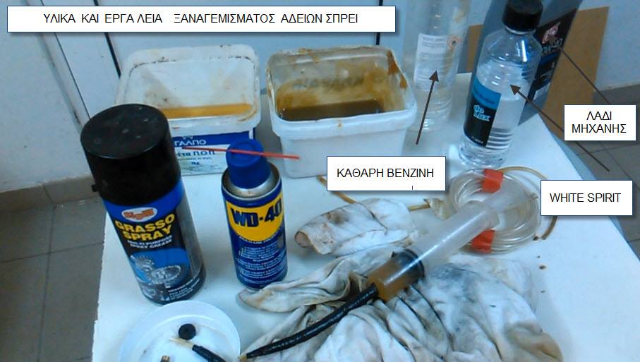

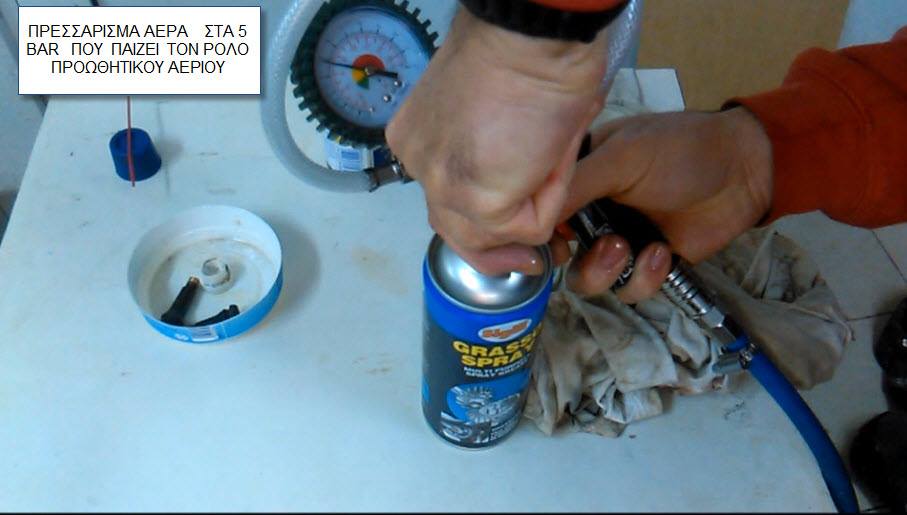

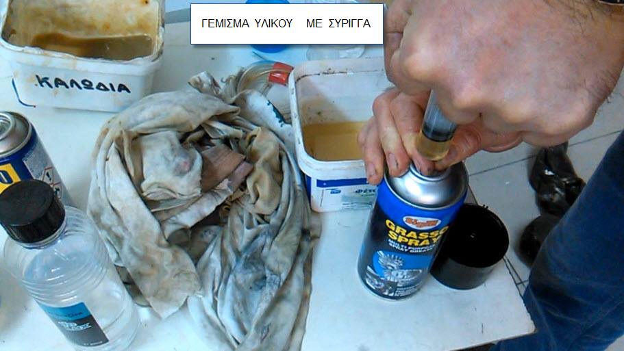

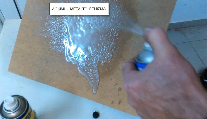

    We use a plastic tube and a syringe. We fill with compressed air in a pressure of 80 psi to be safe. If we use propane gas instead of compressed air is more dangerous. YOY CAN WATCH THE VIDEO HERE.
