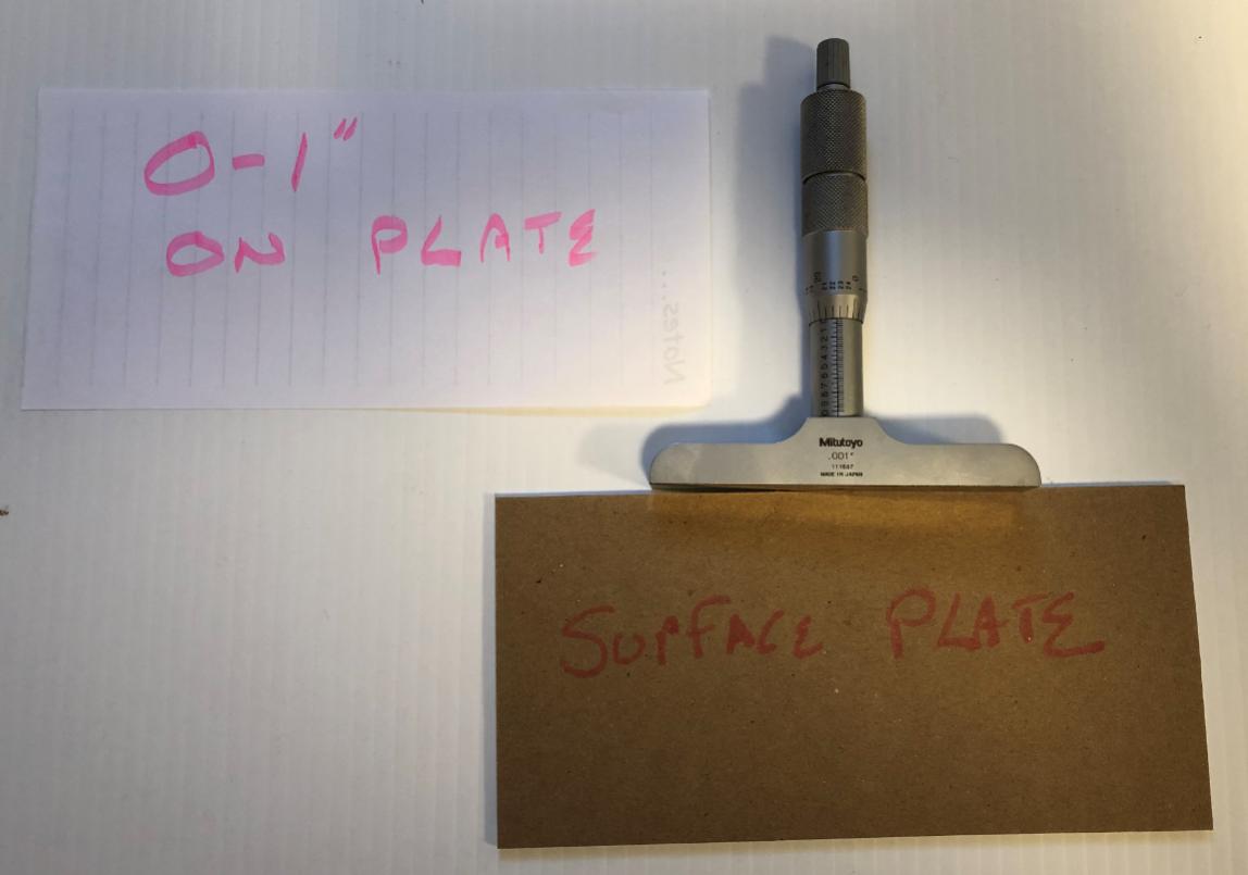

    I am having some problems attaching photos
    When you change rods you must check calibration you do this for many reasons (bent rod – dirt or metal shavings inside under rod – dent on bottom of rod – and many more )
    To check calibration I use gauge blocks and a known surface
    thank you for your response

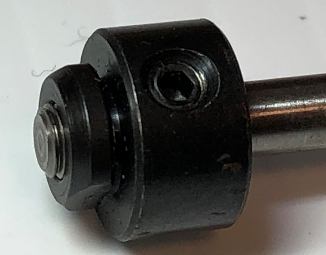

    To calibrate the depth micrometre
    You adjust each rod (this can take some time)
    If you are going to adjust a rod size in a vice there is a chance of bending the rod during celebration
    Don’t do this with out help from some one who has experience
    There are multiple different styles of rod heads
    This example has a nut and 3 allen keys
    thank you RexB
    if this does not answer the question let me know
