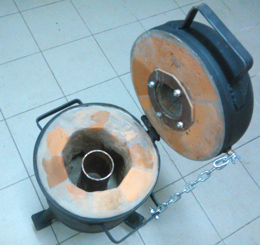

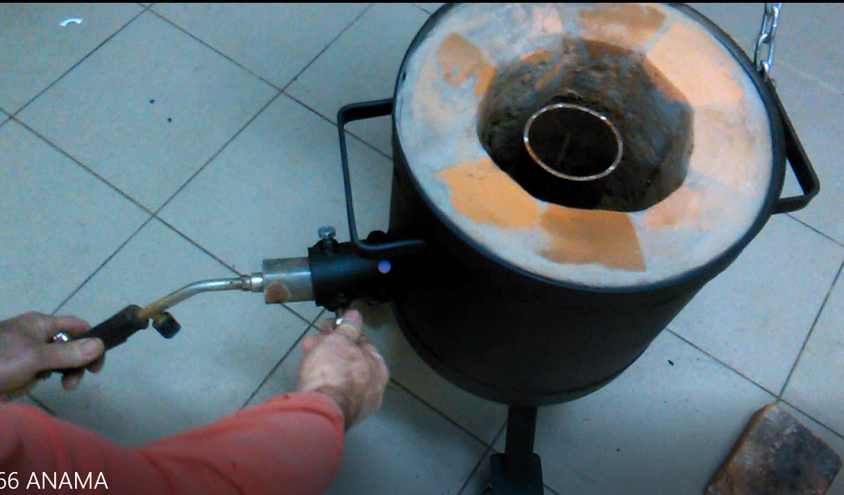

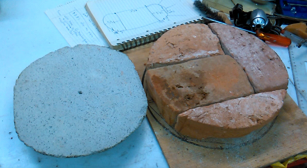

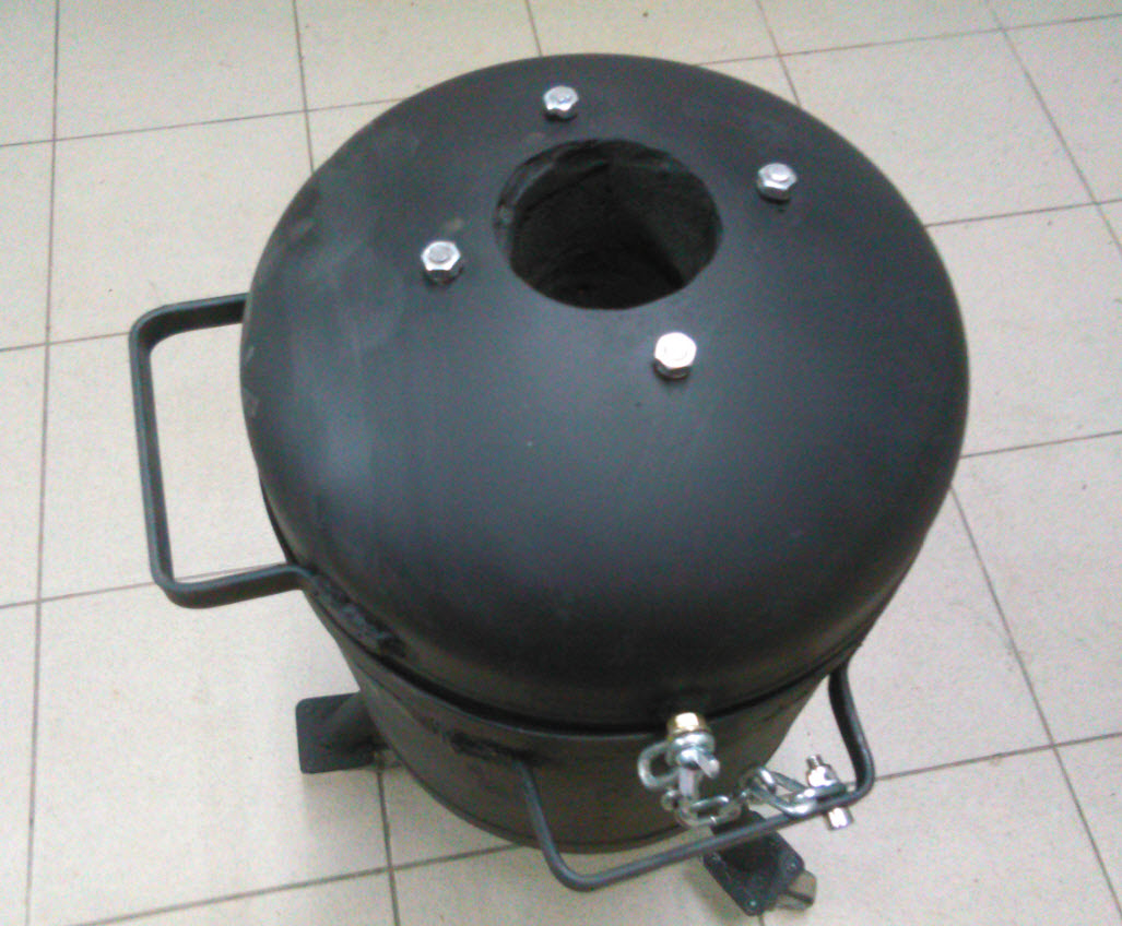

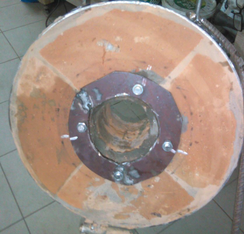

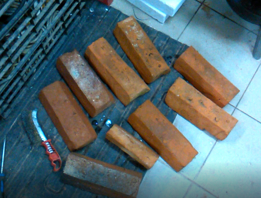

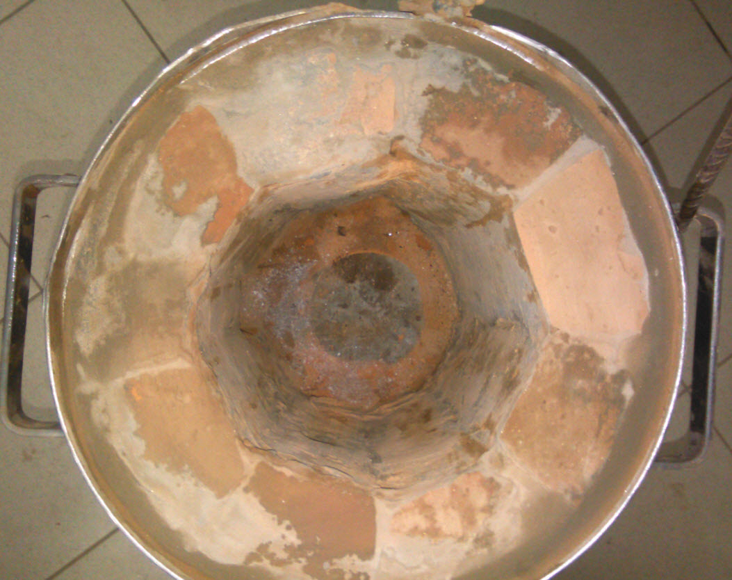

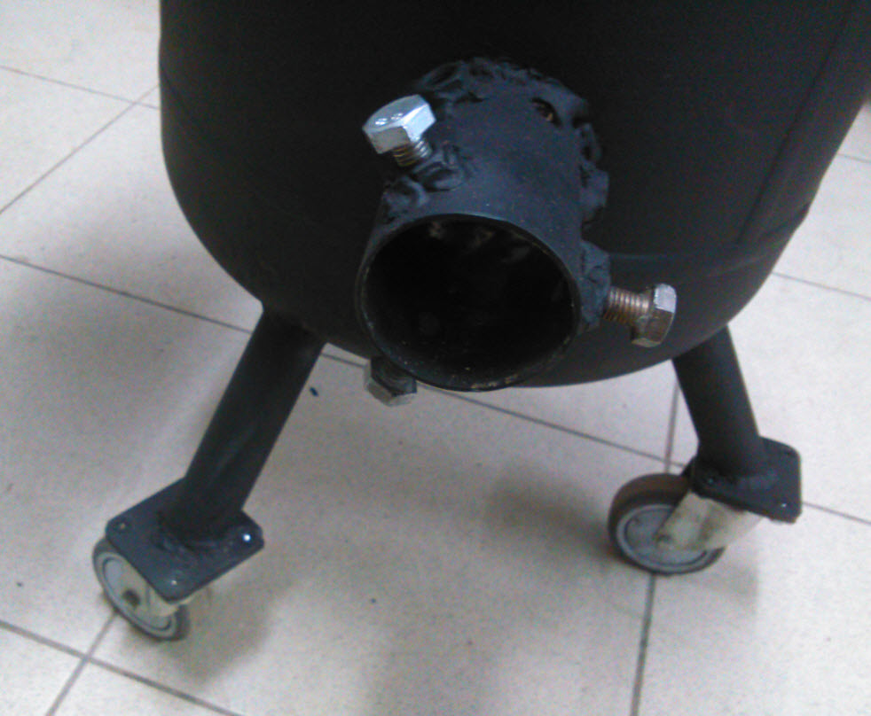

    This is the first video of the new serie in my channel that is about metal melting. We can learn here how to make a homemade metal foundry that works with propane. In the future i will try first to melt in this foundry aluminum and later copper and bronze.
    YOU CAN WATCH THE CONSTRUCTION HERE:
    Attached Thumbnails Attached Thumbnails HOW TO MAKE A STRONG METAL FOUNDRY-f101.jpg   HOW TO MAKE A STRONG METAL FOUNDRY-f102.jpg   HOW TO MAKE A STRONG METAL FOUNDRY-f103.jpg   HOW TO MAKE A STRONG METAL FOUNDRY-f104.jpg   HOW TO MAKE A STRONG METAL FOUNDRY-f106.jpg

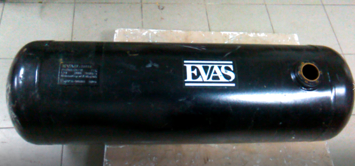

    I have a old 60 gallon compressor tank I want to cut the top off of and do this to so I can cast some heads and some cylinders for my air cooled vw/porsche stuff. im not sure where to get the brick.perhaps I should ask the local clay products place ( brick yard/seller) I was wondering if fire place bricks work for this. and what mud to use?.I reckon Ill watch this vid and see!!!

    how long does it take to preheat this foundry until it's ready to melt the aluminum?
    I saw similar designs based on the electric heater, and it took 1 hour to heat it up!
    I hope the gas based foundry cuts the preheating time to few minutes.

    Depends of the dimention of the object. If for example we have tins you need about 5-7 to begin to melt. Then you put inside more tins that are melting almost immediately.If the object is more thick you need more time for the melting to begin.
    Same here. I picked up a free compressor just for this sort of project. It has holes rusted in the bottom, and no motor, so no one wanted it. I have the refractory cement and some of the fittings.
