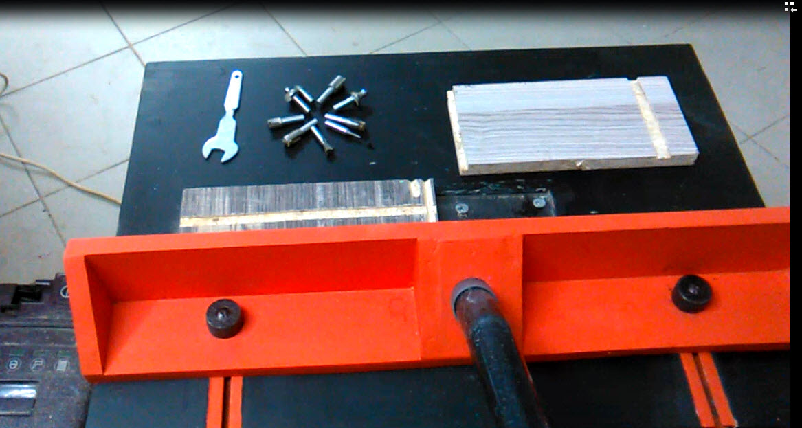

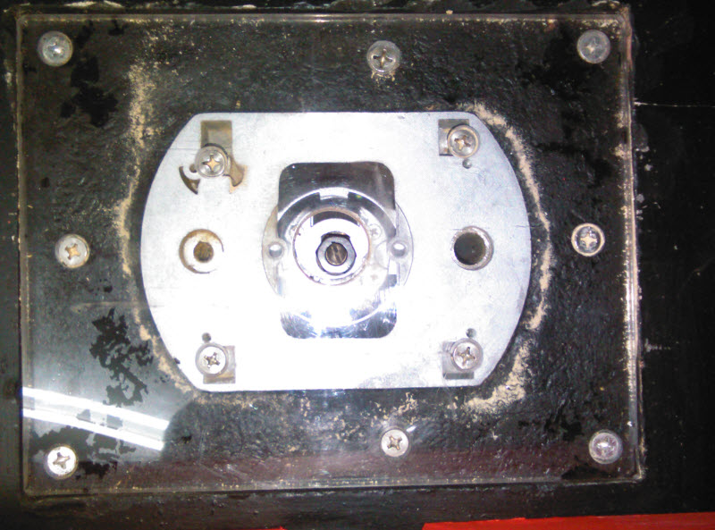

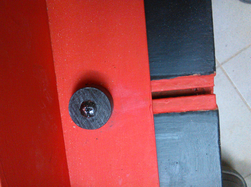

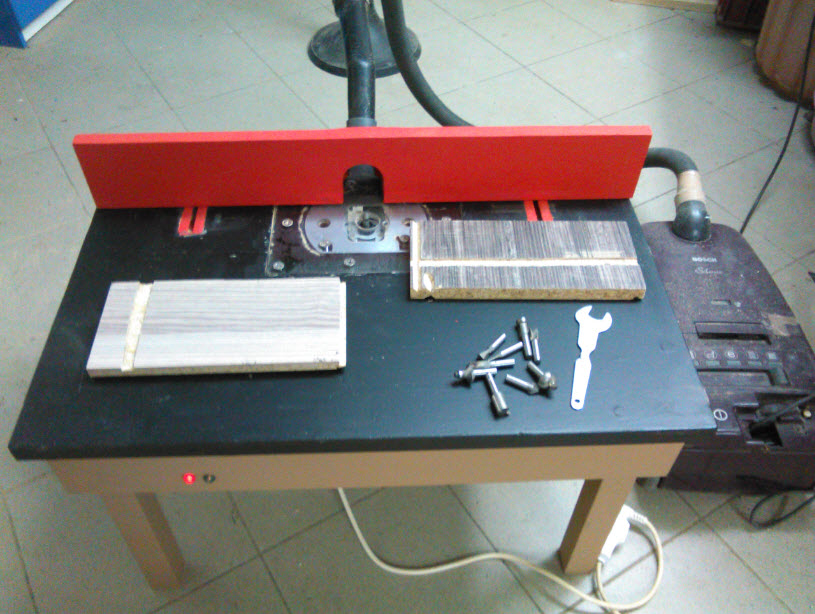

    HOW TO MAKE A ROUTER TABLE

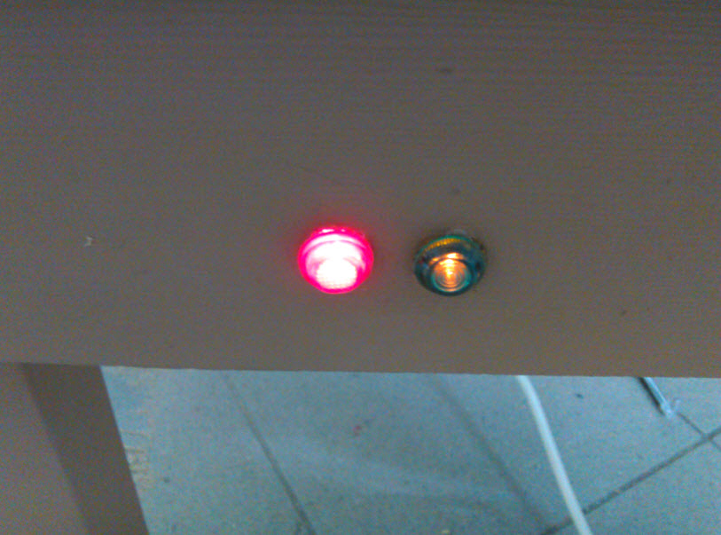

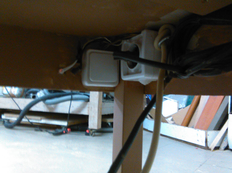

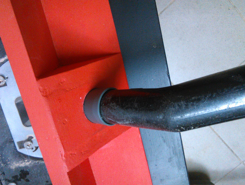

    In this video you can learn how to make a table for your router with very simple materials. The two T-Slot you can buy from Bangood very cheap. The top of the table is 70X50X2.5 cm. The plexiglass is 8 mm thick. The on-off switch is 230 V 10 A. Take care of your fingers.
