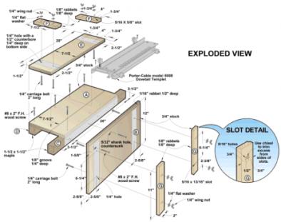

    I have a router and I want to make a dovetail guide

    The time and precise fabrication required doesn't offset the savings. But if you really want to make one. Here's a basic exploded drawing of one. Then it depends on the depth and spacing you want to achieve.
