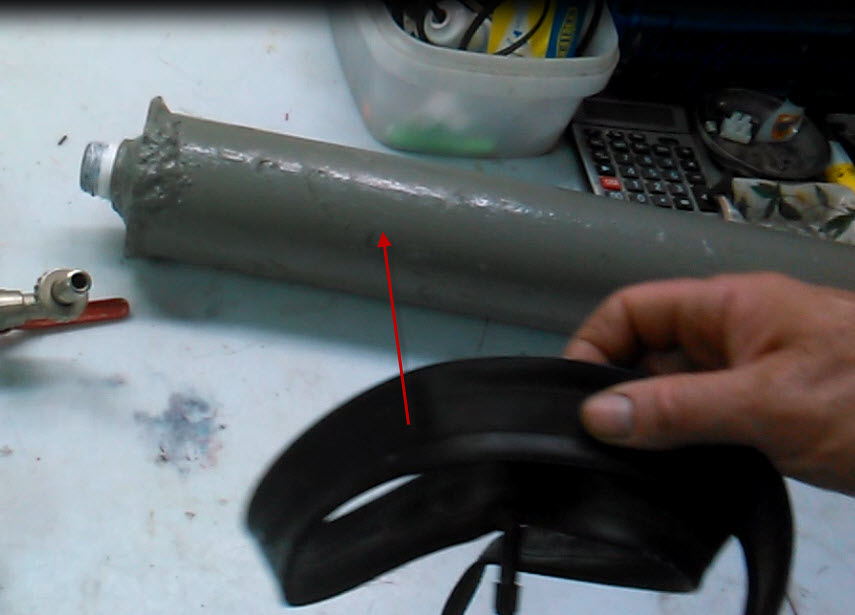

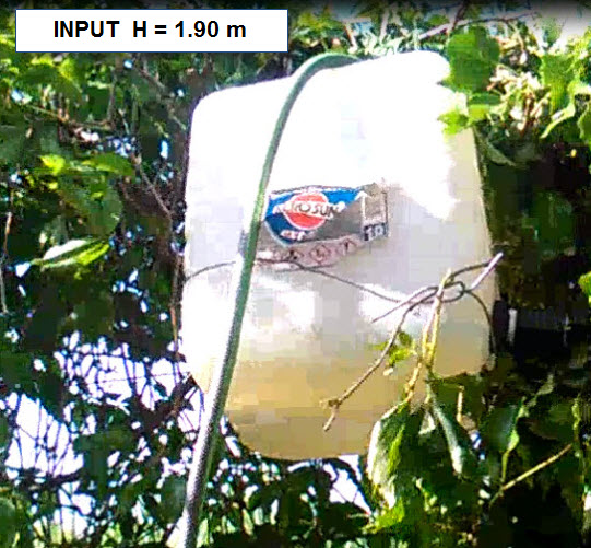

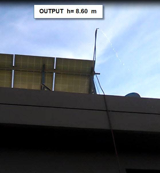

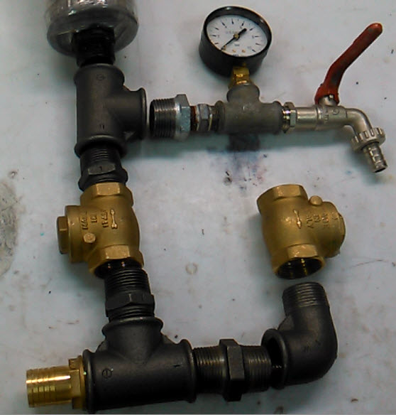

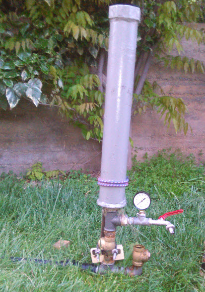

    An easy construction to elevate water from a small stream or river to our field that is higher 5-8 times than the manometric height we get the water. We don't need fuel or electricity to do this.We use only the kinetic energy of the water. The water supply is low but it works 24 hours a day. We can store the water in a tank in a high place of the field for watering our place.
    YOU CAN WATCH THE CONSTRUCTION AND THE USE HERE:
    Attached Thumbnails Attached Thumbnails HOW TO MAKE A RAM PUMP-f1.jpg   HOW TO MAKE A RAM PUMP-f2.jpg   HOW TO MAKE A RAM PUMP-f3.jpg   HOW TO MAKE A RAM PUMP-f4.jpg   HOW TO MAKE A RAM PUMP-f5.jpg

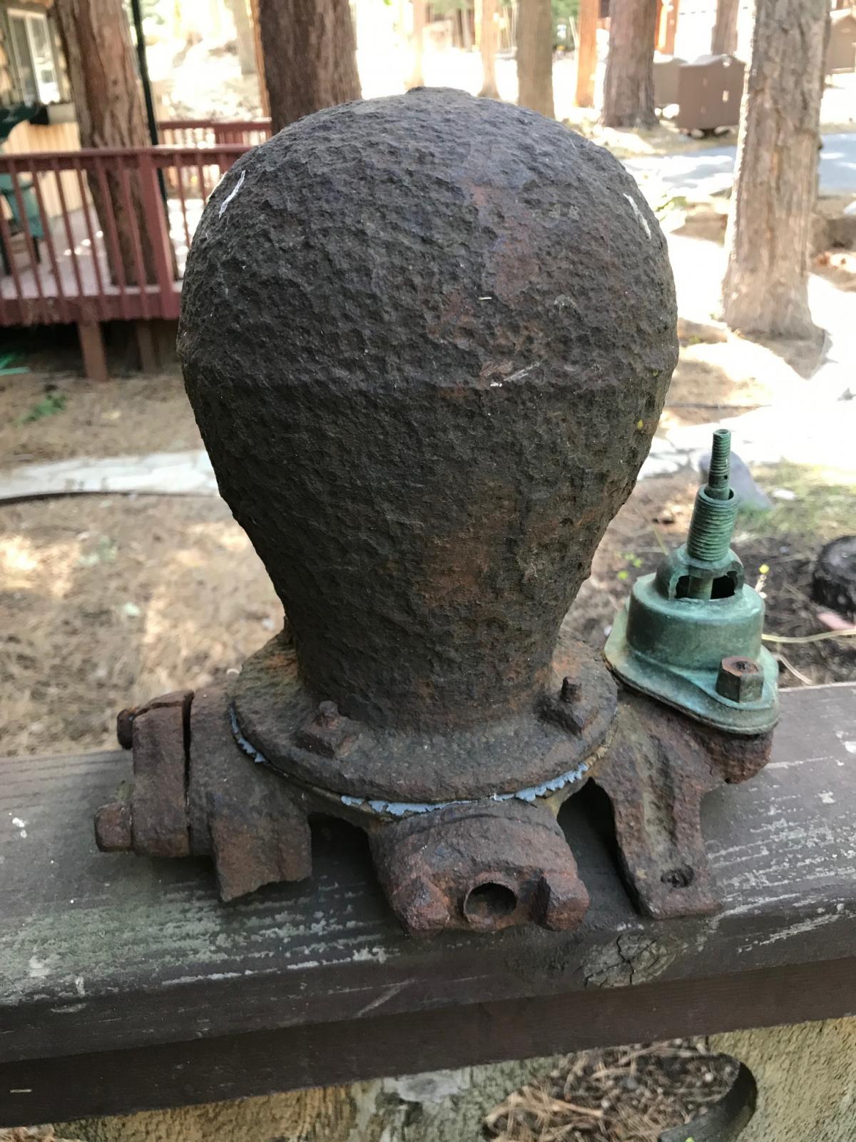

    Great build. I think mine is over a hundred years old...
