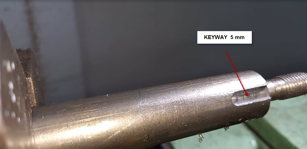

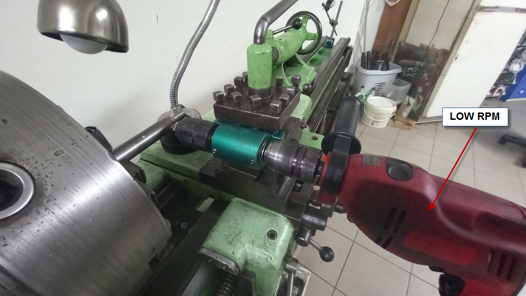

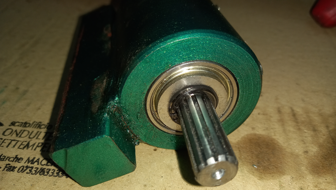

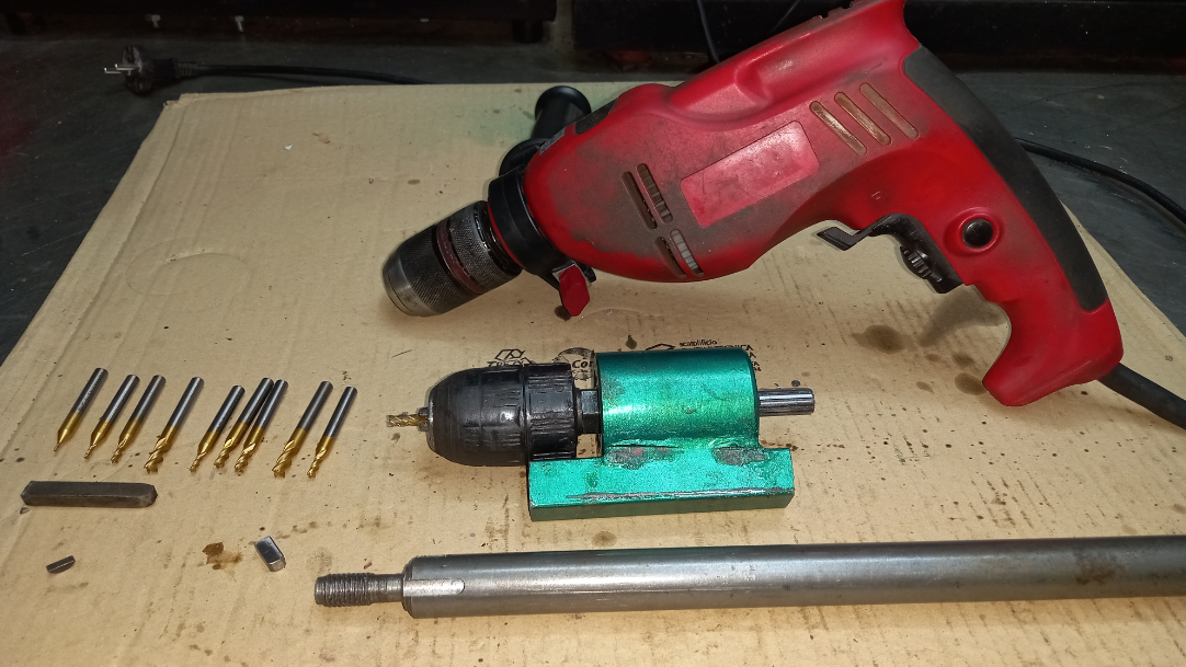

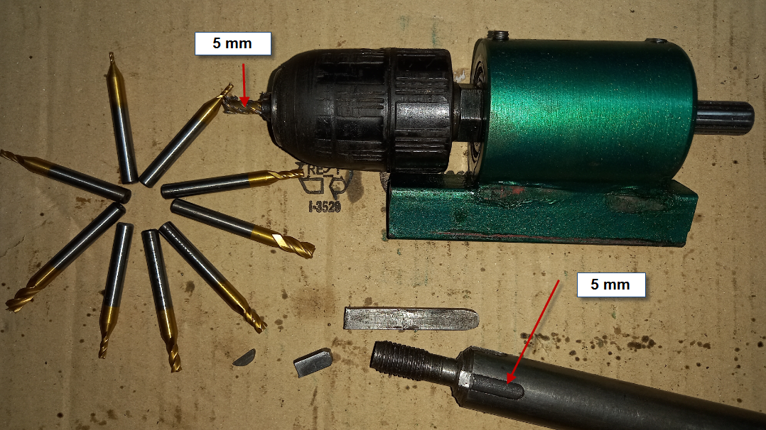

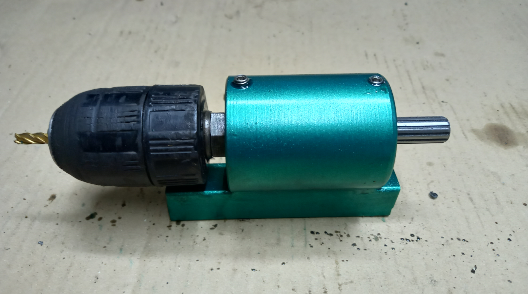

    HOW TO MAKE EXTERNAL KEYWAY ON THE LATHE.
    In this video i made a simple tool that helps us to make external keyway without a milling machine by using only our lathe. You can watch the video of the construction and the use of it here:
