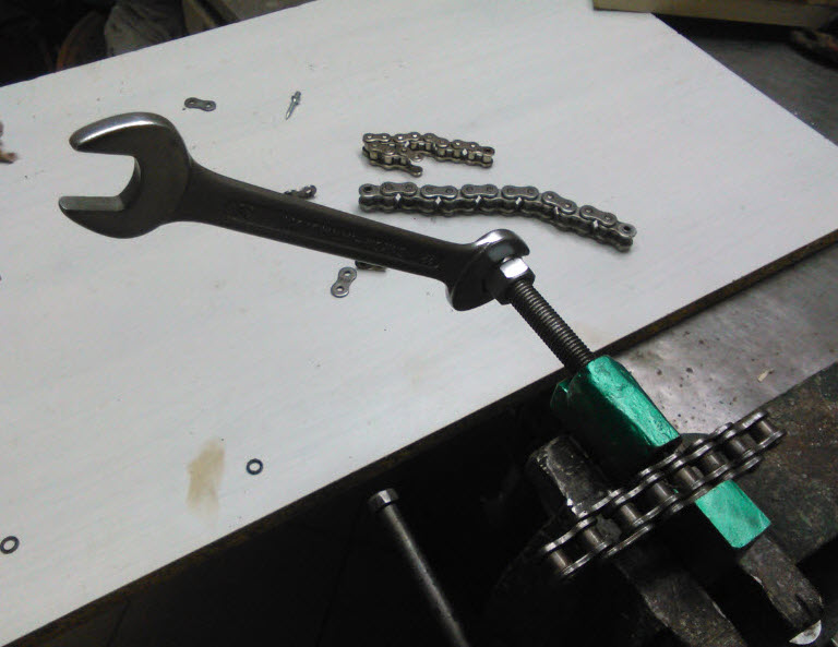

    HOW TO MAKE A CHAIN BREAKER FOR MOTORCYCLES

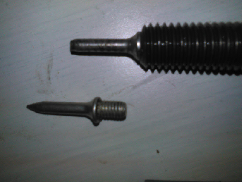

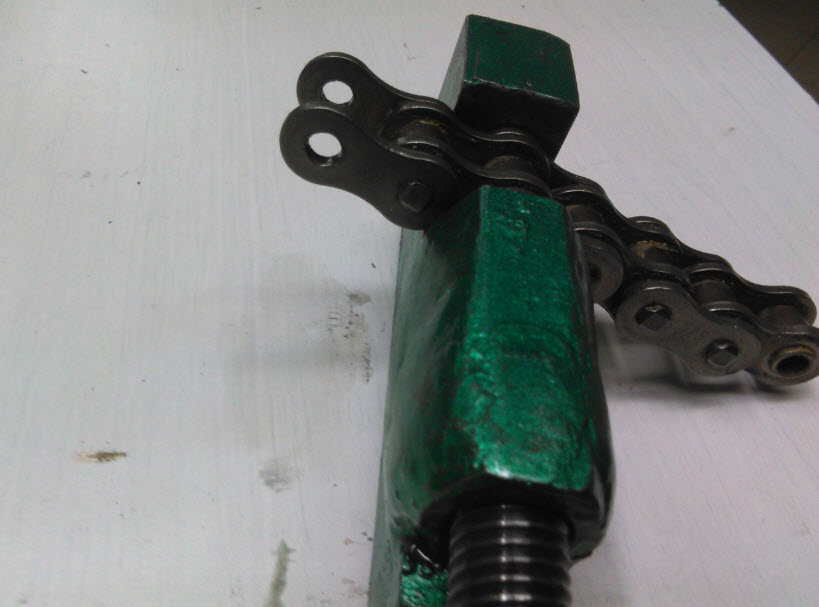

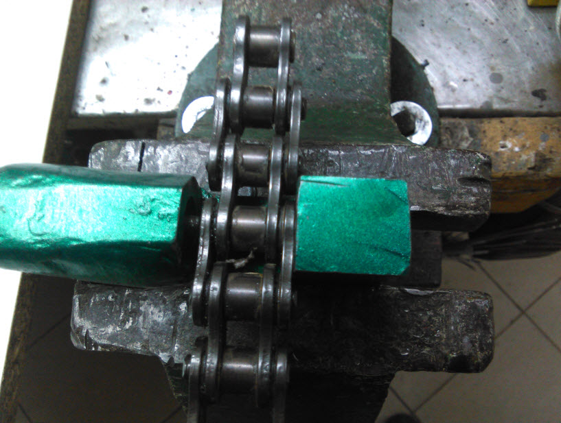

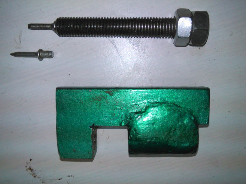

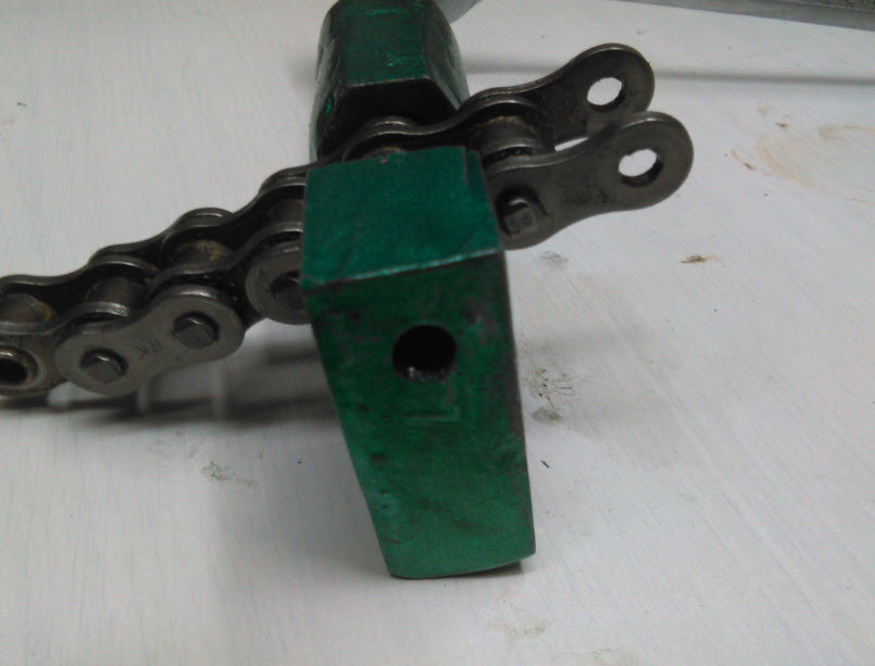

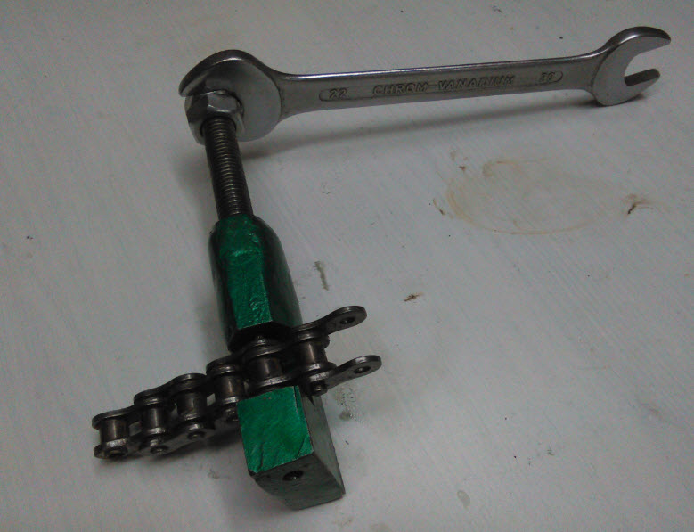

    A useful tool for your motorbike , you can make it in your laboratory with simple tools. You need an angle grinder , a drill , a welding machine and the tool to cut the 6 mm thread. Of course it is not a professional tool but you can make it very cheap. I have used a 2 cm thick iron bar , a 14 mm screw , two M14 nuts and a steel nail.
    YOU CAN WATCH THE VIDEO OF THE CONSTRUCTION AND THE USE HERE:

    Good chain break kits here might run high as 75-80+ USD. Imports about 1/3 that. Those lower priced offerings don't like 520 chain. DAMHIKT
    Or DIY as shown; substantial frame, fine pitch threads, high Rc [if not hardened] point. Perfect score!
