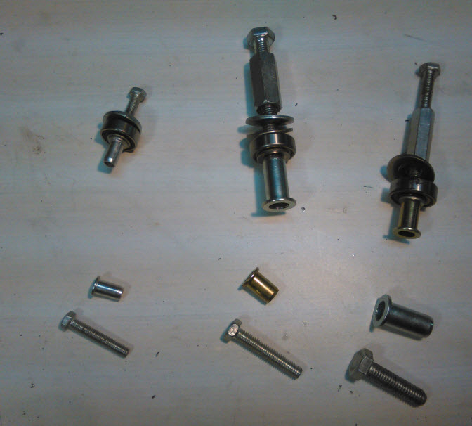

    HOW TO INSTALL RIVET NUTS WITHOUT THE SPECIAL TOOL.

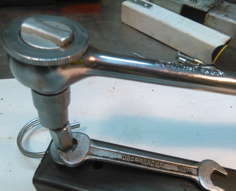

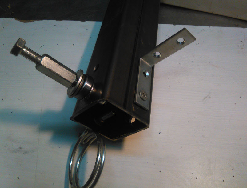

    In this video I have made a simple tool to install easily rivet nuts. I have used a bearing with two washers , one small (small hole) in conduct with the inner ring and the nut and one bigger (bigger hole) in conduct with the outer ring to the other side. The reason is to not transmit the rotation from the screw to the nut.
    YOU CAN WATCH THE CONSTRUCTION AND THE USE HERE:
