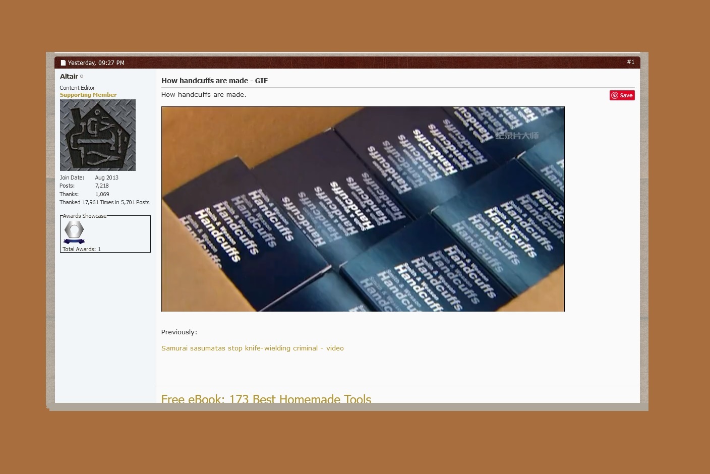

    How handcuffs are made.

    Smith and Wesson cuffs at that. It appears from the logos that they might be made abroad and not in the U.S. Did anyone else get that impression from the logos on the screen? I have a couple pair of them. They were always tight ratcheting through and required much more force that the Peerless brand ones I carried most of the time as a cop. One time several years ago, the local Sheriff's Dept. bought a bunch of Hiatt's handcuffs. Almost every pair of them had to eventually be cut off of inmates' wrists with bolt cutters. They would not unlock. Apparently it was a bad batch.

    They're S&W alright. Unmistakable logo.
    Can't (won't) stereotype place of origin, but the tooling appear well made, for a mostly handmade product. Biggest surprise was the gas furnace instead of induction.
    Some US companies are careful with who they let out contracts, and monitor product from raw material to packaging 100%.
    Seemingly a pattern for outfits still carrying the founders names, no matter changes in ownership.

    It isn’t clear to me how the main, curved components are formed. Stamped out? Forged? Did I miss something? I went through it several times.
    Virtually all stampings, including the channel shaped 'housing' formed from flat strip. Teeth are milled into the hook portion, and what I take to be the chain swivel ball is shaped part in 6 spindle lathe with form tools.
    The anchor end wasn't visible, I suspect done the same way. but a lathe with integral milling or live tooling perpendicular to the material axis.
