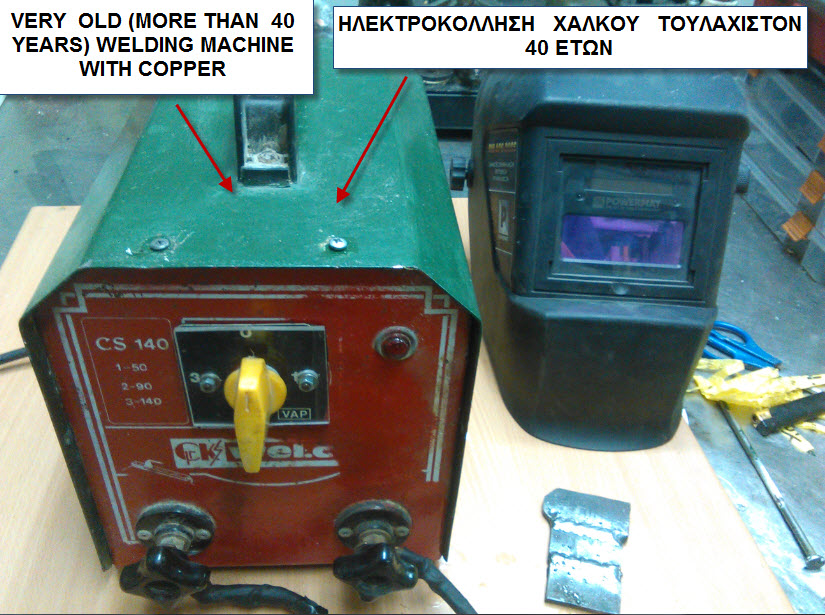

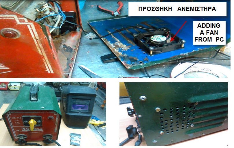

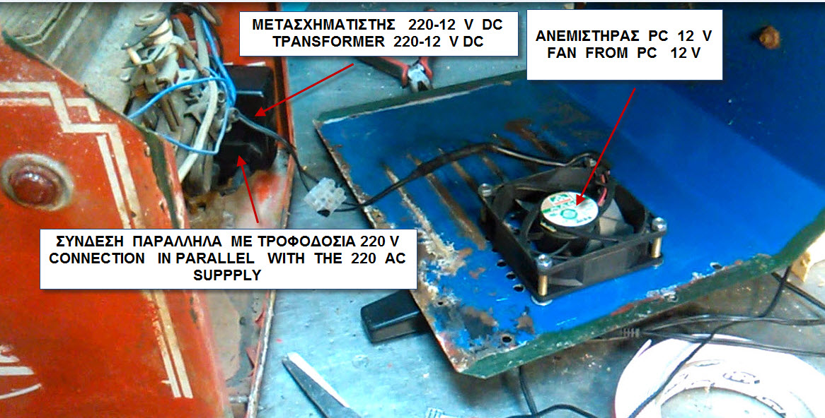

    An easy construction that keeps your welding machine (transformer with copper wire) cool especially during the summer time. I ' ve used a 220-12 v small transformer and a 12 v fan from an old pc. In this way the thermal switch stays closed all the time and the welding machine is cool inside.YOU CAN WATCH THE CONSTRUCTION AND THE USE HERE:
    Attached Thumbnails Attached Thumbnails HOW   TO  COOL  MY  WELDING MACHINE-f1.jpg   HOW   TO  COOL  MY  WELDING MACHINE-f2.jpg   HOW   TO  COOL  MY  WELDING MACHINE-f3.jpg
