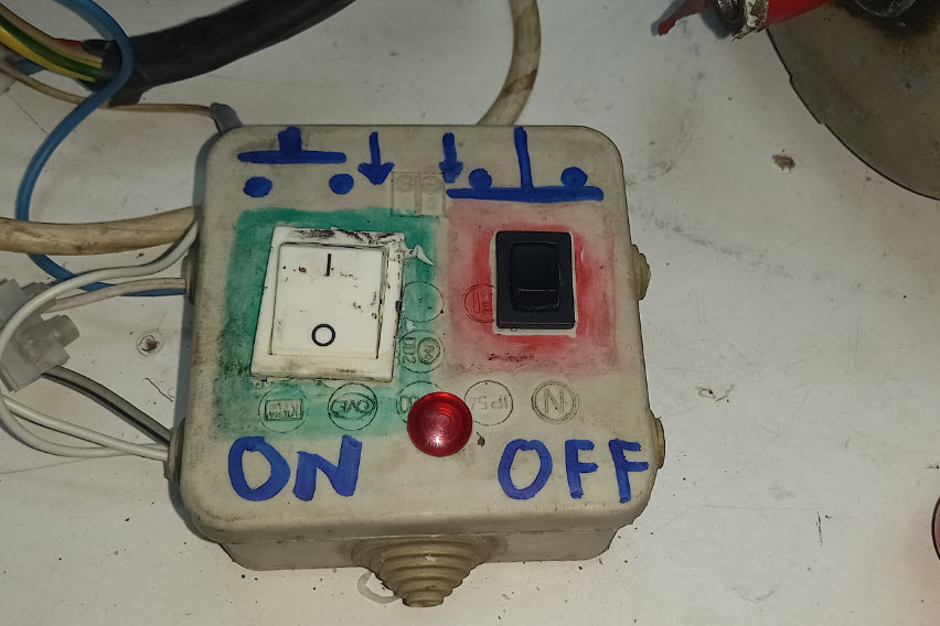

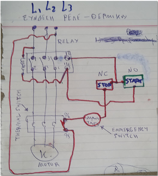

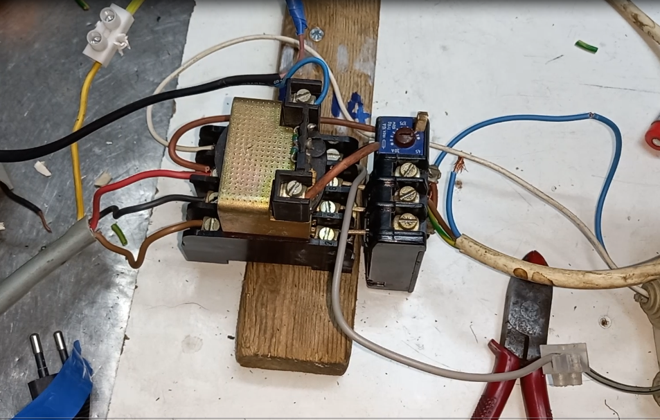

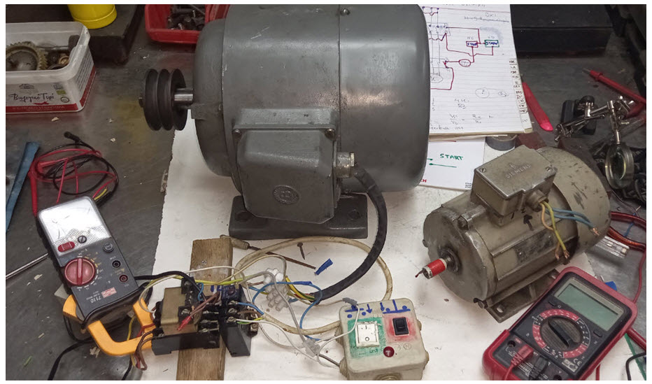

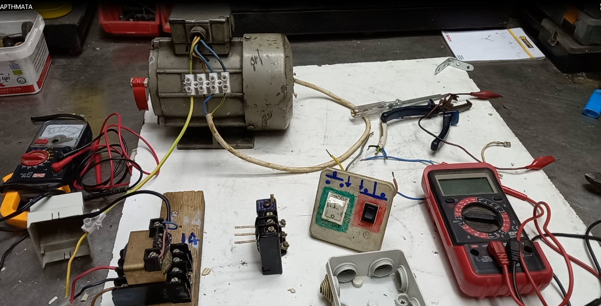

    HOW TO CONNECT A THREE PHASE MOTOR WITH THERMAL PROTECTION AND ON-OFF SYSTEM
    In this video we can learn how to connect a three phase motor with automatic ON-OFF and thermal protection.
