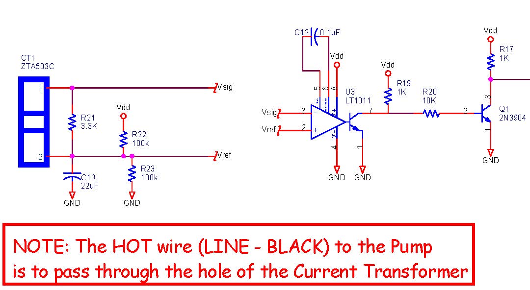

    Turns out, I had a similar problem as I had a pump that I needed to monitor and if the pump stopped running (for whatever reason) I needed to raise an alarm so that yours truly could intervene. For that, I designed a circuit using a current transformer that looks like this:
    Vdd is 5v and GND is NOT attached to earth.
    That circuit works really well and can sense the current flowing when the power was down to less than a watt and up to many hundreds of watts (the pump was a variable speed pump).

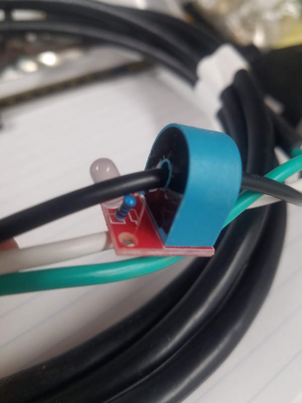

    For the tractor, I wanted to make it simpler and I came up with this:
    Pretty simple - 5A/5mA Current Transformer, LED, and Resistor...
    When I bought the current transformer for the pump, at the time it came with a circuit board and you got two sets in the package. You could use the circuit board (I cut in the resistor), but you could also wire it up on a breadboard or even just to the leads of the components.
    The current transformer is an AC device so it's output is AC as well. The HOT line (BLACK in the USA) goes through the hole in the current transformer and the rest of the components are isolated from the line voltage. Most of these current transformers have isolation voltage ratings of thousands of volts (I think mine are 4500V). The orientation of the LED doesn't matter, since it is AC. I put the resistor in there to limit the current in the current transformer and the LED. The value you see is what works well for my block heater. In your case, start higher and lower the value of the resistor until it is bright enough to see the LED. I used an LED that was in my "inventory" (I have no clue of it's specs, it was red and I fussed with the resistor value to get it visible).

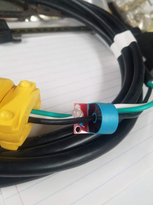

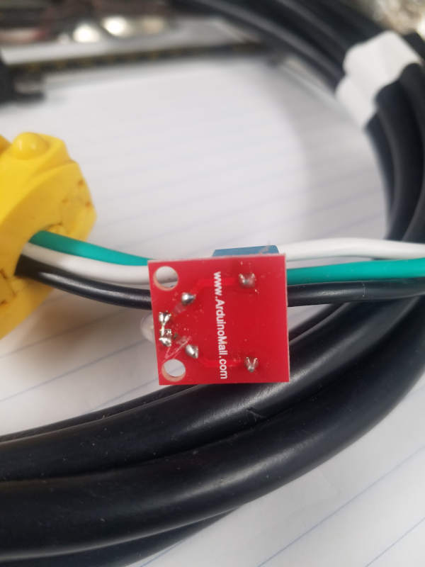

    Here is what it looks like when built:
    the back of the board

    closer view of the front
    The current transformer I used was a ZTA503C, but just about any 5A/5mA (1000:1) ratio transformer will do. I think a part number I've seen recently is ZMCT103C. Remember you are using a current limiting resistor, so you don't need to scale up to a larger current transformer. There is one on amazon - 10 pieces for $8, another 5 pieces with circuit board for $7. That newer part number shows up on aliexpress as well and pretty cheap.

    Looks good, but can I recommend a tiny change? Might want to add some back to back diodes in parallel to that CT to clamp the voltage. With a 3.3k resistor in parallel with that CT you're looking at hundreds of volts across those op-amp inputs if there's in-rush current. Probably won't be a huge problem with a resistive load that only draws an amp or two, but you had mentioned a pump and that will be a problem. Right now you're relying on the chip designer's ESD protection on each pin to save the circuit, but that will only take so many thumps before it gives up and your op-amp kicks the bucket.
    Also you mention using the hot wire, but this circuit will work equally well on hot or neutral. Unless you have a ground fault the current will be identical on both wires and the circuit will function identically.

    Depending on the LED used, it may not like being reverse biased every cycle. You could use two LEDs wired in parallel but reversed so one lights at a time or put a diode across the LED to clamp the reversed half cycle.
    The old, dim, green LEDs are really rugged so are often used in a circuit like this to avoid the cost of the diode. More modern LEDs like bright green and others don't like reverse voltage.
    I had thought of diodes, but they aren't needed, based on breadboarding and testing. I found that the current transformer saturated at about it's maximum input current. This was found by looking at the scope with only the front end stage of the circuit, with the comparator removed. The traces were clipped, just like if saturation occured. Trust me, I pondered this quite a bit. I suspect that with the datasheet load resistor of 100 ohms max, the results would be more linear, but I didn't test that. I wasn't trying to characterize the current transformer. just experiment with it. So, in practice, the "max current" and the load resistor yielded less than 1.5V. Why? I don't know. 5mA * 3.3k should be 16.5v, but that assumes the current transformer is an ideal inductor and at 60Hz, I don't think it is even close.
    There is 2.5V of headroom because of the voltage divider. I spent a lot of time with the breadboard, loads (resistive and noisy switchers), and a scope testing this because I didn't understand why I couldn't get more current passed to the secondary. I suspect it has to do with the shape of the current transformer and the field around the wire, but Maxwell's equations and EM field theory was 1974 and I don't remember any of it.
    I ended up concluding that while my test loads were 10x of tha actual load, I couldn't force the circuit to get anywhere near the limits of the simple voltage shifter. Also, with the comparator, I was able to detect current at 0.01x the actual load under it's lowest operating point, so given that, diodes were not needed.
    Now, it you had a more powerful current transformer, you wouldn't get away with this circuit, but again, my load was a soft start variable speed pump.

    As I mentioned in a comment about the original circuit, the voltage generated was only around 1.5v, even when I pushed the current way higher than the little current transformer was rated for. The burden resistor was higher than the rated burden resistor. I believe the current transformer was saturated.
    So - even if input current was 3x higher than the rating of the 5A/5mA current transformer (block heater is a 1600w device so current is about 15A), I didn't get much more than about the forward voltage of the diode and the that value as a reverse voltage was not enough to stress the red led I used.
    It's been working for about a decade, so I'm, going to leave it as is.
