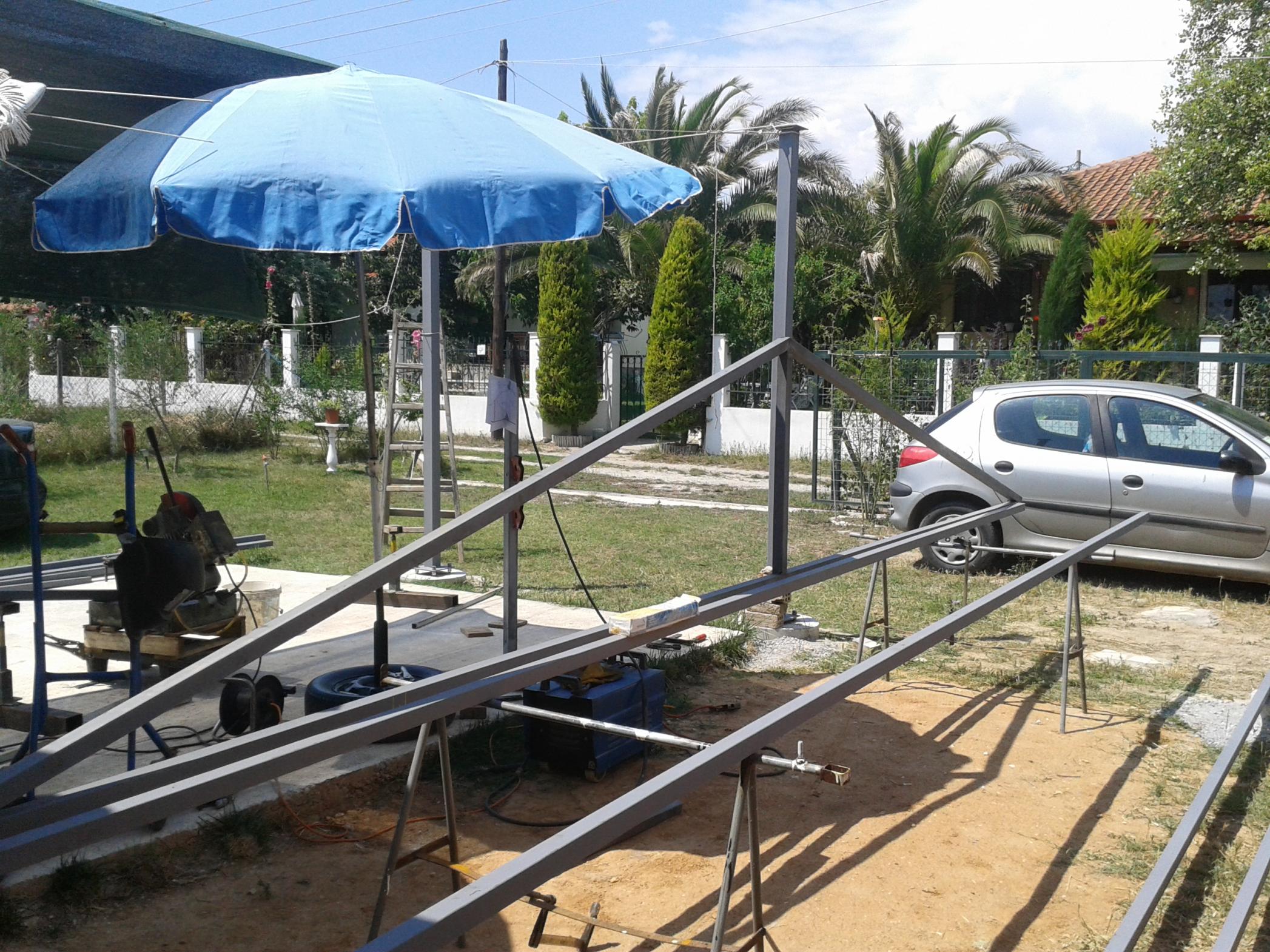

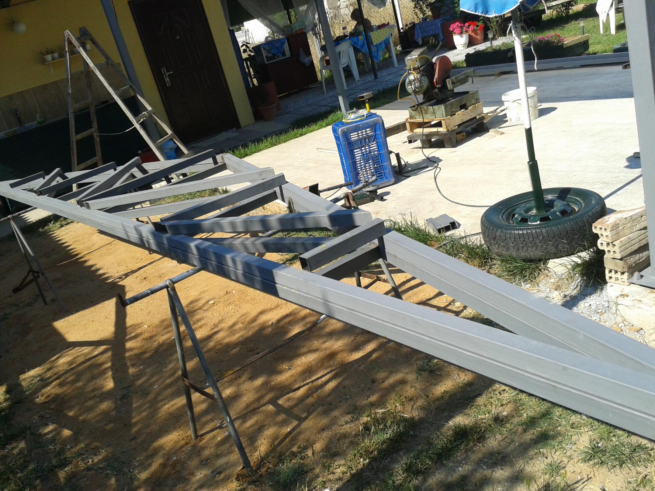

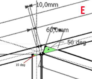

    How to Build a Steel Structure House Part4 Roof Truss Assembly

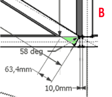

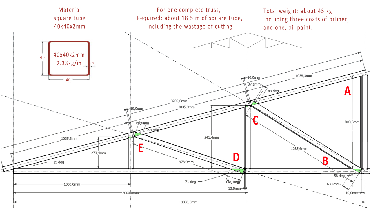

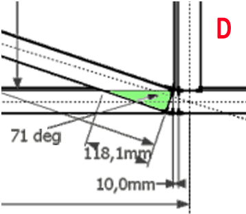

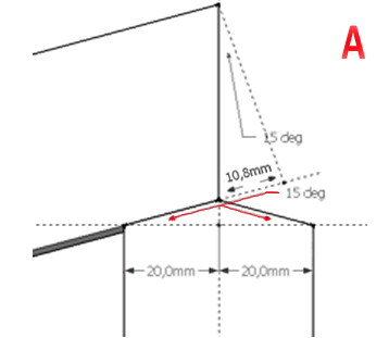

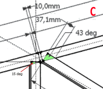

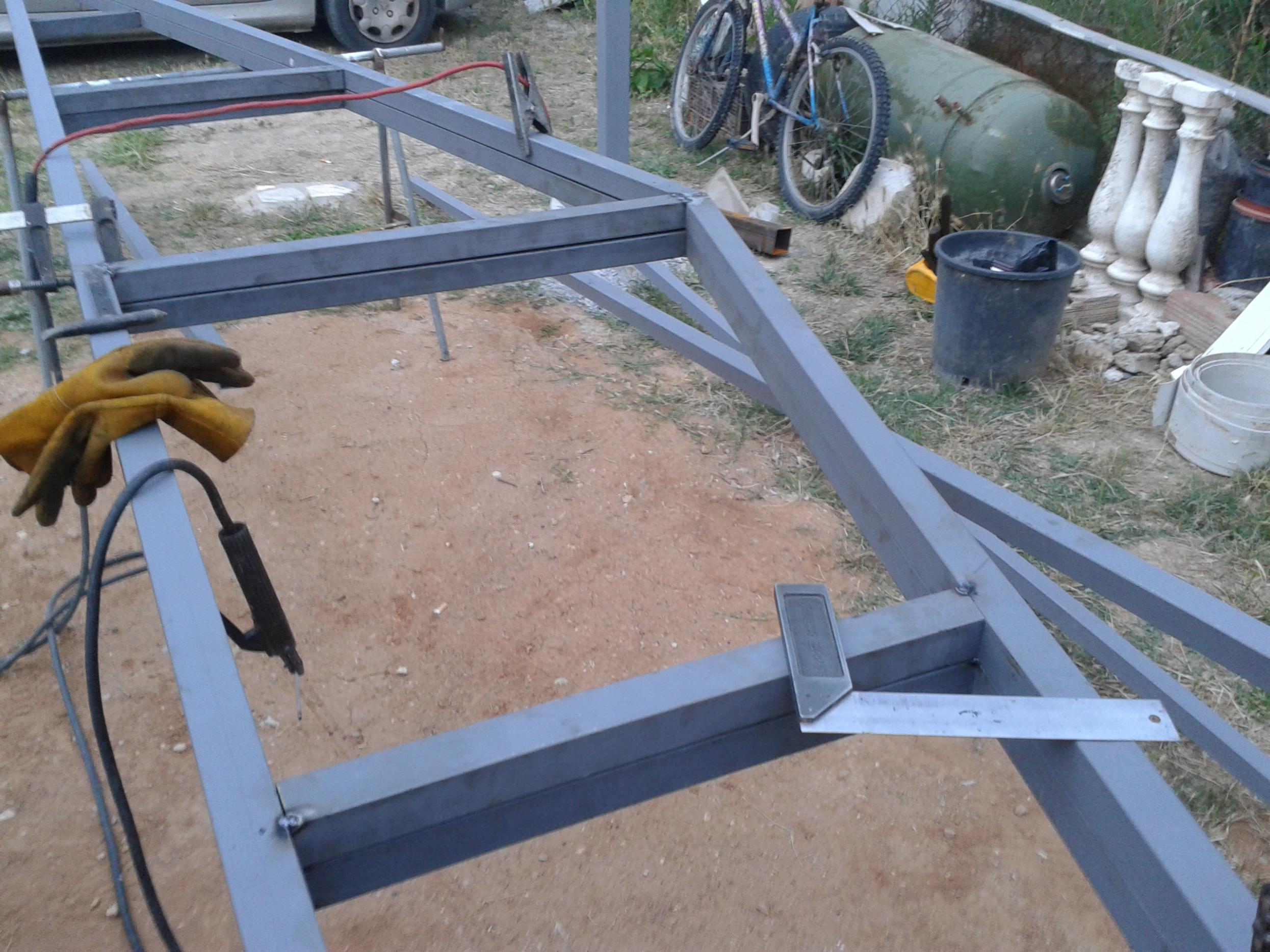

    Roof truss assembly.
    Full plan of trusses with all dimensions.
