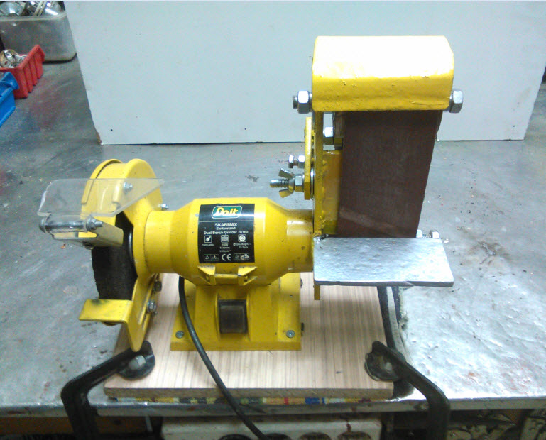

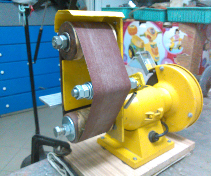

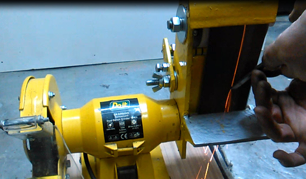

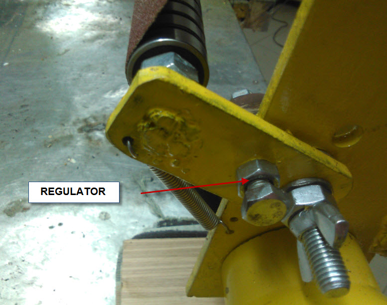

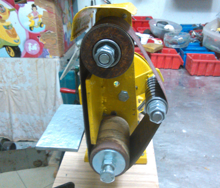

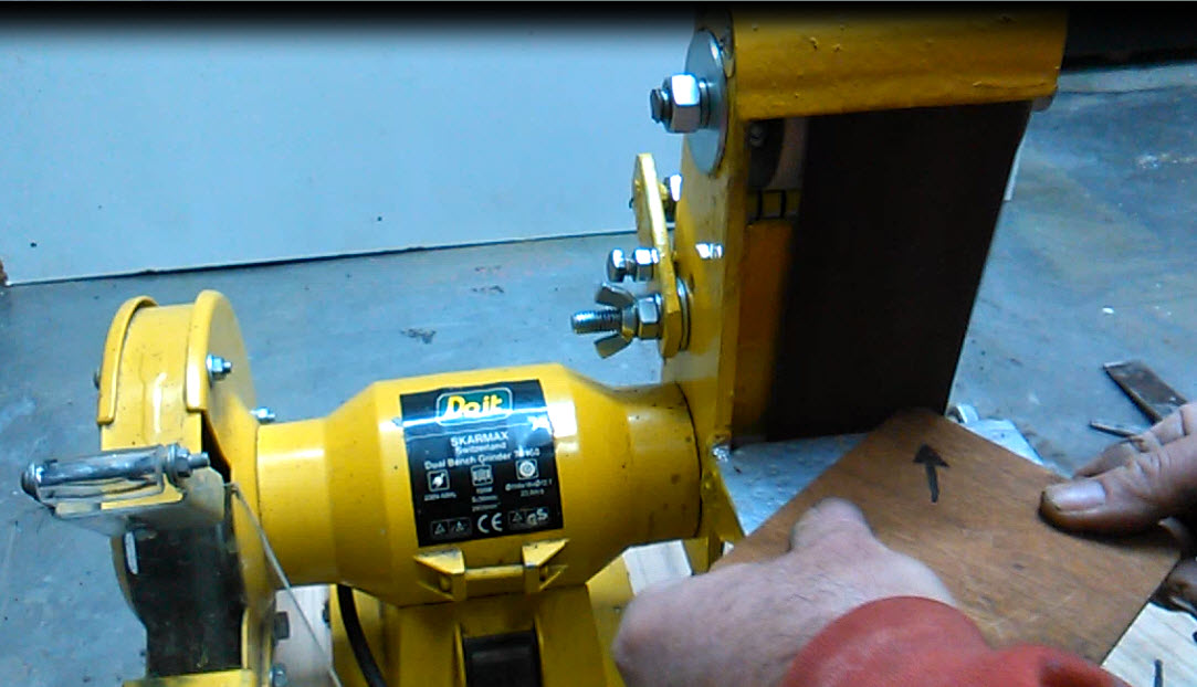

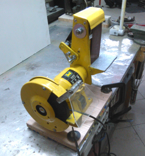

    HOW TO ADD A BELT GRINDER TO YOUR TWIN WHEEL BENCH GRINDER
    In this video we can learn how to add a belt grinder to a small twin wheel bench grinder in our lab. The most difficult is to make the two wheels of the belt grinder without a lathe. It's better our twin wheel bench grinder to have at least 1/2 hp for easy start of the machine.
    YOU CAN WATCH THE CONSTRUCTION AND THE USE OF THIS TOOL HERΕ:
