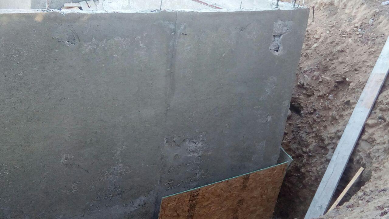

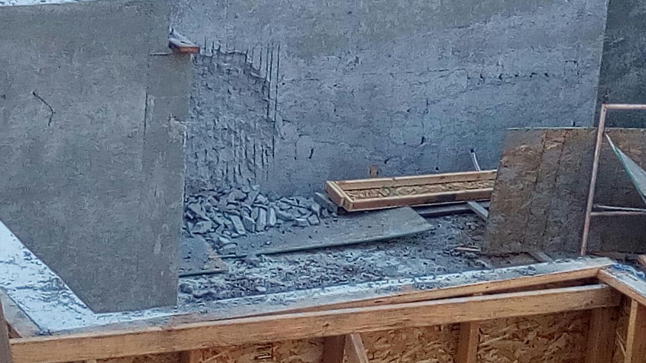

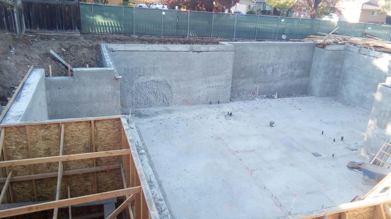

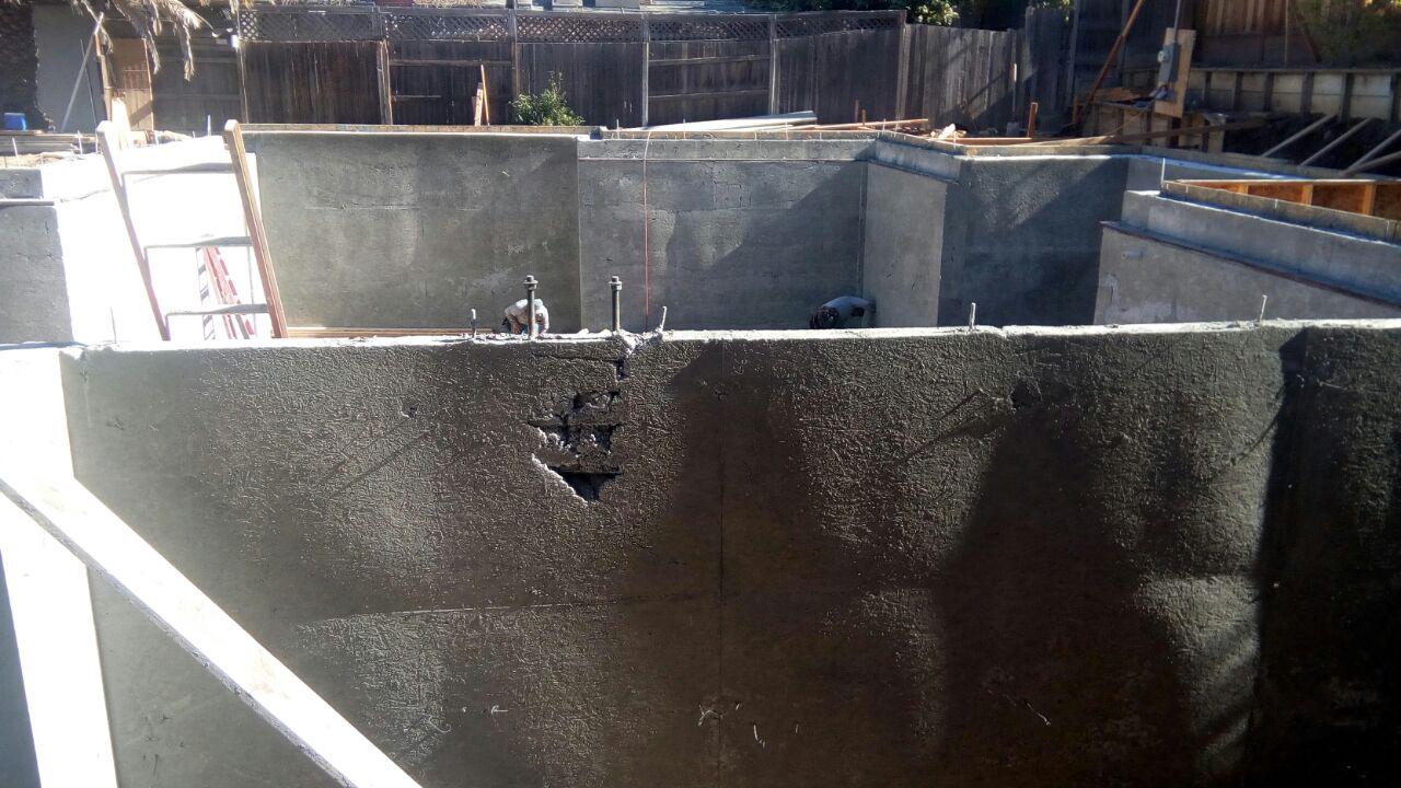

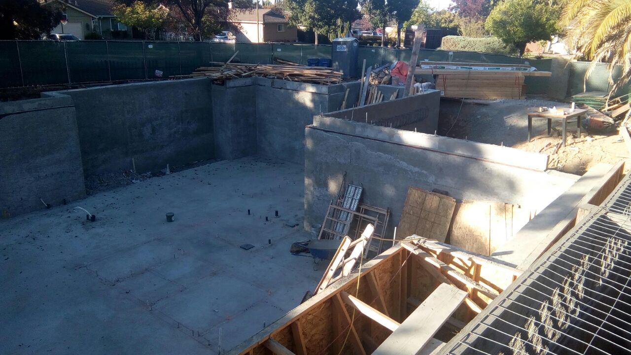

    Ok, the latest from the Pit Crew.
    Carving done...maybe
    The house next door...or how to NOT build a house-photo_2019-10-21_16-54-29.jpg
    Joint from where they ran out of concrete and finished the next day.
    The house next door...or how to NOT build a house-photo_2019-10-21_16-54-46.jpg
    Almost normal looking section
    The house next door...or how to NOT build a house-photo_2019-10-21_16-54-52.jpg
    Oops.
    The house next door...or how to NOT build a house-photo_2019-10-21_16-54-58.jpg
    The wall made a face
    The house next door...or how to NOT build a house-photo_2019-10-21_16-55-07.jpg

    Nicely timed last photo - when the sun shines perfectly in form the side, thus revealing the 3-dimensionality of the wall surface...

    That's a FEATURE, very few people have Waffle Walls. They charge extra for that.
    I heard more power hammering today, so they weren't done carving. They haven't packed up for the day yet so please hold for pictures.

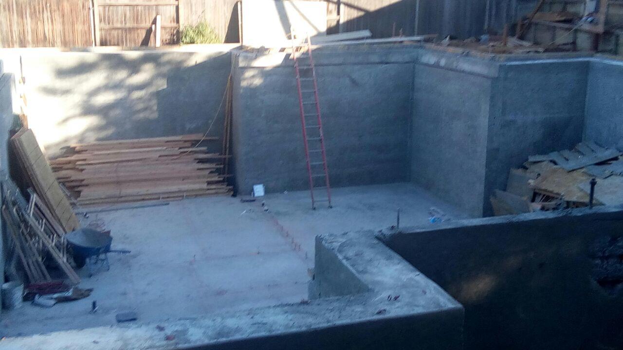

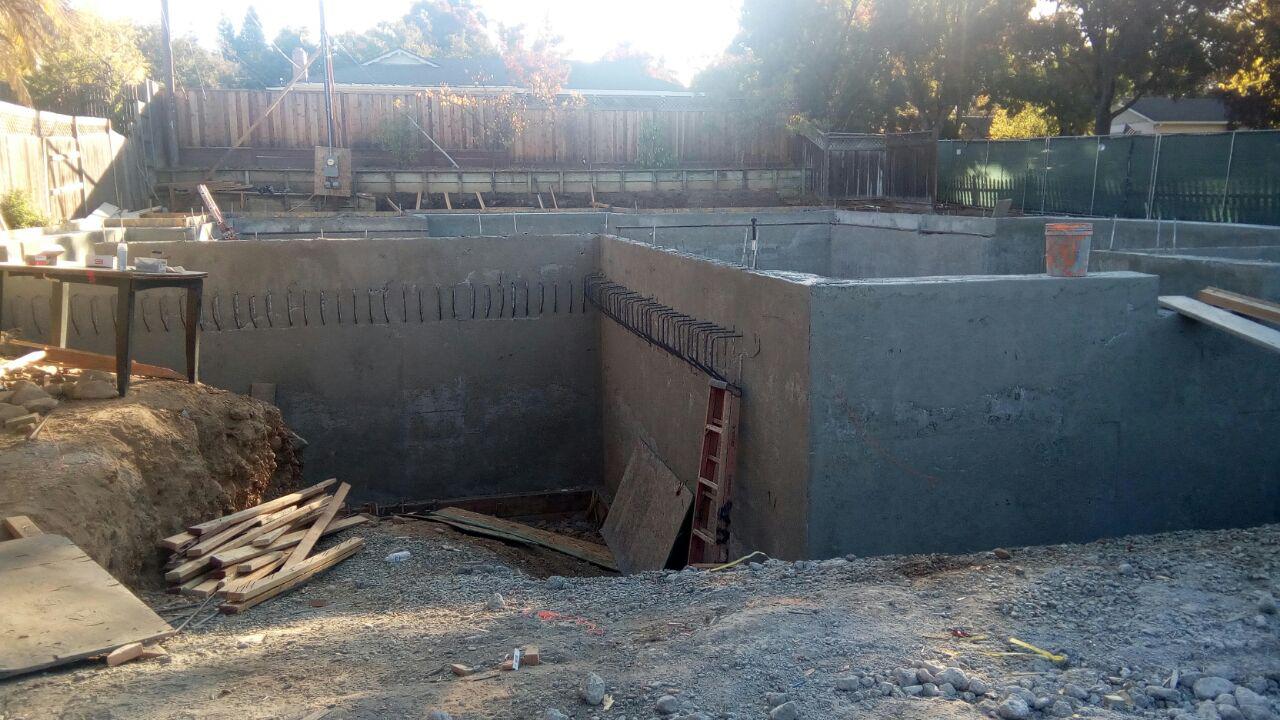

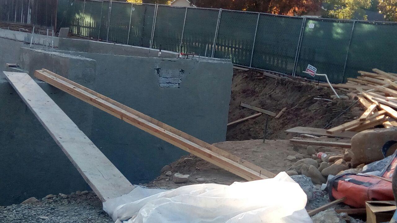

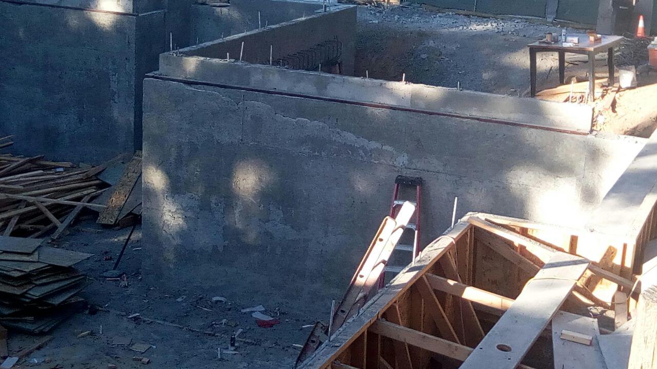

    Today's photos. The first two are a poor man's drone (A-frame ladder (which actually cost about as much as a decent drone)). They were carving a bit more on that same section of wall, they finished hammering partway through the day so I guess that's done.
    The house next door...or how to NOT build a house-photo_2019-10-22_16-56-54.jpg
    The house next door...or how to NOT build a house-photo_2019-10-22_16-57-04.jpg
    more voids uncovered today
    The house next door...or how to NOT build a house-photo_2019-10-22_16-57-09.jpg
    The view from the west
    The house next door...or how to NOT build a house-photo_2019-10-22_16-57-15.jpg

    I'm going to speculate that the carving was done due to a bulge in the concrete due to the shoddy materials used for the forms.
    I don't think I have ever seen that amount of porosity and outright voids in a vertical pour since a visit to Yemen in 2011 to inspect a construction project we were making the steel structure for. It was painfully clear that the Ministry of planning and development had been bought off as every phase had been rubber stamped without and accompanying inspection documentations.
    I suspect on this house construction there will be a huge amount of spackle patching before the moisture barrier is sprayed on
