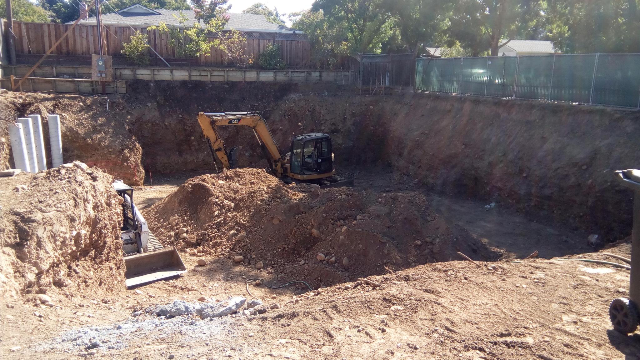

    In theory they are building a McMansion next to our house. The first thing was they had to cut down our giant redwood tree because the roots would be in the way of their basement. It turns out that is the least of their problems...
    The plan called for 28 drilled and cast piles around the perimeter to prevent the sides of the pit from slumping. Only thing is, they never did a soil test or asked anyone around here if this was feasible...this is an old creek bed and there are a LOT of rocks in the ground. They never got the first hole below about 6 feet.
    Plan B, just start digging and see what happens.
    200 truck loads of dirt later they have a hole 14 feet deep on the street side and about 20 feet on the hill side. We're also starting to notice the hole is only a couple of feet from our fence, the roots from our former redwood tree are the only thing holding the UNDERCUT wall up.

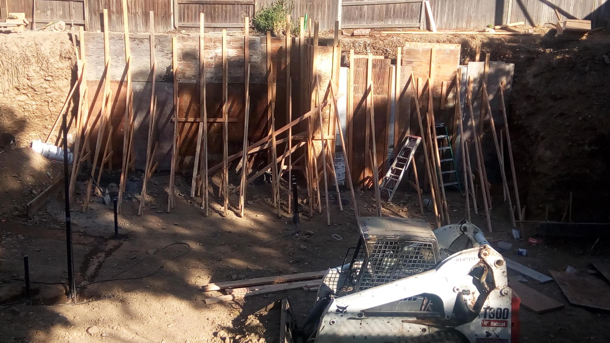

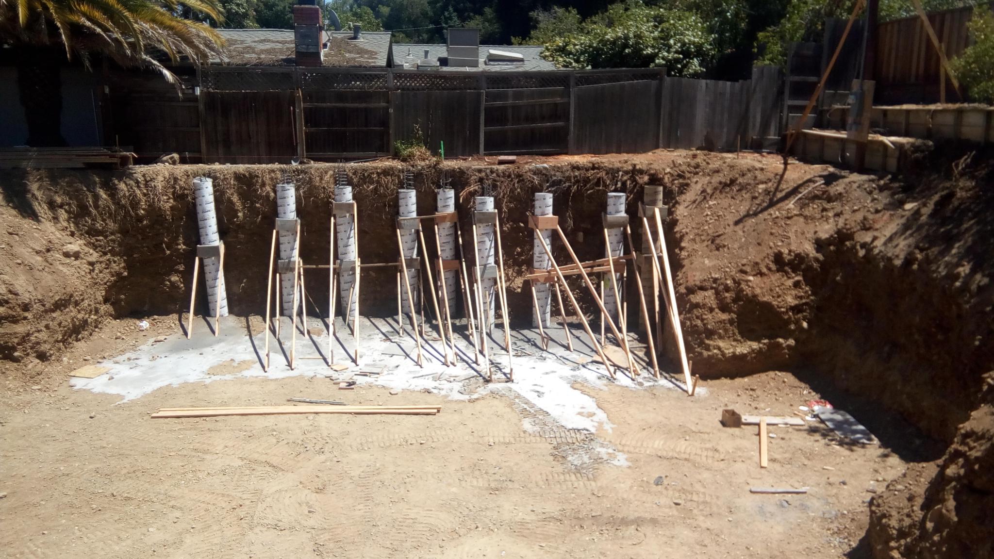

    Remember they were supposed to have drilled and cast piles to hold the hill back? Well, since they removed the dirt the piles were to be drilled through, why not just put them where they would have gone...sort of. Plumb is not something they understand.
    At this point the inspector came by, had a cow, fit, and several other bouts of attacks and put a STOP order on the job.

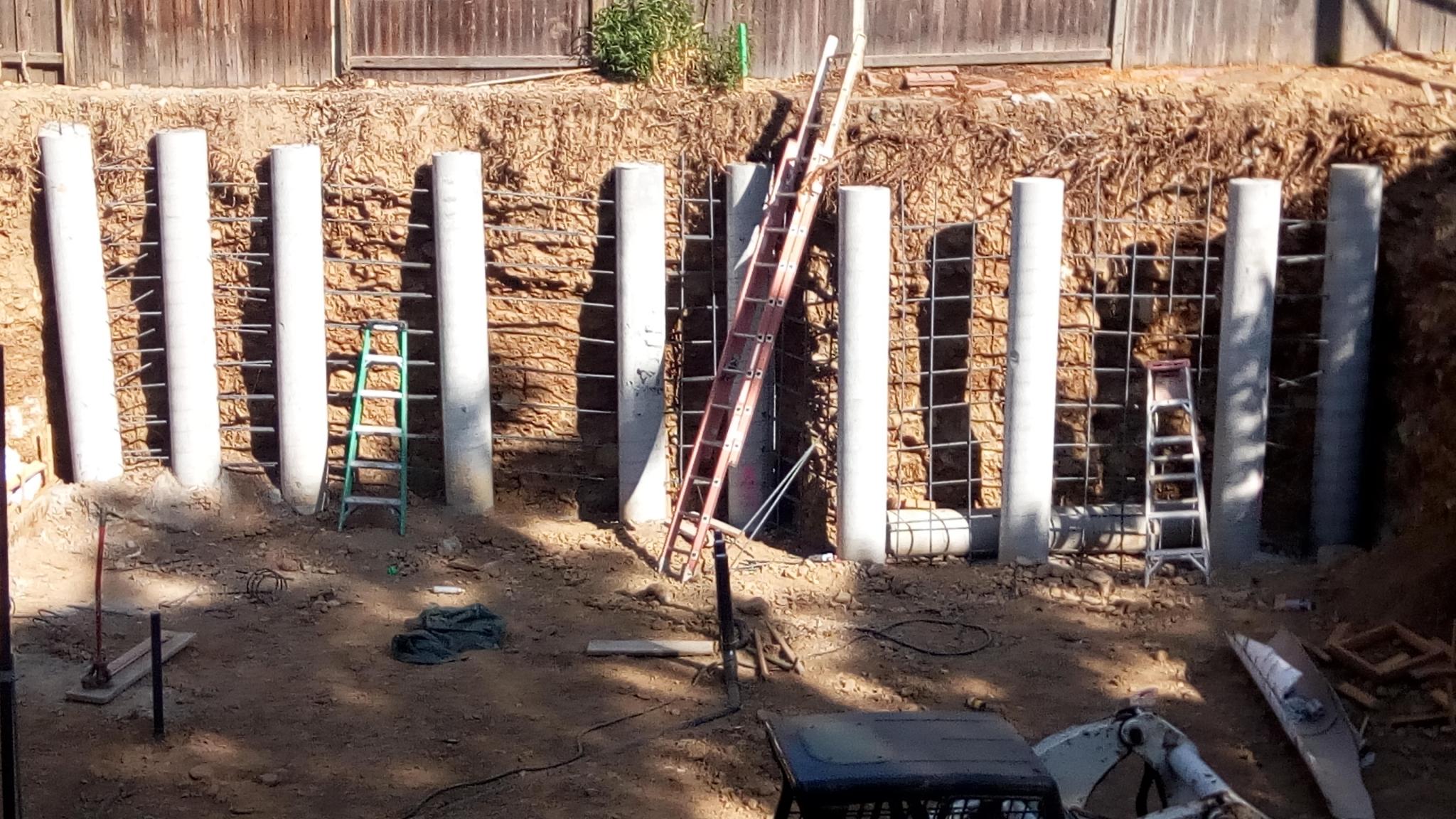

    A few days later an engineering firm truck showed up, the contractor showed him around, lots of pointing and measuring. They need to add in some sort of wall that makes the engineer happy.
    Columns peeled, more digging.

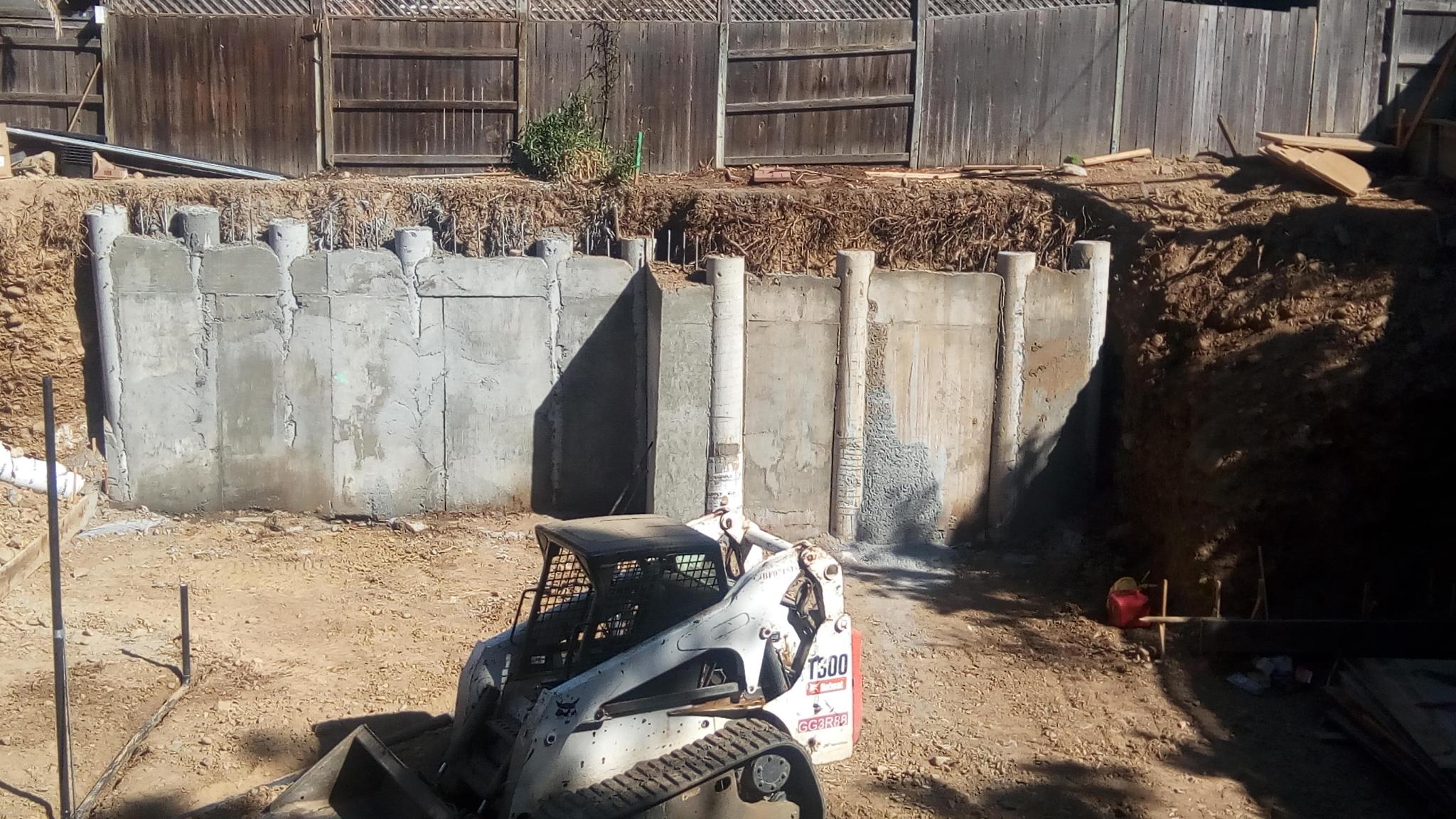

    Ok, not happy with that, they shaved off part of one of the columns
    Then cast the wall
    Then filled in the column they had cut the piece out of and scraped one panel of the wall with the excavator until...I don't know, they liked the looks.

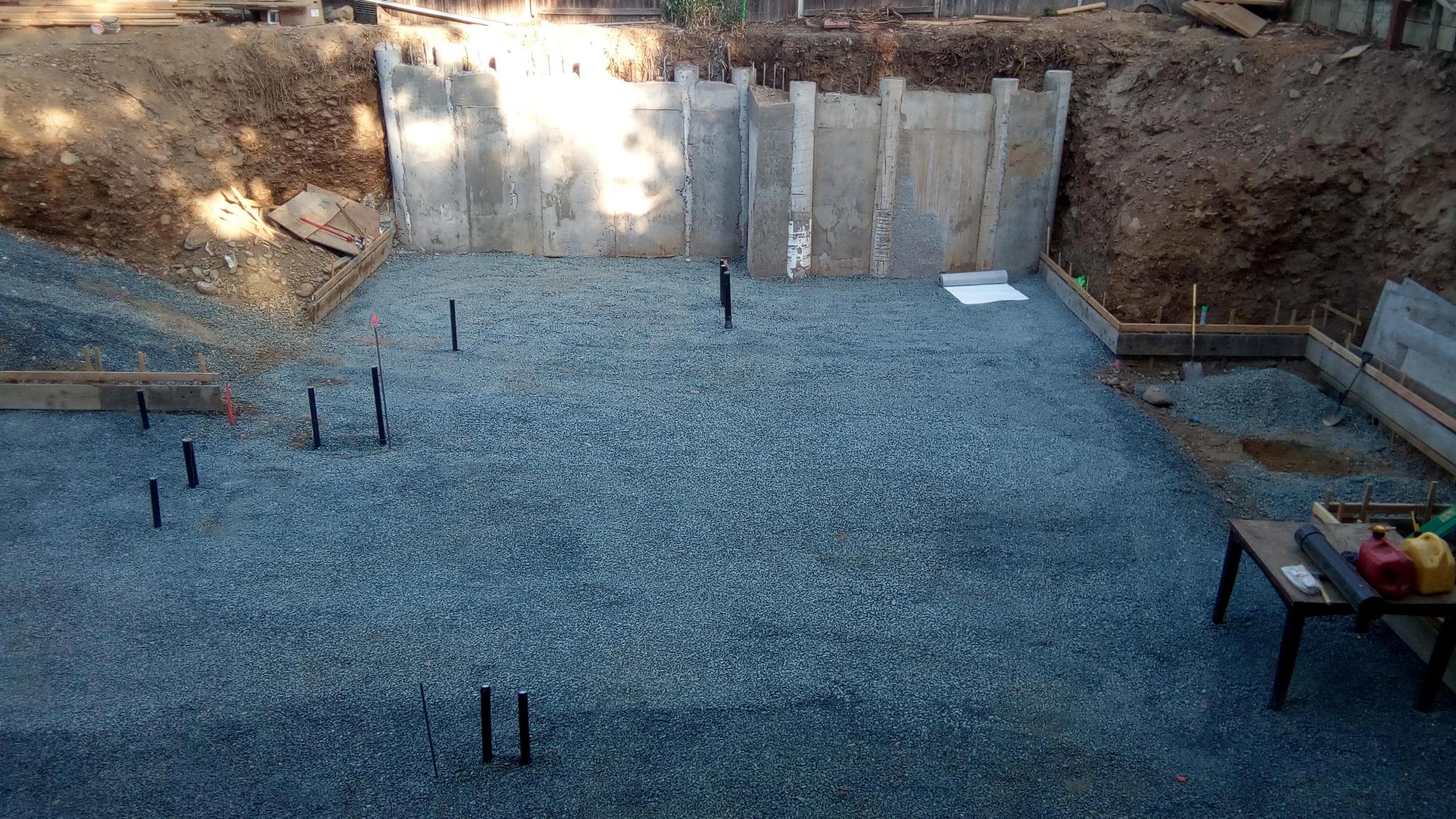

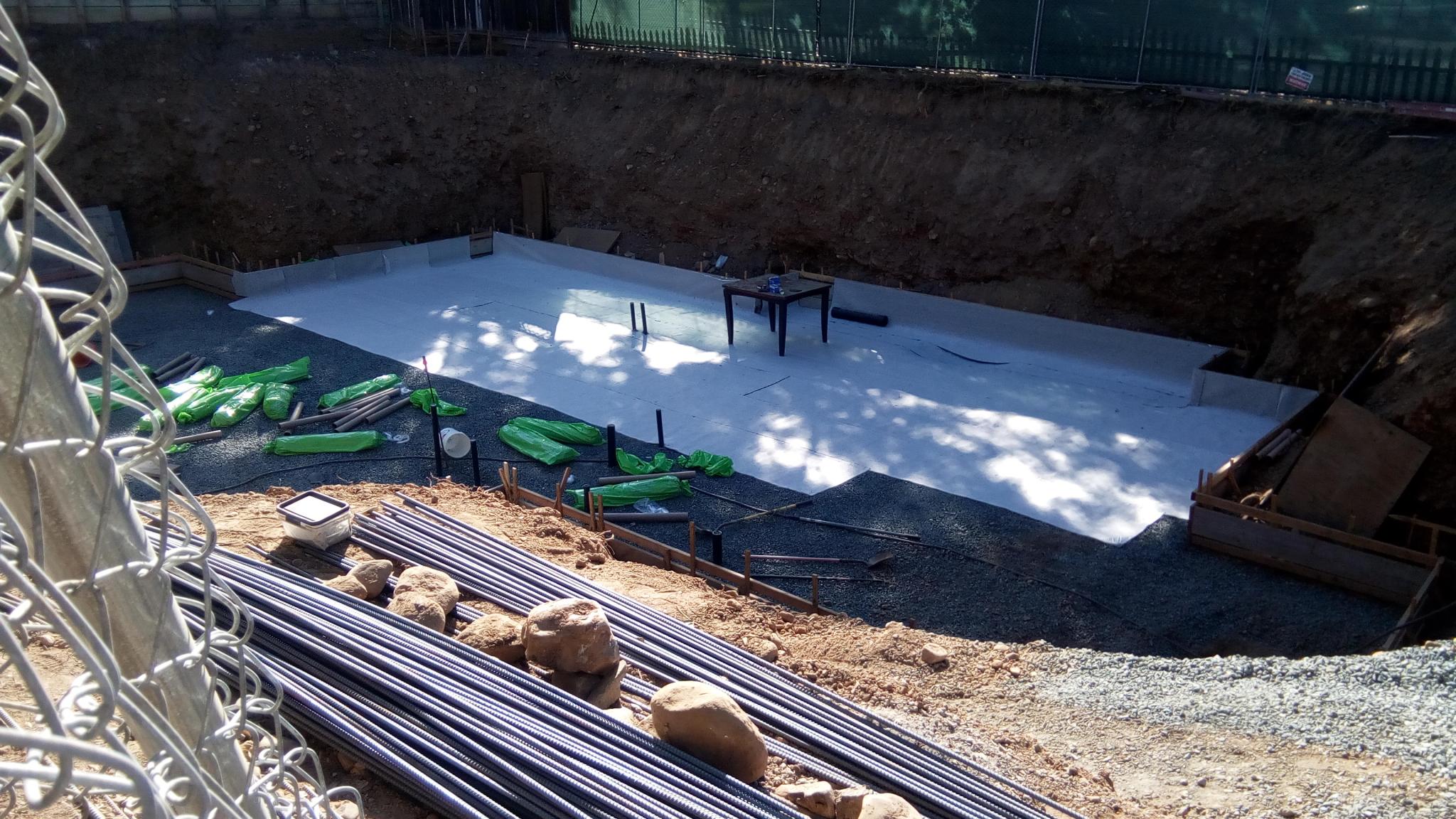

    In the last message you may notice they already have plumbing in, I couldn't believe they didn't drive over one of the pipes. Oh, these are also around 10 feet below the sewer main so I hope they have backup batteries planned for the pump.

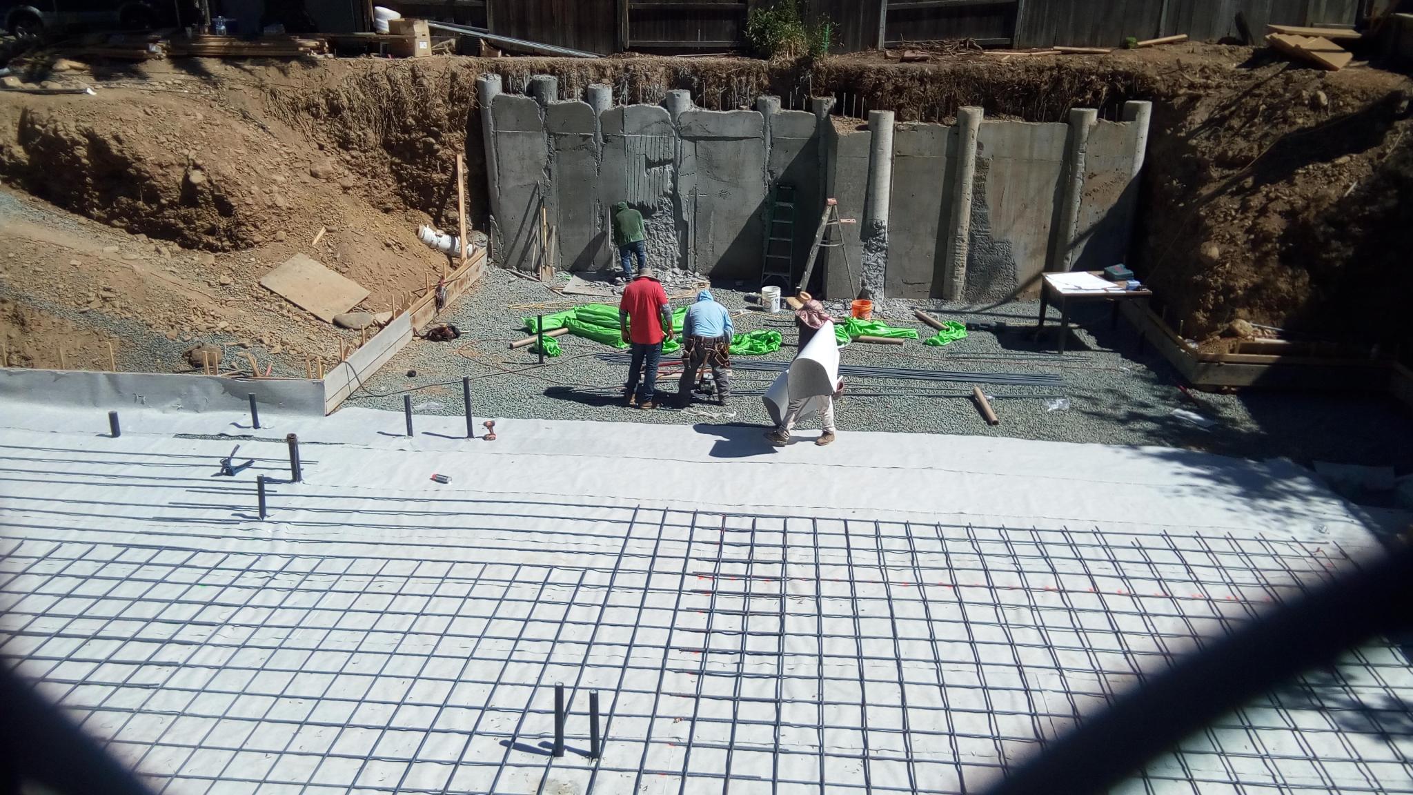

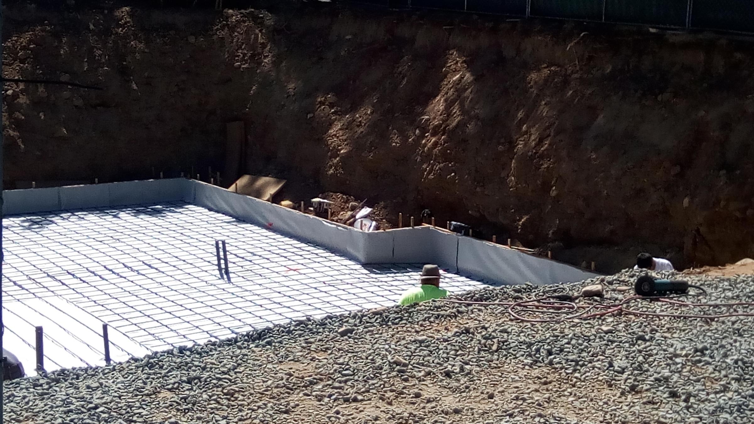

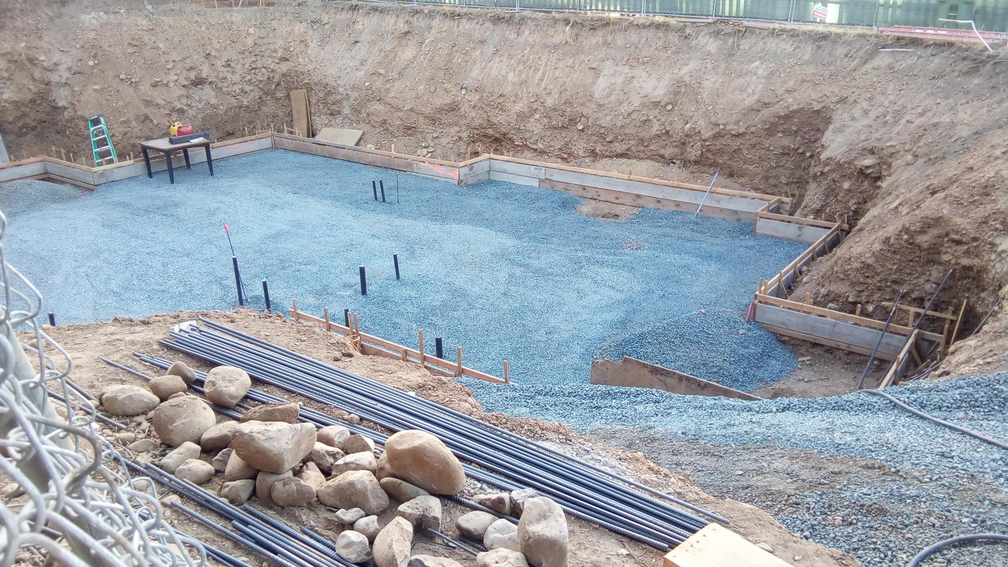

    Next they put down forms, gravel, and vapor barrier. Note that there's no hint of a foundation, apparently they're just doing a slab.
    We're not done yet!

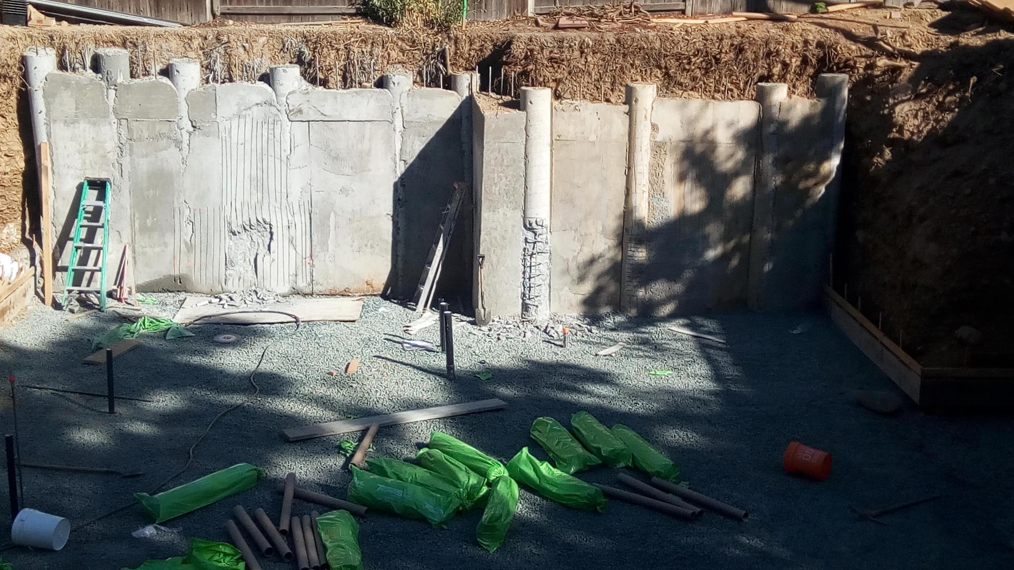

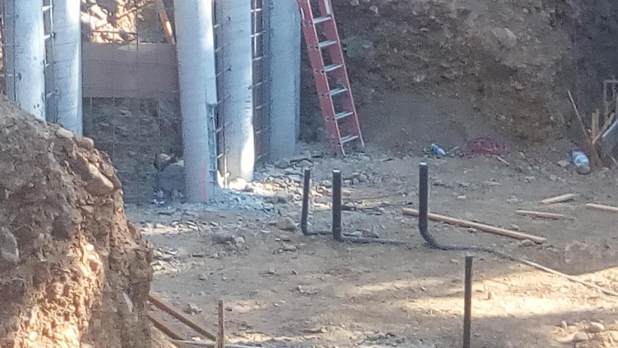

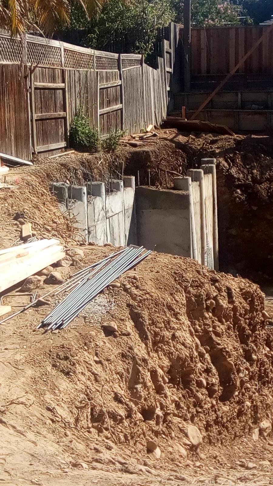

    Yesterday they spent all day sawing and jack hammering the wall. By the way, our chicken coop is directly above that green ladder against the other side of the fence. My office is slightly to the left of that.
    Note that the column that they had cut, then patched, has now been jack hammered more than the cut was.

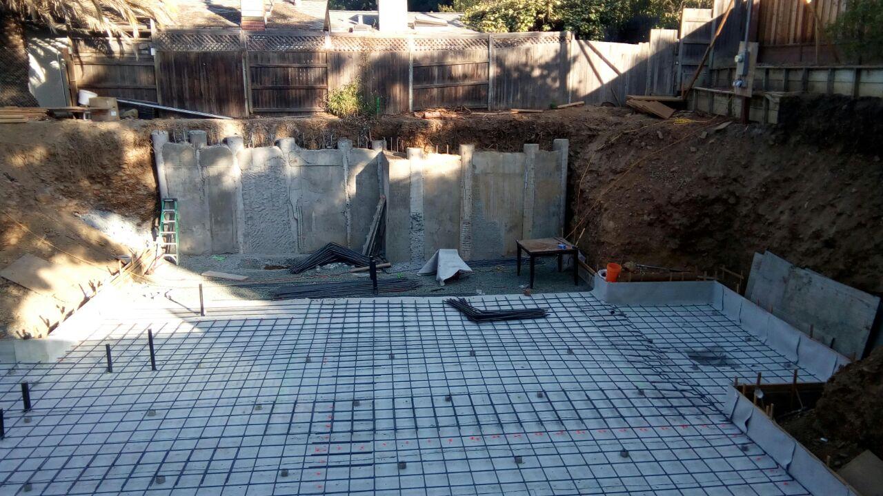

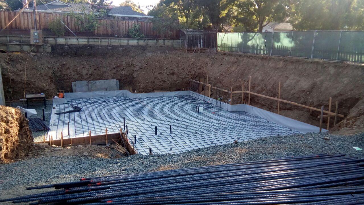

    they appear done carving on the wall
    The house next door...or how to NOT build a house-photo_2019-09-04_19-03-12.jpg
    The house next door...or how to NOT build a house-photo_2019-09-04_19-03-18.jpg

    jdurand's Tools

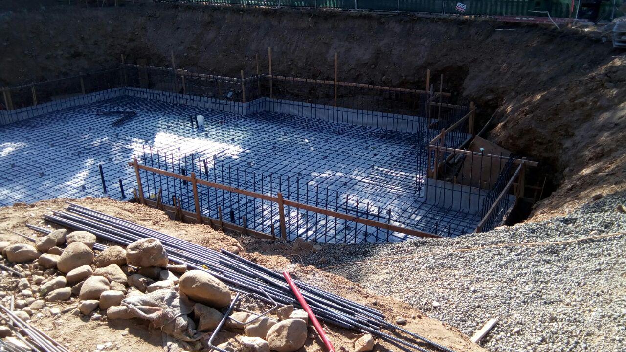

    They seem to be putting in the rebar for the foundation, but is the floor really going to be that thick or will they pour a thin floor and then build more forms to make the foundation on top of the floor? Several contractors I know wait for each day's pictures to try to figure out what these guys are doing.
    The house next door...or how to NOT build a house-photo_2019-09-05_17-04-29.jpg
  18. The Following 3 Users Say Thank You to jdurand For This Useful Post:
    Inner (Oct 24, 2019), rlm98253 (Oct 26, 2019), shopandmath (Sep 12, 2019)
  19. #10
    11,634
    2,185
    If I had to make a guess I'd say they are going to pour a unitized floor foundation and basement walls.
    I would hope they pour the floor then set the forms for the wall/ foundation wait a few days for some curing to take effect then pour the walls.
    I've seen contractors try to make a pour of the walls and floor all at once but that hardly ever turns out well.
