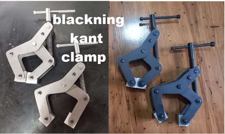

    I made a couple of clamps and gave it a black oxidized finish, similar to those made on firearms.
    I hope you enjoy the video
    Greetings from Brazil
    Celso Ari

    what is the purpose of the 24 hour wait after oiling (other than to stop people "looking at it" and accidently wiping the oil away?)
    just curious

    Quote Originally Posted by desbromilow View Post
    just curious
    I believe it is a type of pH neutralization

    It may be what celsoari said, but I have an idea it could be to prevent oxidation while the coating has a chance to fully cure and harden, which goes right along with his comment
