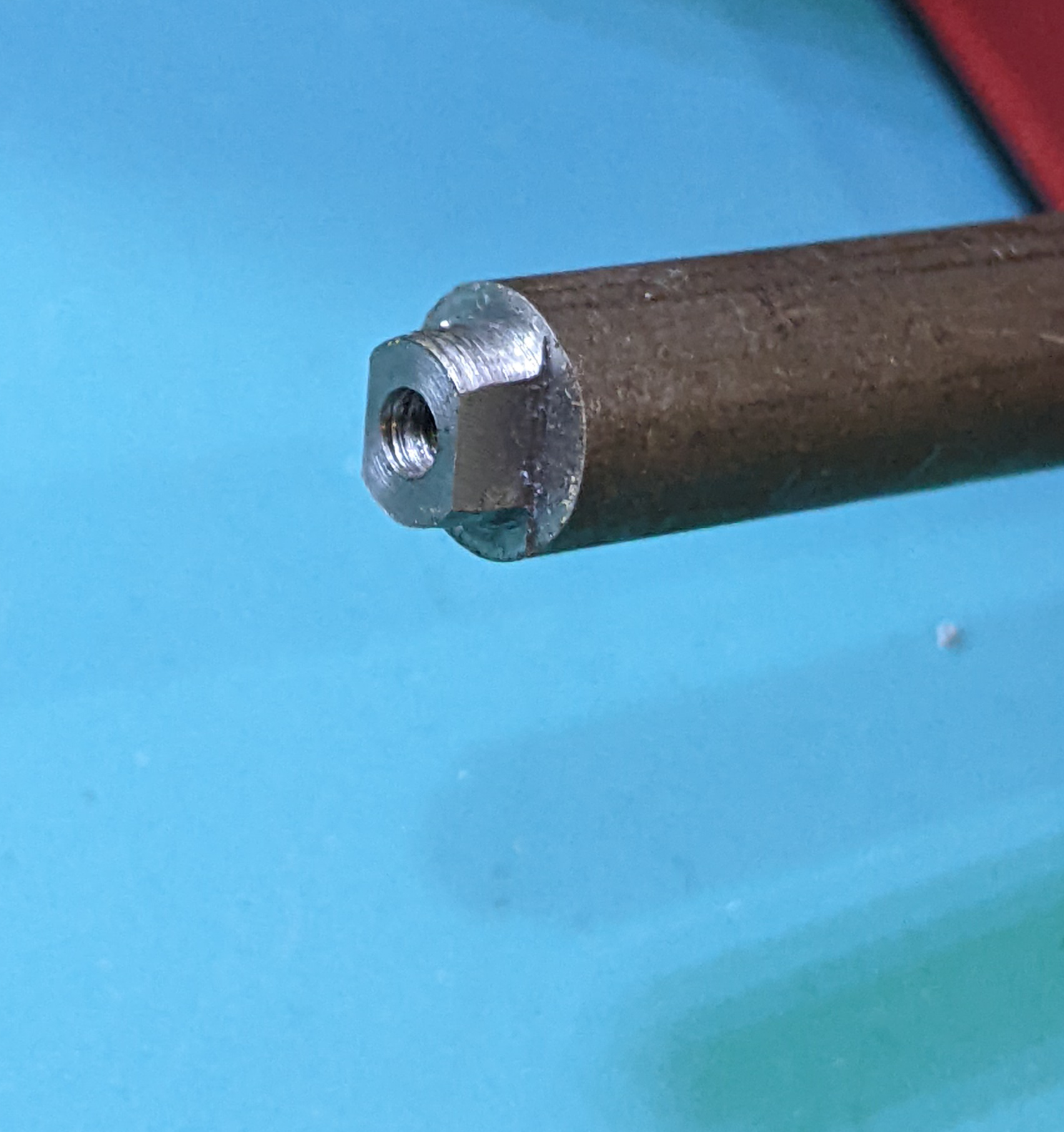

    I made a mandrel that resembles the actuating stem of the ball. That was easy peasy, 5 minutes at the lathe and 5 minutes at the mill. Quick ‘n dirty. It only needed to work once.

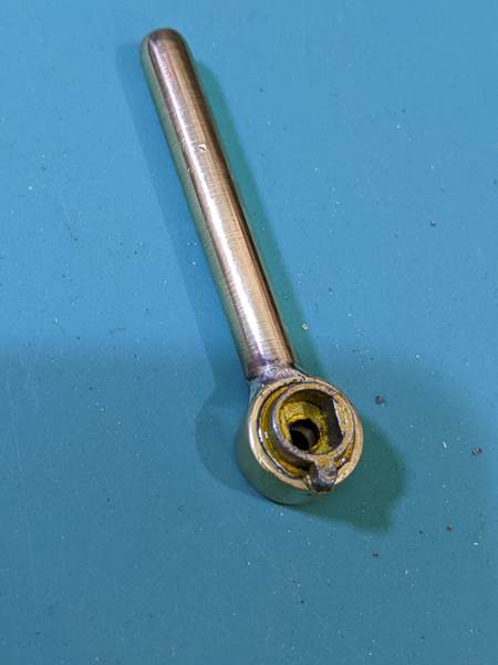

    I put what was left of the actuating thing on the mandrel, chucked it up in the lathe and machined off pot metal until all that was left was a round cylinder above the part with the radially protuberant tit that limits rotation to 90 degrees. Then I machined a brass cap from a bit of 3/8” brass bar stock, making a lathe-bored cavity about 0.0015” smaller than the pot metal valve part. I silver-brazed a bit of ¼” rod to the brass cap to serve as an operating lever, and then I pressed them together in the Kurt mill vise that can exert at least a ton of force while keeping faces parallel. The part in the middle looks like brass but it isn’t; it’s brass-plated pot metal.
    I dabbed a bit of Loctite 609 (the green stuff) on it before assembly but I doubt that it’ll make any difference. It probably all got squeezed out.

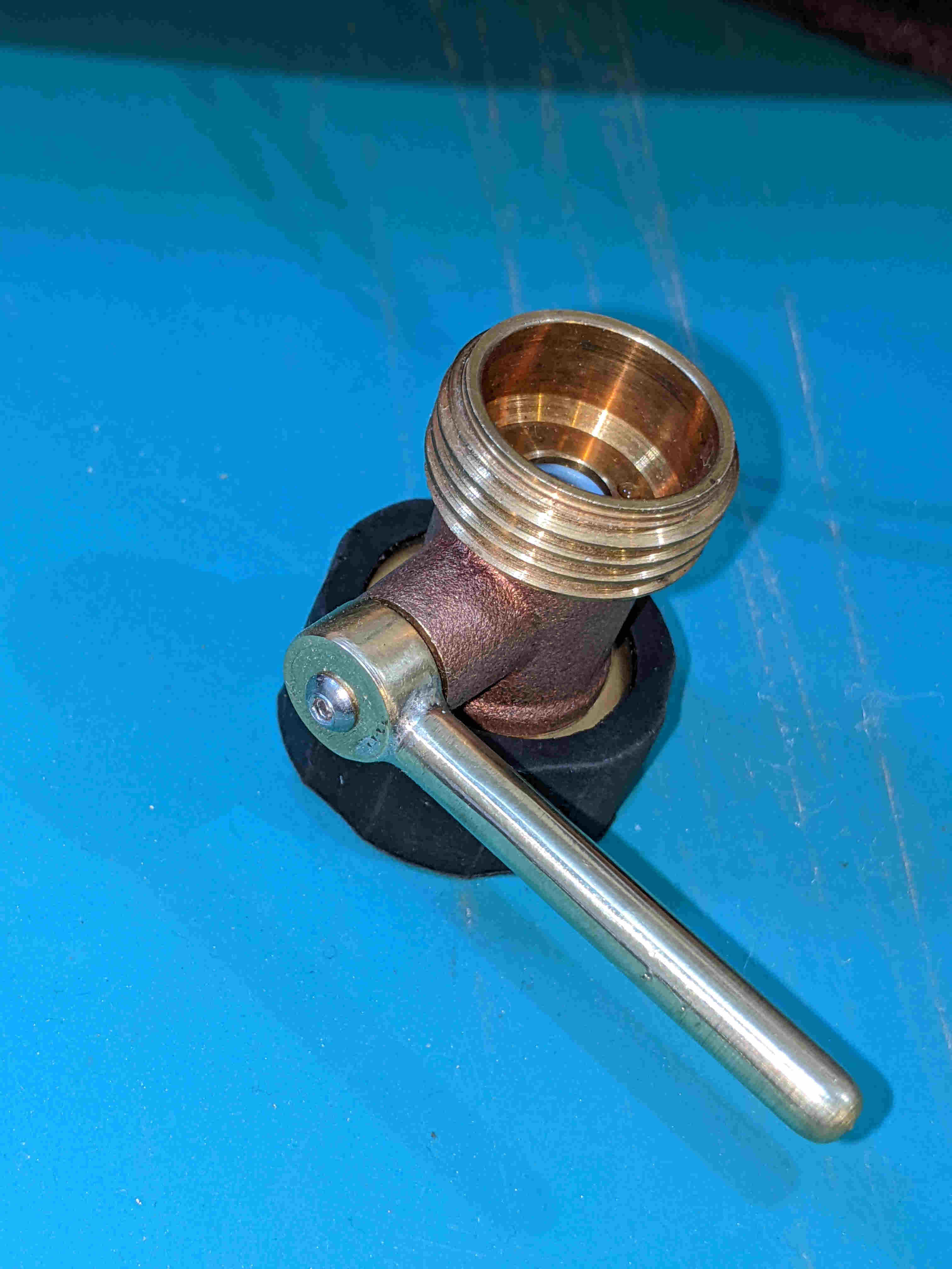

    I reassembled it to the valve with a stainless M3 x 0.5 mm metric button-head machine screw and voila: ready to go to work hosing off the fish-cleaning table at da laaaake. It’s very easy to operate without getting hurty fingers. I hate getting hurty fingers.
    The joint is just a butt joint. I made a concave curved face on the end of the rod with a ½” end mill, butted the brass parts together at the bench and silver-brazed them. The rod would bend before the joint would fail. A good silver-brazed joint can be stronger than the parent metal. And besides, ya can’t weld brass but silver brazing works very well.
    These garden hose ball valves are not forever. This isn’t the first one I’ve modified, or the second. They last for a few years and then they start to leak so need to be replaced.
