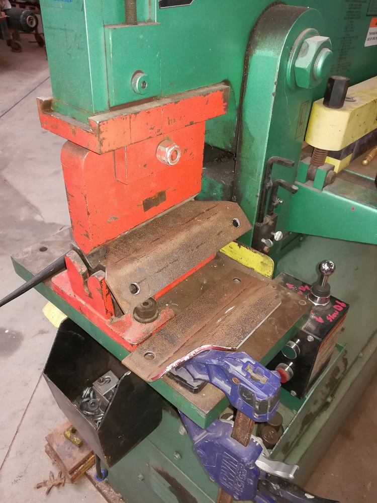

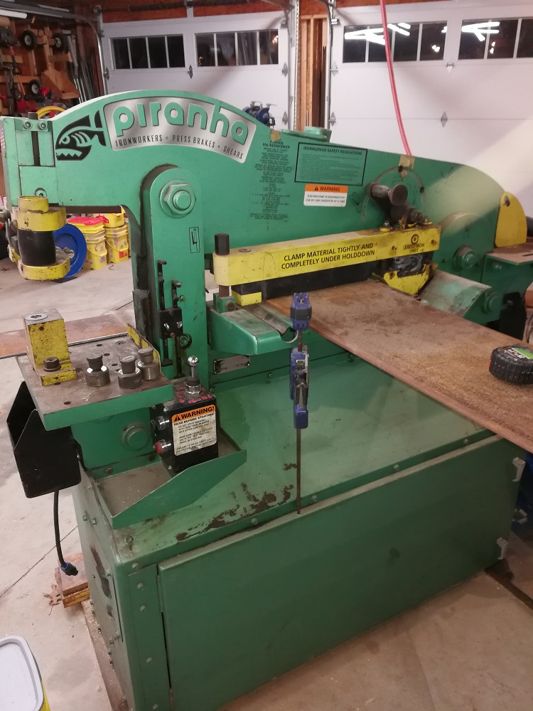

    The first step was to shear out some pieces of steel on the Piranha Iron Worker. Luckily I had some steel left over from another project.

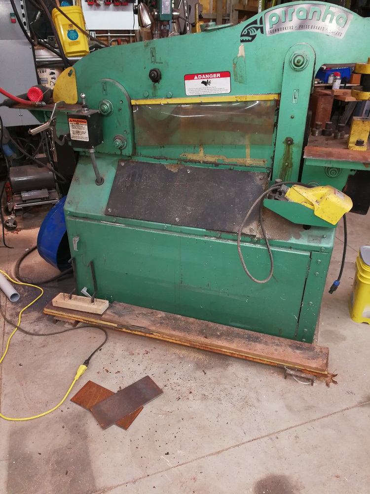

    Then I punched some holes and changed out to the press brake. I bent the two offset flanges.

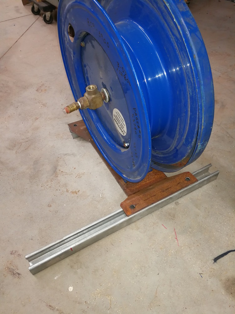

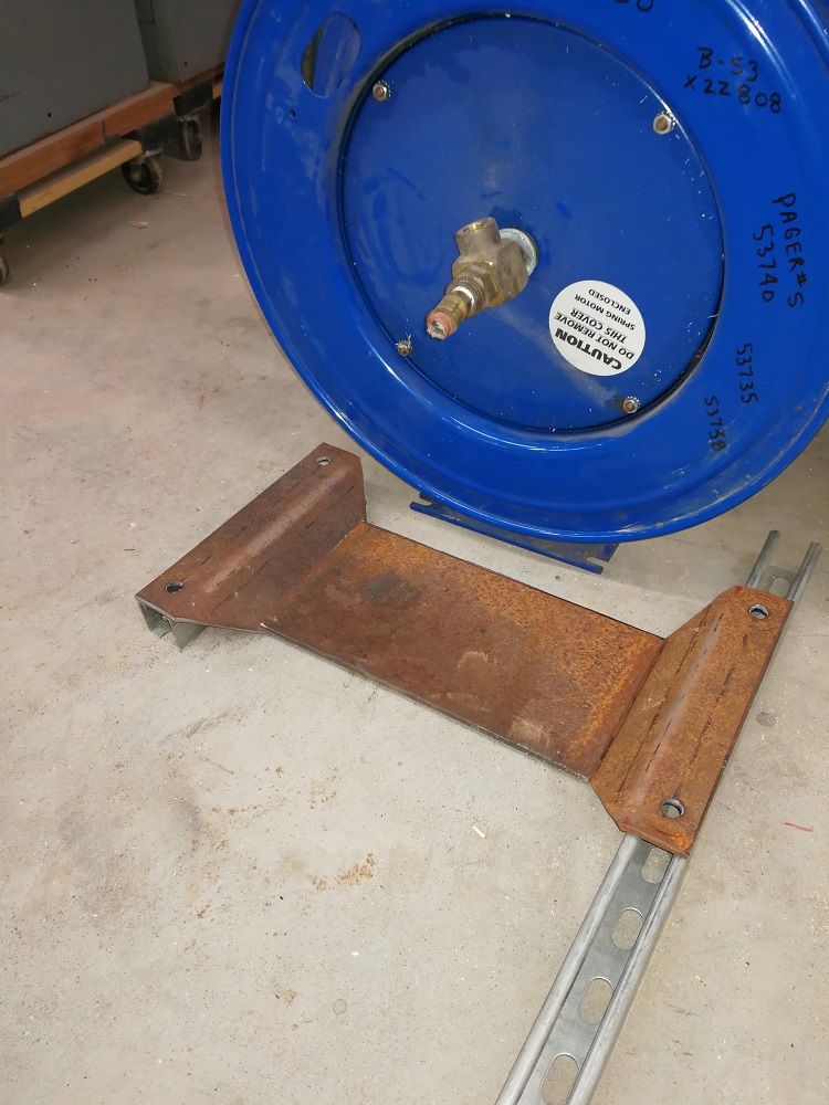

    Time for a check of how it was progressing:
    Hose Reel Mounting Bracket -- Tight Clearance-blue-hose-reel-installation-dec-2017-4-.jpg
    Hose Reel Mounting Bracket -- Tight Clearance-blue-hose-reel-installation-dec-2017-5-.jpg
