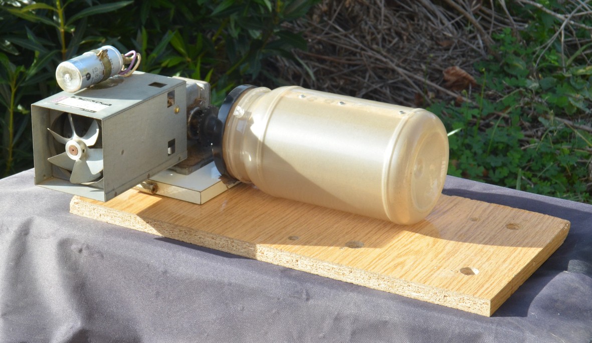

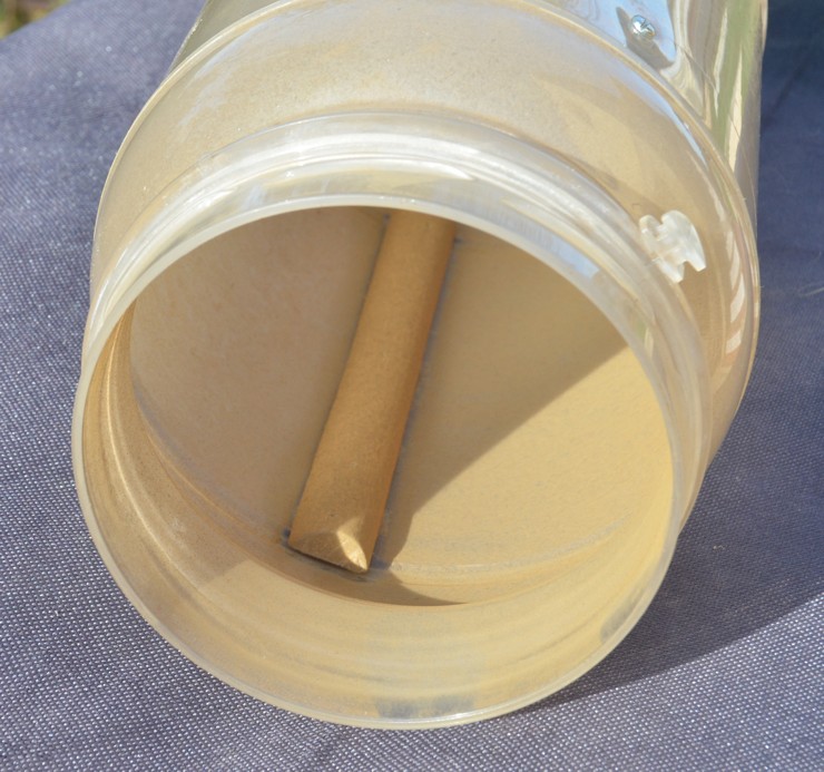

    I recently had to make a trip to the US. Usually on my way back to an airport I stop off at a Horror Fright store and top up my luggage allowance. However, past trips had pretty much exhausted my needs of stuff small enough for luggage and so I bought one of these
    https://www.harborfreight.com/5-lb-m...ler-67617.html
    and https://www.harborfreight.com/540-lb...dia-63673.html
    and https://www.harborfreight.com/520-lb...dia-63672.html
    I also tried some sharp sand and some glass beads.
    I feel that I had wasted my money. It is useless. Against the wisdom of the instructions I tried the bought media with water. That worked a little better but still very poorly.
    I am seeking suggestions for improvement. Mods to the machine or different media.

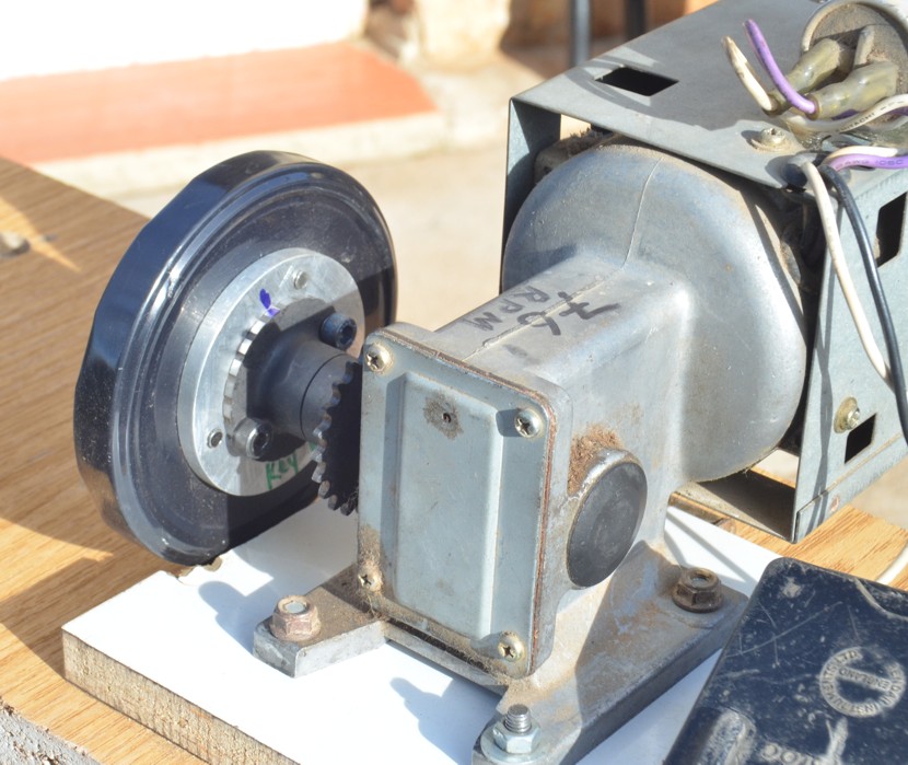

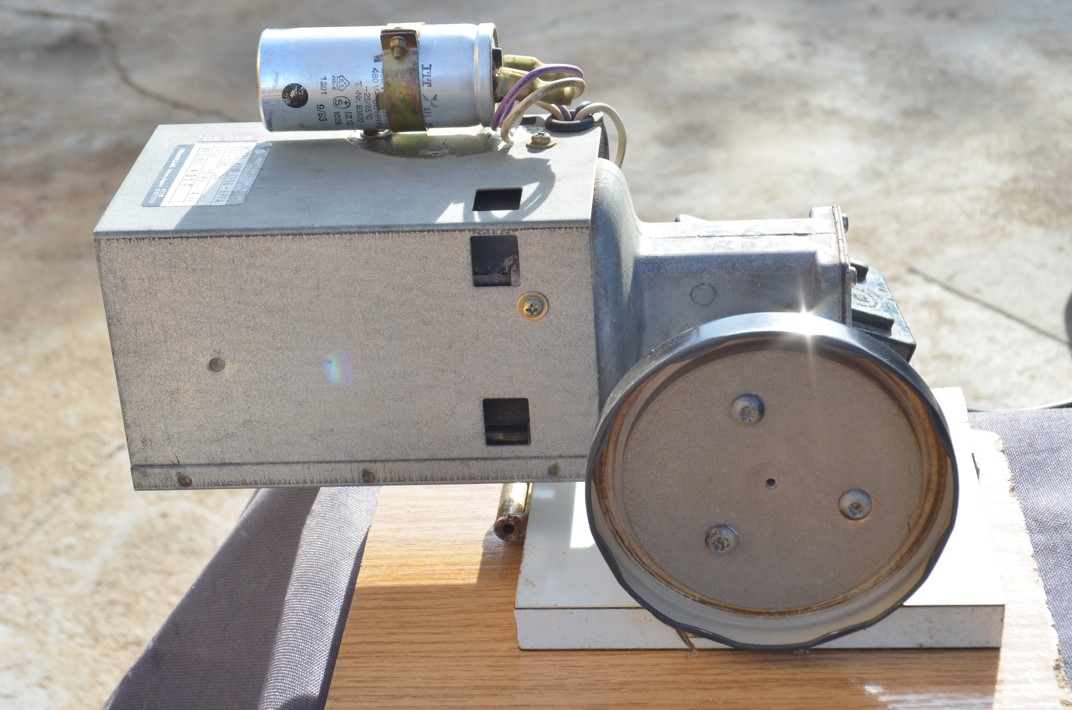

    PS. A while back I built a very Q&D rotating tumbler using a 75 rpm motor and gearbox from an old photocopier and that works so much better.
    Horror Fright vibrating tumbler-tumbler-01.jpg Horror Fright vibrating tumbler-tumbler-02.jpg Click images for full size.
    Horror Fright vibrating tumbler-tumbler-04.jpg Horror Fright vibrating tumbler-tumbler-05.jpg

    Hi Tony, I built a similar setup to your tumbler using a geared DC motor, it is dismantled at present after moving house. Like yours it works very well for preparing original fastenings prior to plating.
    I have tried all sorts of media from silica sand for a polish to washed coarse sand and even fine shingle. Being only 400 yards from the beach I am spoilt for choice for free supply. If its for deburring of machined parts you may find a local powder coating shop for some blast media which could work in a tumbler.

    This morning I loaded the HF unit and my Q&D rotary machine with the same weight of pyramid shaped media, a small amount of water and detergent. I added the same weight of components in each. Within one hour the stuff in the rotary tumbler had been deburred nicely and needed no more. It is now ten hours later and the HF unit is nowhere near the same results.
