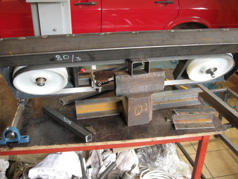

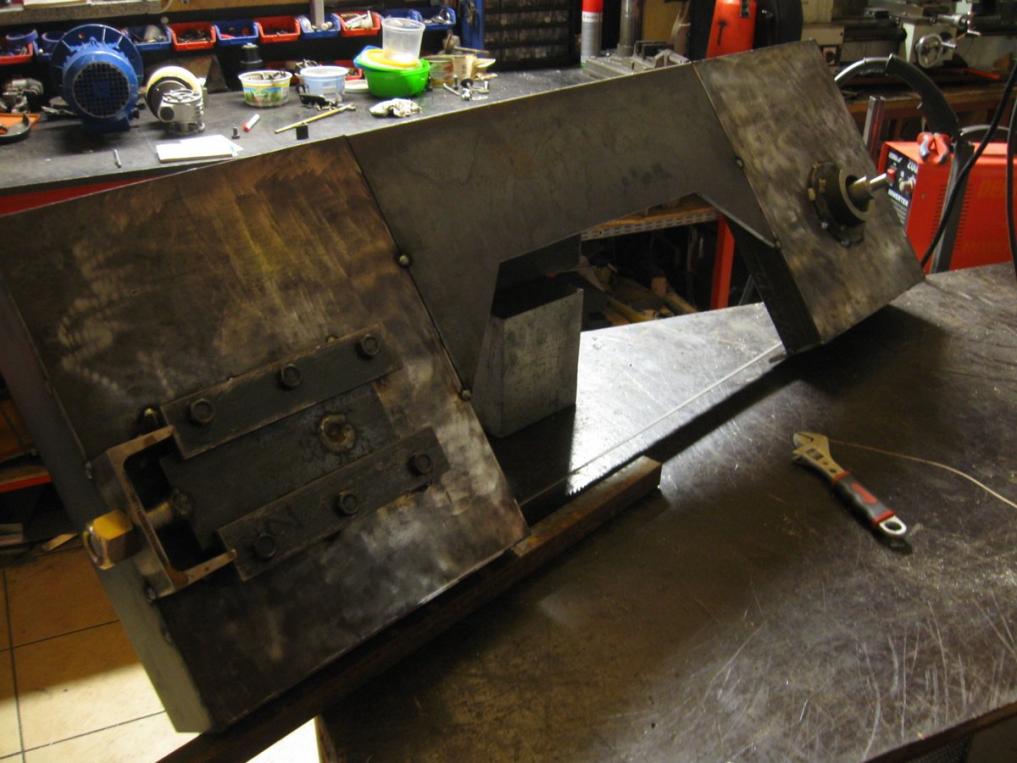

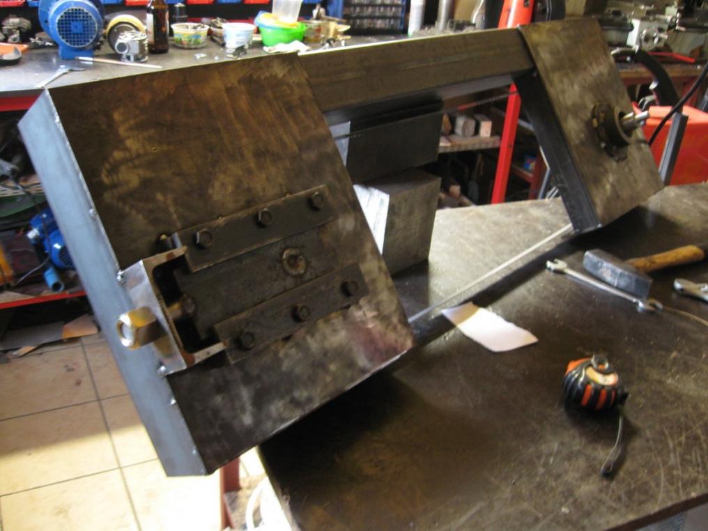

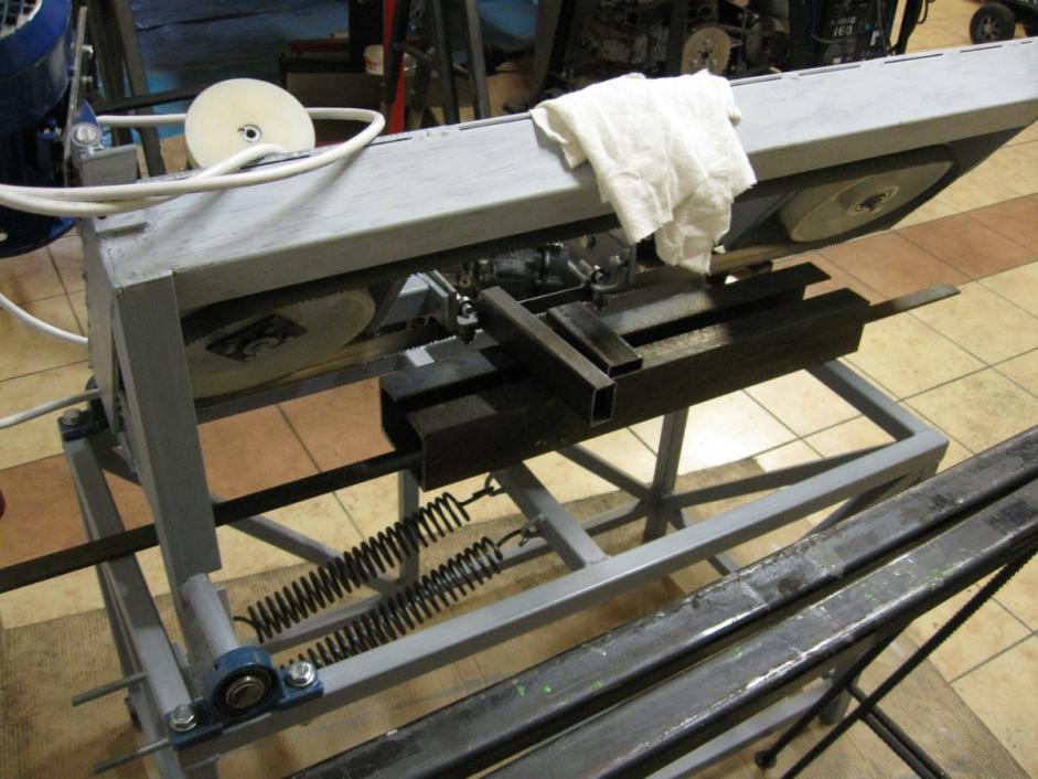

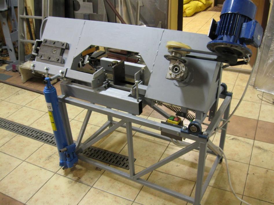

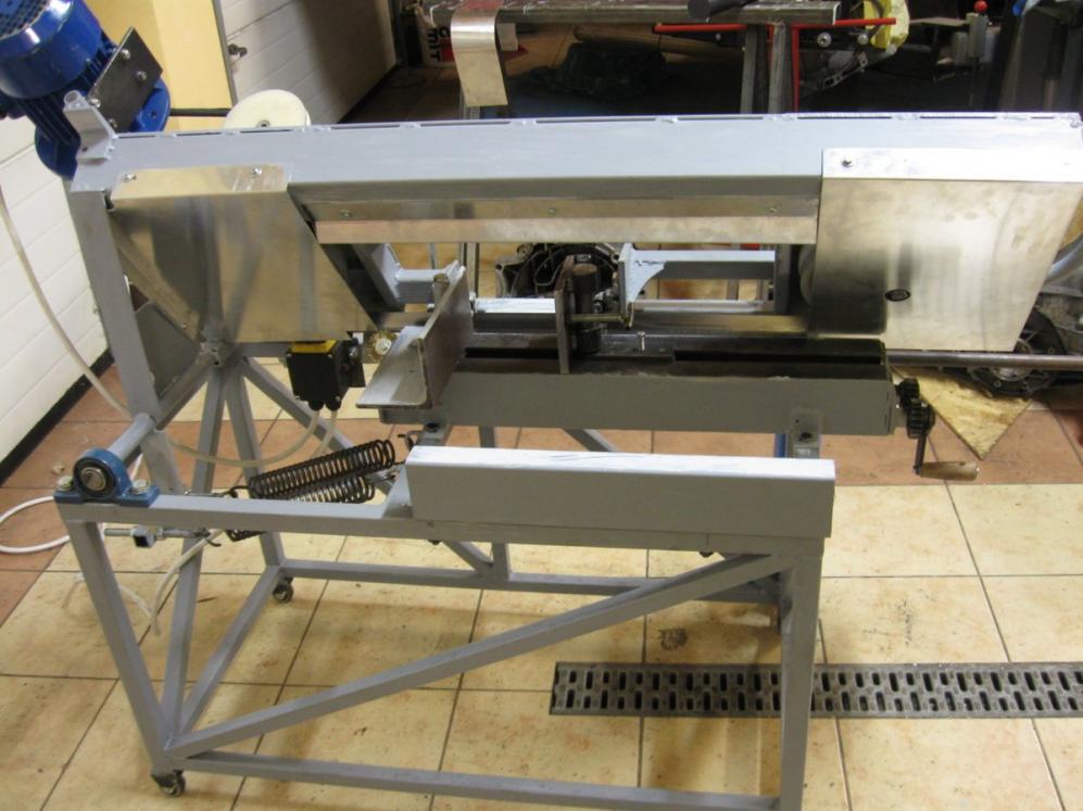

    This is my horizontal bandsaw for cutting metal

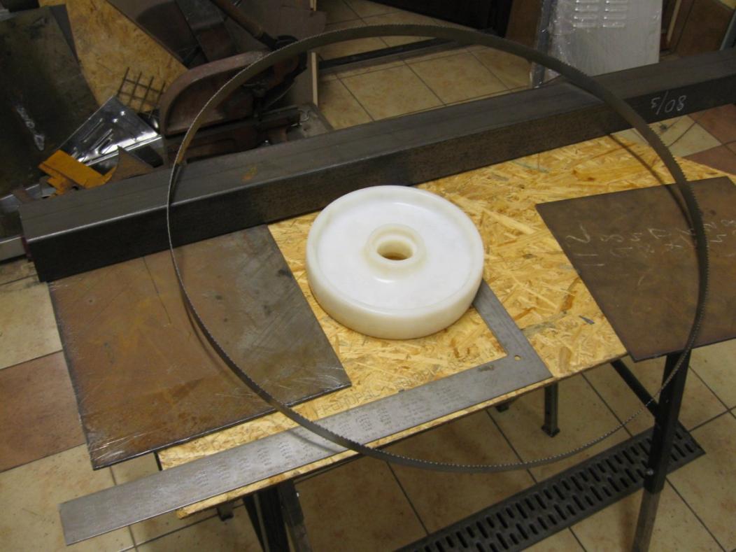

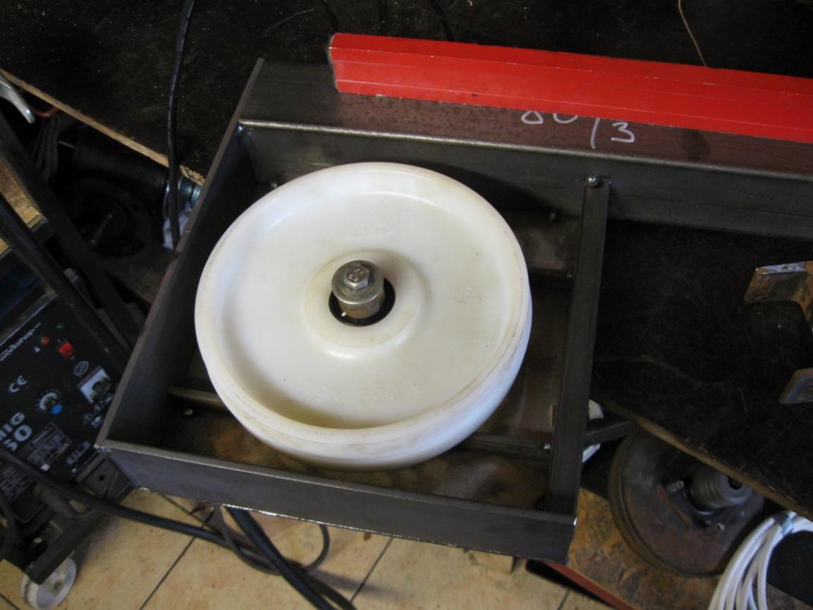

    I used 250mm (10inch) polyamide (nylon) wheels because it was easier and cheaper to obtain and fabricate, (they needed to be turned on the lathe anyway)
    I was going to make a whole hydraulic installation like in a commercially made bandsaw but then I tried this jack from my engine hoist and that's how it actually remained to this day
    cutting capacity 190mm round or 300x125mm box

    Nicely done radom. What motor did you use?
  7. #6
    Feb 2013
    Poland
    4
    Thanked 5 Times in 2 Posts
    radom's Tools
    thanks,
    motor is 3phase 0,55kw (3/4hp) 920rpm
    with v-belt pulleys and 1:10 worm drive blade speed is either 70m/min or 35m/min

    The use of the engine hoist cylinder is a great alternative to what you originally planned.
