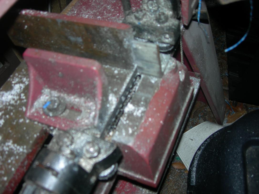

    I have a set of milling clamps but hadn't thought of using them on saw. I did fit a 'zero clearance' extension to the outside of vice block so cutting short pieces is safer

    Here's fuzzy pic of the piece of angle I bolted to bandsaw to support thin material. Still need packing on 'back end' of vice when material doesn't reach to pivot bolt though.
    I butted it against edge of back plate then used saw blade to cut the 'zero clearance' slot.
    Swarf drops through underneath, even the plexiglass I just cut
