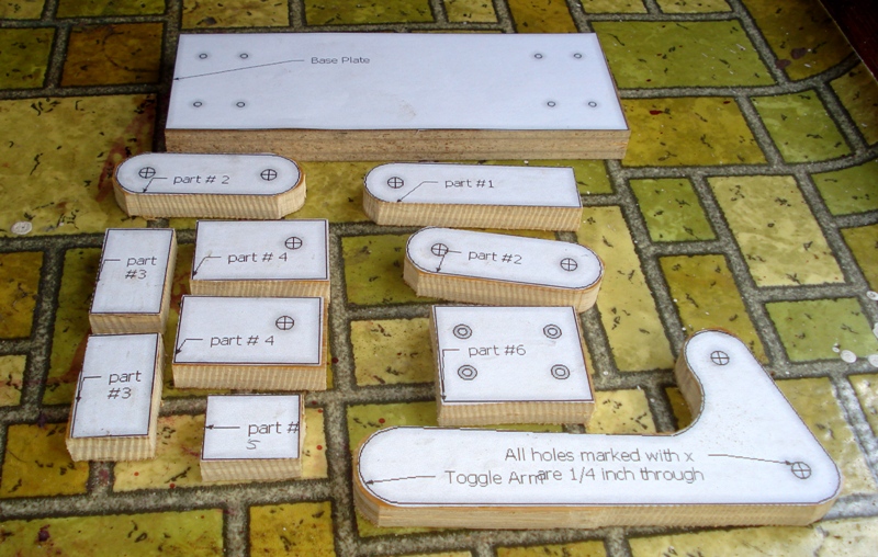

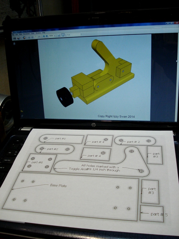

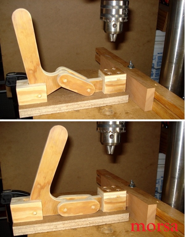

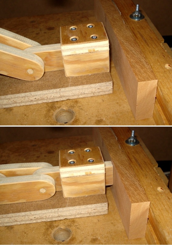

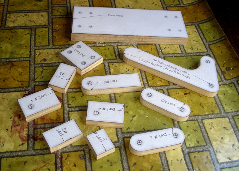

    Alike the http://www.homemadetools.net/forum/h...zzy-swan-52833, this horizontal action toggle clamp is based in a model by Izzy Swan. You can also download the plans for free.
