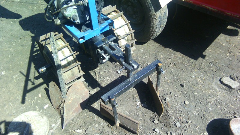

    Produced equipment for planting potatoes.
