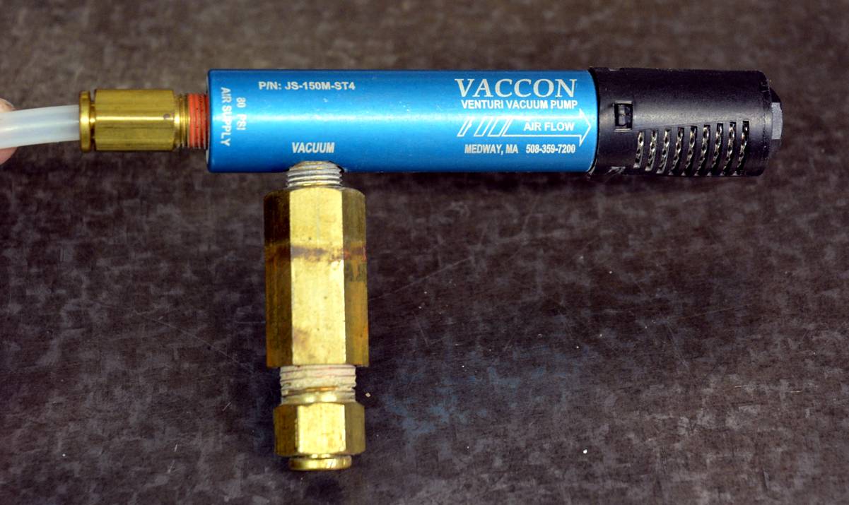

    Hmmm, running a vacuum port [eductor] hadn't occurred to me. The multiple pumps address volume in what seem economical fashion....Thinking now to pull it down with venturi [a little harder to control], and maintain it with a pump.
    Here is my venturi thingy.

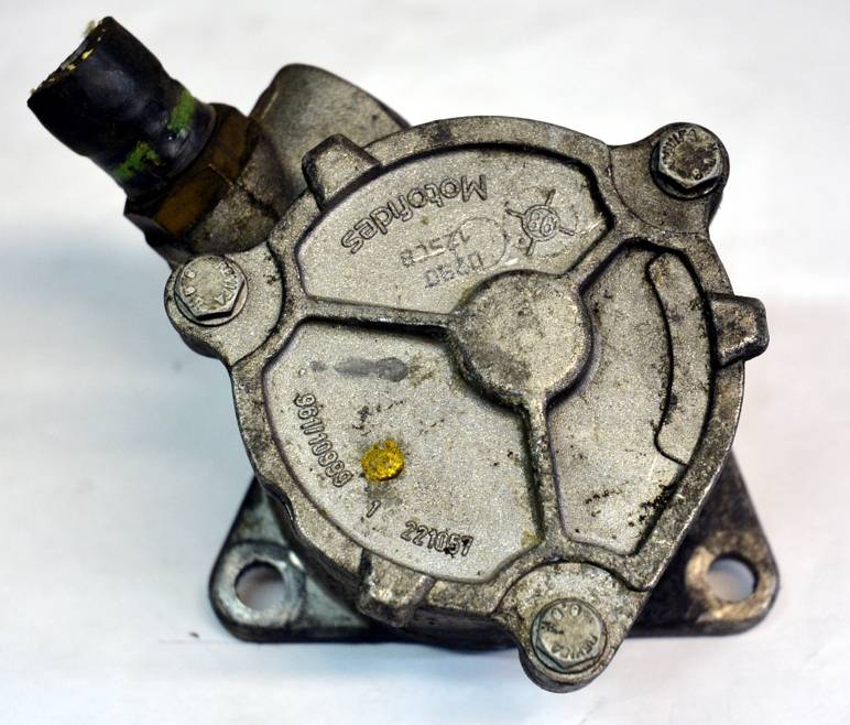

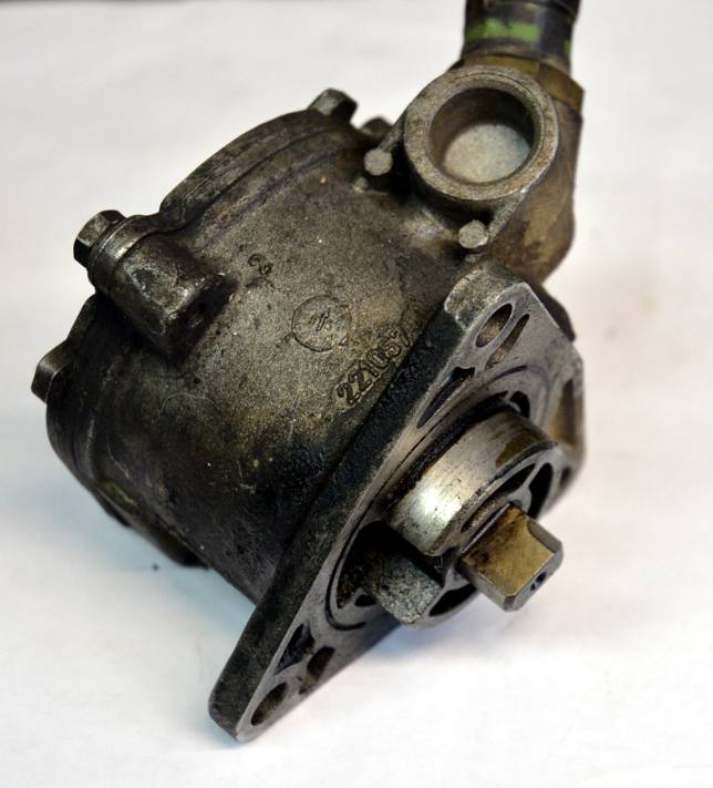

    Here is the power brake vacumn pump to compensate for the lack of manifold vacumn in diesel engines. This was driven off the end of the camshaft, so around 3000 rpm should work really well. They have a good flow rate and suction but I have no real data.
    Homemade Vacuum Pump-vacumn-pump-02.jpg Homemade Vacuum Pump-vacumn-pump-01.jpg
