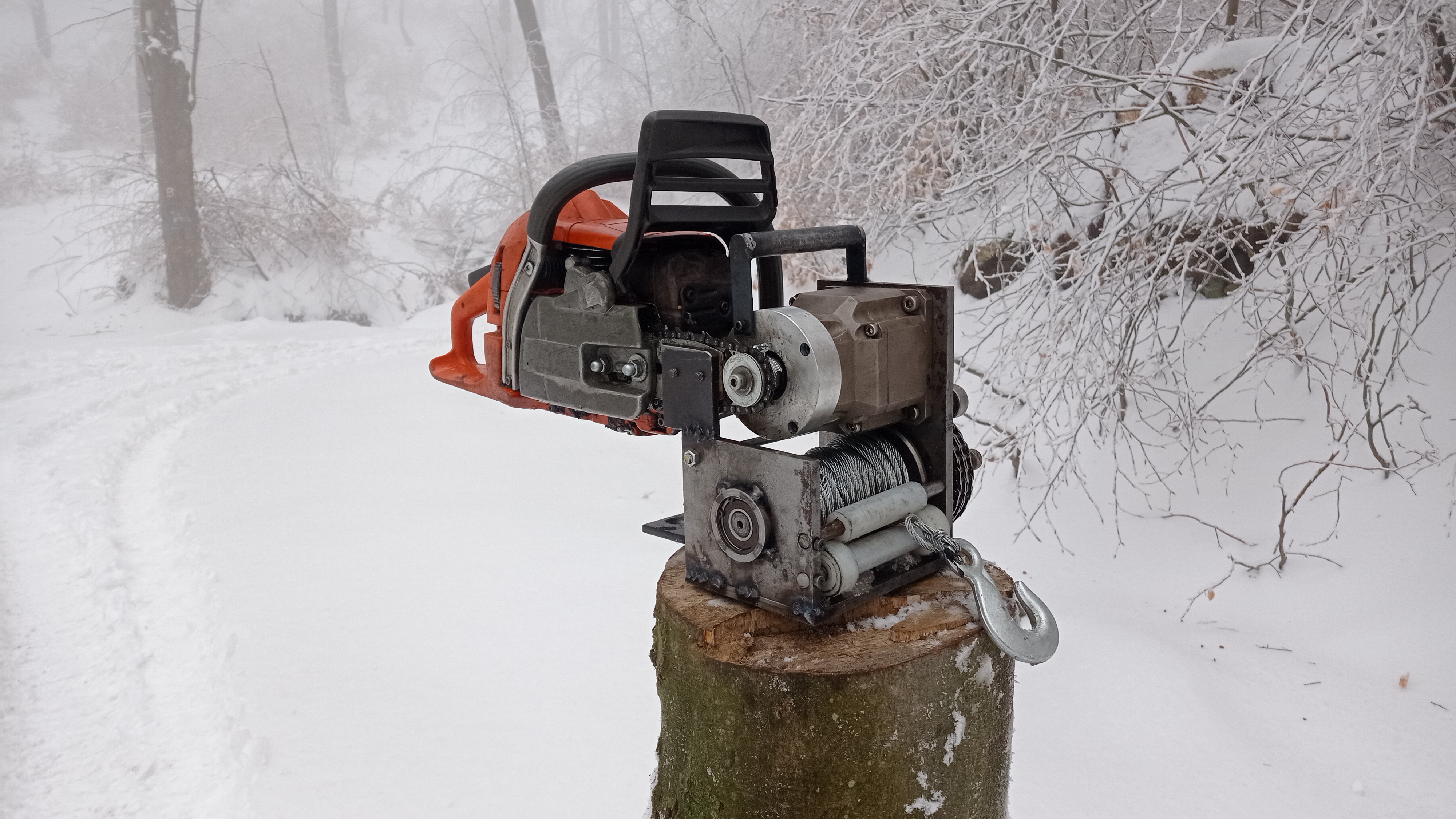

    Hi. Me and dad built a winch for a chainsaw.We built it in our small workshop using a lot of tools and machines.The project is our authorship.We came up with the idea when we had to pull wood from a small dense forest into which a tractor is not allowed.The winch is very simple, it consists of:
    - winch drum
    - Basics
    - Planetary gear
    - Chain saw drive.
    We made everything from metal, the whole thing with the chainsaw weighs about 20 kg.
    Sprockets and chain - bmw timing.Winch Drum Clutch - Homemade - Claw Clutch - On - Off.The winch has a lot of power and does the job.I use it to pull trees from small forests.A video of me building a winch. I invite you
