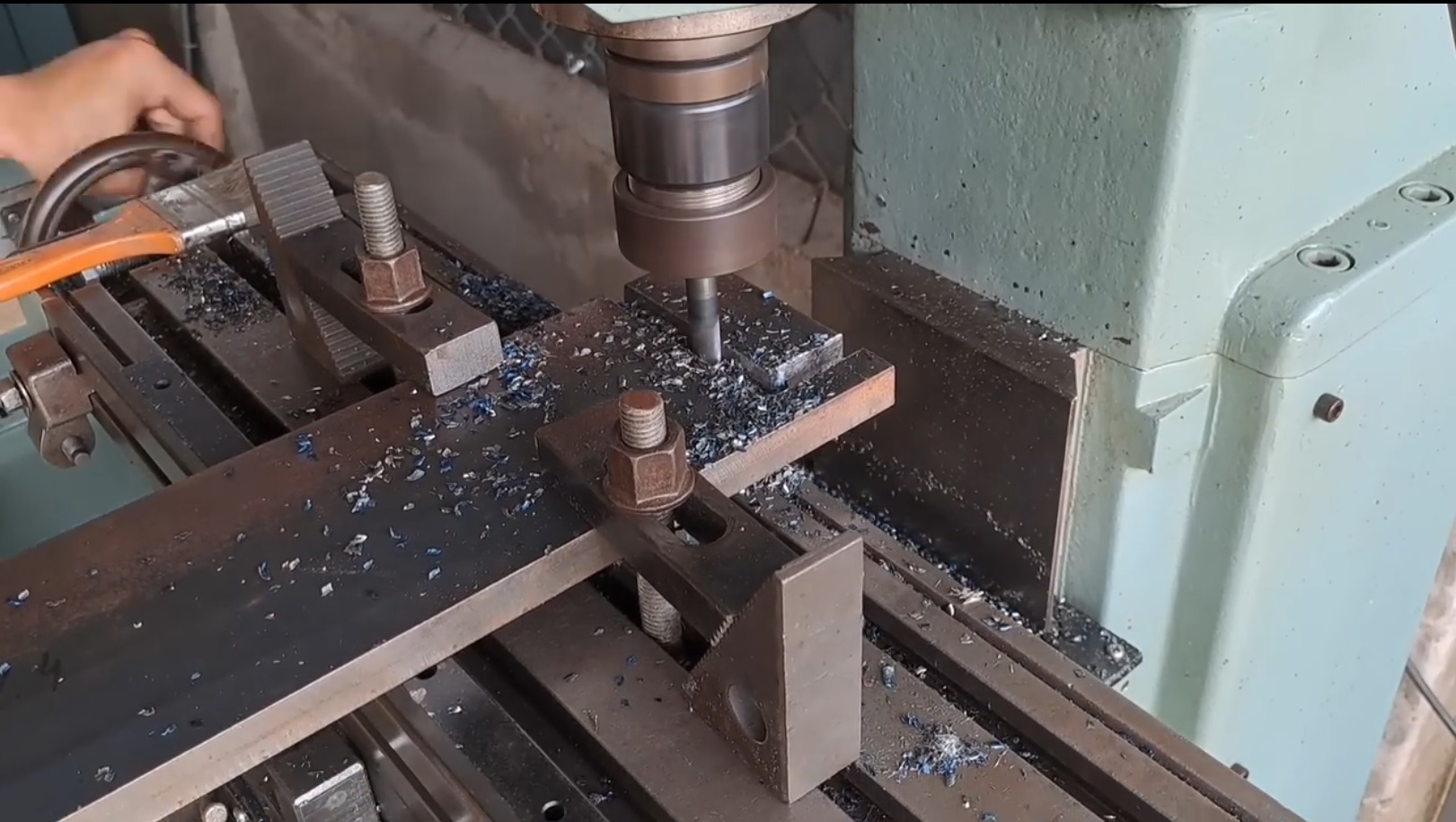

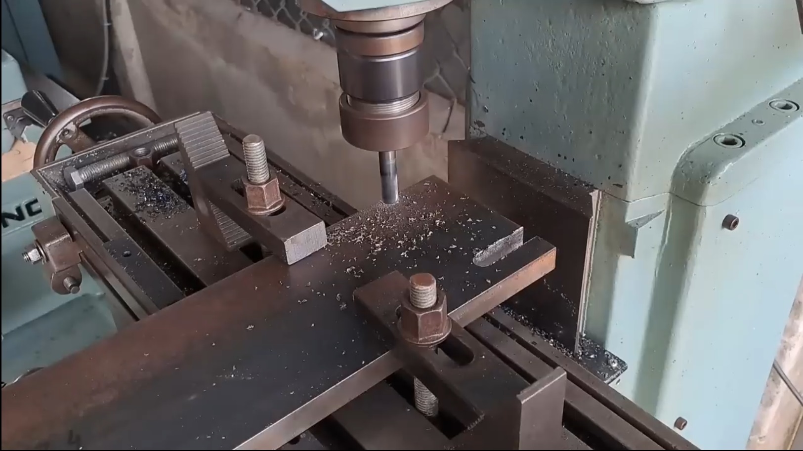

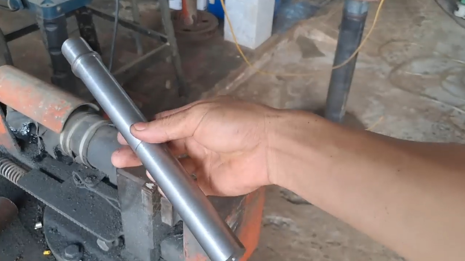

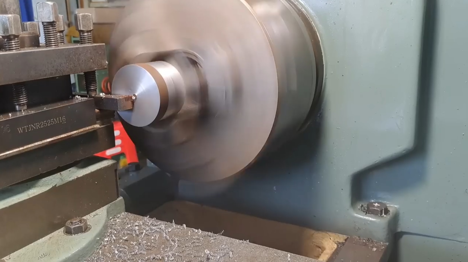

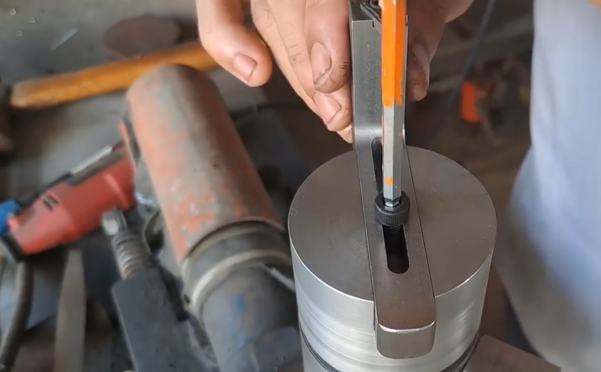

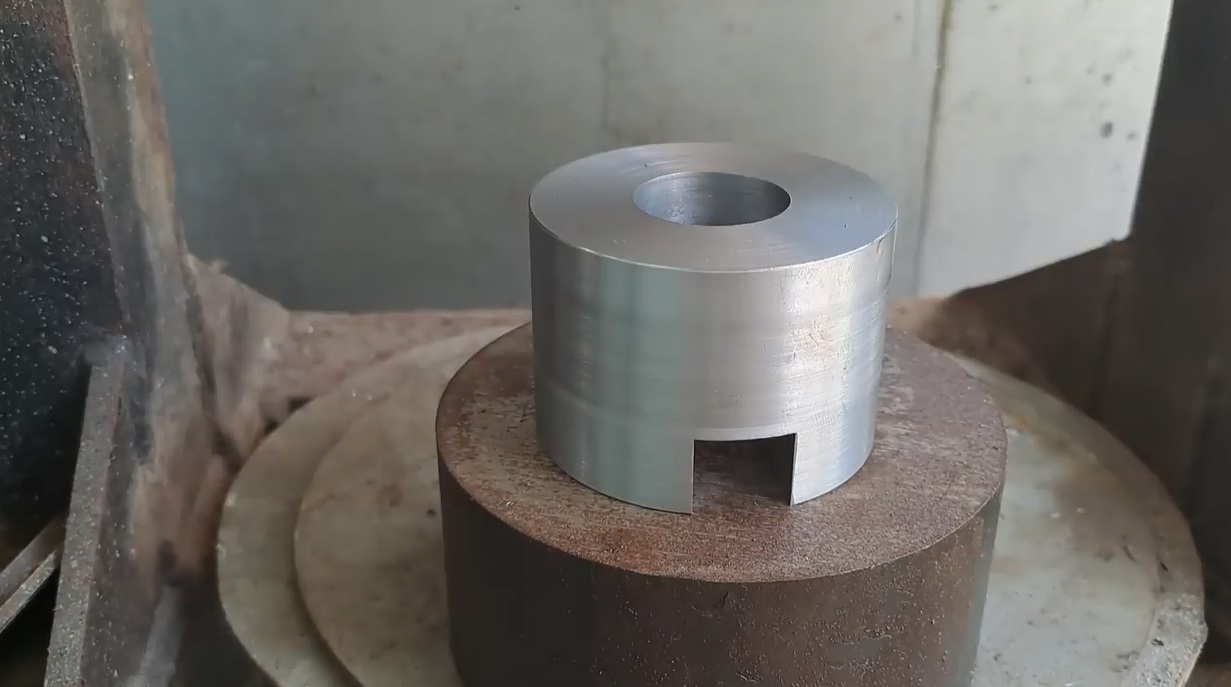

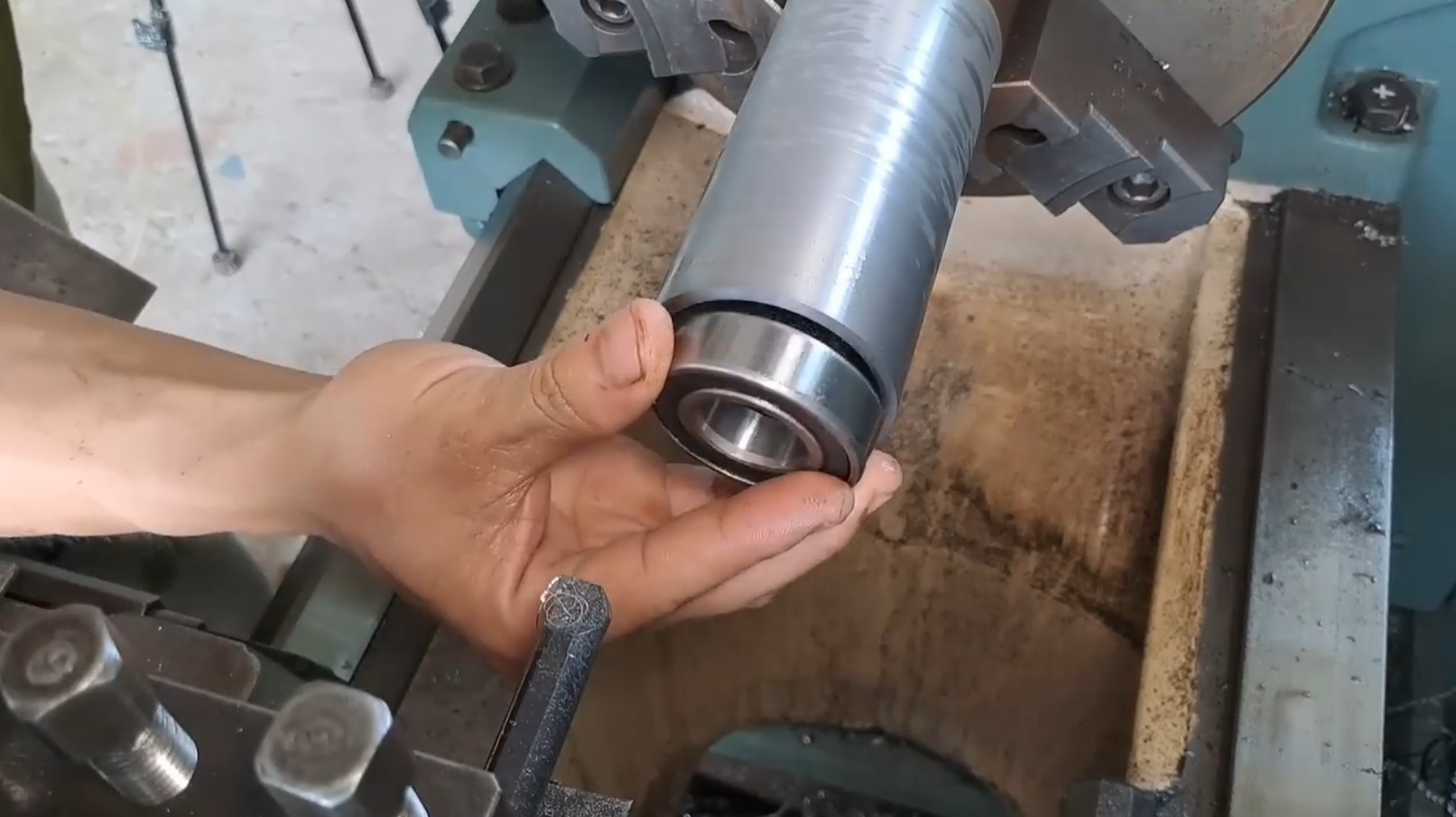

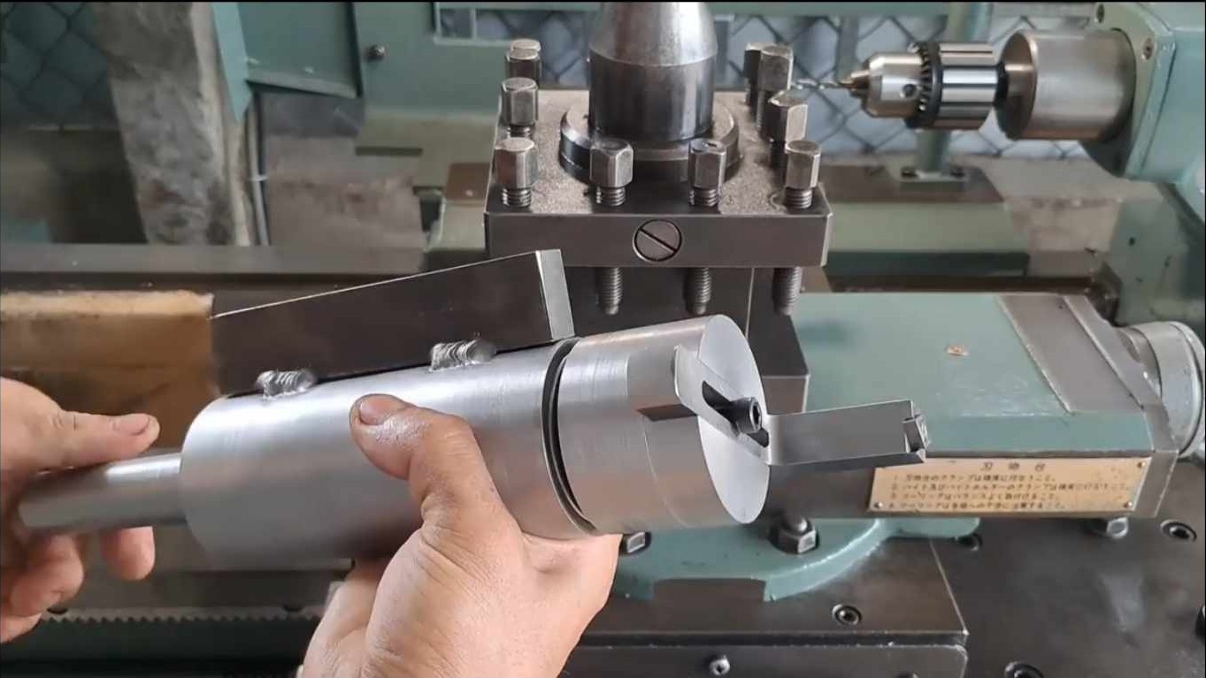

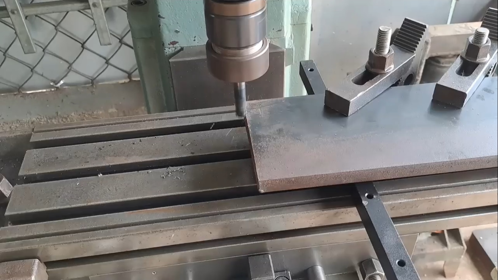

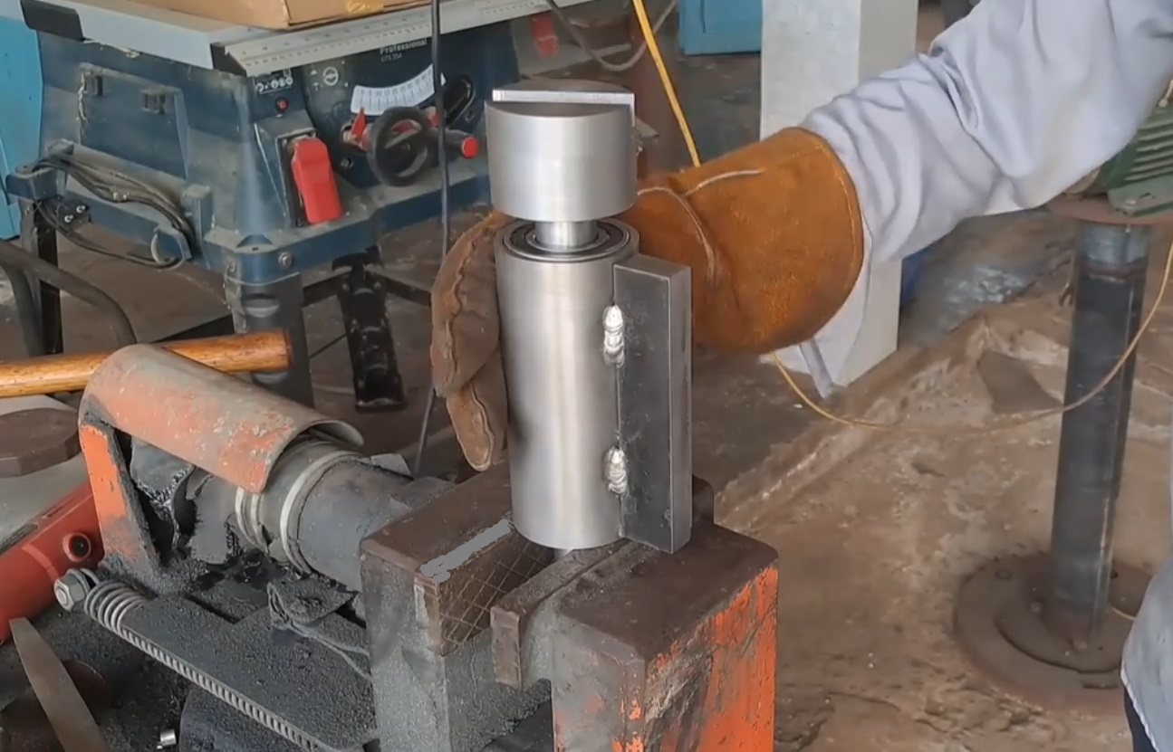

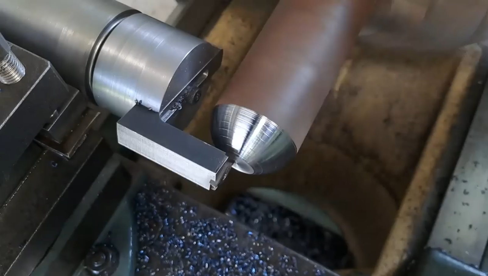

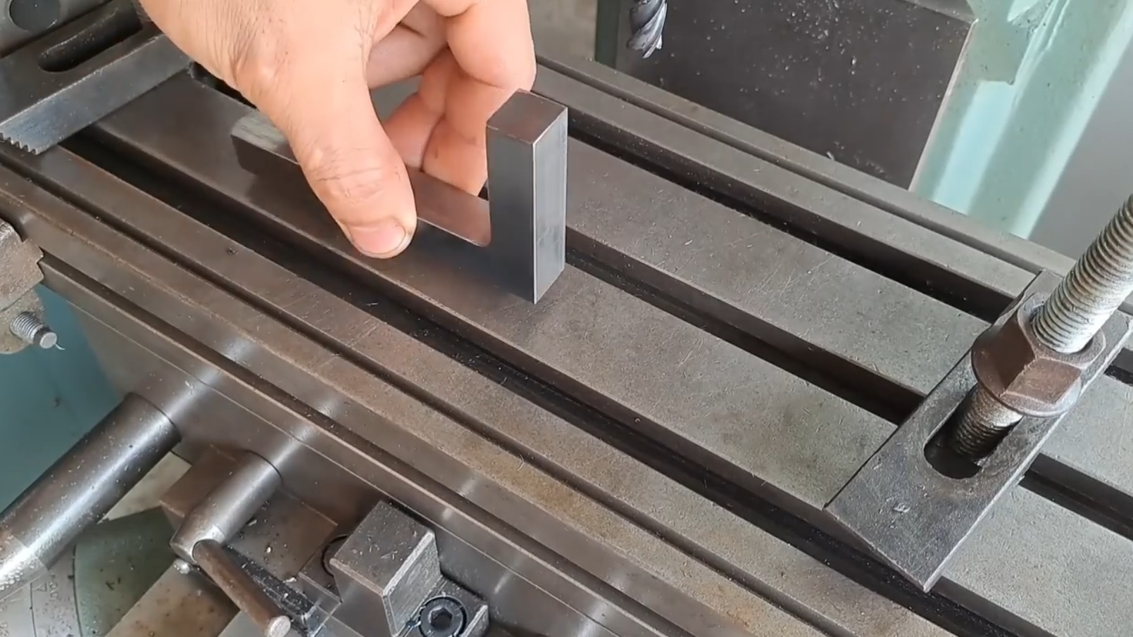

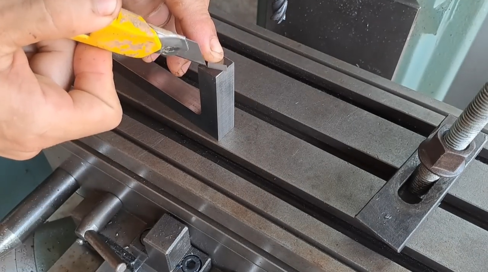

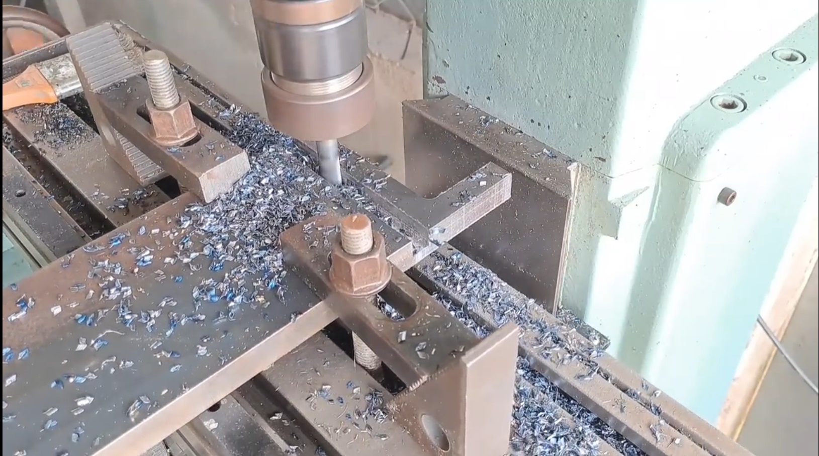

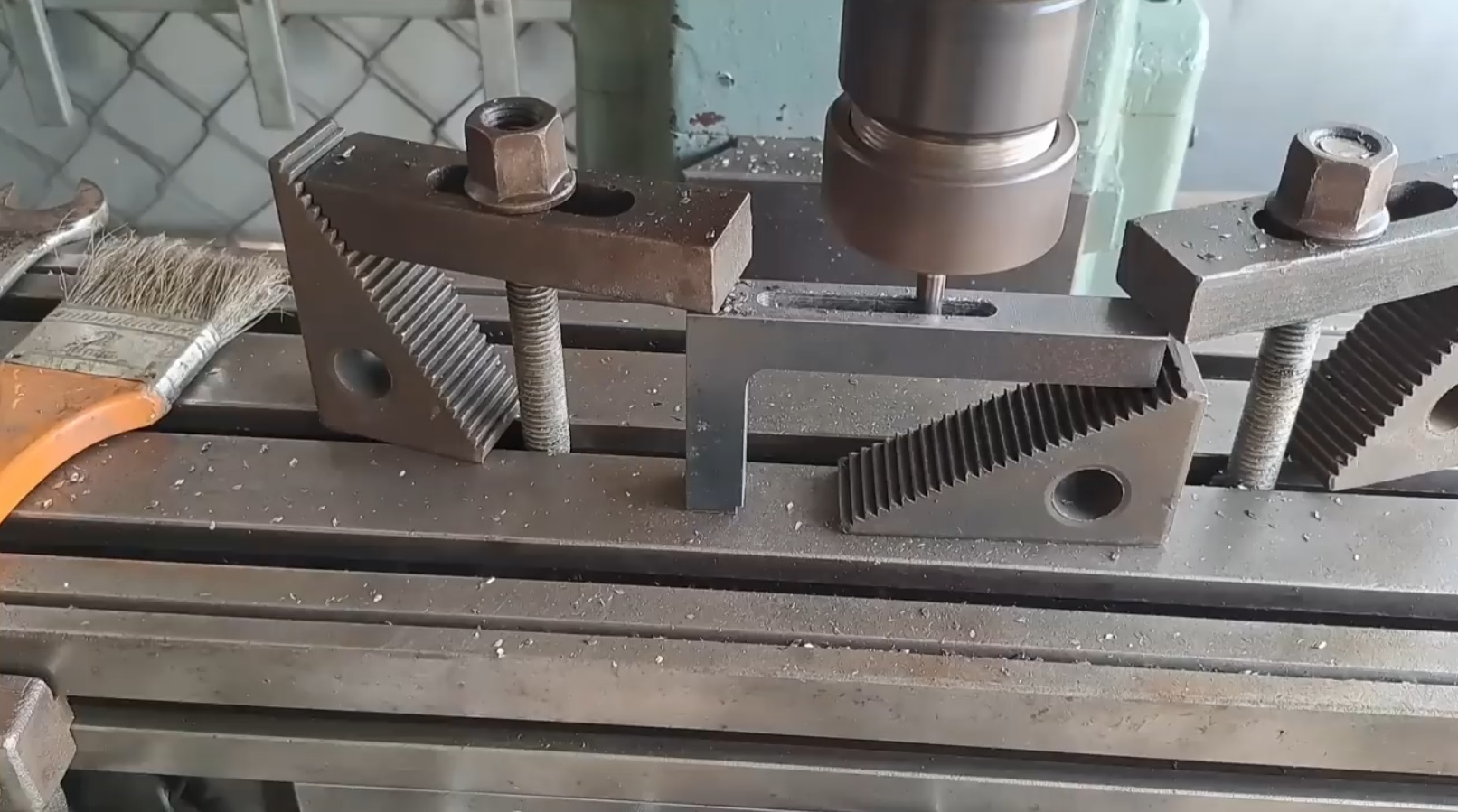

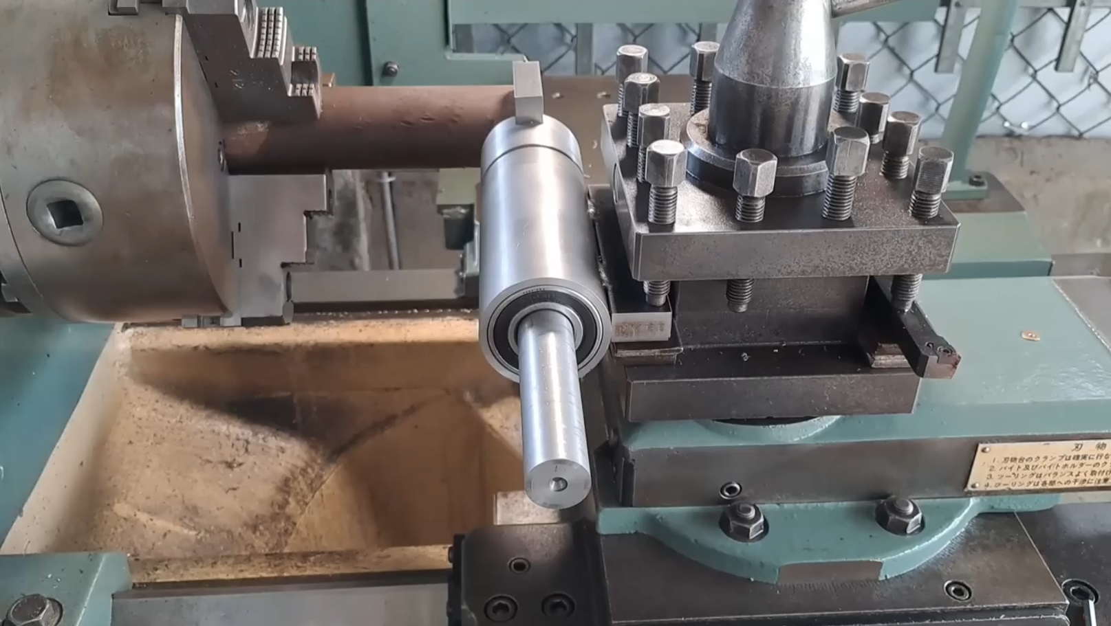

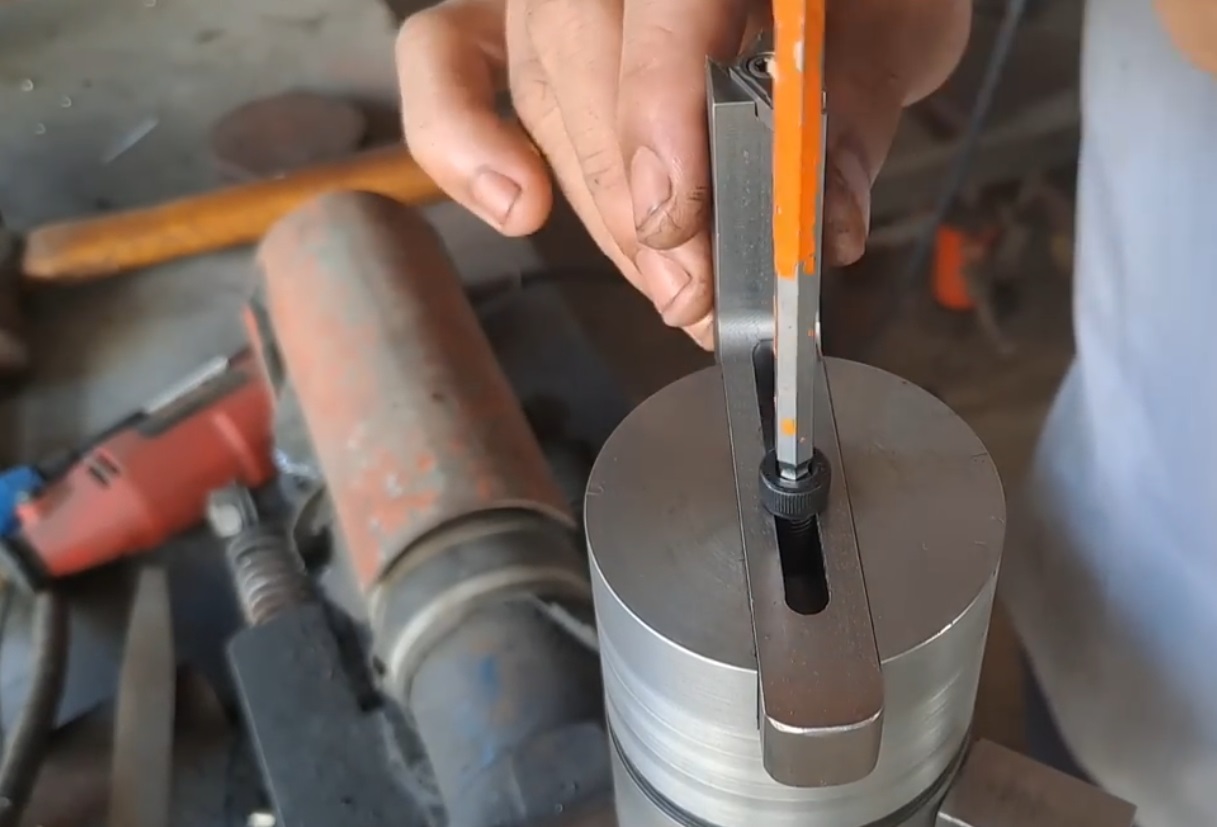

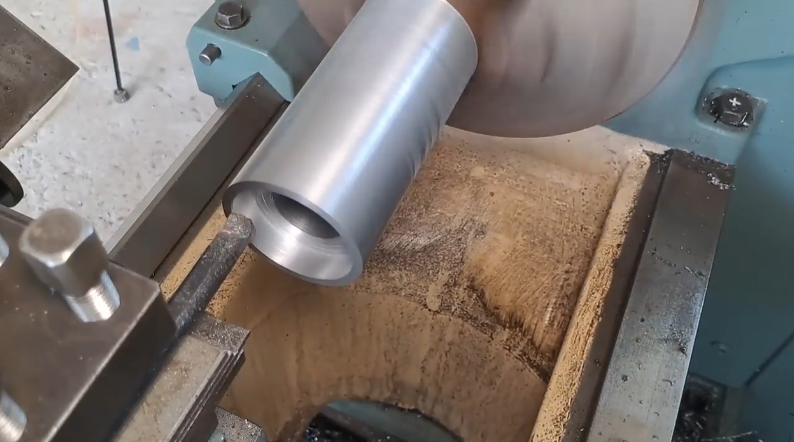

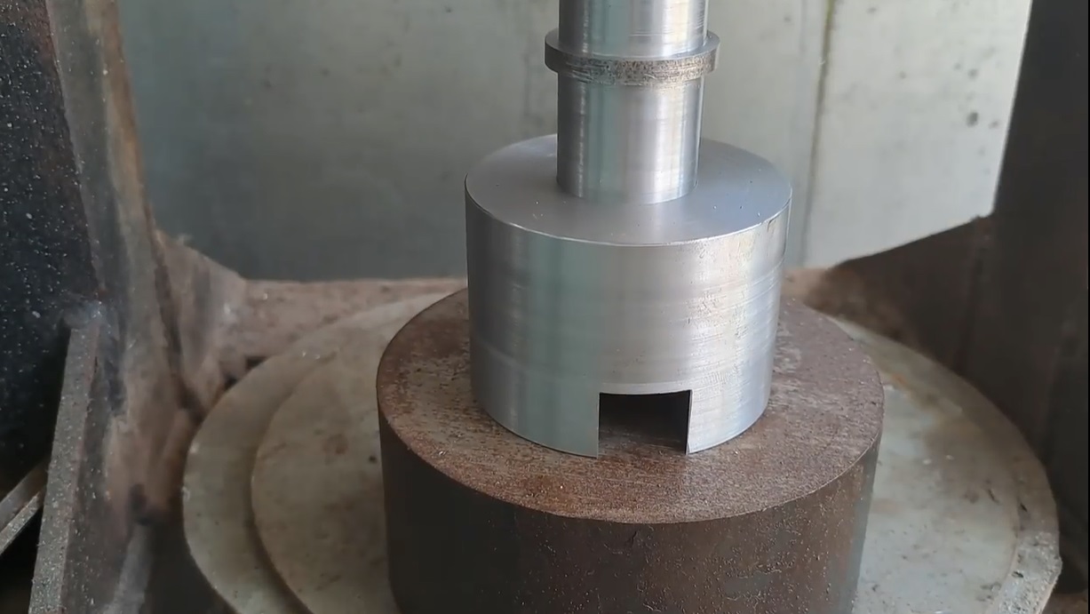

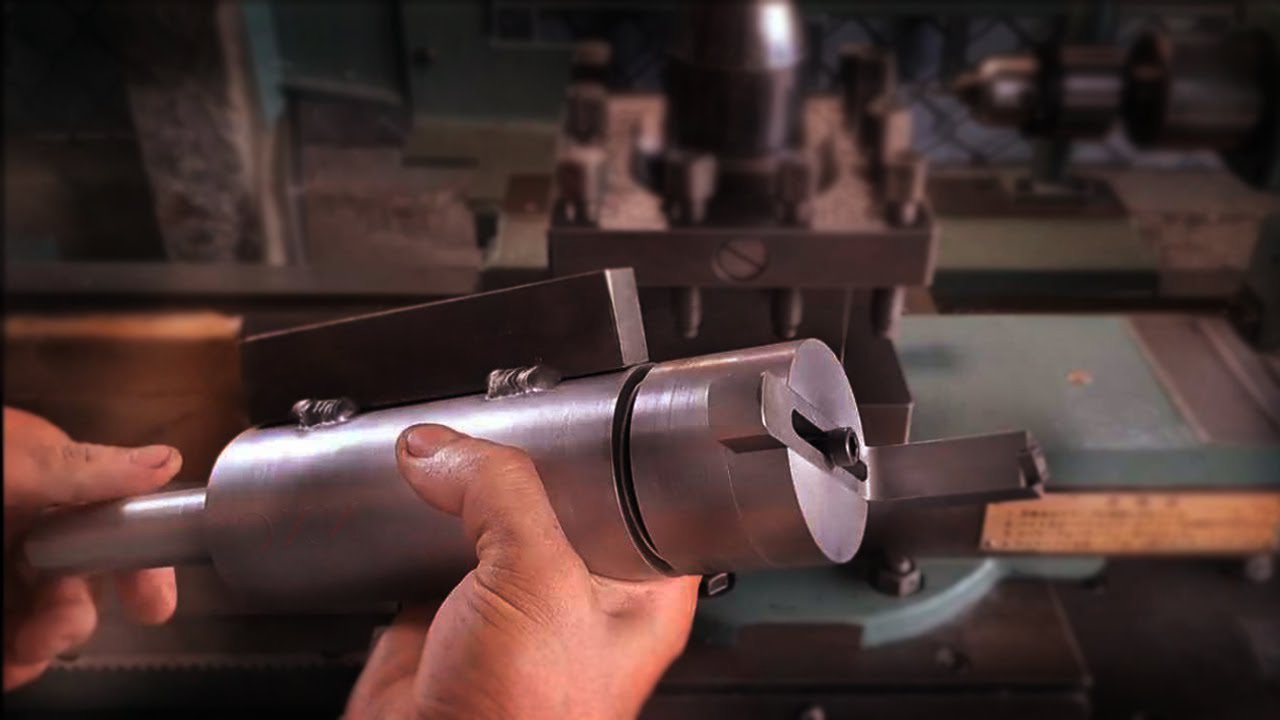

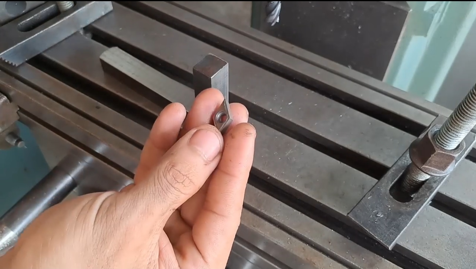

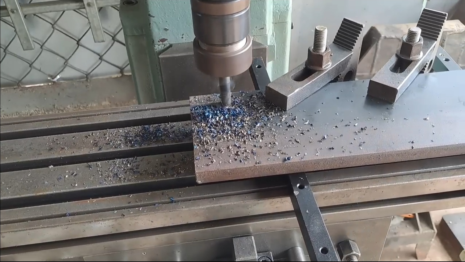

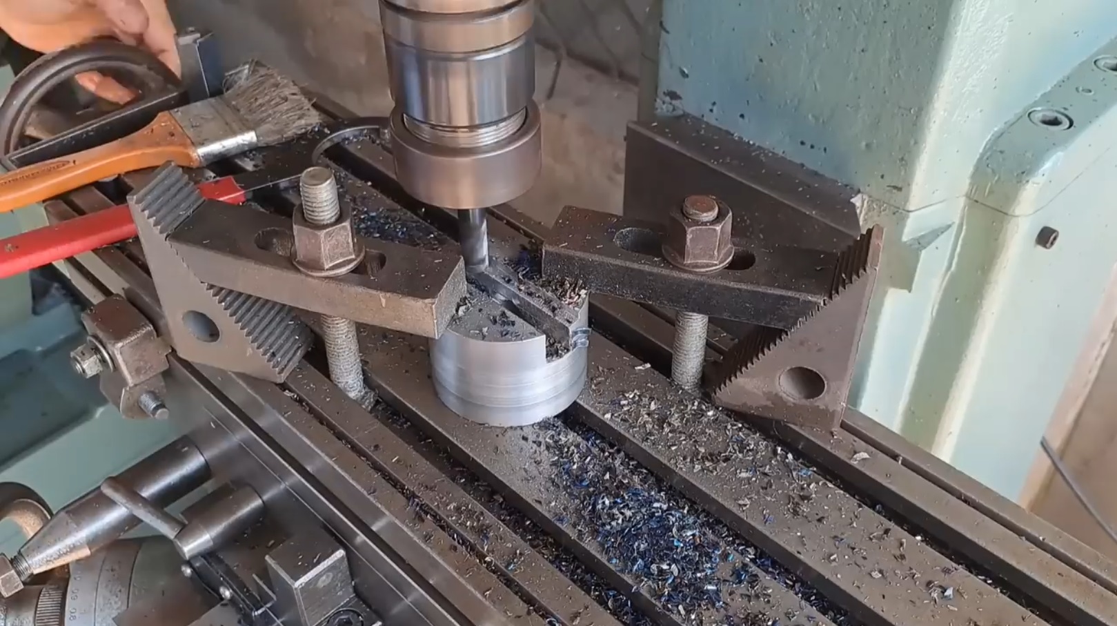

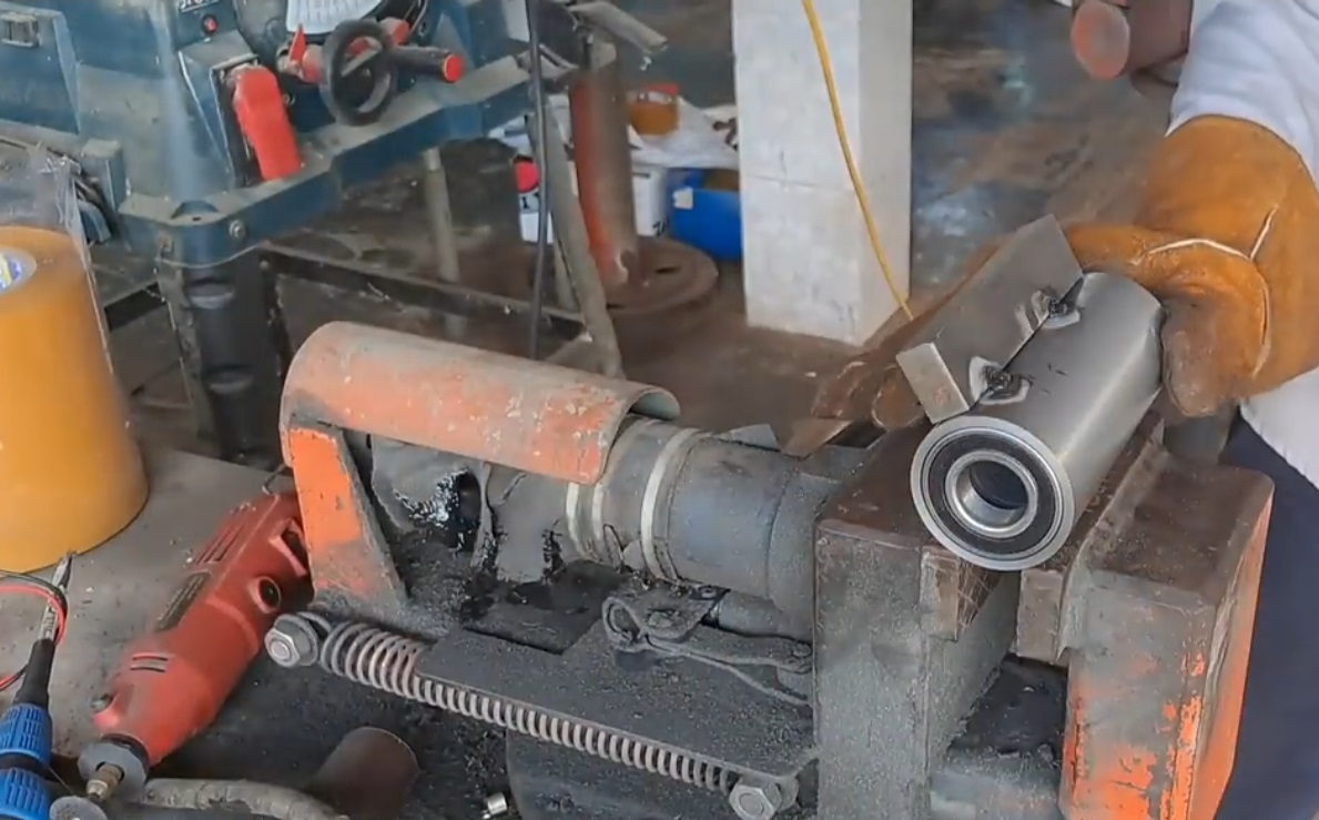

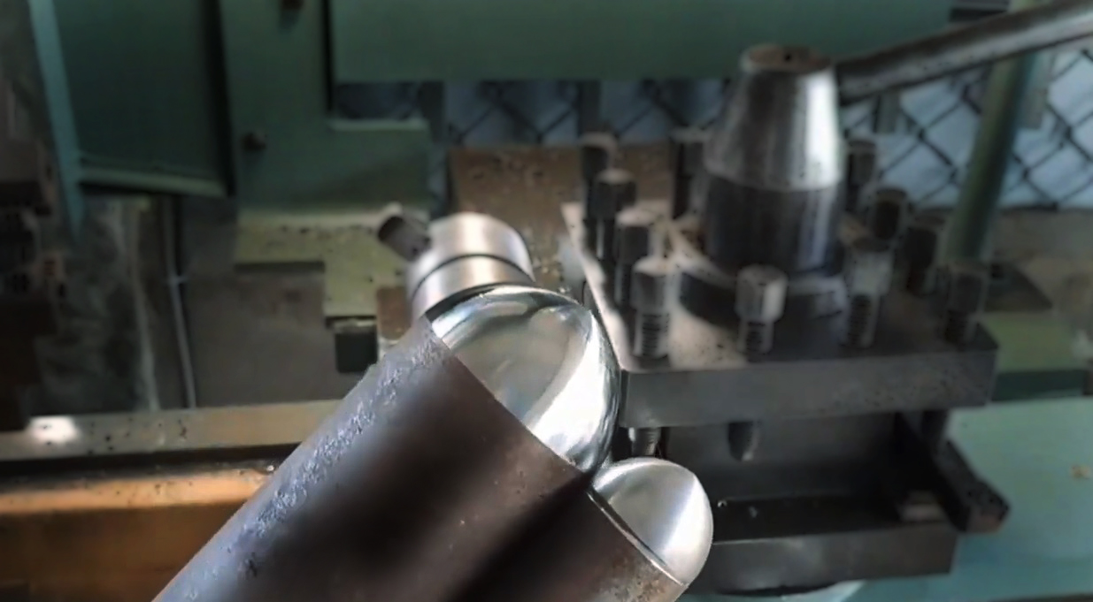

    This tool attached for lathe to spherical turn easily and quickly.
    Homemade Spherical turning tool for lathe-spherical-turnining.jpg ==>> Homemade Spherical turning tool for lathe-21.1jpg.jpg
    For for step and step tutorial video:
    https://zalonvtn.blogspot.com/2024/03/blog-post.html
    Homemade Spherical turning tool for lathe-1.jpg Homemade Spherical turning tool for lathe-4.jpg Homemade Spherical turning tool for lathe-5.jpg Homemade Spherical turning tool for lathe-6.jpg

    How did you attach the handle for turning the bit?
    Supporting Member troyhaack's Avatar
    Nov 2018
    17
    20
    Thanked 68 Times in 14 Posts
    troyhaack's Tools
    I temporality used a locking pliers . I've been made a round hand wheel for this with a key on shaft. It's simple
