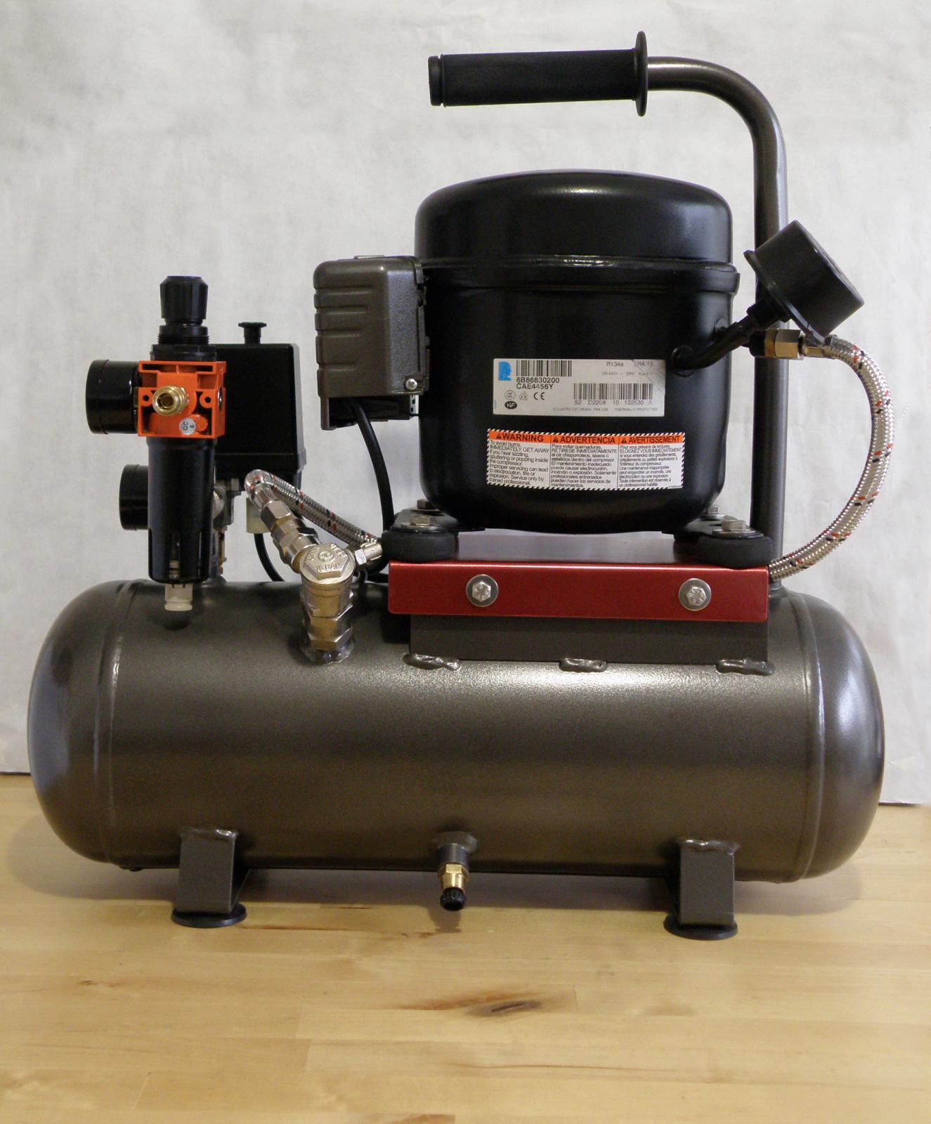

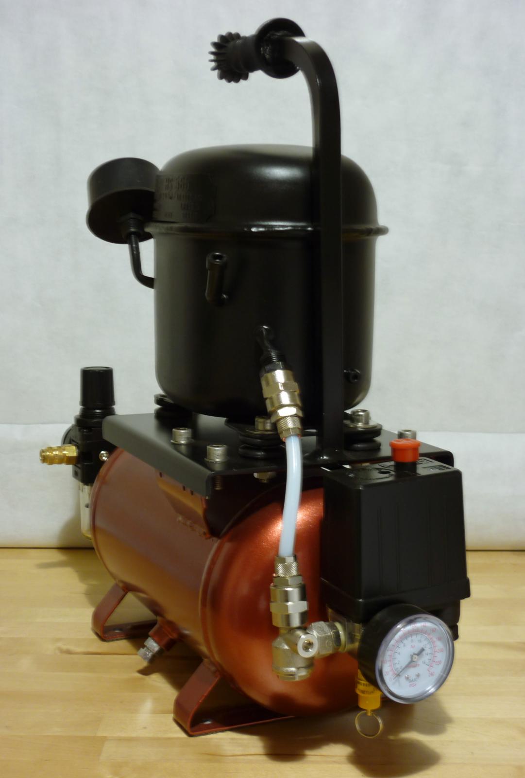

    Hello to all,
    I must admit that I have a passion for silent air compressors, simply because you can use them anytime you want without disturbing your neighbors! I built my first compressor 11 years ago using a truck’s brake air tank. Until today I've made 5 silent compressors and I have a 6th one under construction (unknown when it will be finished).
    The following video shows the construction of the 5th compressor I’ve made that is actually my first serious built when I started my YouTube channel 6 years ago.
    I don’t want to tire you with pictures here (except the necessary ones) because the whole video is actually a slide show with all the info about the built; at the end of the video you will see some photos from the other 4 compressors, but since the time of the video is short I will put these pictures below so you take closer look. I would like to show you more from my previous builds but unfortunately I have only these pictures.
    Homemade silent air compressor-52.jpg Homemade silent air compressor-56.jpg Homemade silent air compressor-57.jpg Homemade silent air compressor-58.jpg Homemade silent air compressor-59.jpg
    These are the previous 4 compressors I've made.

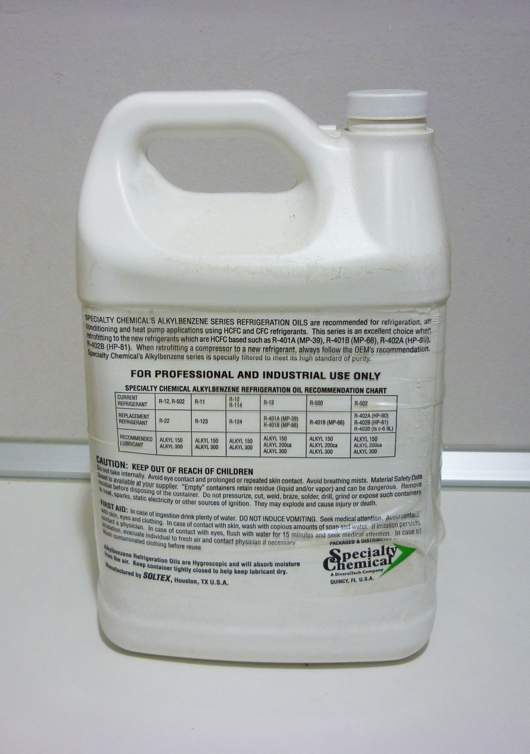

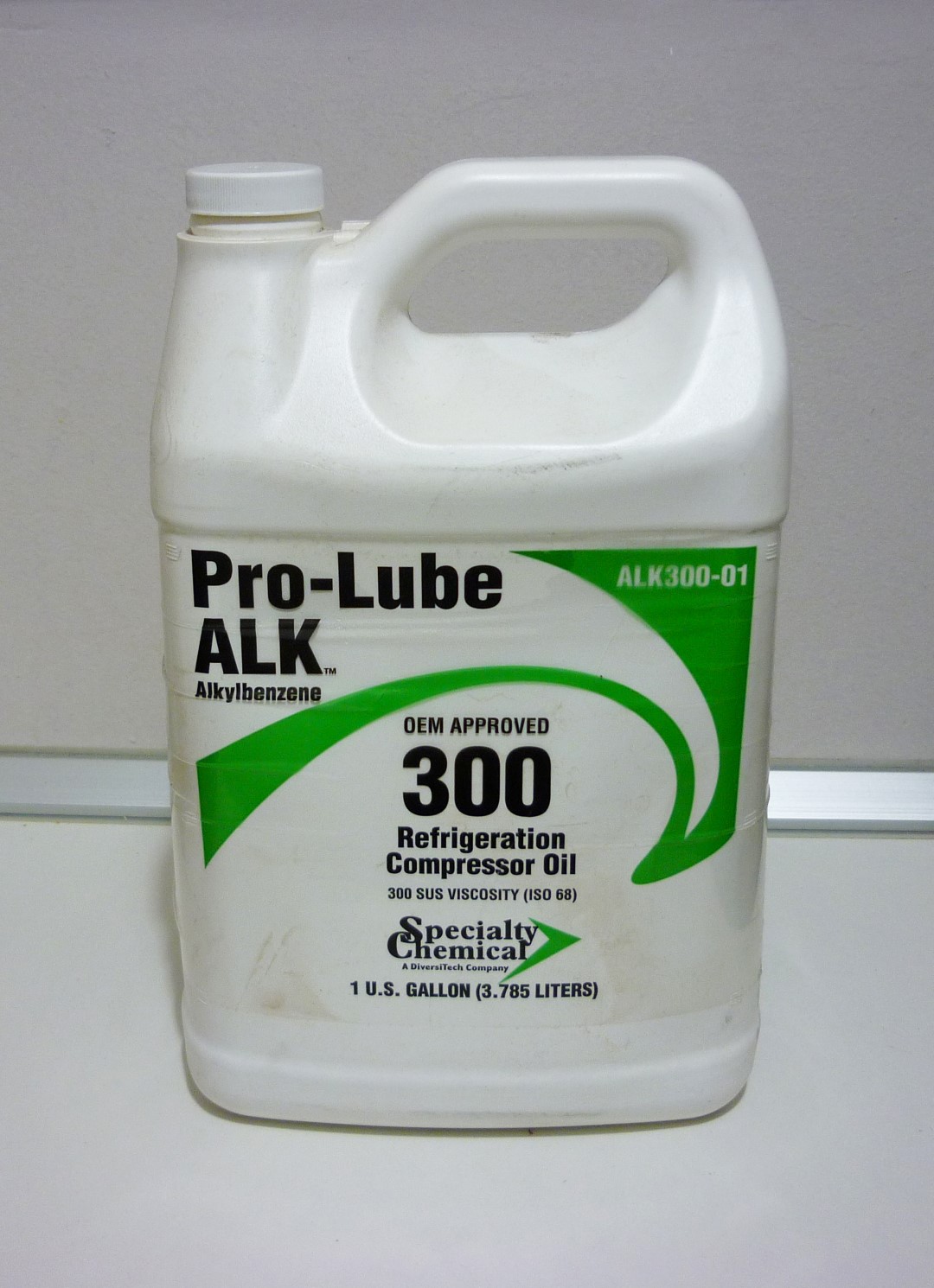

    Hi Sleykin
    As you well said it this type of air compressor is perfect for using an airbrush, a pencil grinder or for a small pneumatic engraver for stone setting or any other art work, this will answers your first question; with proper maintenance they can last for many years because they are made to support tools with low air consumption. Now, the main disadvantage of a fridge compressor is that its motor runs at high rpm transferring motion to a small cylinder inside the housing that increases temperature, meaning that the motor must not work continuously; thankfully all fridge compressors have a thermal switch for protection but it is wise not to reach this limit. The working time of compressor like this is depending on the power of its motor; the motor must stop down equal time with the time of its continuous run.
    The rule of thumb is:
    A 135 Watt motor must not exceed 15 min. continuous run, after this time must cool down for 15 min. A 280-340W 20 min run - 20 min stop, a 735W 30 min run - 30 min stop
    As for lubrication, I use the recommended coolant oil from the manufacturer.
    Homemade silent air compressor-p1130937-large-.jpg Homemade silent air compressor-p1130938-large-.jpg
    Now checking the oil level is a bit problematic, because fridge compressors haven’t the glass checking window; so the only option is to use a syringe with a hose for sucking the oil from inside the housing and check the quantity and the color of the oil in a measure pot; luckily all reputable manufacturers state the proper oil quantity on the motor’s label.
    Fresh oil has transparent pale yellow color, when the color become dark yellow (but still transparent) it's recommended to changed it.
