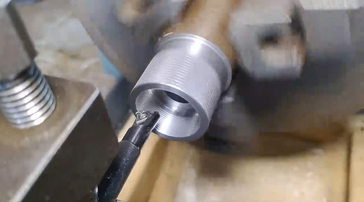

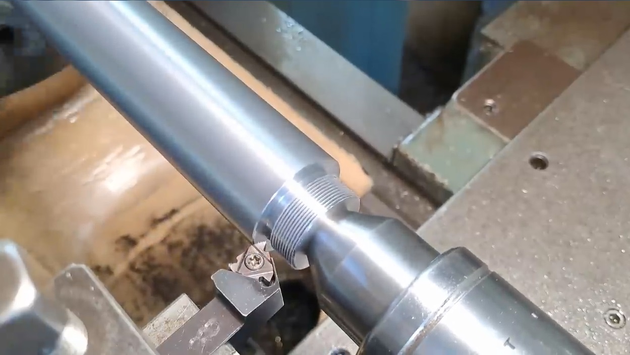

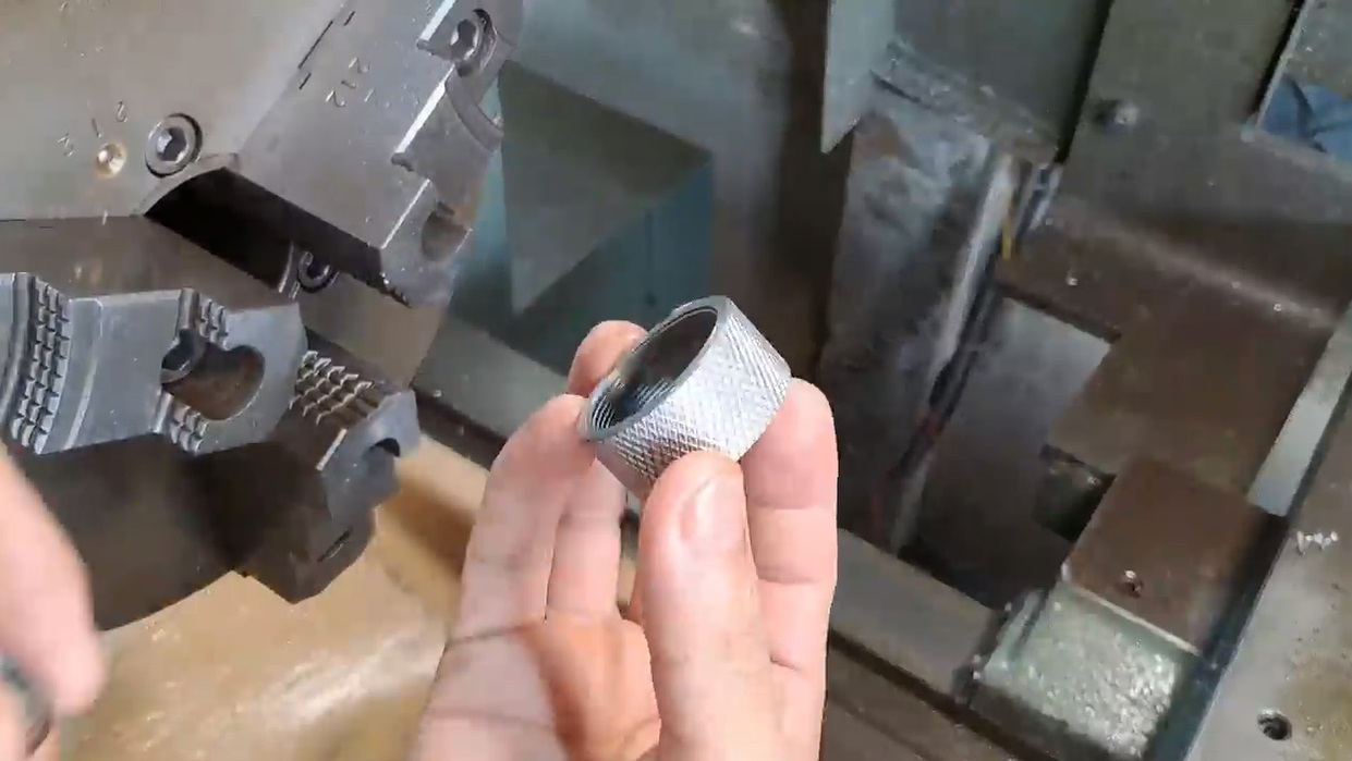

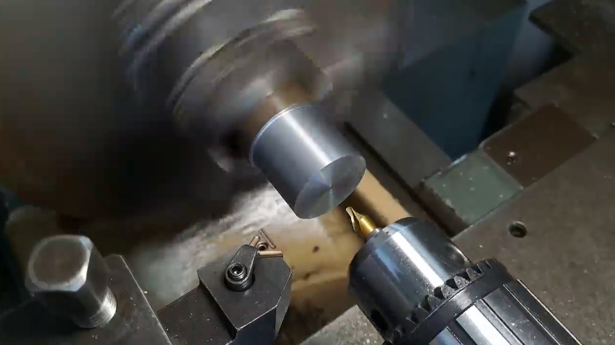

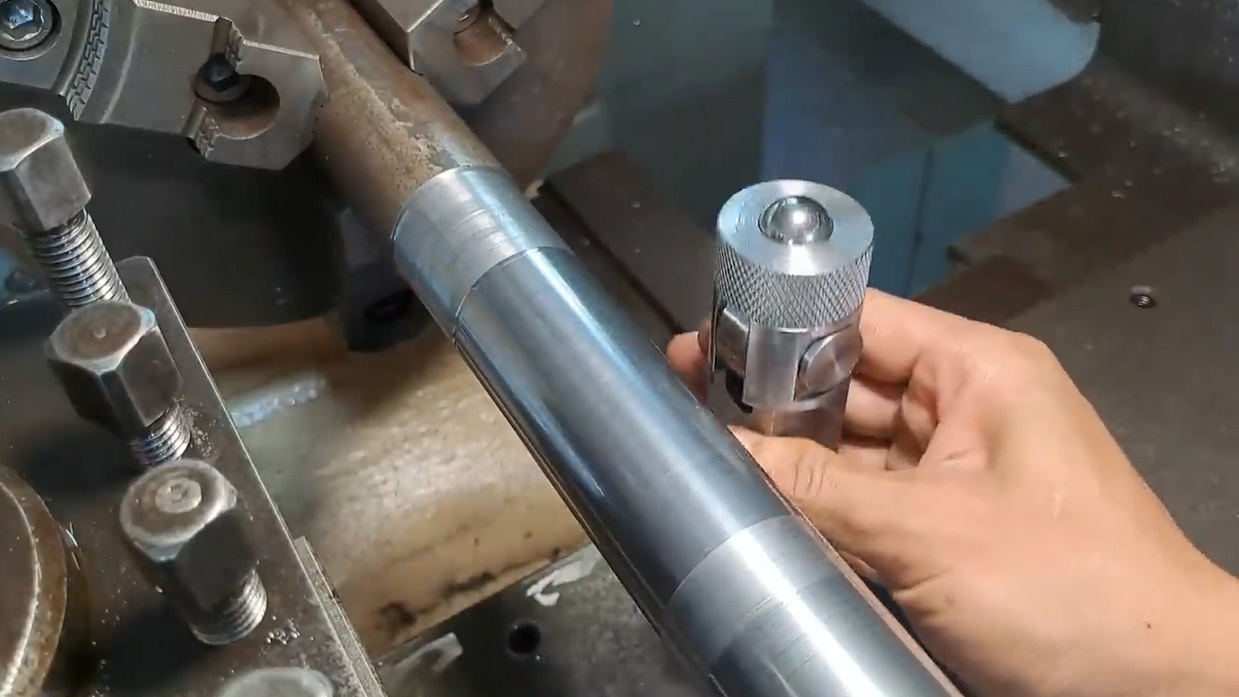

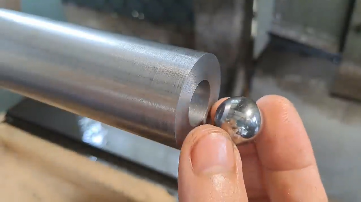

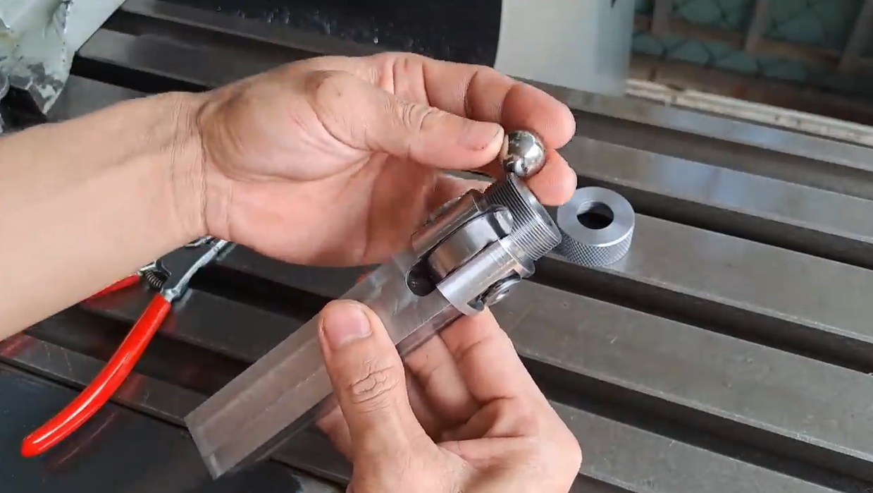

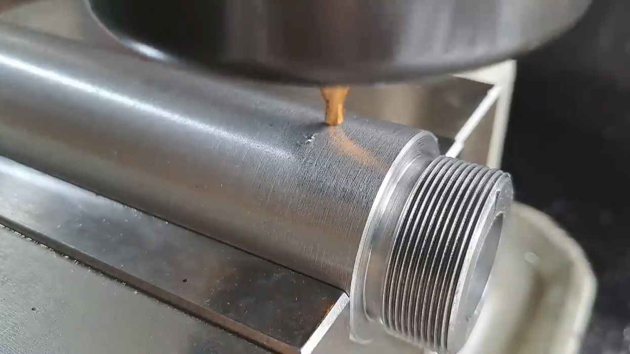

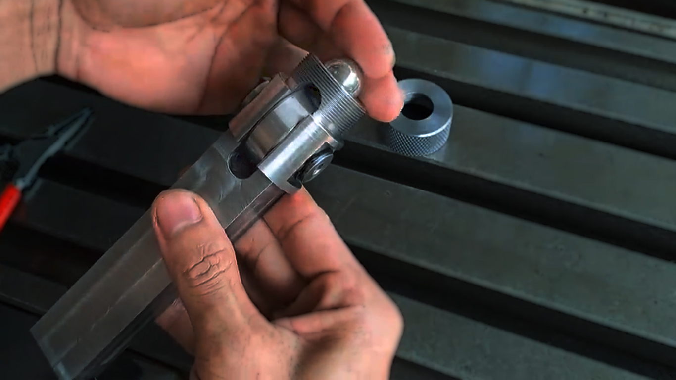

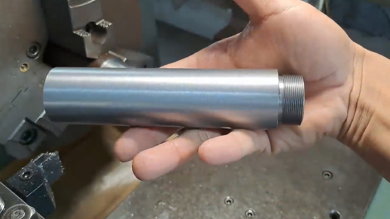

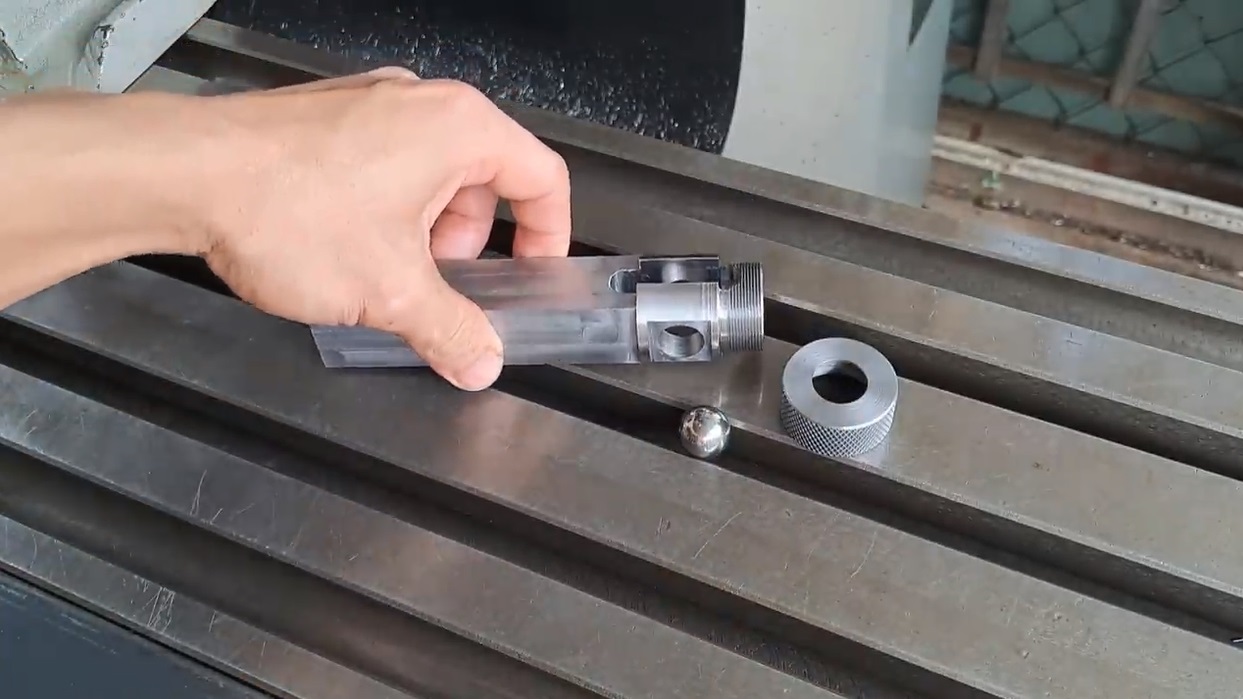

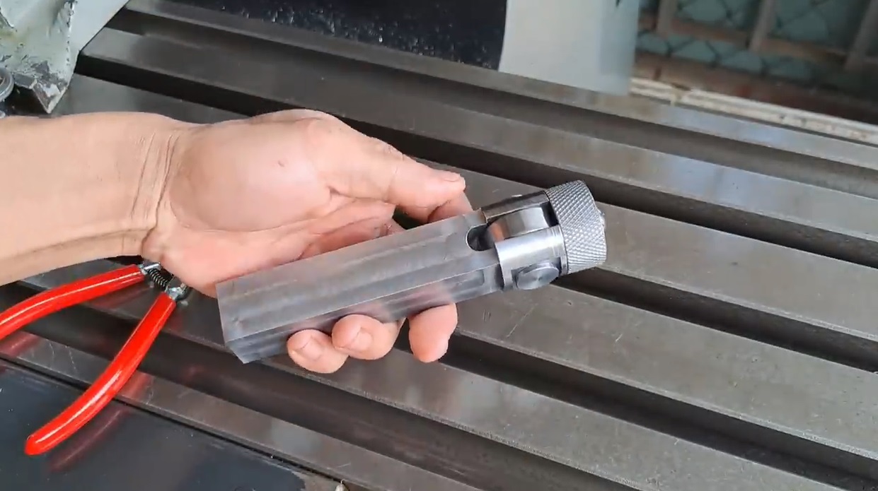

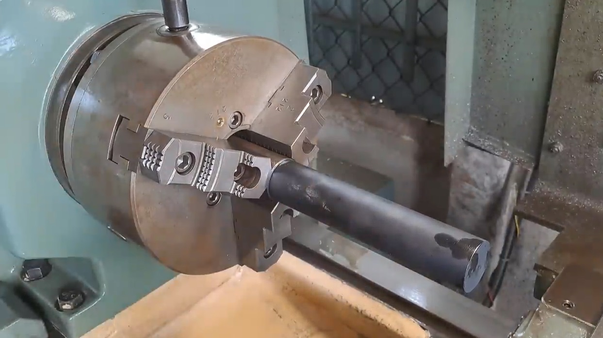

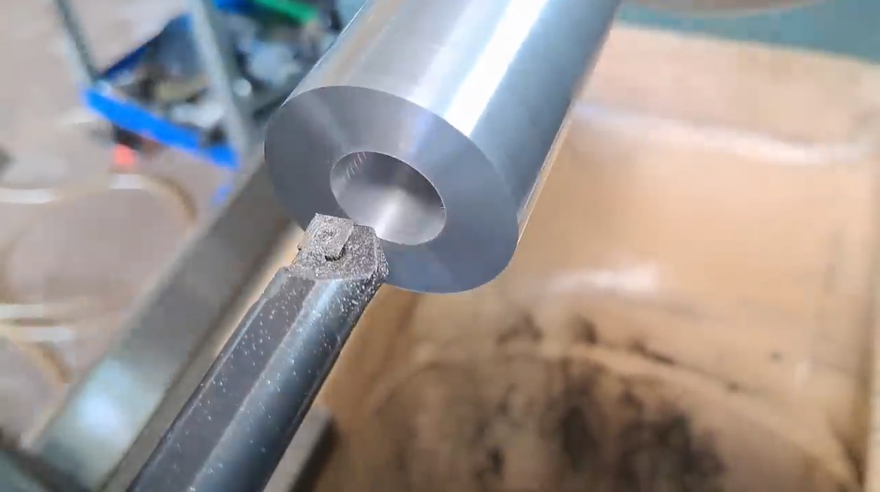

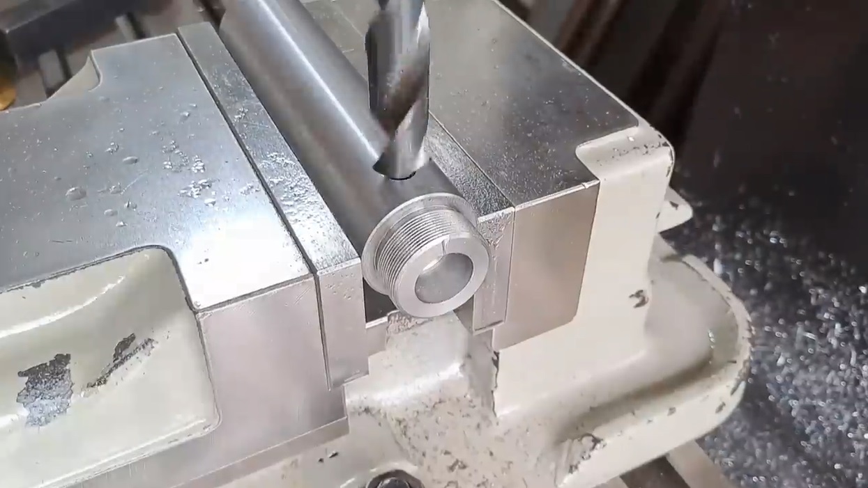

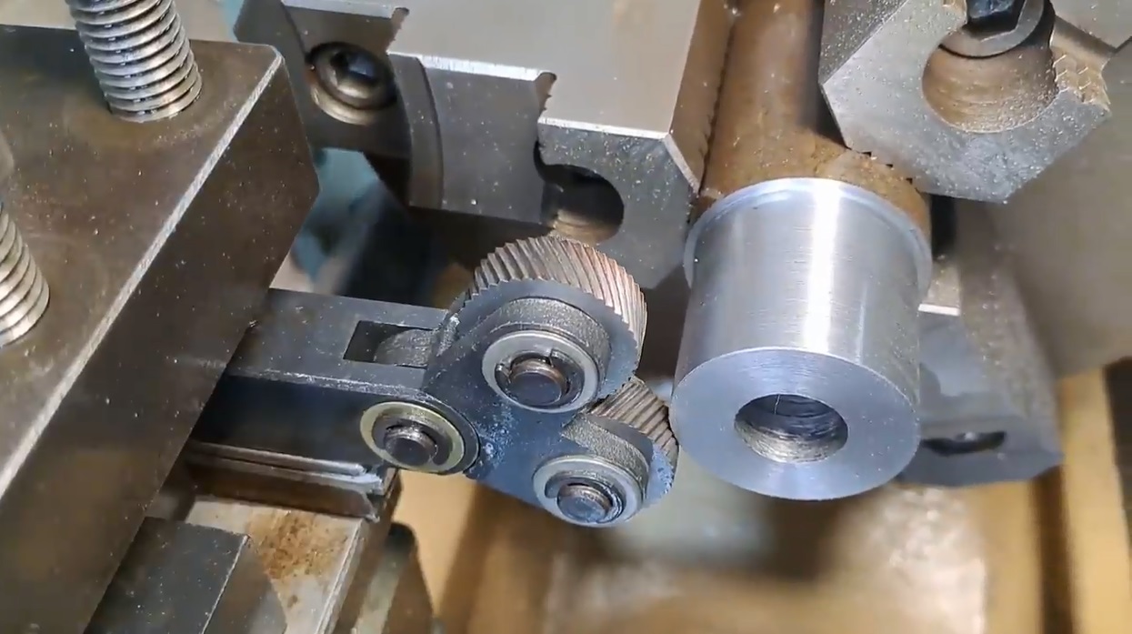

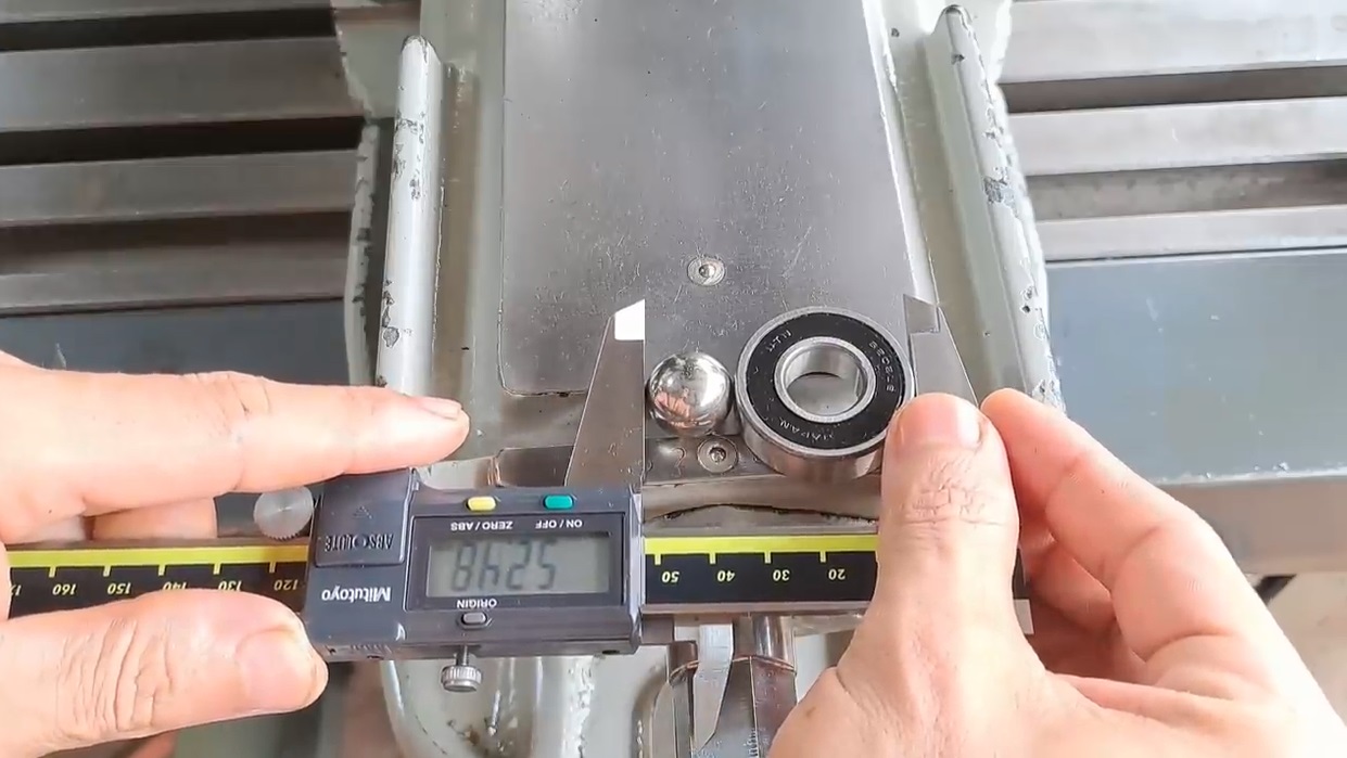

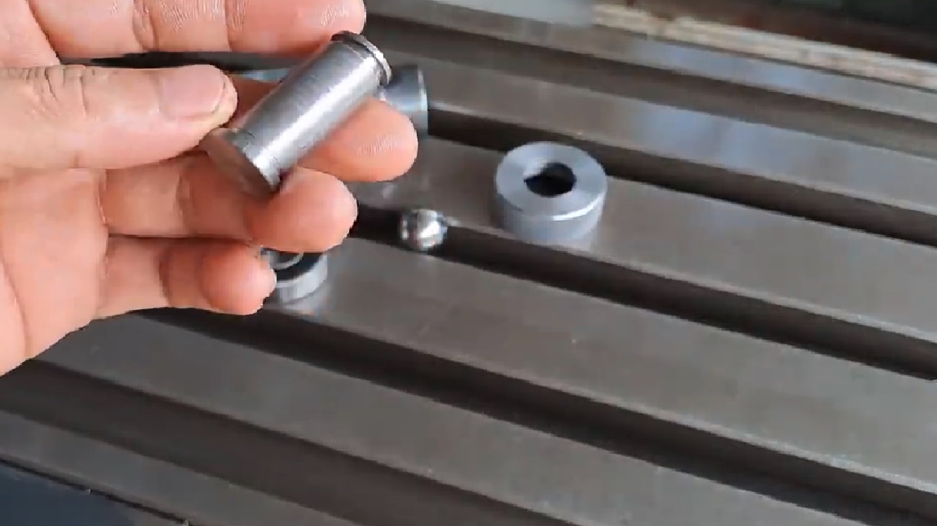

    Homemade shaft surface polish tool for lathe
    This tool uses to polish shaft surface on lathe. This tool also makes surface harder
    Homemade shaft surface polish tool on for lathe-1.1.jpg ==>> Homemade shaft surface polish tool on for lathe-17.jpg
    Look at here for step and step tutorial video:
    https://zalonvtn.blogspot.com/2024/04/blog-post.html

    Pretty cool. How much dimensional change does that introduce to the part?
    Apr 2020
    20
    Thanked 6 Times in 4 Posts
    Yes I have the same question, what is the dimensional change?
    Will have allot to do with the material and also the tool pressure?
    It does give you a different looking finish.
    Cheers
    Willy
    Supporting Member troyhaack's Avatar
    Nov 2018
    17
    20
    Thanked 68 Times in 14 Posts
    troyhaack's Tools
    Quote Originally Posted by rebuilder1954 View Post
    Quote Originally Posted by willyb View Post
    Cheers
    Willy
    The dimentional change depends the carriage adjustment, material, shaft dimension... You certainly can not move the carriage too much because this tool is not a cutter. With my shaft the dimension minus 0.01 after I did.
