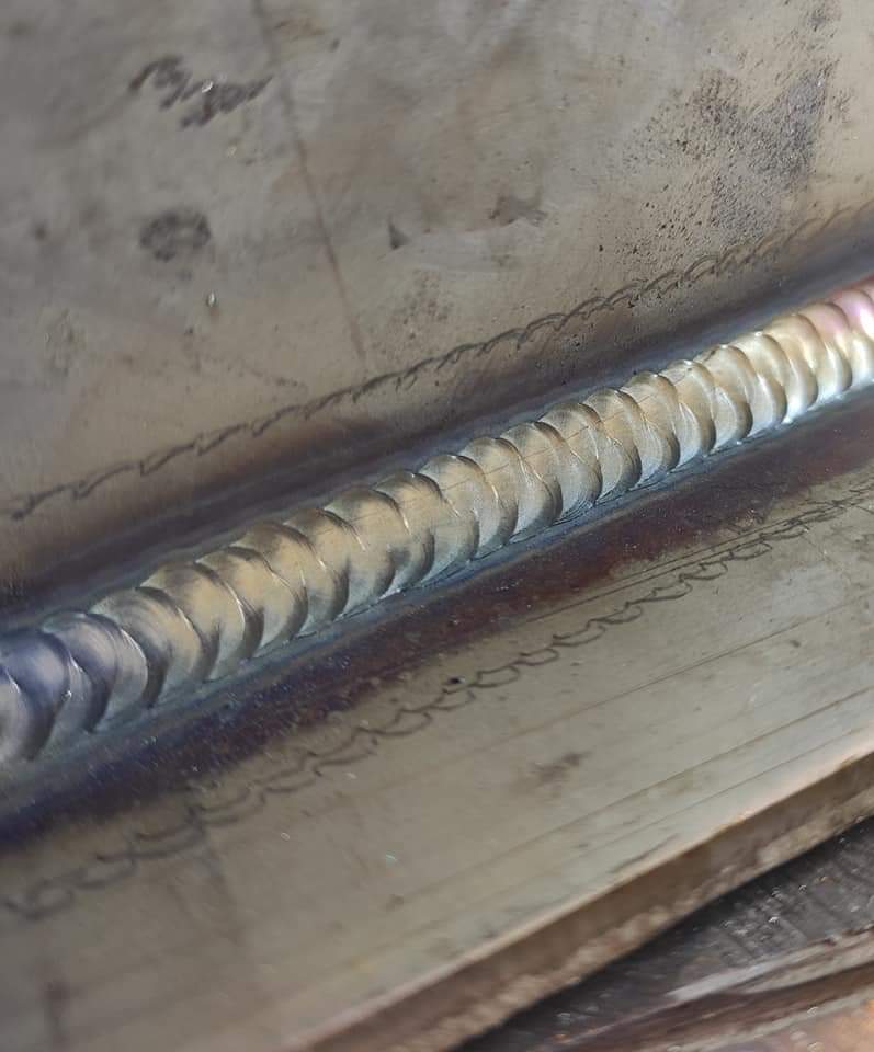

    Once that's painted, wondering percentage of people would not believe this is hand made, or produced by a private shop.
    I'd feel sorry for them, but it'd be a lost cause.
    Thanks. Its still missing some parts. I will integrate leg vise to it too. Video comes when its ready.

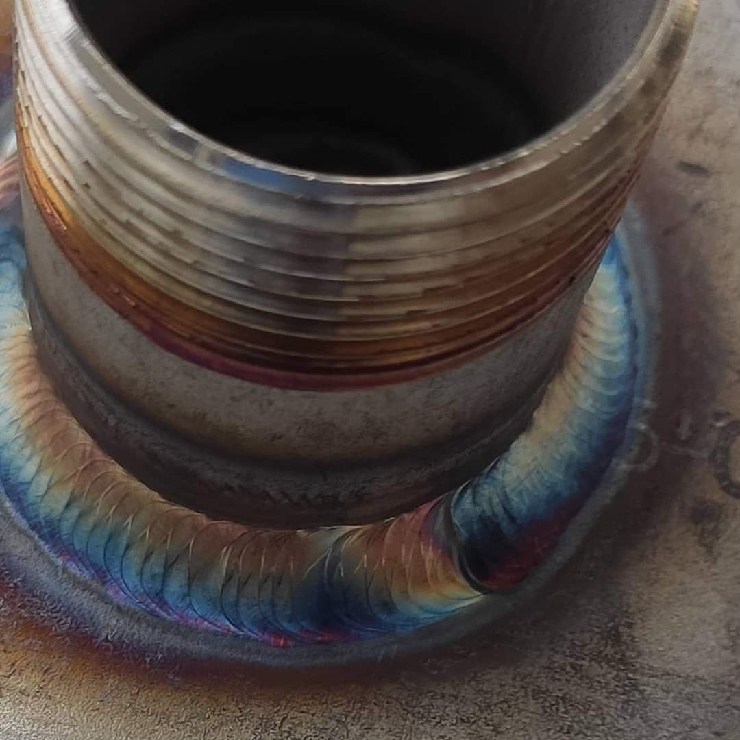

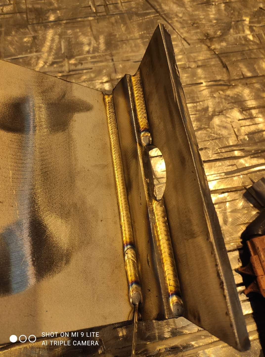

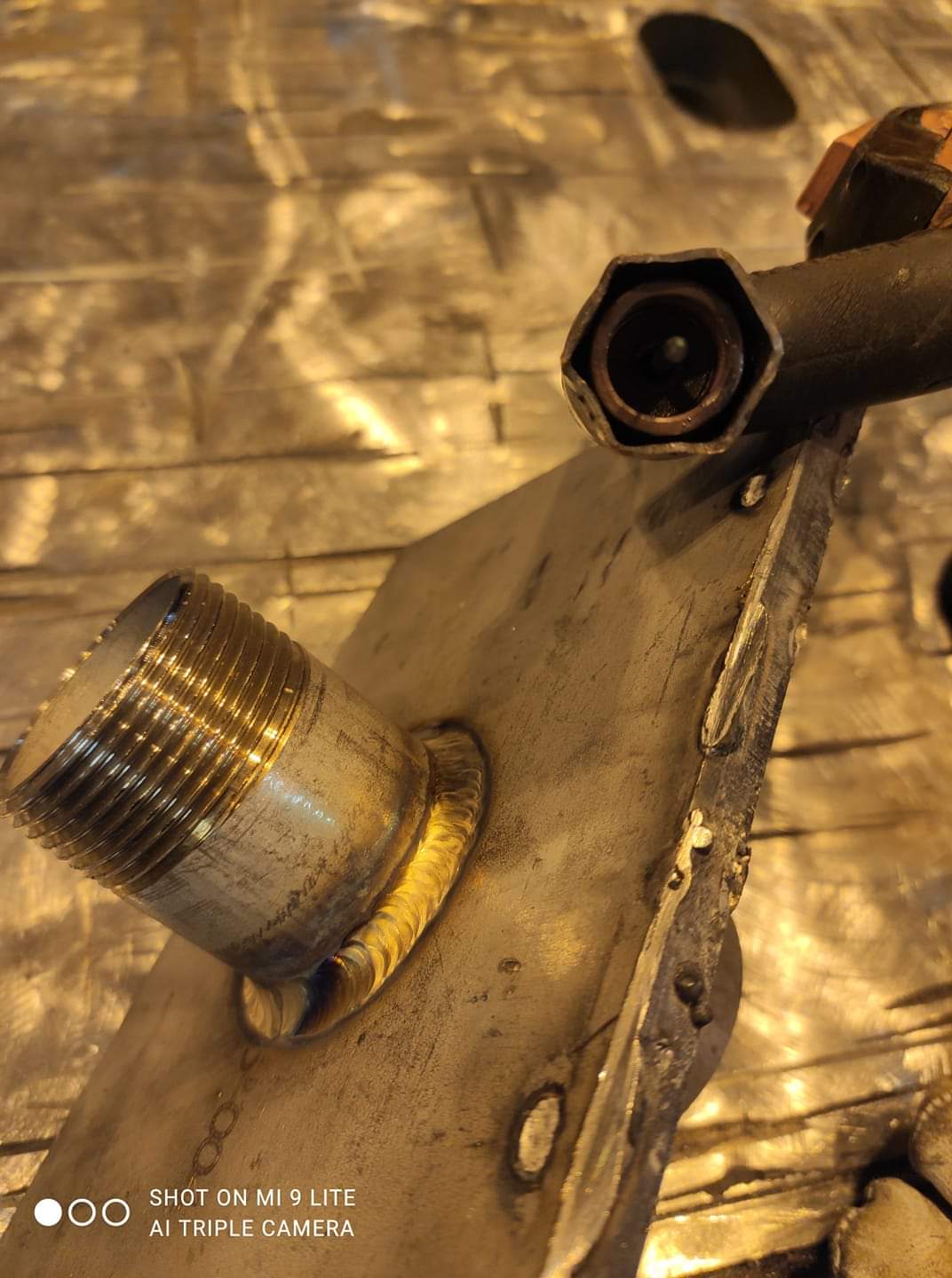

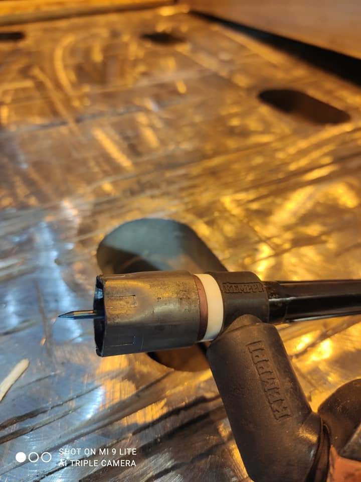

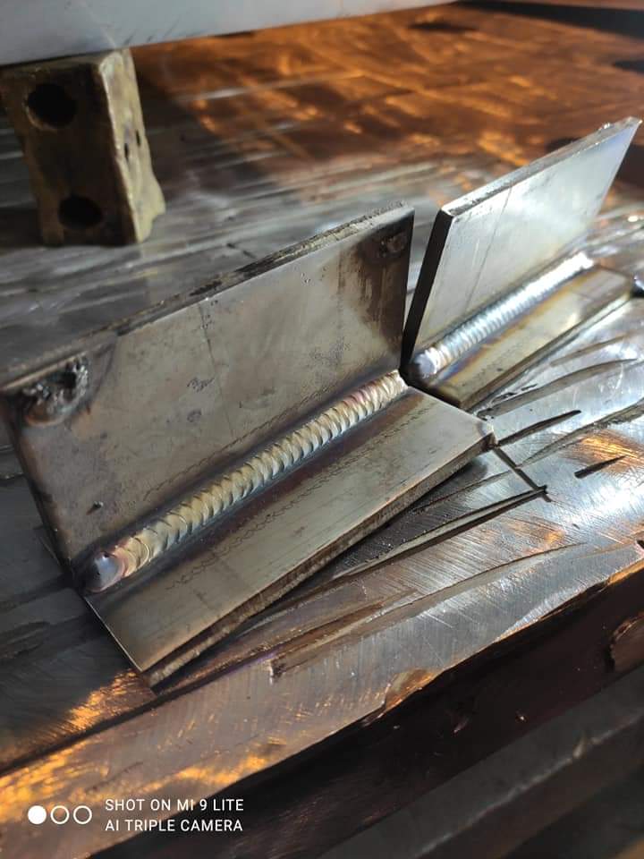

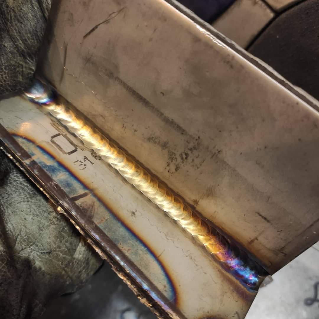

    Btw. While welding it, i got an idea about simple aid that makes easier to learn " walking the cup " with tig.
    Simple octagon shaped cup.
    Its easier to " walk " with the edged, than round shape.
    Short clip shows the use:
    https://www.facebook.com/45637460180...3932313711744/
    Note that camera is on the way, so i need to feed additive over it.
    It would be better to feed it in lower angle.
    Results:
    Homemade Rr-track anvil-fb_img_1611676184206.jpgHomemade Rr-track anvil-fb_img_1611676190080.jpg
    I haven't used that method earlier, just the " traditional " way.
    Actual cup is a shaped copper pipe on top of the size 6 ceramic cup.
    Octagon shape is made by pressing pipe around suitable sized nut head.
    Helped me to learn the method.

    Those are some really pretty welds, one of these days I am going to learn tig welding.
    I'd like to see some pictures of the weld being cut sorta like picture 5 but cut through the weld with a close up of the weld.

    To nice to use! if I made it I would have it as an ornament on a shelf. Great work Tuomas

    Clever idea, nice work & beautiful TIG welds.
    Minor correction...it's a hexagon shape...6 sides....octagon would be 8 sides, and I'm not aware of any 8 sided nuts or bolts, but I've not seen it all yet.

    That looks like a great idea. I tig weld quite a bit & find that my "distance moved" varies too much with the round & can see this helping me to make better looking welds. Will give it a try.
