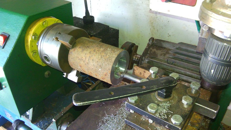

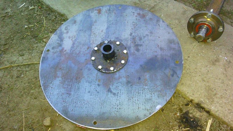

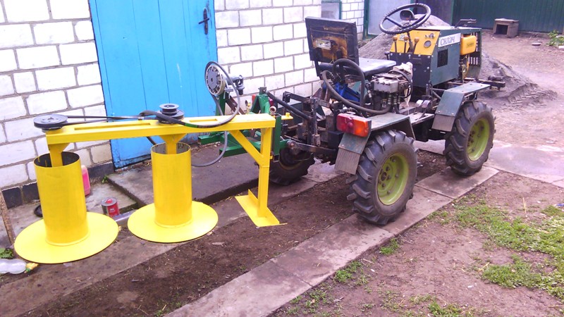

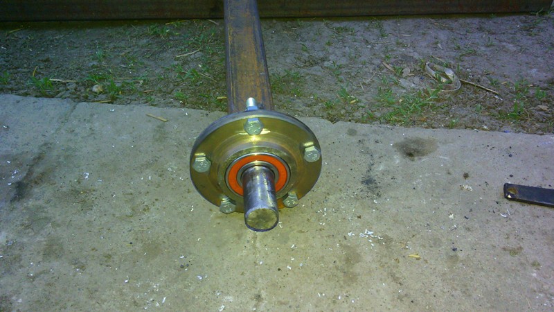

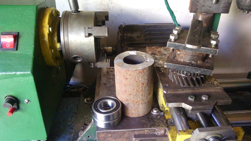

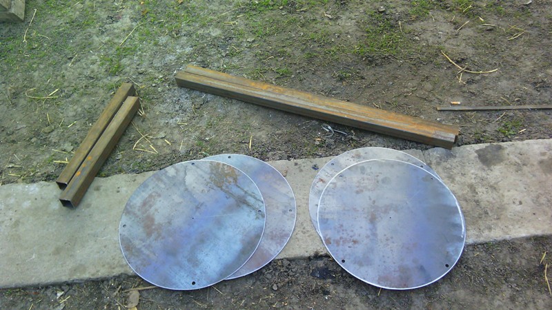

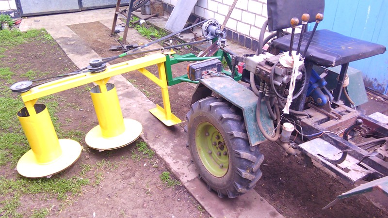

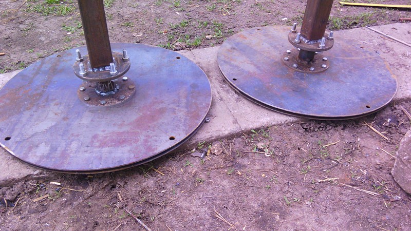

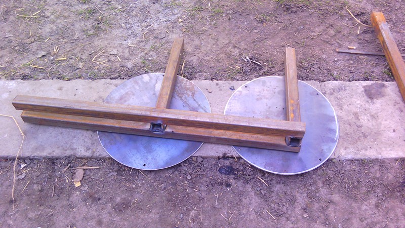

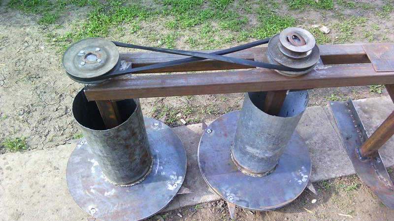

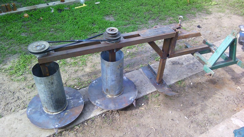

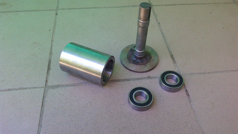

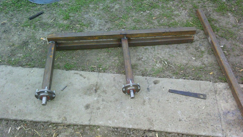

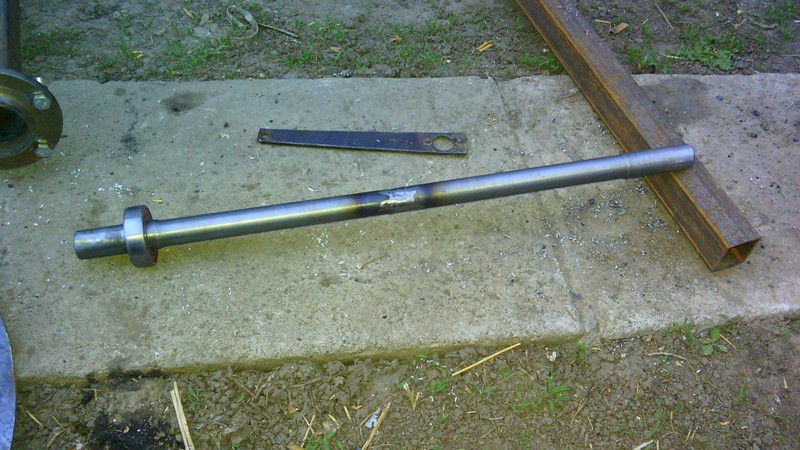

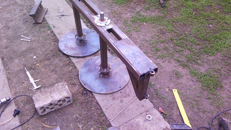

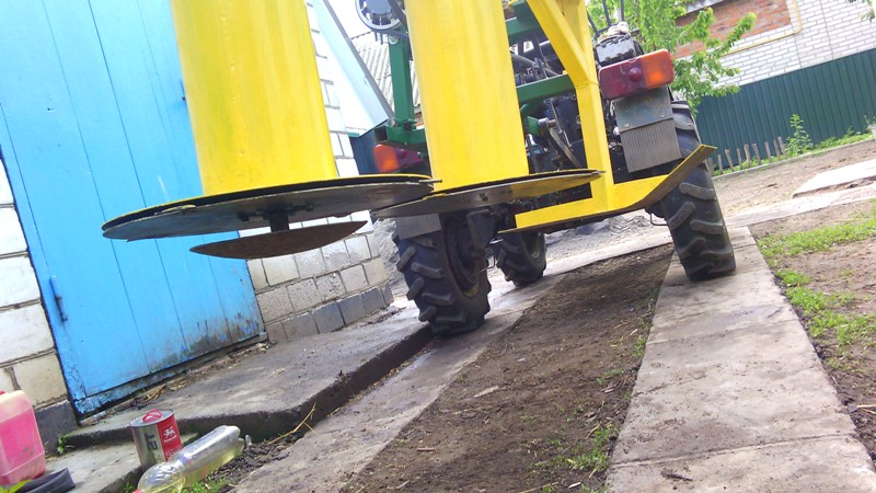

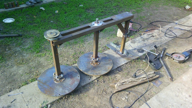

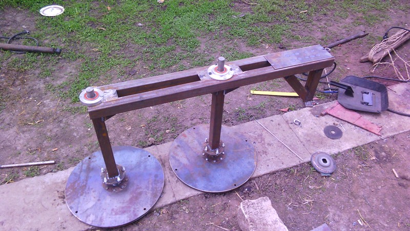

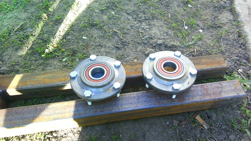

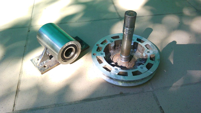

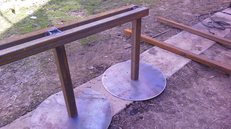

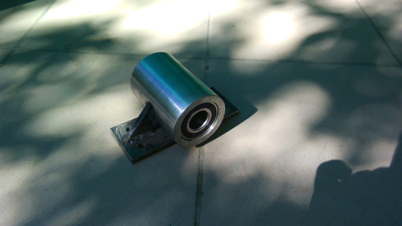

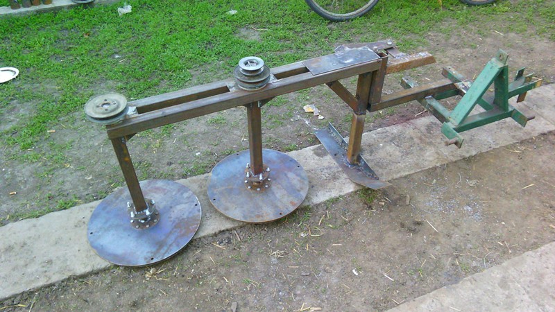

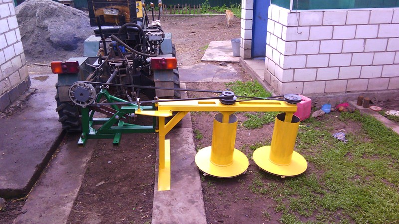

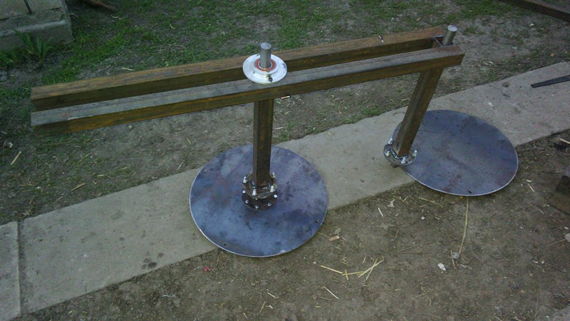

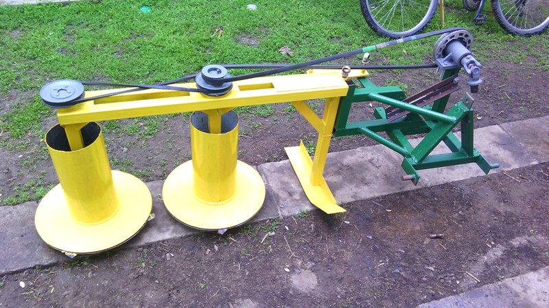

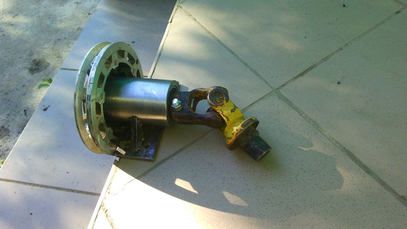

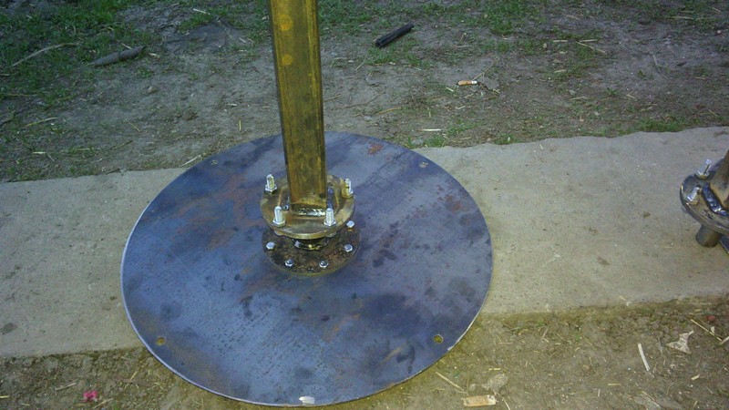

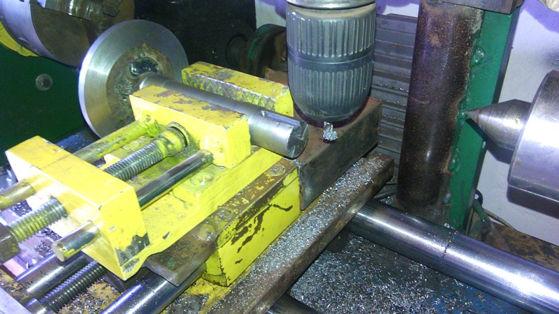

    Hello. My new device
    Homemade rotary mower-img_20170426_111324.jpgHomemade rotary mower-img_20170426_114322.jpgHomemade rotary mower-img_20170426_114353.jpgHomemade rotary mower-img_20170503_173845.jpgHomemade rotary mower-img_20170504_201233.jpgHomemade rotary mower-img_20170504_201244.jpgHomemade rotary mower-img_20170504_201300.jpgHomemade rotary mower-img_20170504_201334.jpgHomemade rotary mower-img_20170504_202230.jpgHomemade rotary mower-img_20170504_202239.jpg

    AT my first observation I thought you were possibly building an over shot mower allow for mowing around a row of small bushes.
    But after I see it complete with the counter rotating disk cutters it closer resembles a small hay cutter.
    Nice job.
    If in fact it is a cutter for harvesting tall grasses which will later be bailed of hauled loose.
    I might suggest that you may find yo will want to add an outer guide on it as well to assist in drawing the fringe of the cut line towards the cutter disk.
    this would create a more defined cut line. if this is a cutter as I have described you might find that you do not want to disks to be counter rotating as well since having the disks rotating in the same direction a natural flow of the cuttings would be laying pretty much in the same direction. This is just an observation not a criticism because I may be looking at it upside down since if the disks are rotating inward from the front only 1 row of material would be created in the first place

    Ok I see the height guide under the outside disk now

    Unusual and well executed, the workmanship is first rate where it counts and I'm geussing 2 minutes with a hose and it's clean? Very nice.

    after taking a couple more looks at his mower I can see where a modified version would work well for me I might have to think about it for a while
    I know the little sickle section teeth would never hold up for my use though.so would have to forge out some blades from leaf springs
