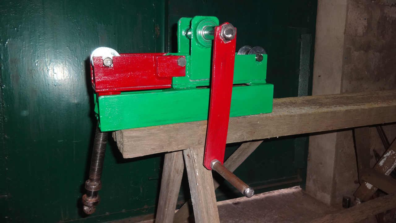

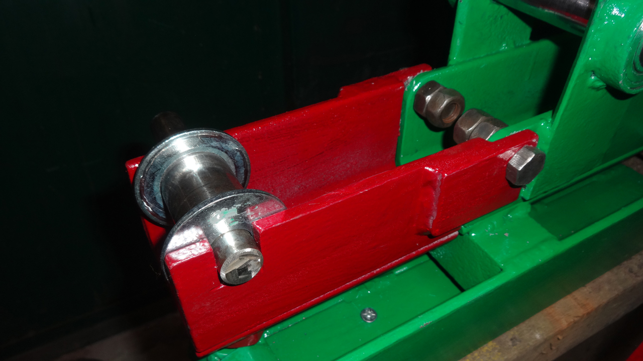

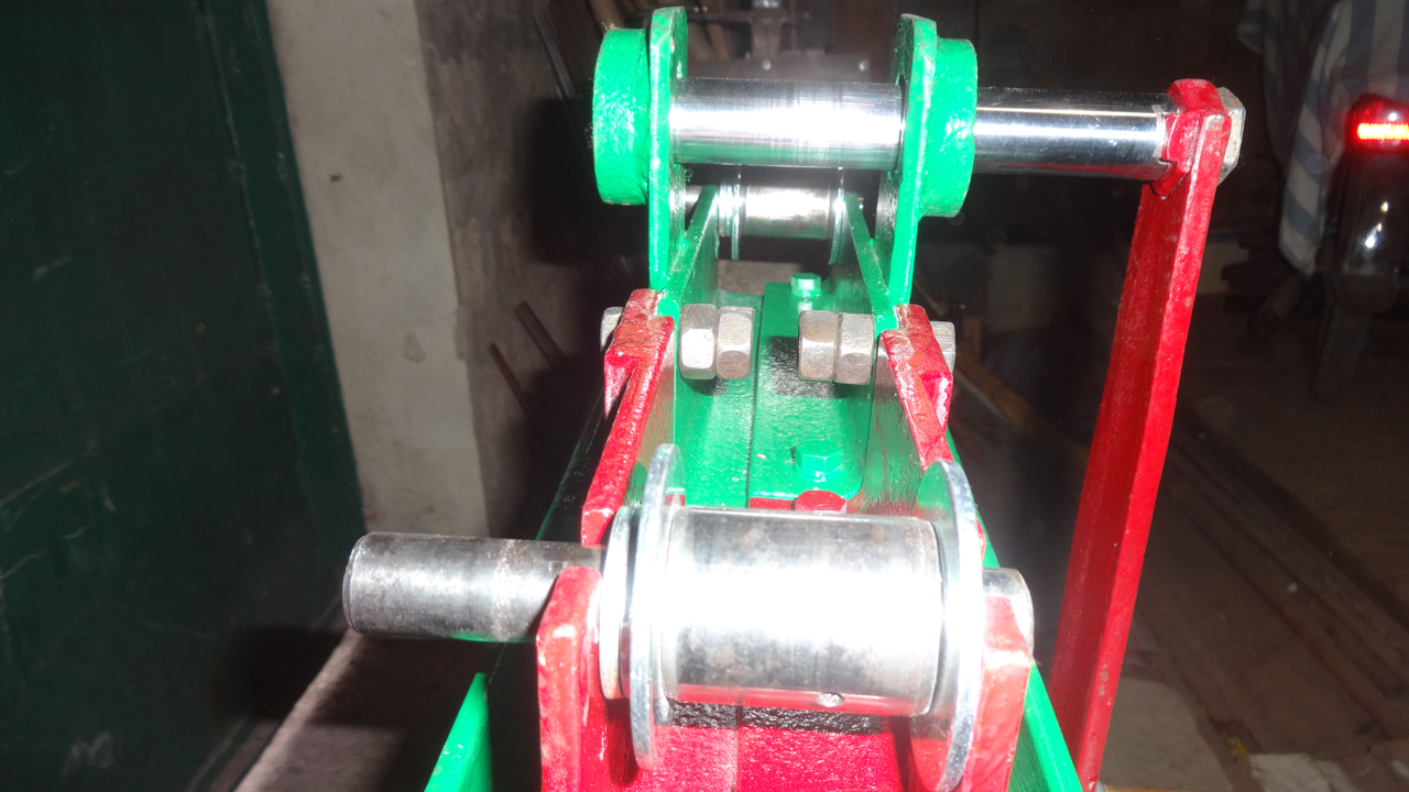

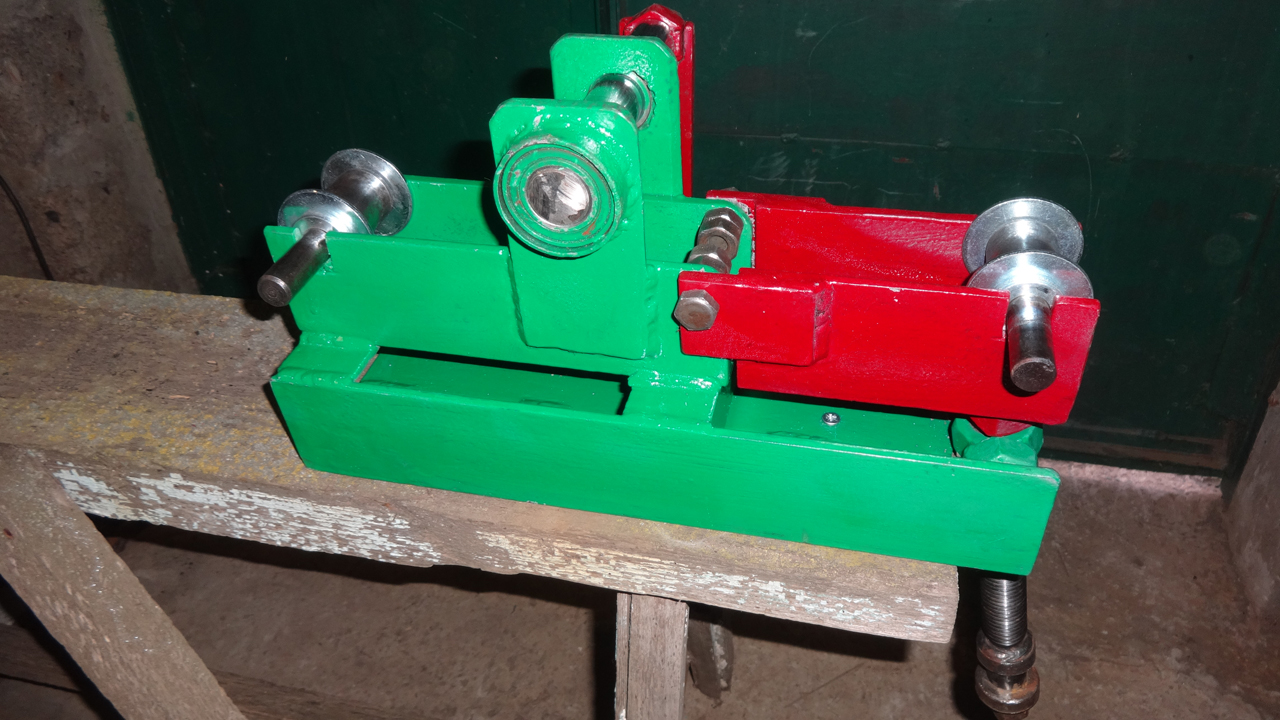

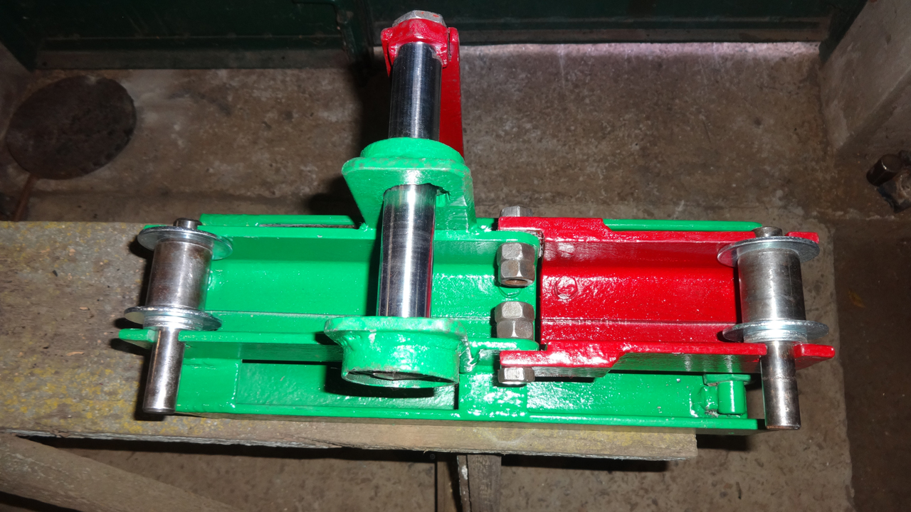

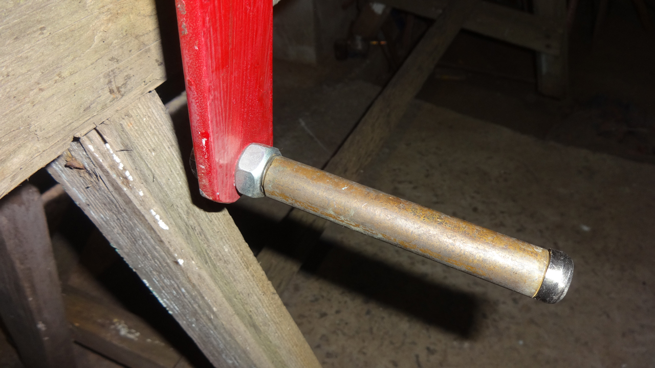

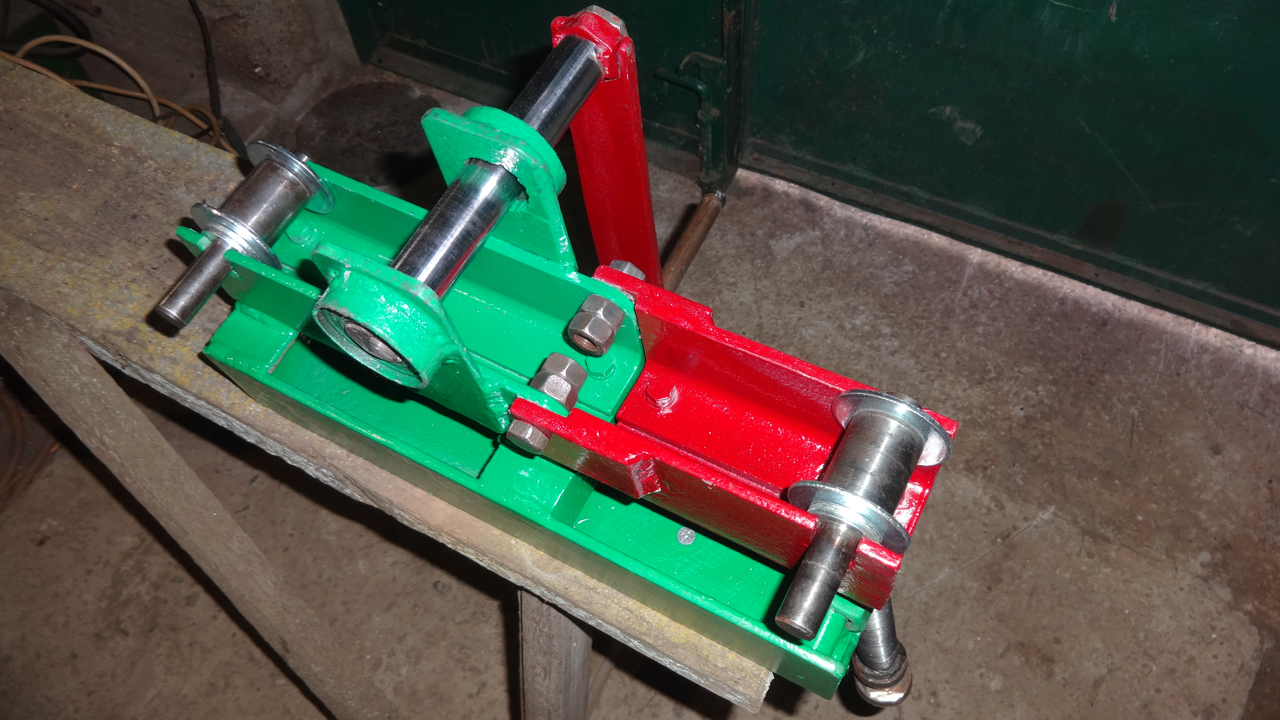

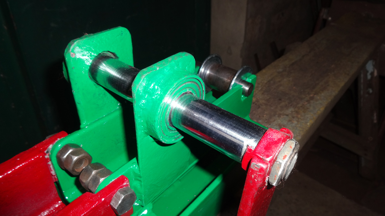

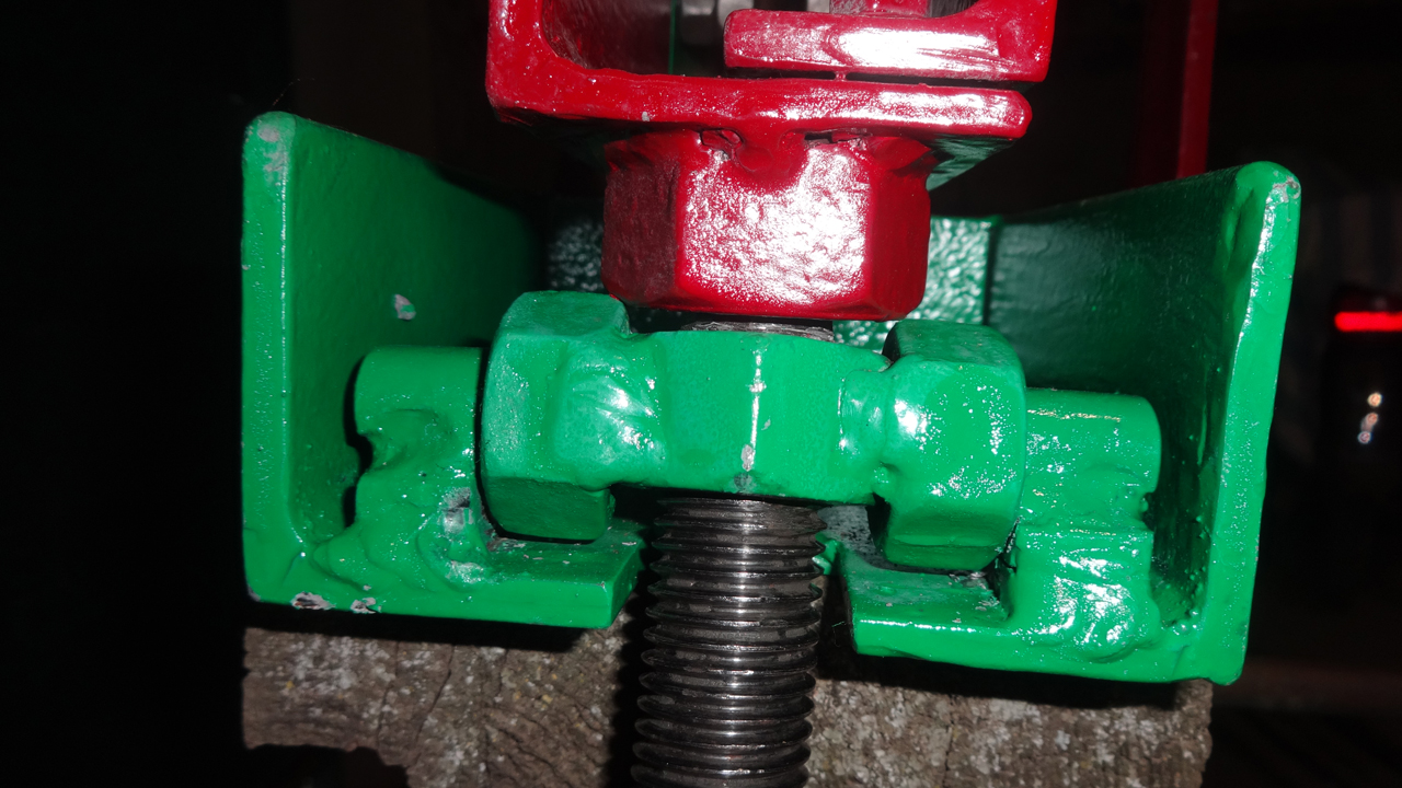

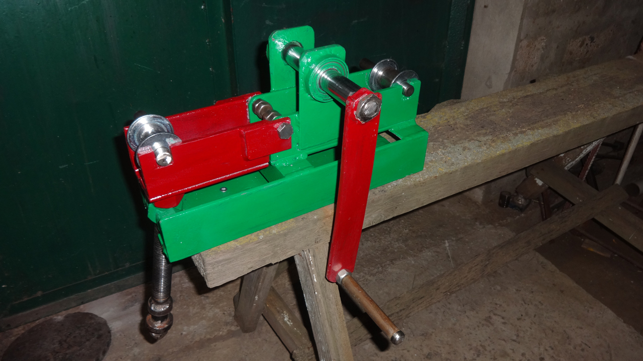

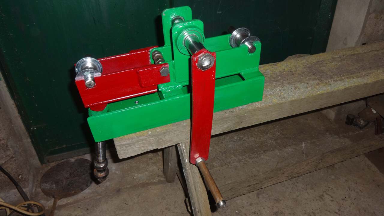

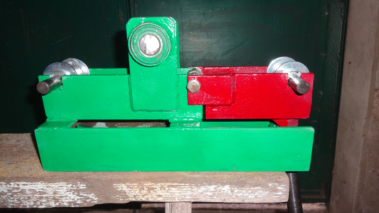

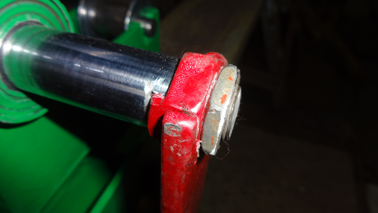

    Hi everyone!

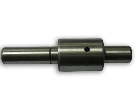

    I present to you a homemade roll bender for Square Pipe and Flat Steel. I used the lower support shafts of the bearings of the car pump. Upper shaft used from the rod of the hydraulic cylinder. The frame is assembled from an steel angle.
    Here the photo in the maximum resolution: https://photos.app.goo.gl/3GLgvzr86QWjM4sH8

    Excellent. I wish you would post a materials list
    Supporting Member liberal's Avatar
    Nov 2018
    73
    44
    Thanked 285 Times in 51 Posts
    liberal's Tools
    Used mostly steel angle.
