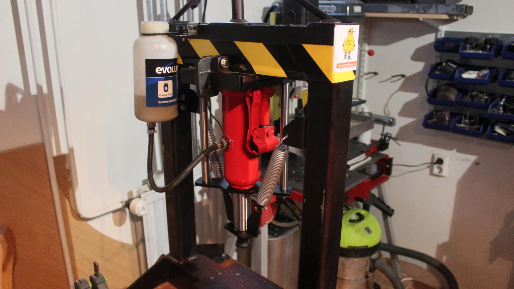

    Latest add:
    Wanted to add bigger jack to my press.
    To get most of the pressure to the small area, i decided to turn the jack upside down.
    This way i can mount hole punching and stamping dies directly to the cylinder of the jack.
    In use:
    Stored:
    Takes about 10 seconds to assemble / disassemble.
    Used cheap 8 ton jack that was sealed with welds. So, i tried this way.
    Actually this should work with "any" jack, so i most likely do neater looking version soon.
    Here is the video:

    More info:
    Picture shows how springs goes between the rods that hold the jack
    Jack mount is locked on its place with two M8 screws. Lid in front is weld to the mount...
    Latch on the back is bolted to the press frame..
    This is the reason why i welded similar plates to the bottom and upper bars of the frame..
    I can use same dies with both jacks.. when i need to bend thicker materials i use bigger jack..
    With thinner ( <5mm ) i use smaller one, wich is more accurate and faster to use.
    I used surplus cutting fluid container as a oil container,
    for mounting it to the press, i used clamp that's originally intented to connect flashlight to the welding mask.
    Hose clamps..
    And why i originally wanted to add this jack to my press.. i had this idea in firts place when i made the original frame, but no i needed it. So, i made it.
    For stamping sheet metals. These are going to be reflectors for small leds. I got idea from Tony Foale, i decided to place dozen small led spotlights to my shop where i need more light.
