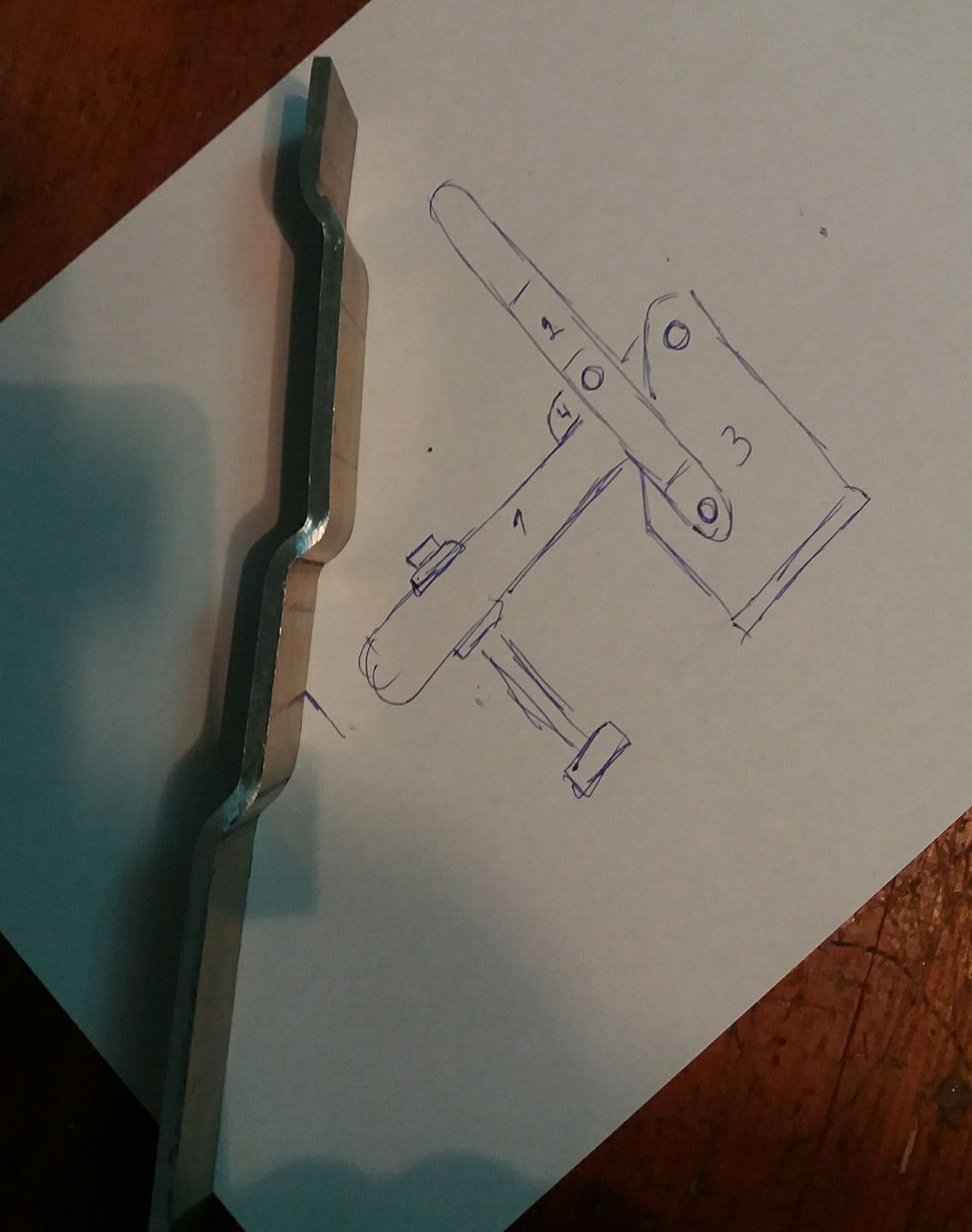

    Btw. Made first parts to my "No weld quick action hold down clamps". Brake seems to work just like i hoped.

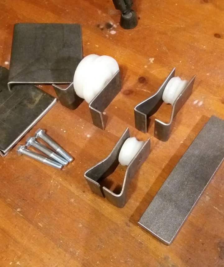

    Decided to make simple pipe bending attachment first.
    Parts. Video coming little later.
    Seems to work nicely.
    This is for 12mm pipe. And just a prototype.

    Simple pipe bending attachment.
    Material:
    Surplus steel, nylon replacement heads from the dead blow hammer, bolts.
    It can be used to bend pipes and rods to 12mm diameter. ( grooves on the dies are with 12mm diameter )
    Same idea works with bigger pipes too, radius of the center die needs to be bigger than this one tough.
