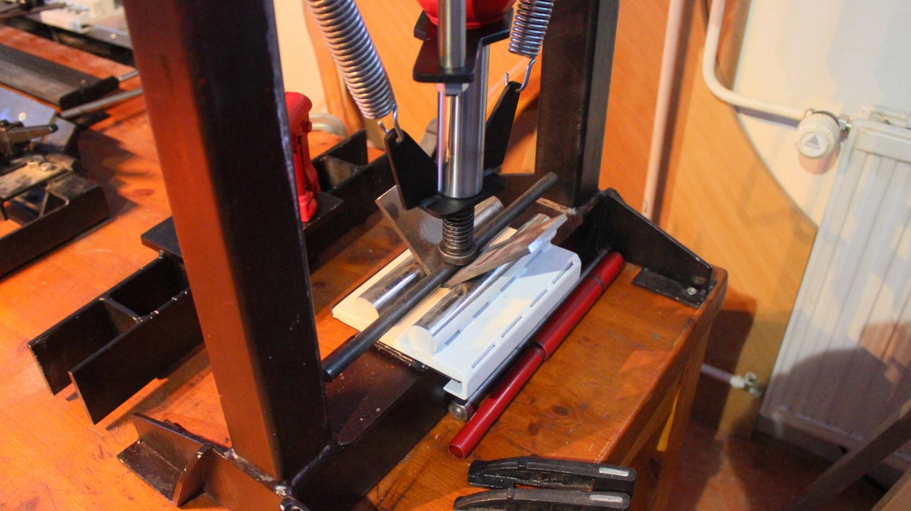

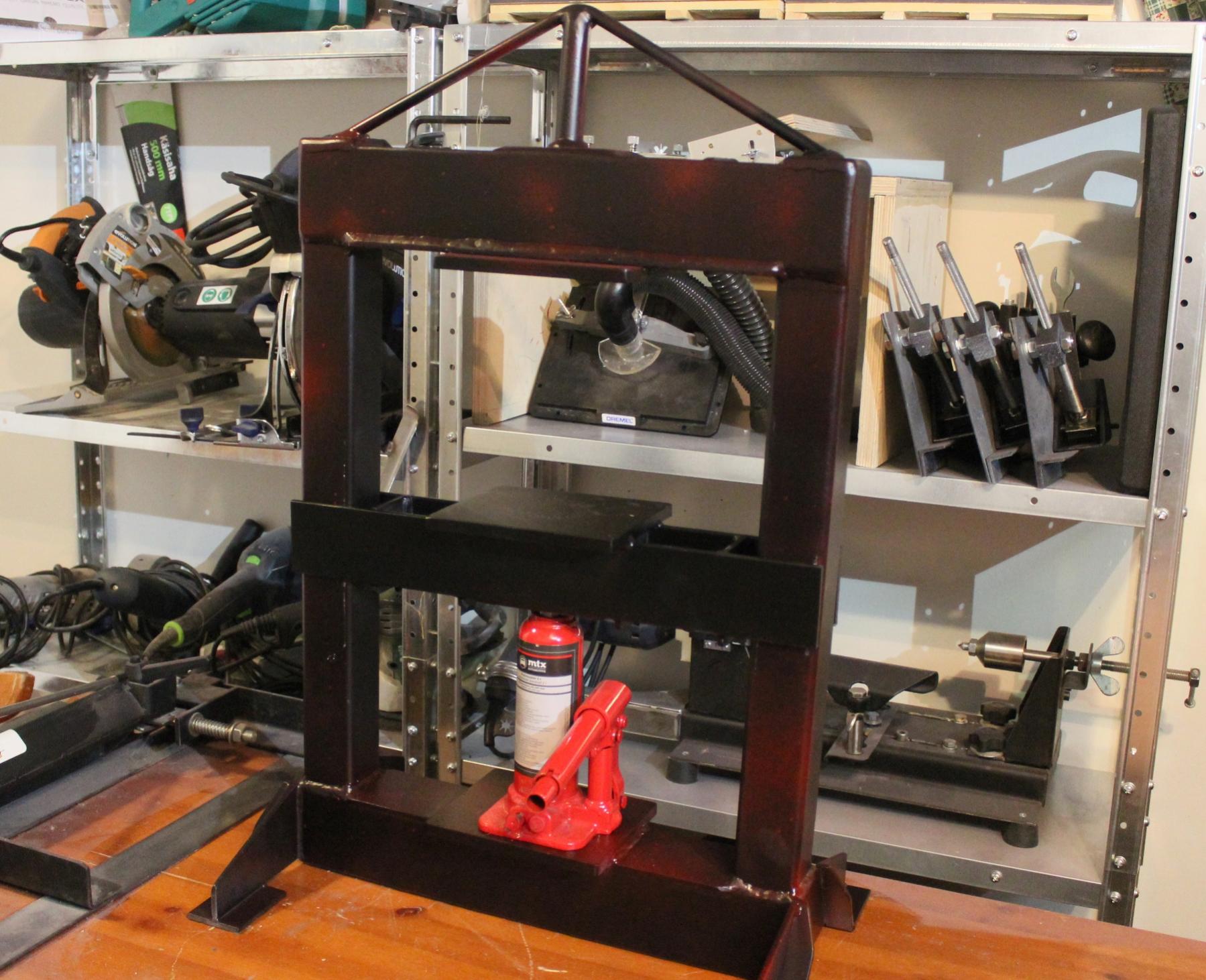

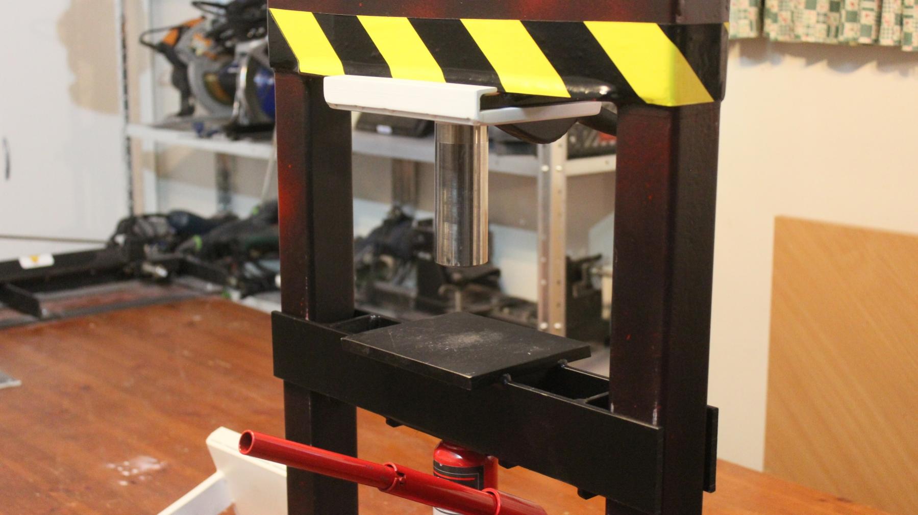

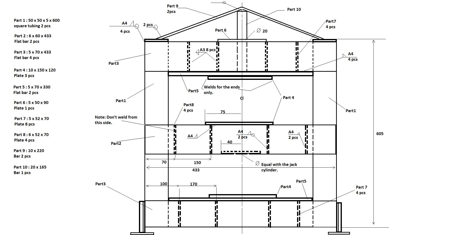

    Made a press.
    Later im going to add brake and rolling possibilities to it, that's why i placed jack down.
    "sled" takes support from the cylinder of the jack, that makes it to travel straight.
    Plan:
    Welds made with Esab ok 73.15 welding rod.
    Extra support rods on the top are just " if i someday need to use it with stronger jack, i can use it on traditional way ( jack placed up )".
    EDIT: here is the jack placed up version. Frame is now tested to handle use with 8 ton jack.
    Attachment 23110
    Takes about 10 seconds to assemble / disassemble.

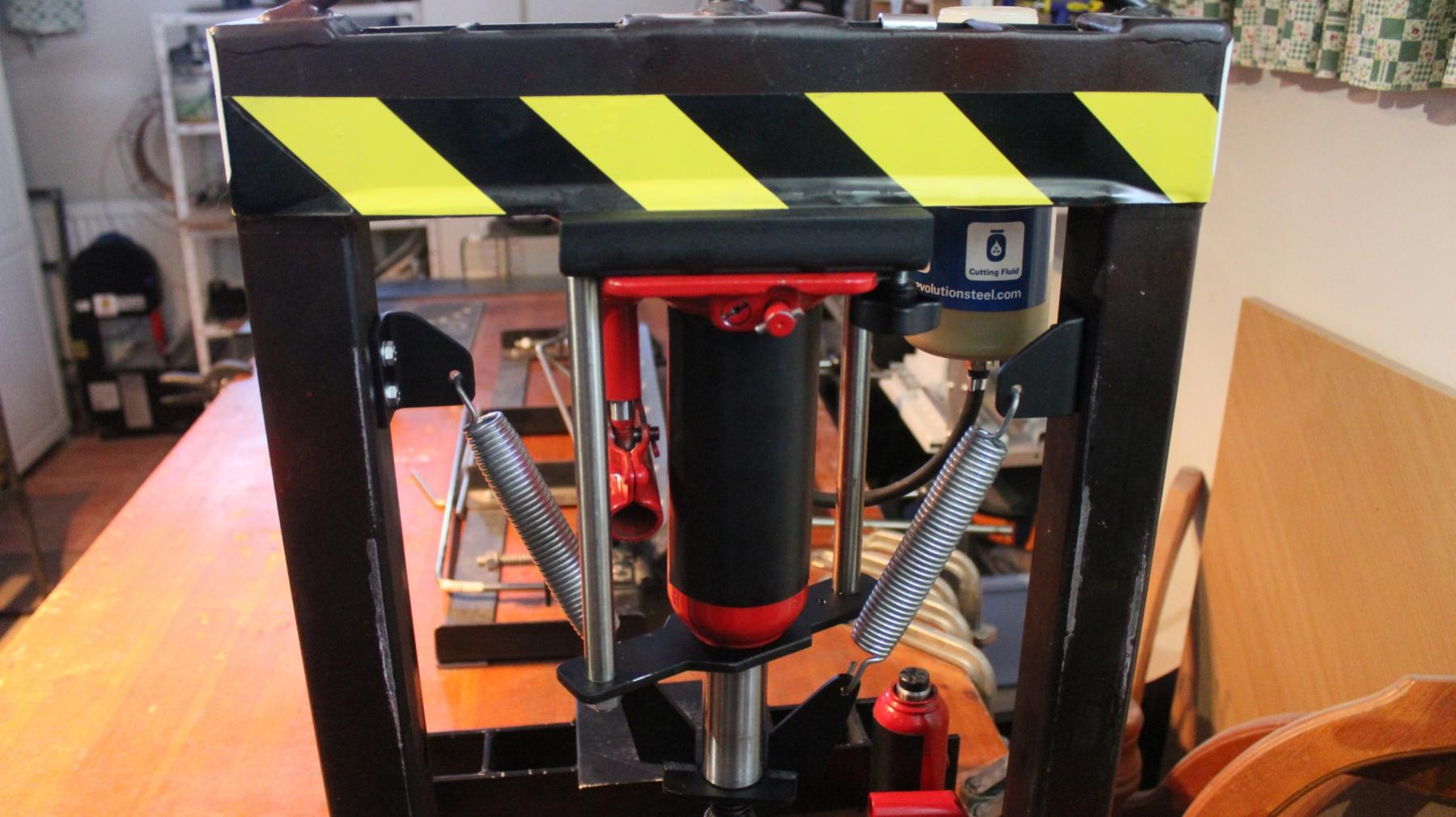

    Springs are surplus from trampoline. Bigger holes drilled with a variable wood cutter, with diy hss blade.
    Used cheap 8 ton jack that was sealed with welds.
    Actually this should work with "any" jack, without need to open it.
    Here is the video:
    More info:

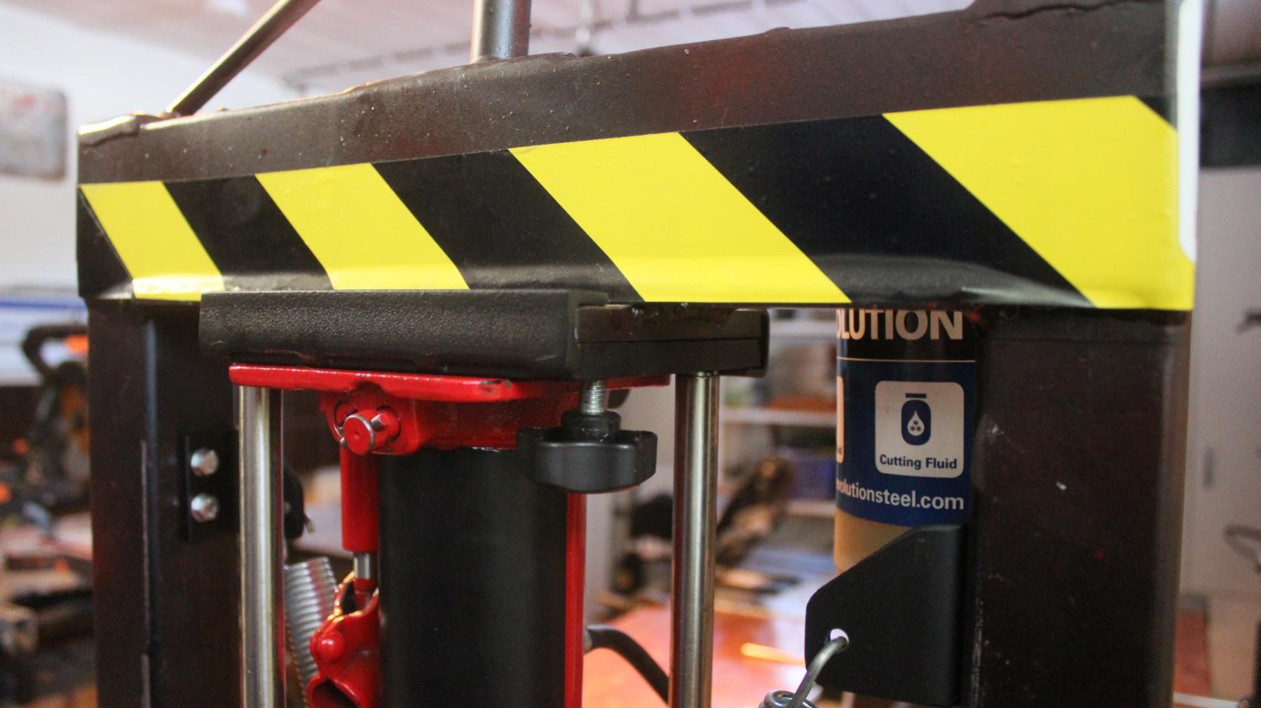

    Picture shows how springs goes between the rods that hold the jack
    Attachment 23112

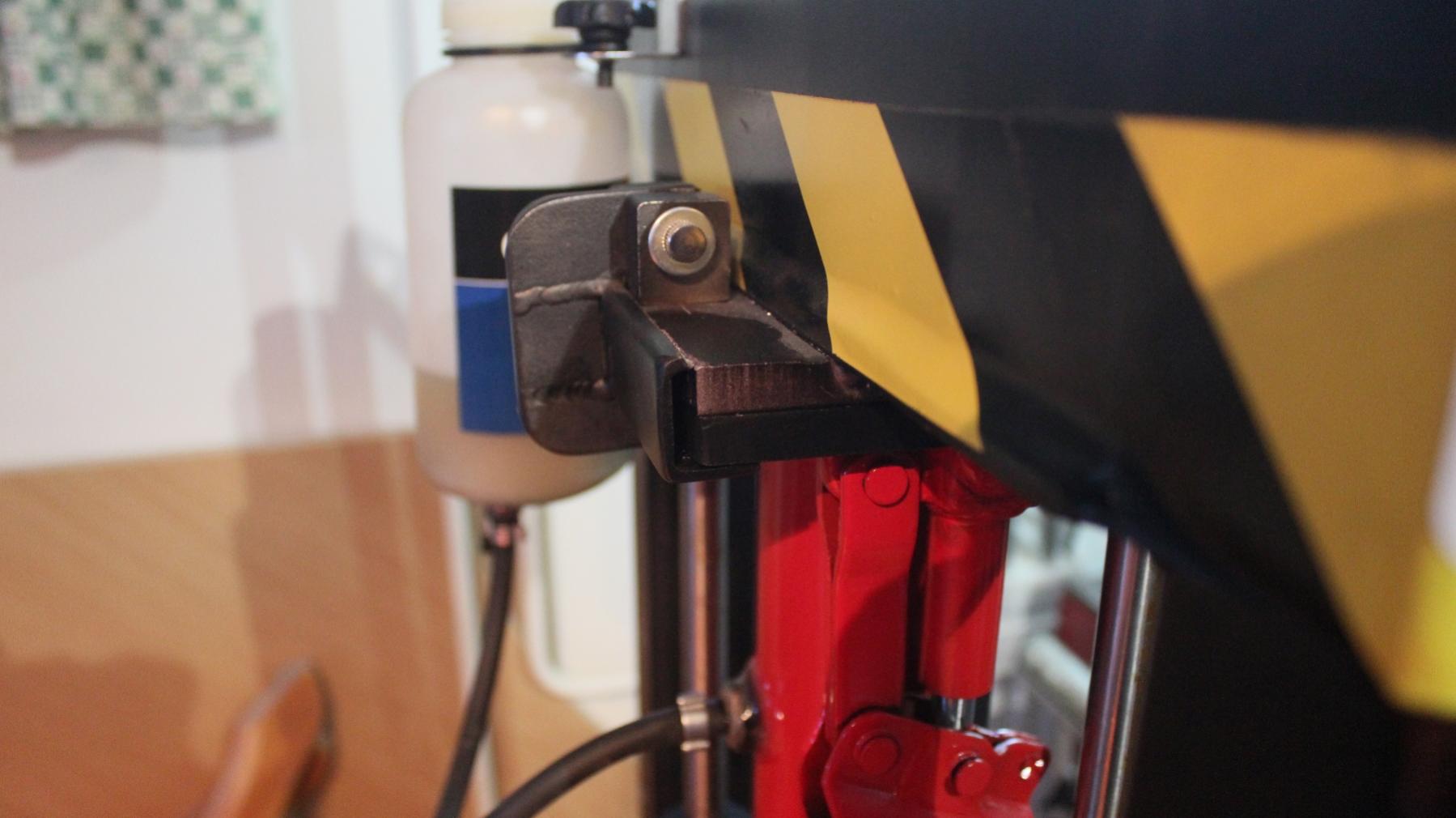

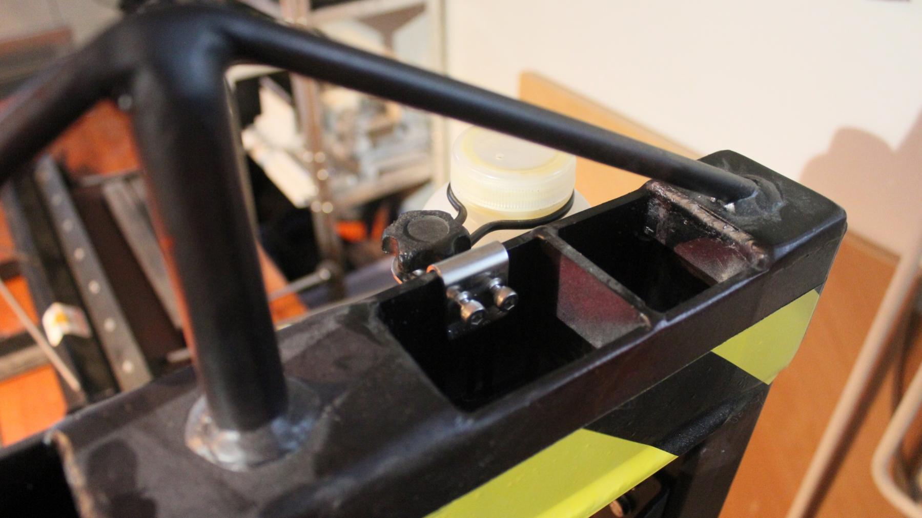

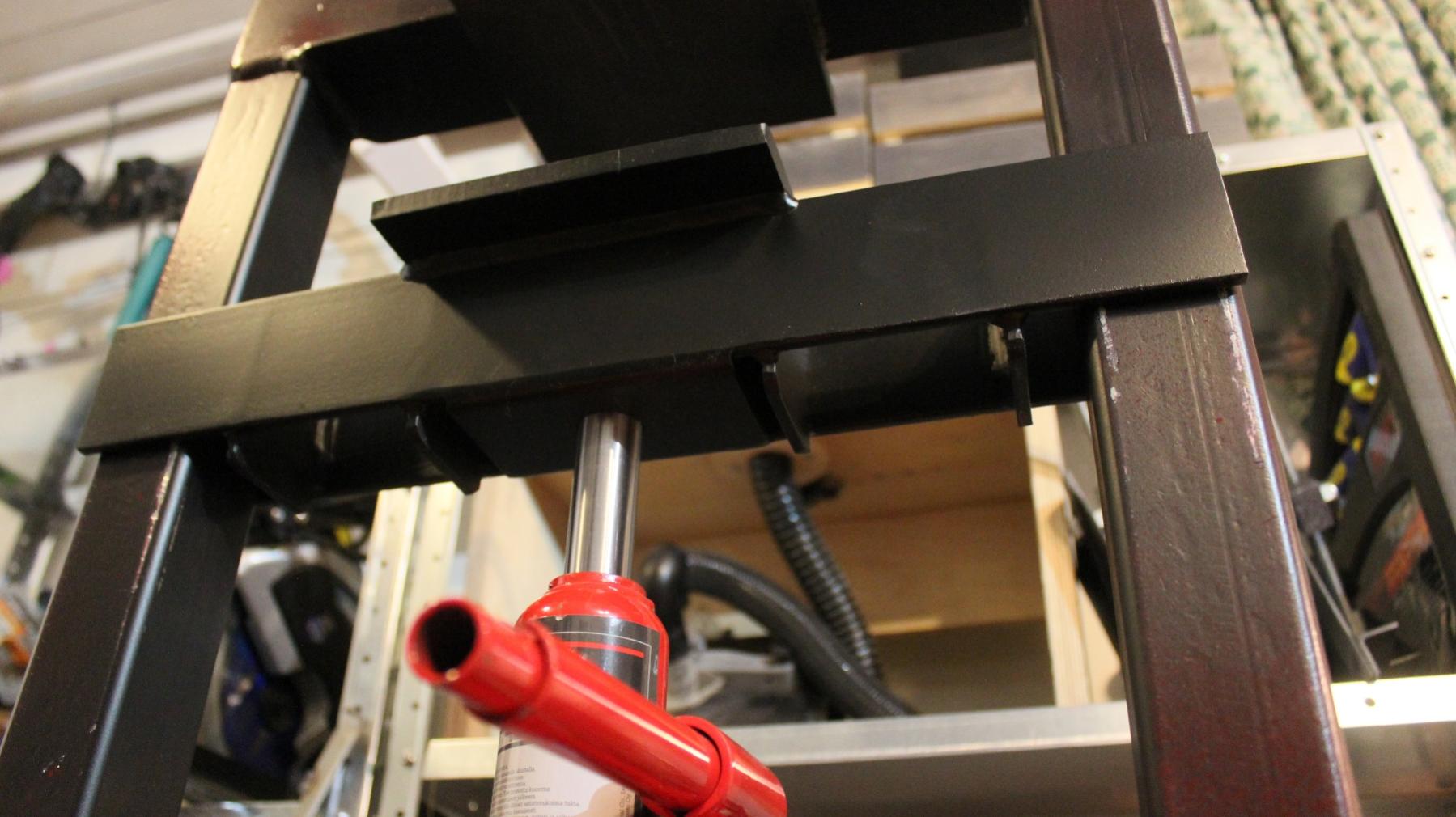

    Jack mount is locked on its place with two M8 screws. Lid in front is weld to the mount...
    Attachment 23113
    Latch on the back is bolted to the press frame..
    Attachment 23115

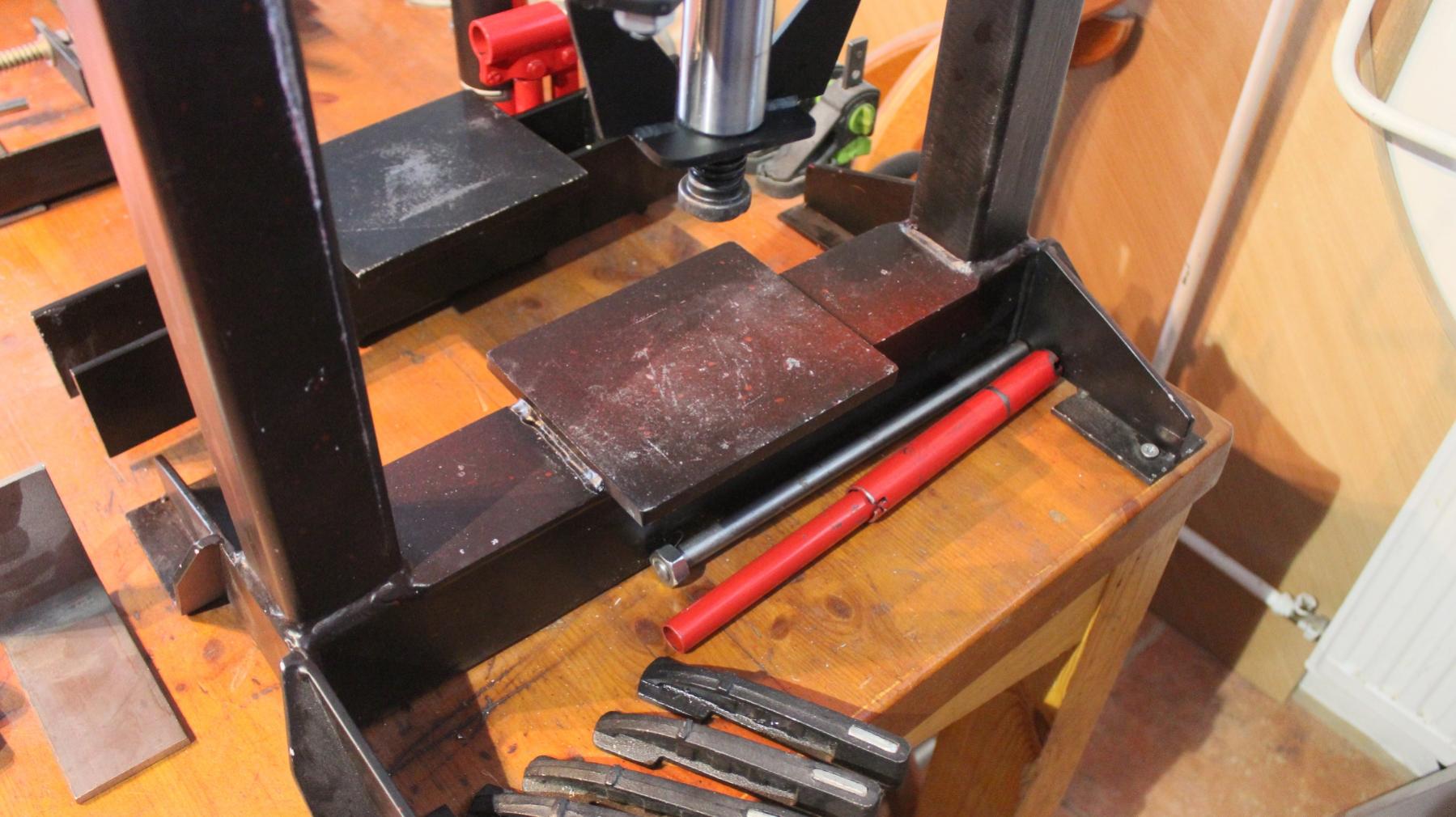

    This is the reason why i welded similar plates to the bottom and upper bars of the frame..
    Attachment 23116
    I can use same dies with both jacks.. when i need to bend thicker materials i use bigger jack..
    With thinner ( <5mm ) i use smaller one, wich is more accurate and faster to use.
    Attachment 23117

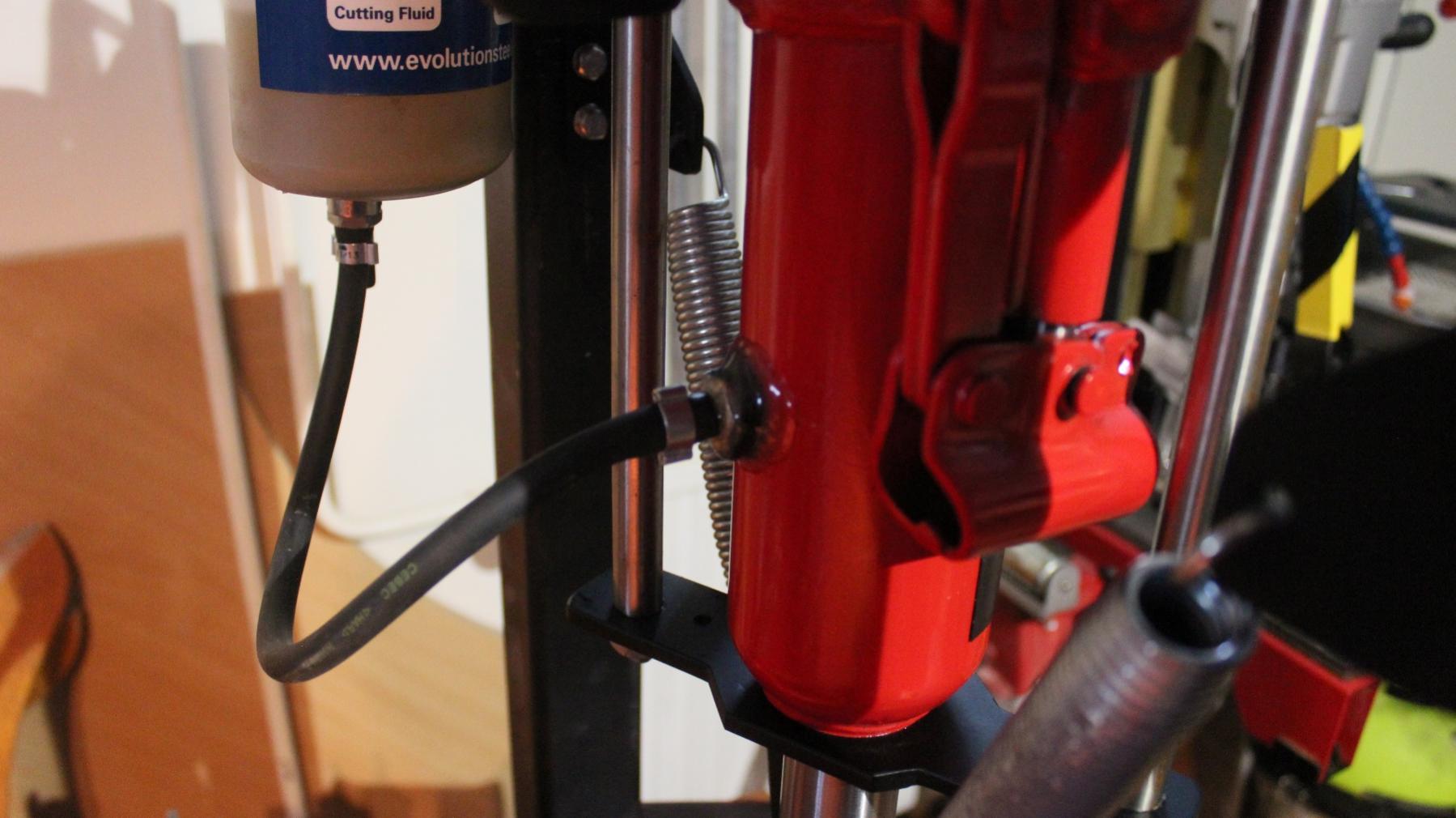

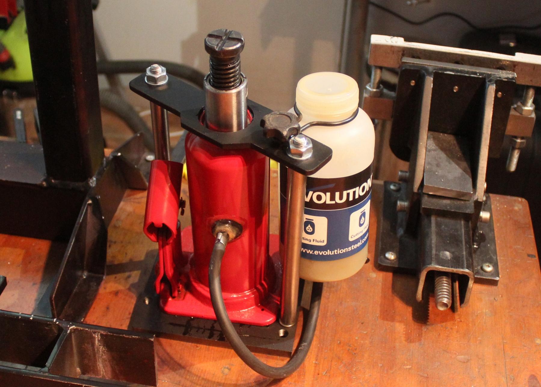

    I used surplus cutting fluid container as a oil container,
    for mounting it to the press, i used clamp that's originally intented to connect flashlight to the welding mask.
    Attachment 23118
    Hose clamps..
    Attachment 23119

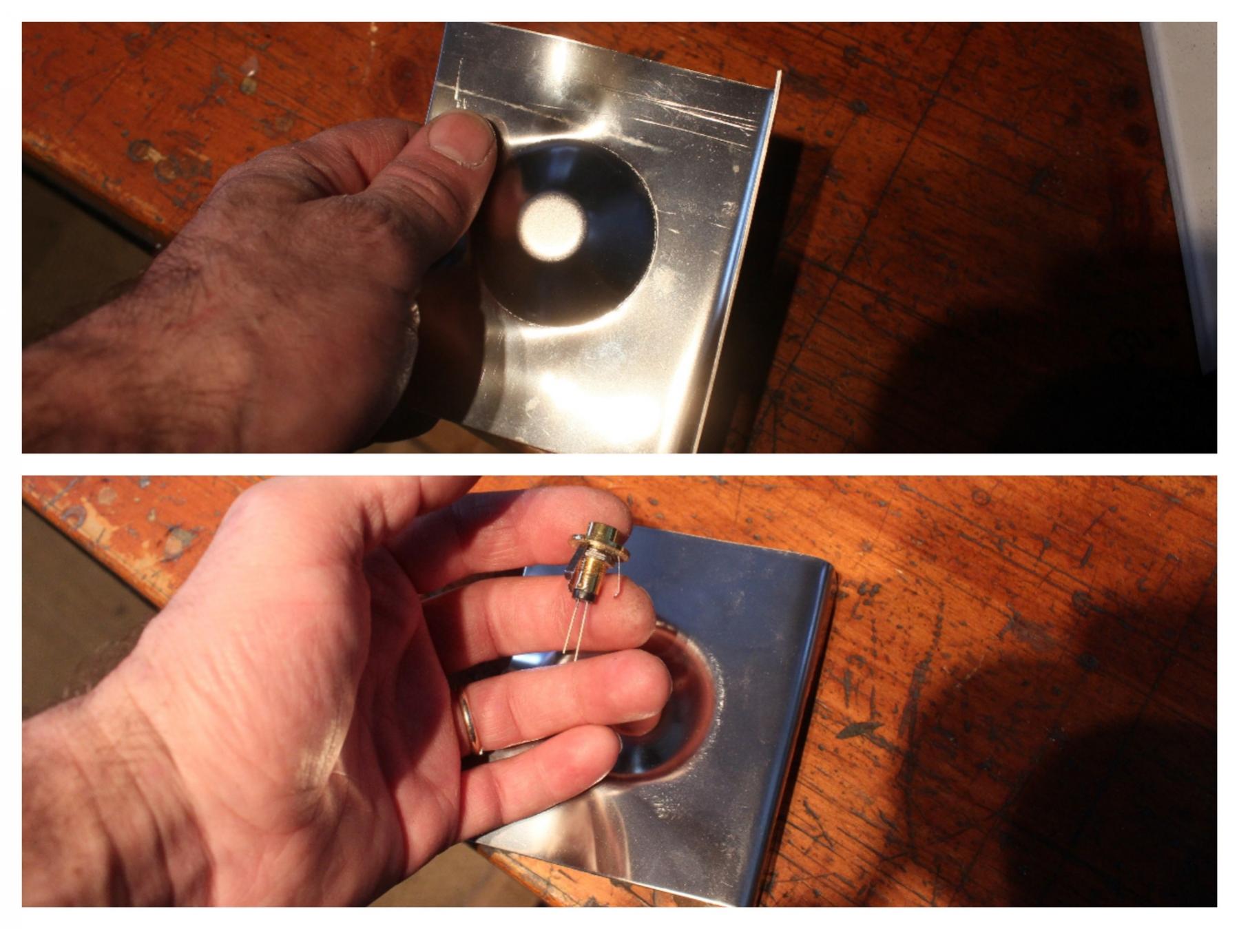

    For stamping sheet metals. These are going to be reflectors for small leds. I got idea from Tony Foale, i decided to place dozen small led spotlights to my shop where i need more light.
    Attachment 23120

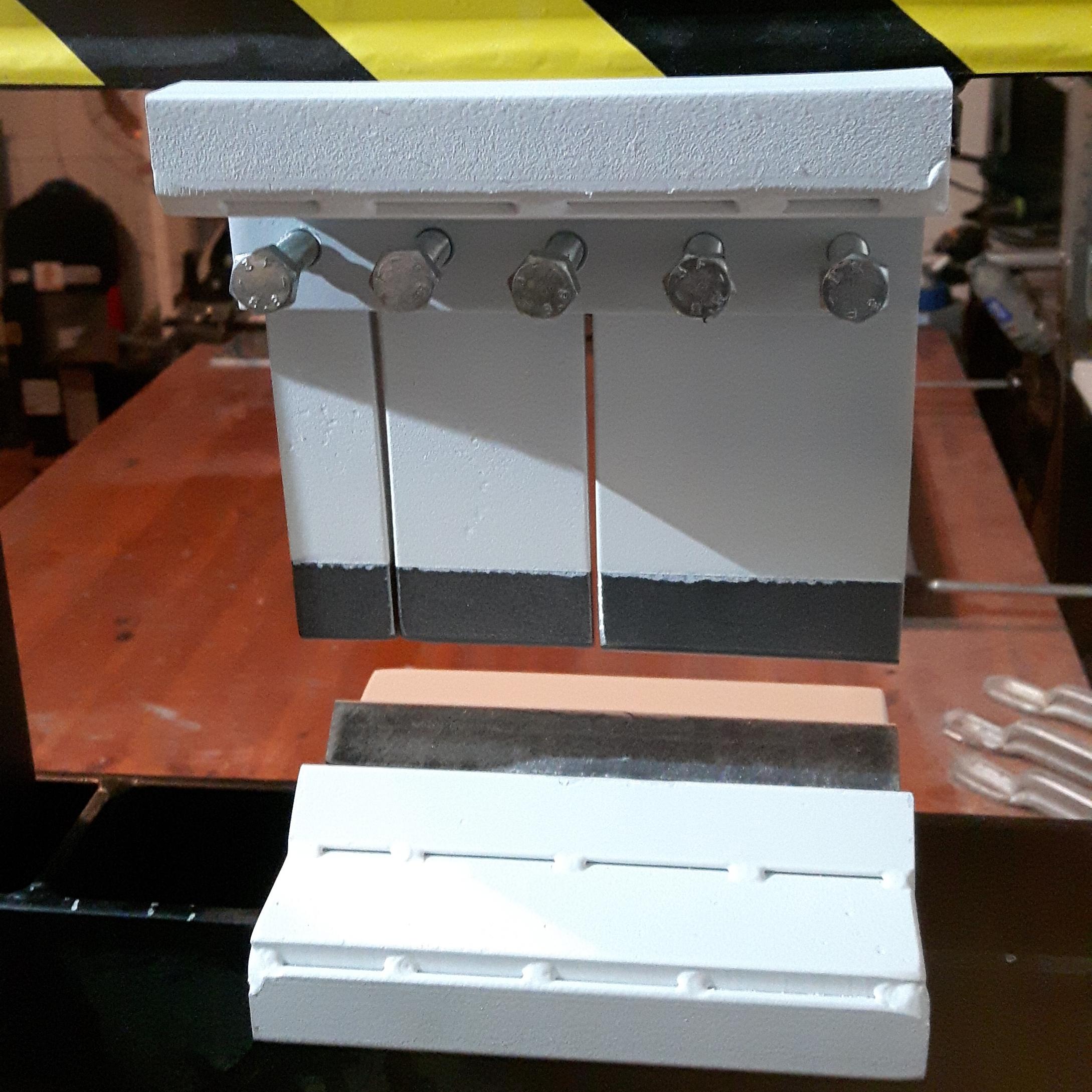

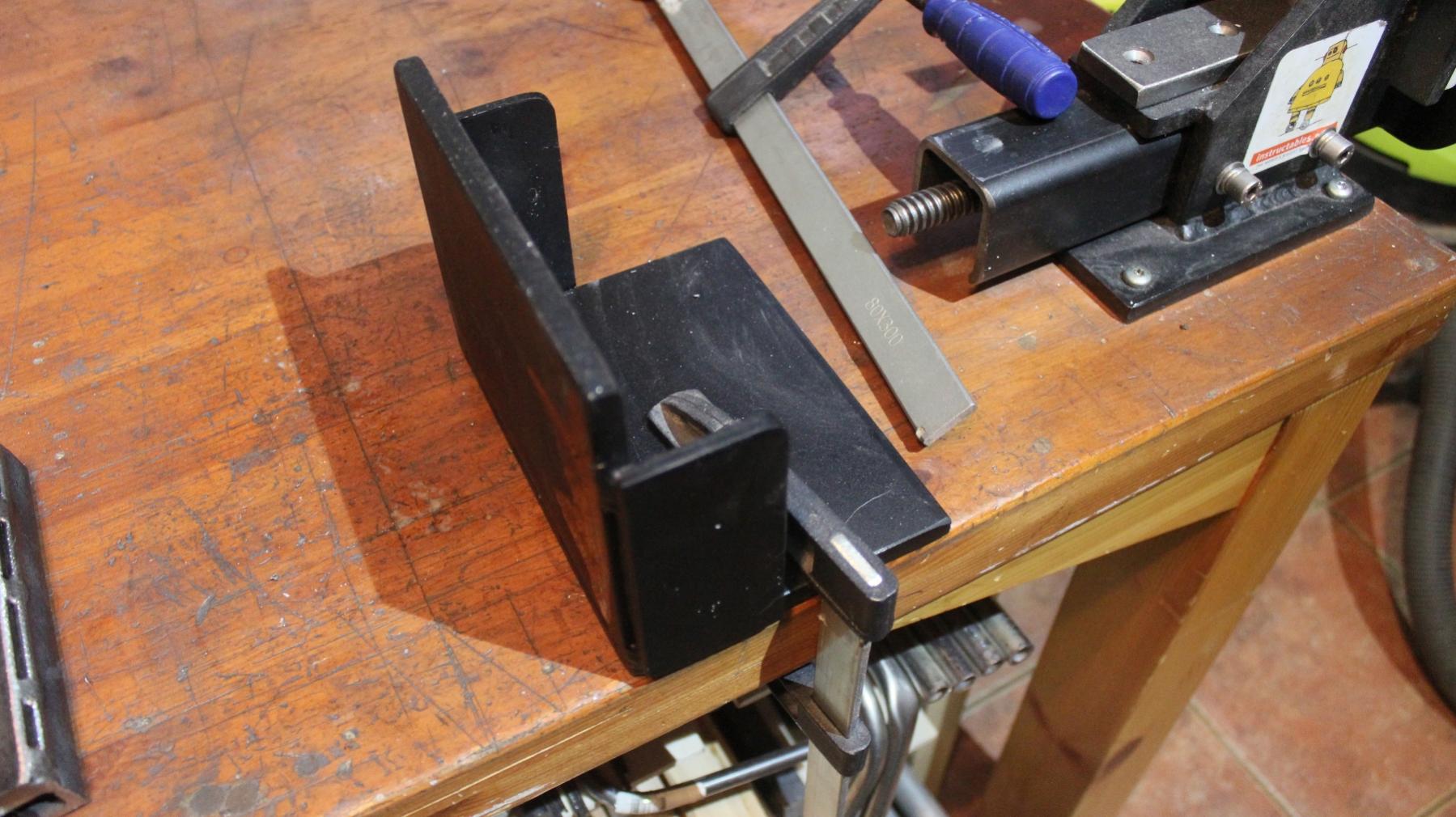

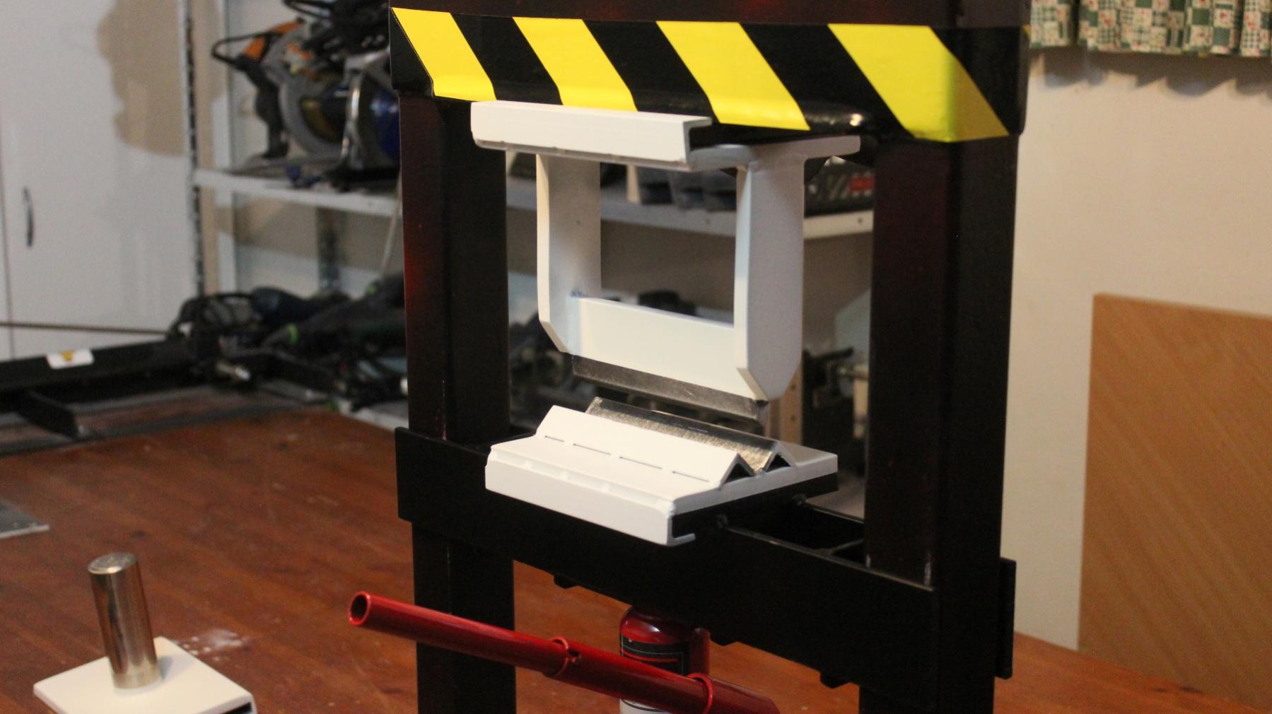

    Here's first adds to it.

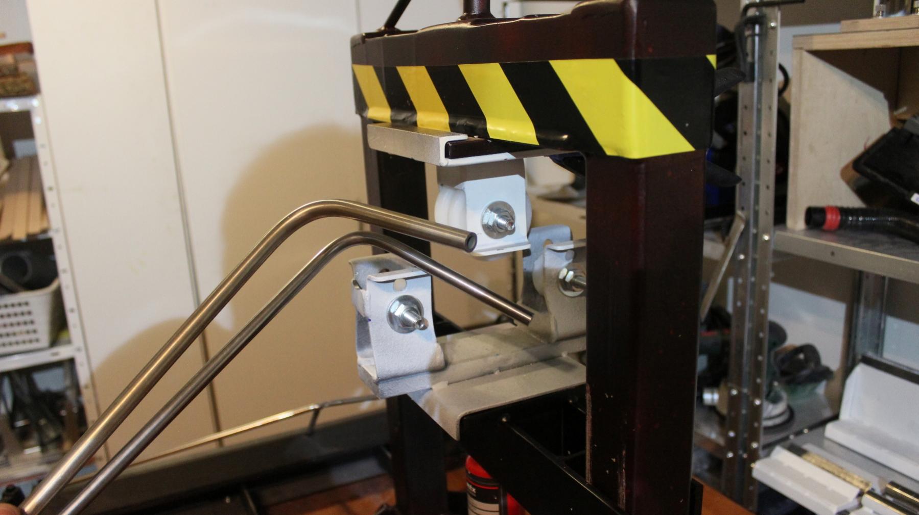

    "Finger"

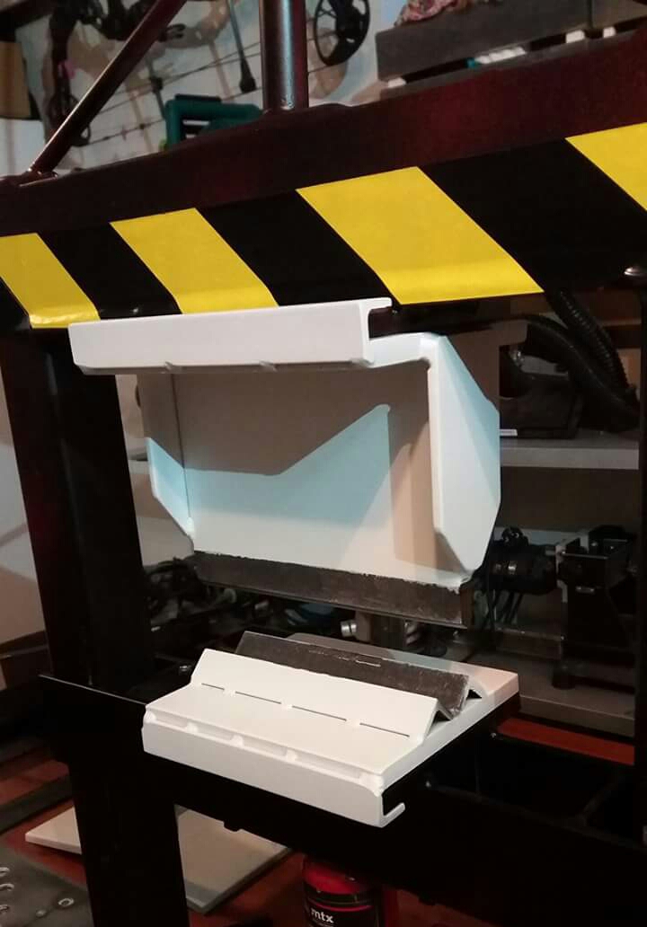

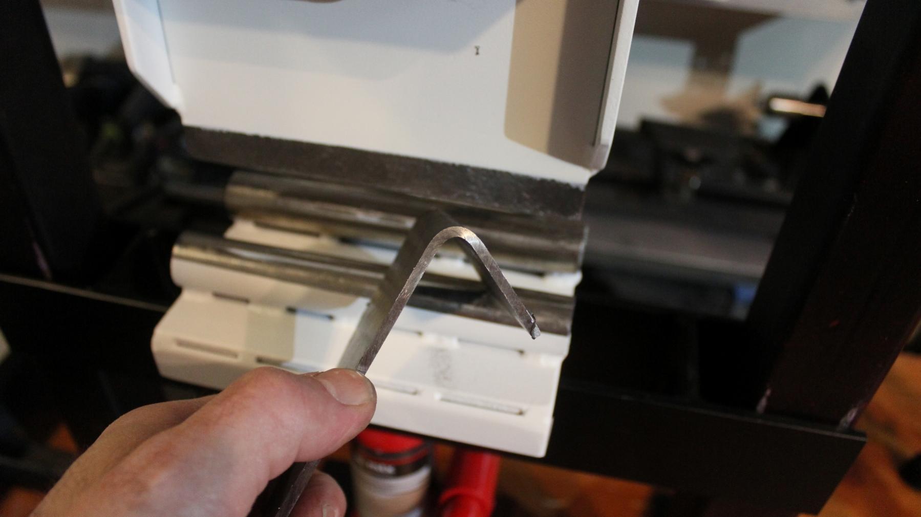

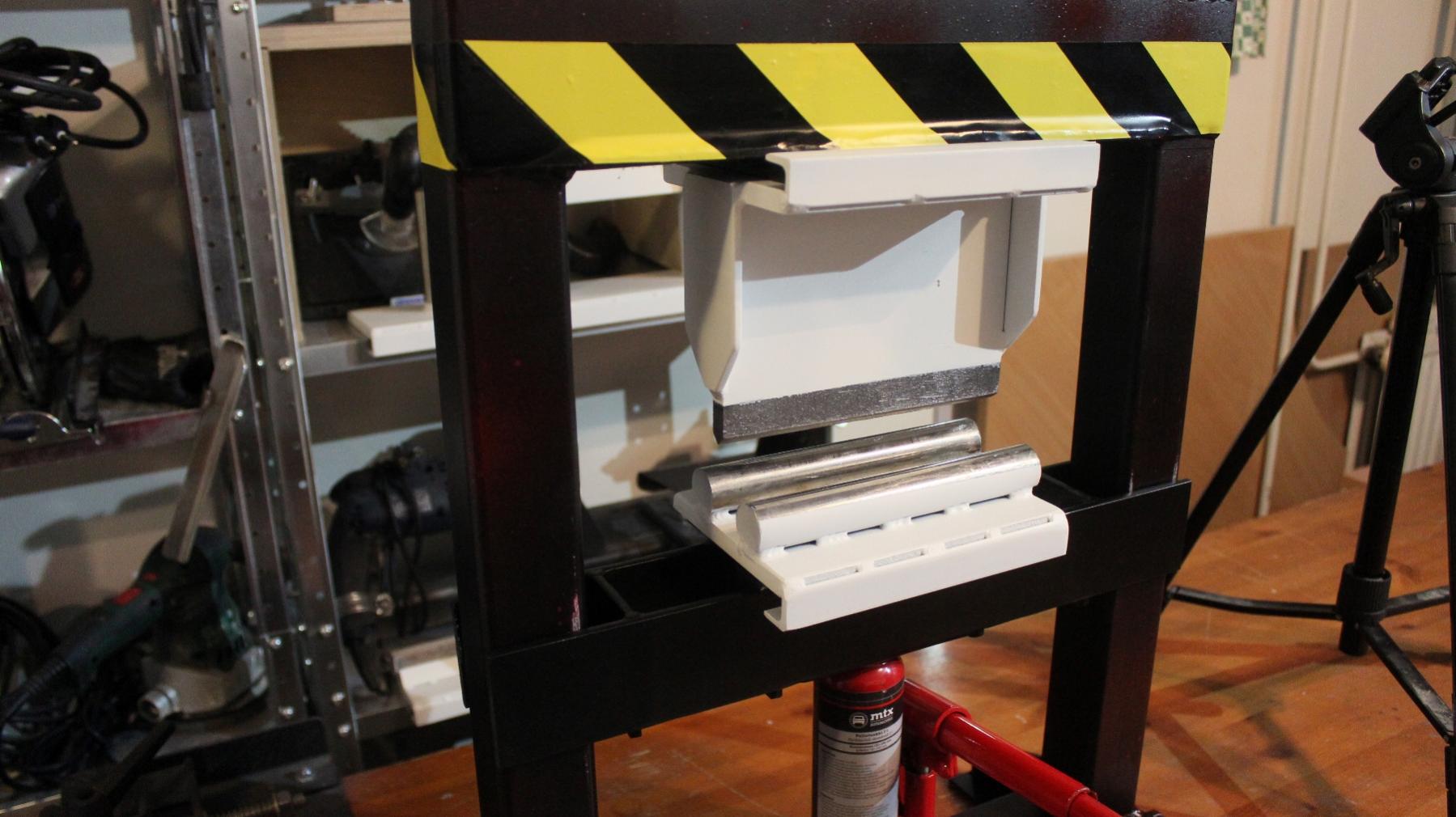

    Bending brake.
    Opening in the blade allows me to bend u-shaped parts.
    Another blade without opening, for thicker materials.
    Easy to change and mix blades and facings for desired radiuses.

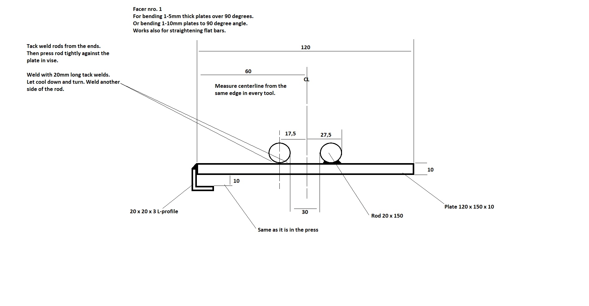

    Material: 10mm steel plate, 3x 30x 30mm L-profile, 40mm axle
    Another facing. Clearance between rods is 15mm. Radius of the rods 20mm.
    For bending over 90 degree angles to plate between 1-5mm, and 90 degree angles for plates between 1-10mm.
    Suits also for straightening.

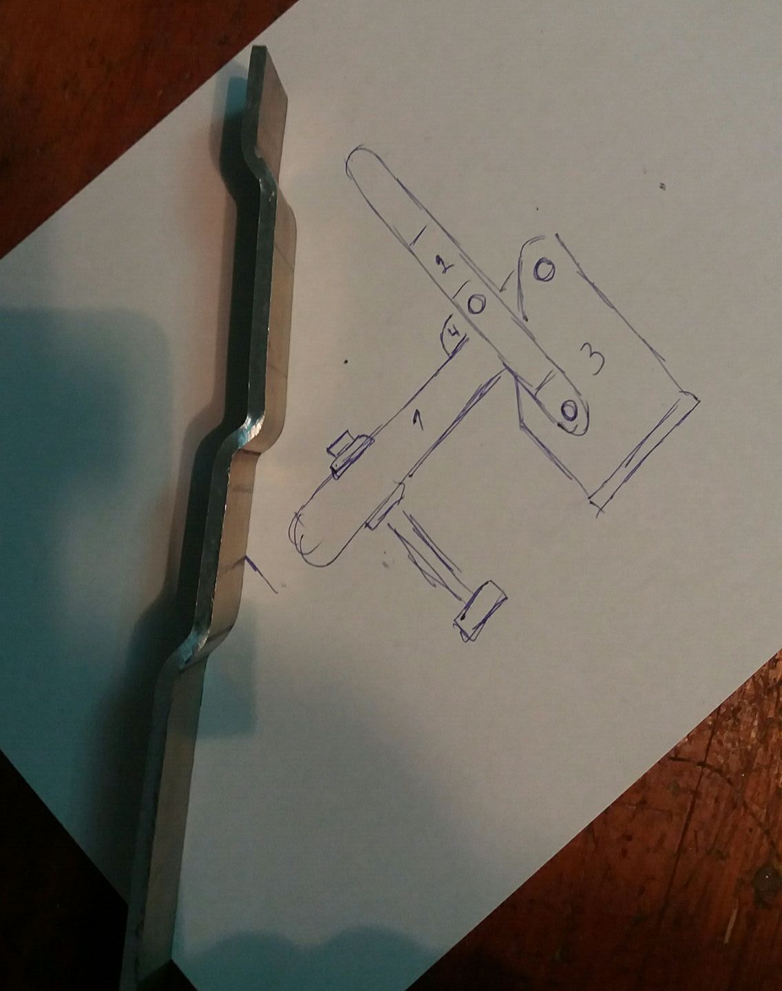

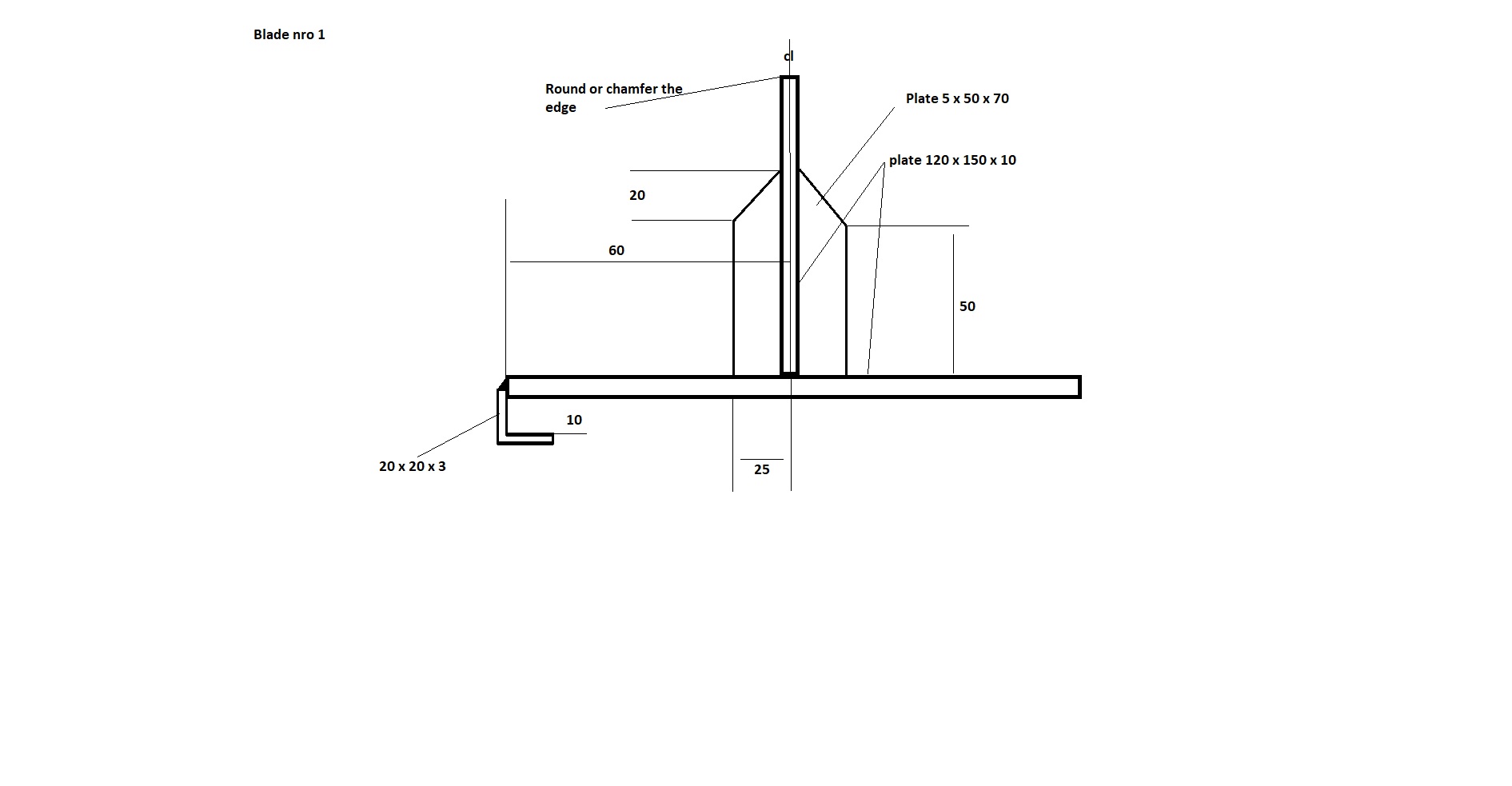

    Plans for two tools as an example.
    Video shows the use:
    Brake works nicely:

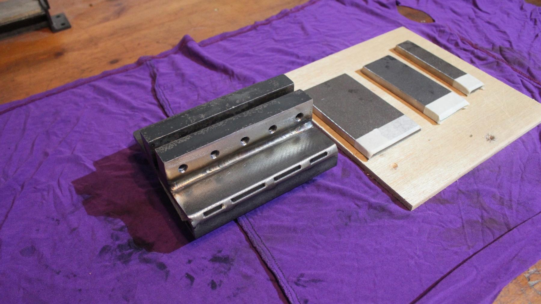

    Finger dies.
    1,2 and 3" wide dies. Gives somewhat enough possibilities to mix needed widht.
    10mm plate with 20mm x 20mm bar on both sides.
    Dies are placed between bars and secured with M8 bolts.
    Intentionally too long bolts, i like its easier to tighten/ loosen over long bolts with ratched.
    Dies are also 10mm plate. Bending edge is grinded to 45 degree angle from both sides and slightly rounded, to avoid deep marks on workpiece.

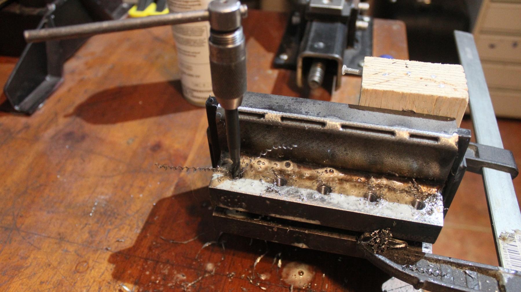

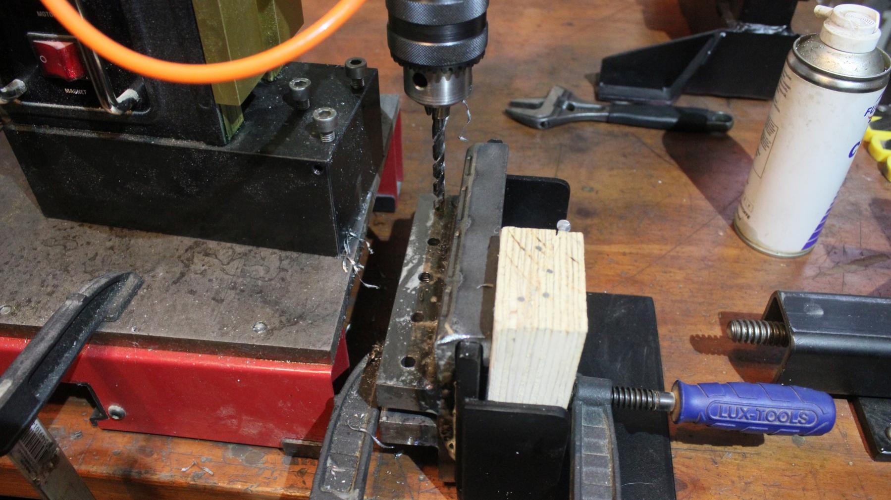

    Made this tool some time ago. Its for drilling to the edges of the plates.
    Attachment 22844
    I marked placement of the holes before welding. Straightened the baseplate with press after welding.
    Then drilled 6.8mm holes
    Attachment 22845
    Threaded with M8 tap.
    Attachment 22846
    Cleaned and painted.
    "Finger"
    Bending brake.
    For bending over 90 degree angles to plate between. 1-5mm

    Plan:
    Stucture is tested with 6 ton jack.
    Frame doesn't bend when pressing with full force.

    Tools are made from:
    10mm steel plate, 3x 30x 30mm L-profile, 40 and 20mm axle
    Clearance between rods in the lower facing is 15mm. Radius of the rods 20mm.
    Its for bending over 90 degree angles to plates between 1-5mm, or 90 degree angles to plates between 1-10mm, it also works as a facer when straightening bent bars.
    Blade with the opening allows me to bend U-shaped objects.
