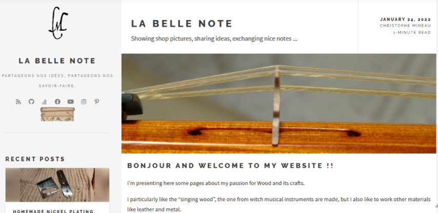

    Allow me to introduce you to my new website, at least to the new version of my Web site : https://www.labellenote.fr/en/
    It's been almost 12 years now that I have started putting things together on this Web site, but the platform I've been using was becoming outdated and slow... I had really slowed down my updates because of this ...
    But here we go, like any tool in the shop, there comes a time where some maintenance is necessary, and as usual, serious maintenance includes some part of rebuilding, and that's what is good !
    So I changed completely the motor, I moved to an up to date and really nice platform called Hugo (I recommend !) and found plenty of opportunities to develop software tools to entirely convert my old contents to this new platform.
    And I'm pretty happy with the result ! All the big work is finished, though I still have to review all the legacy stuff and fix some conversion errors here and there ..
    But now I'm starting to write new content on this platform, and I'm really happy because it's way easier and faster to do.

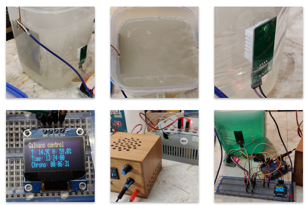

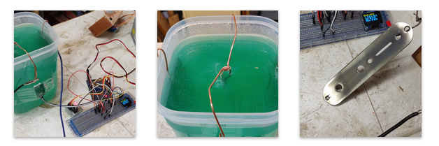

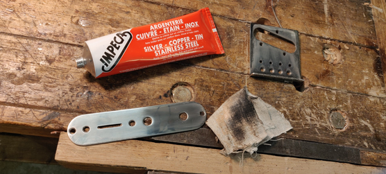

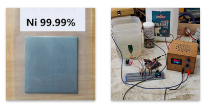

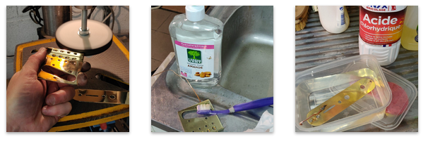

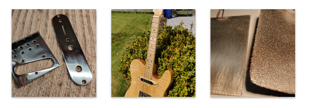

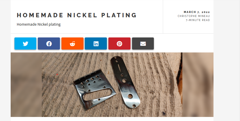

    So, here is my last article : Homemade Nickel plating
    Here is the Table of contents :
    What you need
    Preparing the electrolyte
    Preparing parts
    Theory
    Practical setup
    Polishing
    Results
    I wish you a happy reading !
    Feel free to leave me any feedback.
    Cheers !
    Christophe

    And if you simply dissolve a known weight of copper in plain white vinegar, then do some maths to make a 95/5% nickel acetate/copper acetate mix, you can then do a cupronickel plating. This playing is a matte charcoal grey finish that does not wear off easily, due to the copper in the mix.

    Quote Originally Posted by Drew1966 View Post
    Interesting, thanks for the info, do you have any experience with it ? Can you possibly show picture ?
