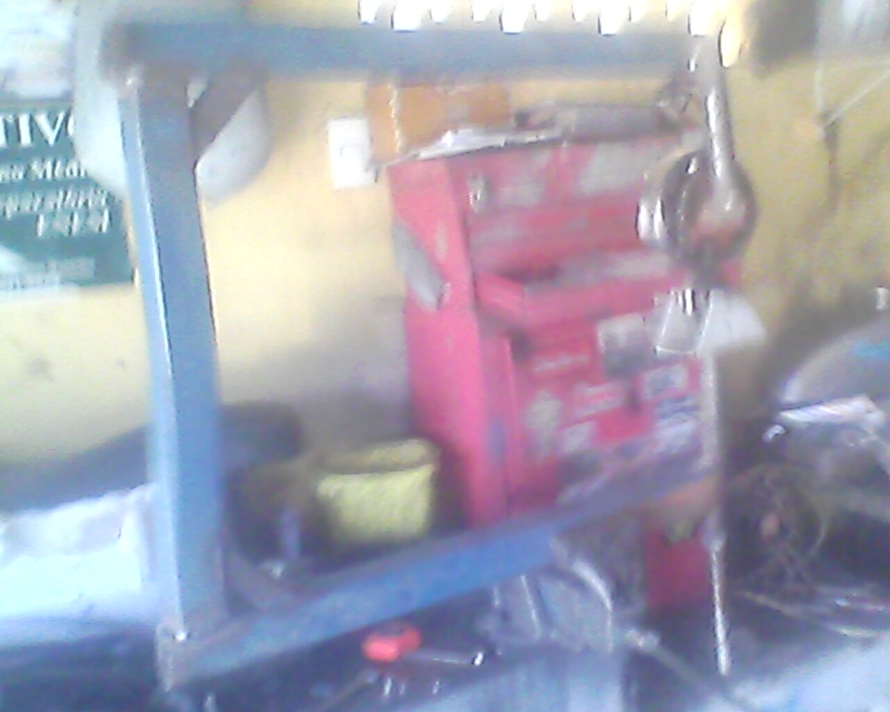

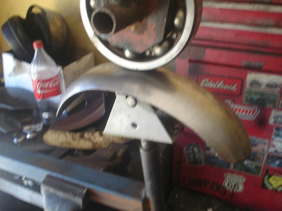

    this is my e-wheel made with two old bearings and square tubes from scrapyard.
    I hope it gives you guy another idea for a budget english wheel!
    Attached Thumbnails Attached Thumbnails Homemade metalshaping tools with scrap parts-262673_270668899723054_1231550977_n.jpg

    Those bearings look huge what did they come out of?

    E-WHEEL BEARINGS
    Quote Originally Posted by jere View Post
    Sorry for taking too long to answer your question. The big one is from a big electric motor. I've been using this wheel for five years and it never wears.
