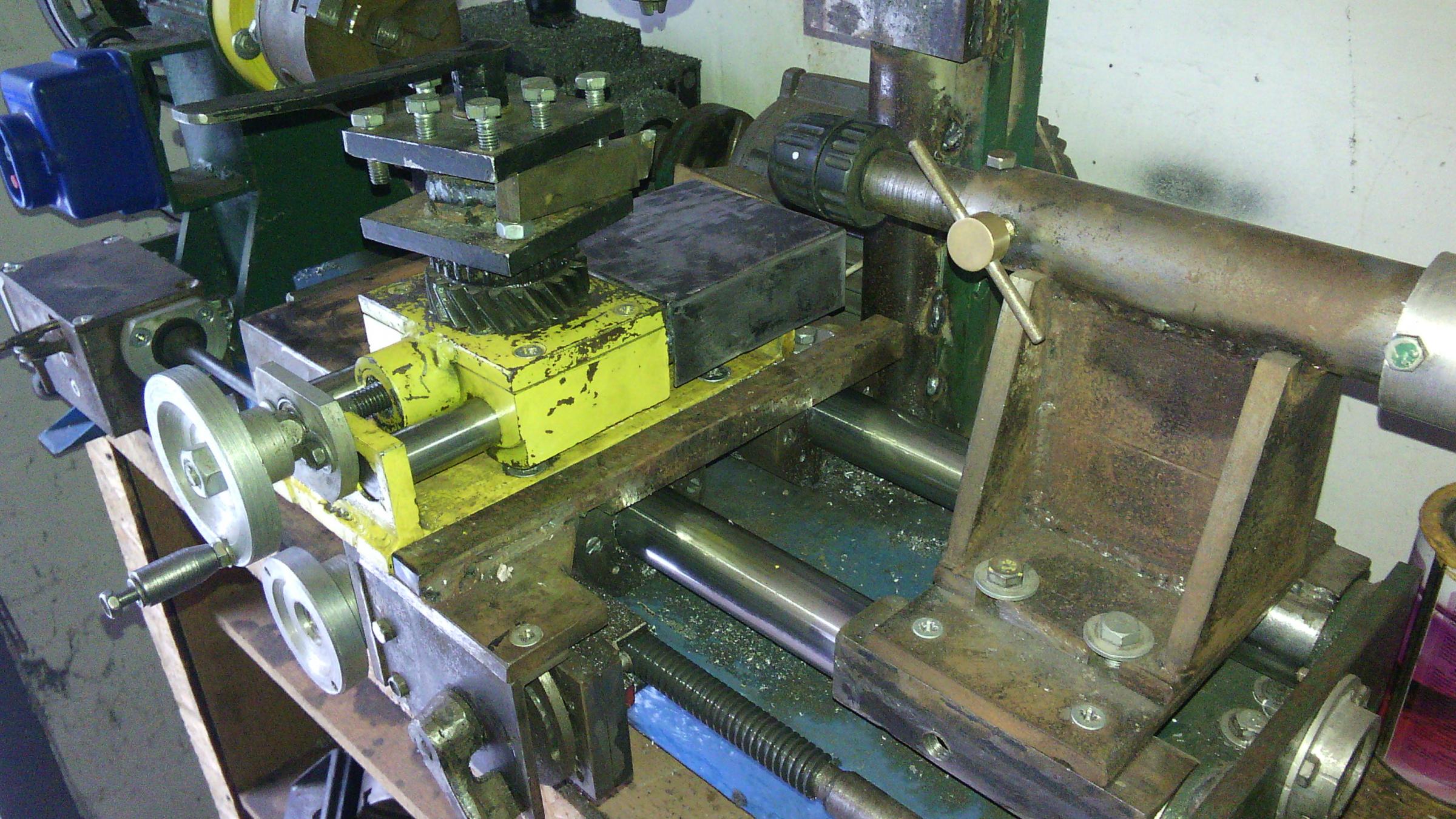

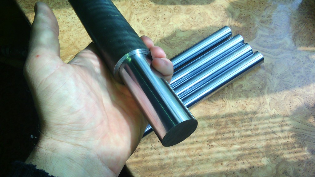

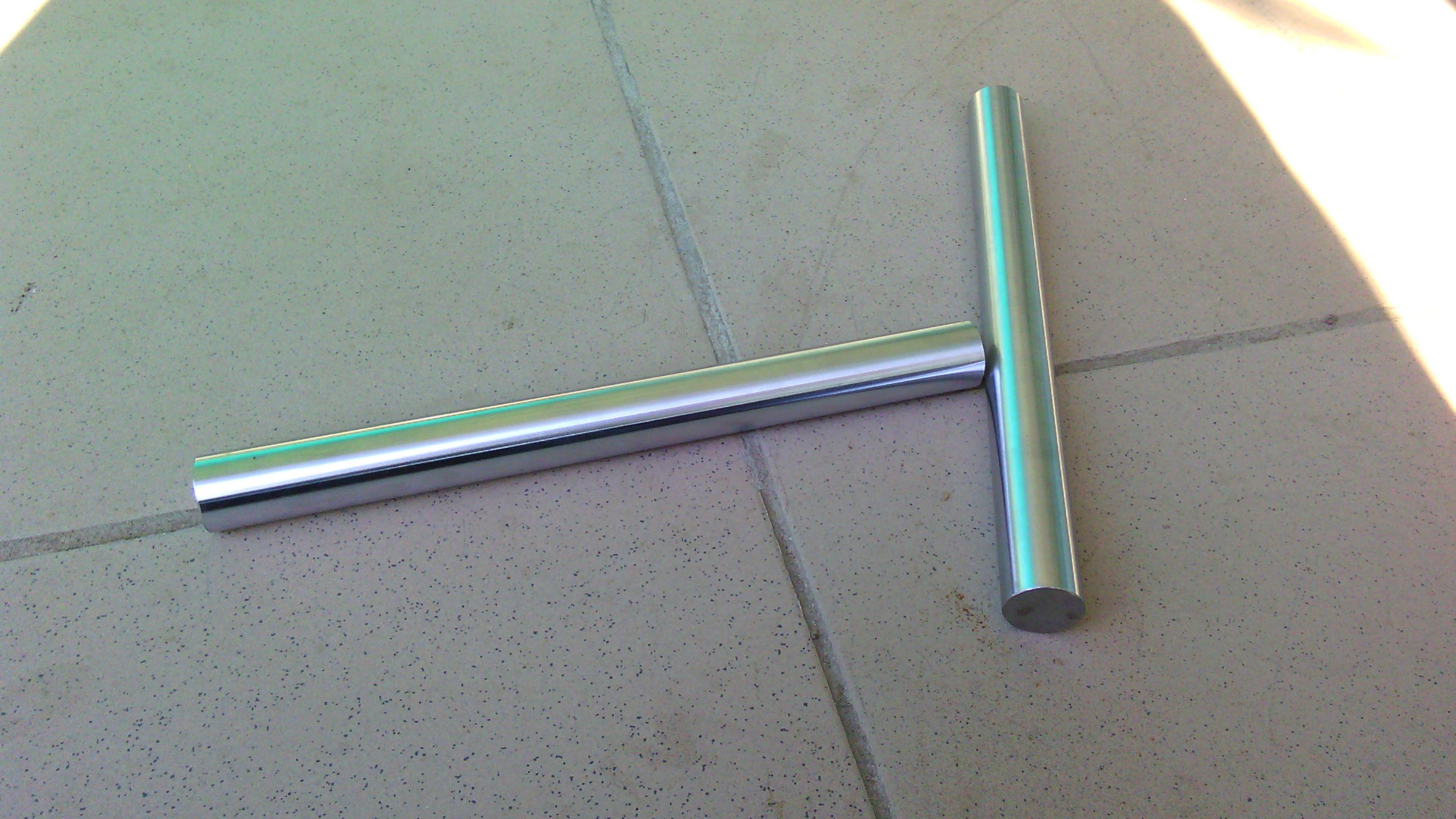

    Bought rods of hydraulic cylinders and set them on the caliper. These rods hardened, polished and coated with chrome. So I enlarge stiffness lathe machine. Also set the plate so that metal shavings do not pollute the screw. Weather is warm, so I can start painting.
    Homemade lathe for metal-img_20160316_143859.jpg Homemade lathe for metal-img_20160318_095621.jpg

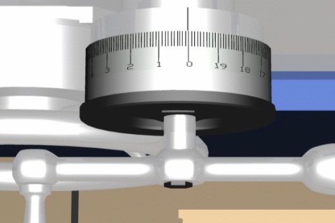

    Later will produce limb and scale. I do not have indexing head, now thinking of how to make the scale. Who can give an idea?

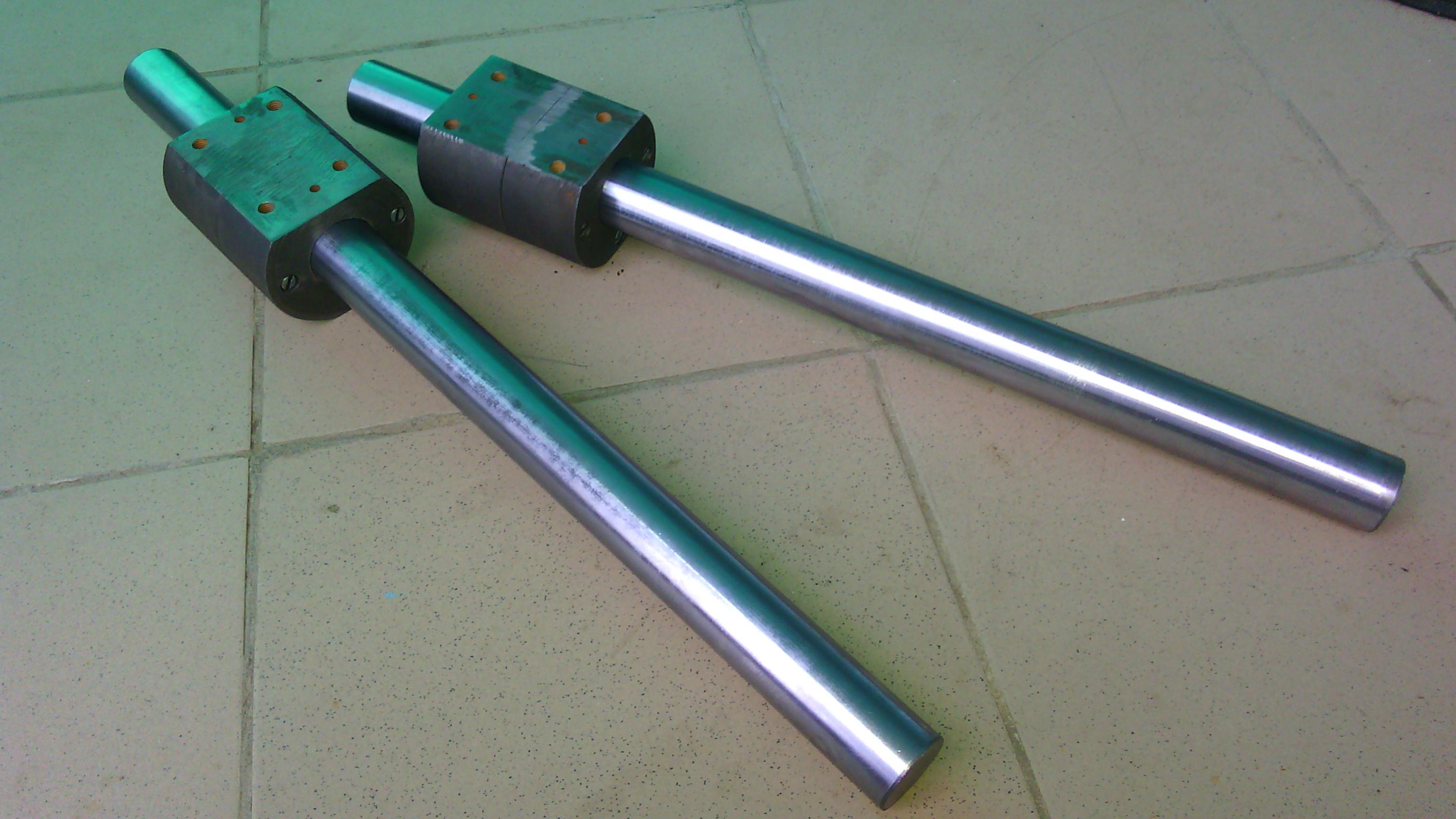

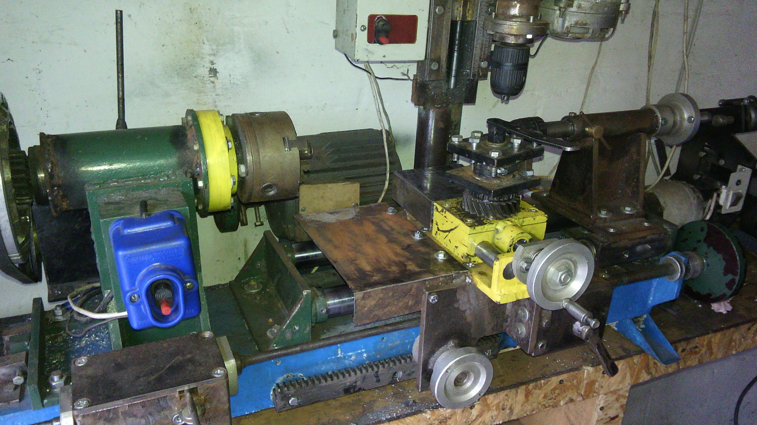

    Replaced all rods on a lathe. The rigidity of the lathe is much better.

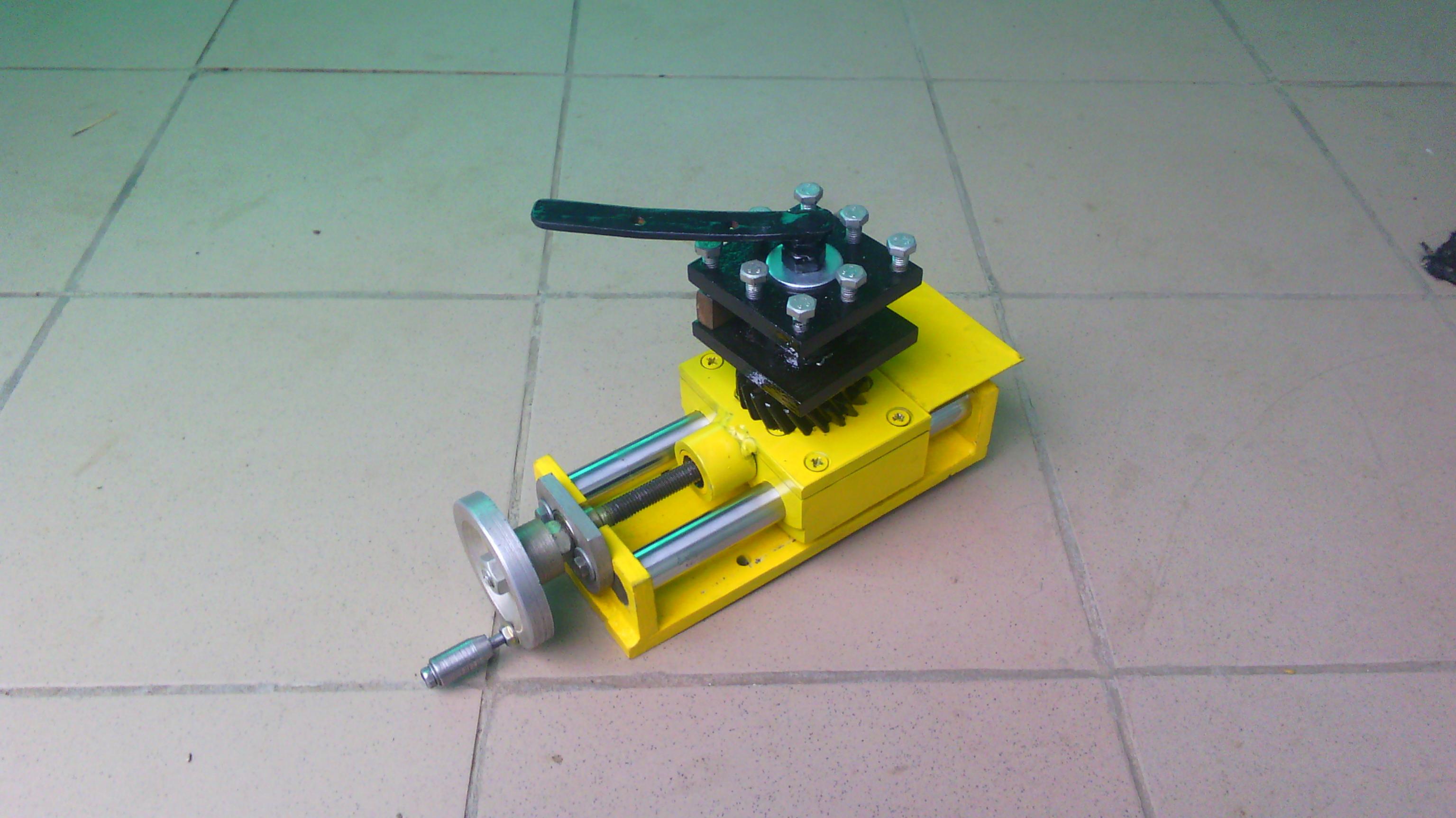

    Milling equipment in the work

    A plywood blade for a circular saw has 100 teeth. That would give you 100 graduations.

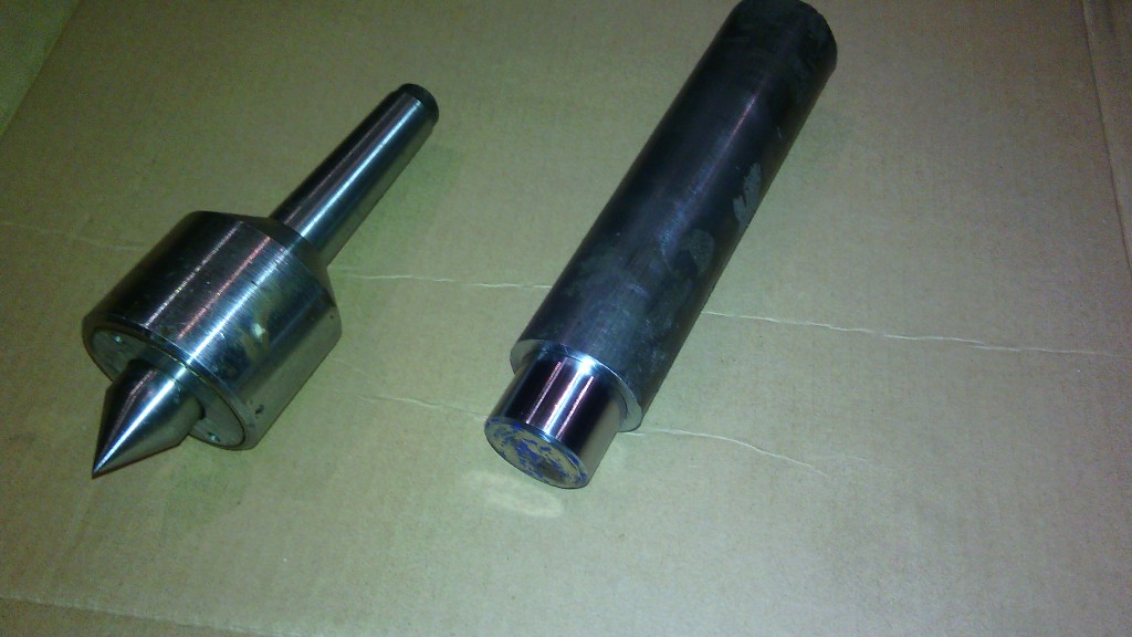

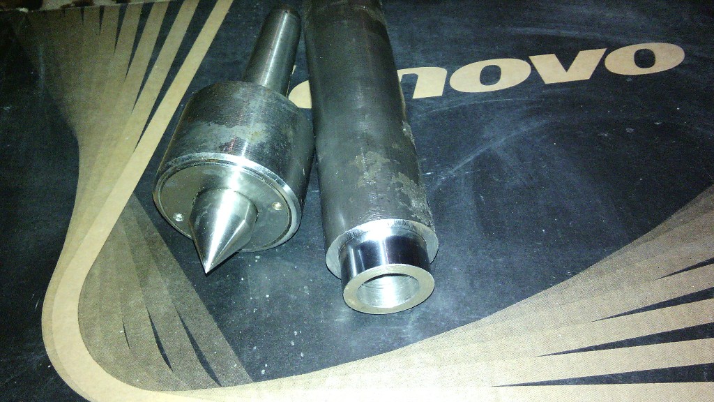

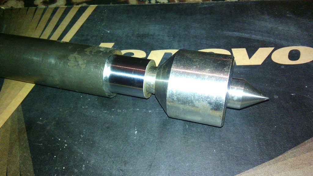

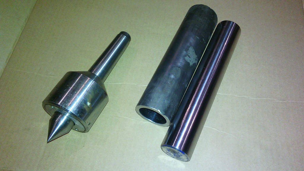

    Modernization tailstock. I have a rotating center Morse cone №3. I bought a rod and tube from the hydraulic cylinder of agricultural machinery. It should be drilled and carved a hole cone.

    Made conical hole
    Homemade lathe for metal-img_20170311_181952.jpg Homemade lathe for metal-img_20170311_182030.jpg
