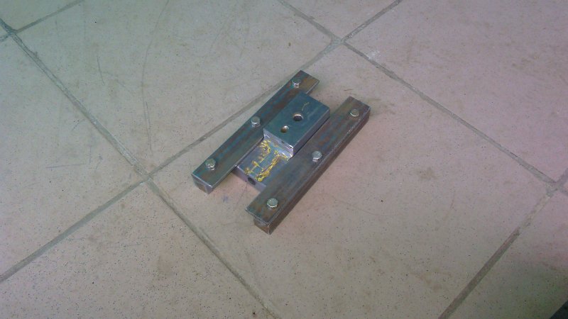

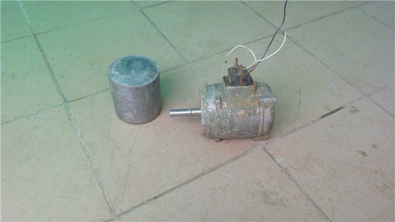

    The molten aluminum and manufactured workpiece diameter 100 mm. Also found motor for milling 350W 2000 rpm/

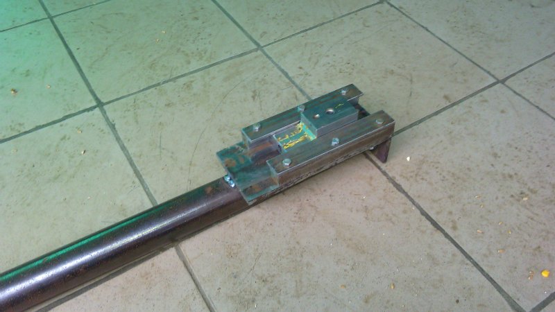

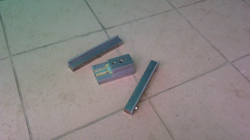

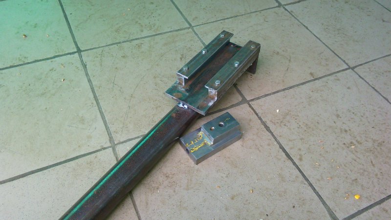

    Vertical rack for milling.

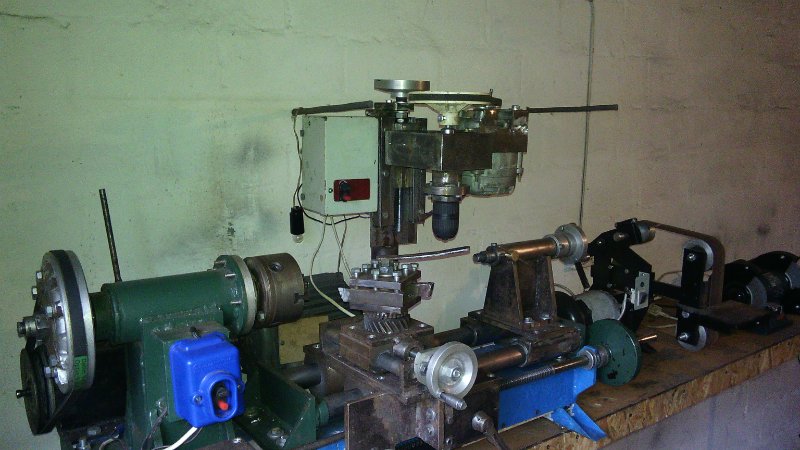

    Installed milling attachment

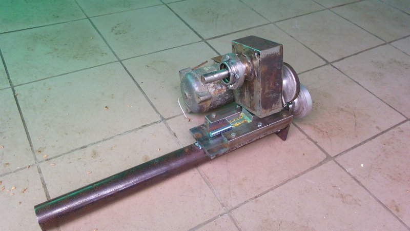

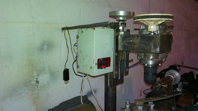

    Vyacheslav.Nevolya's Tools

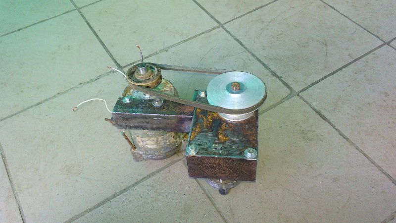

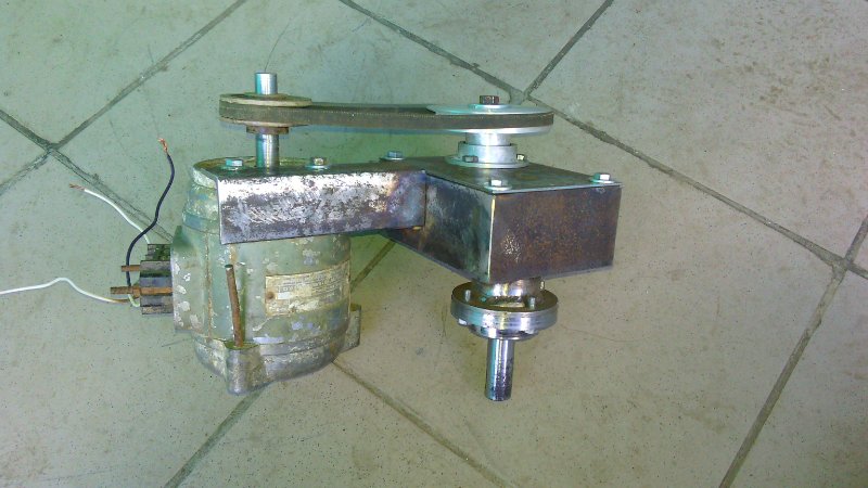

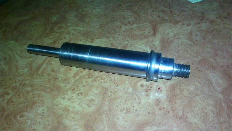

    Hi. Fully developed a new design, new motor and set it on the right. Gear box broke, it was made of cast iron rather than steel. So now a spindle and pulley.
    Box with electronics.

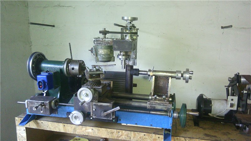

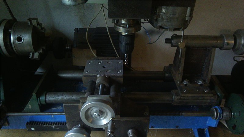

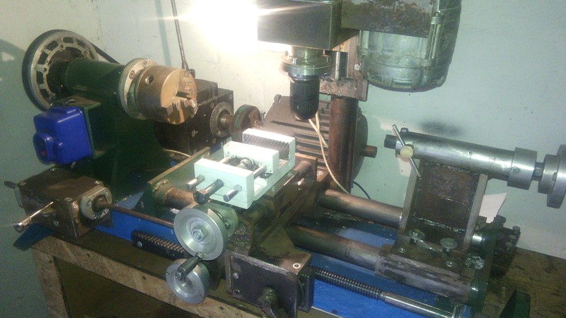

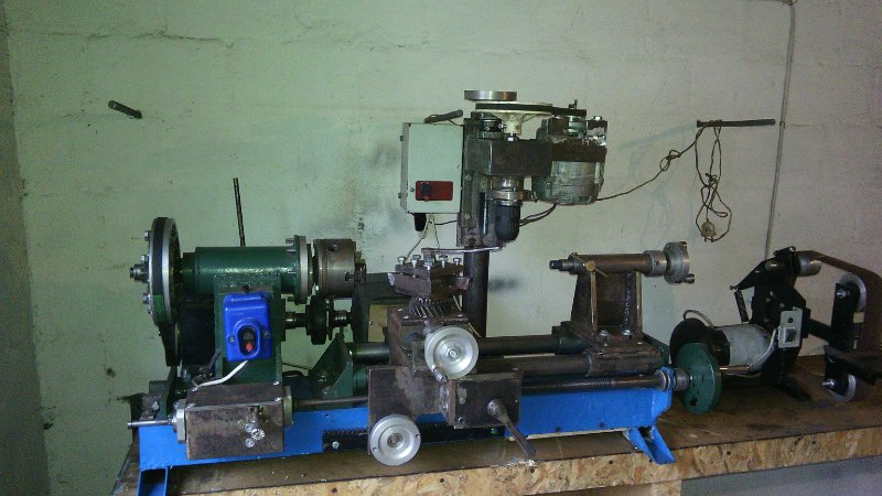

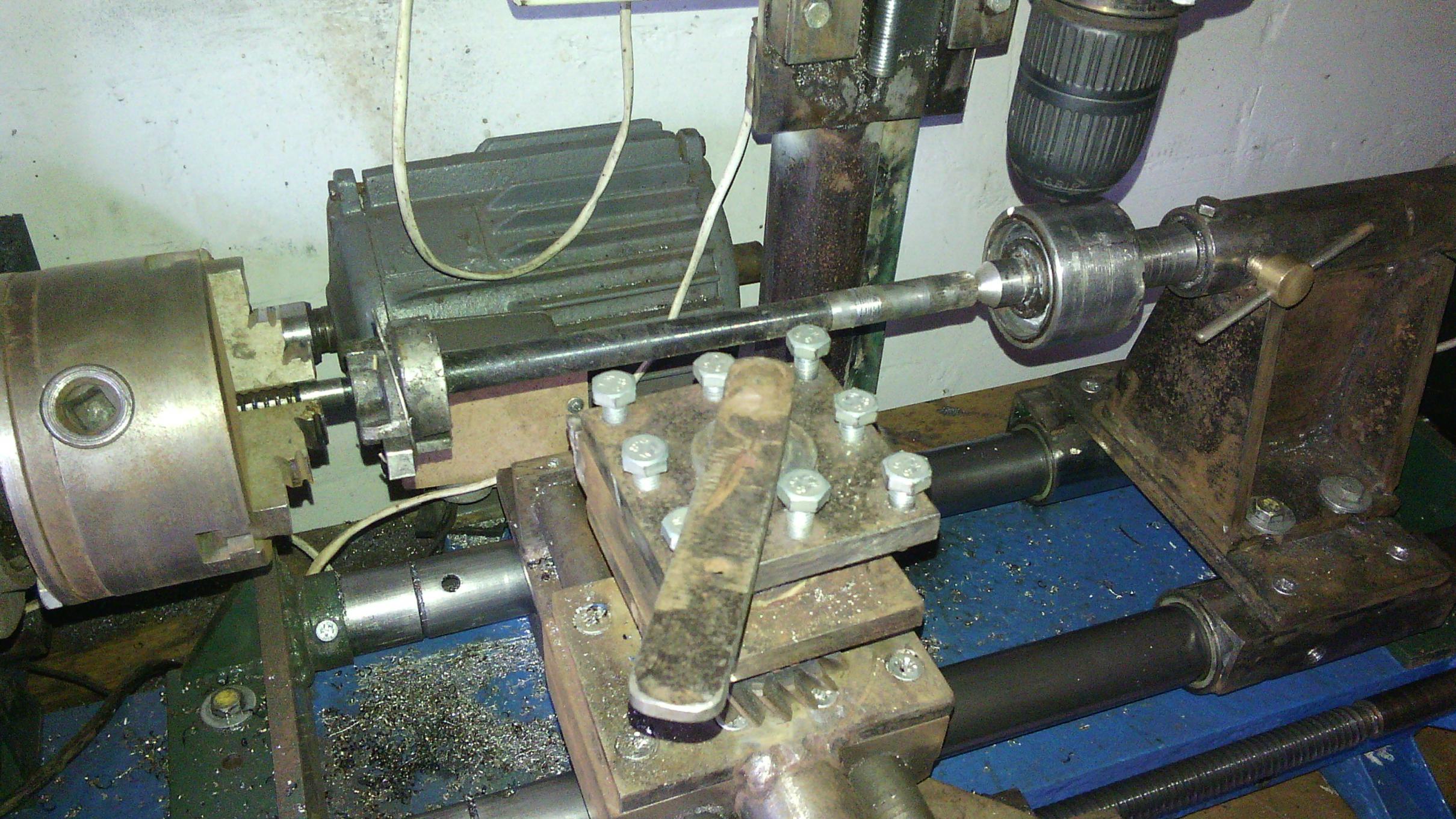

    Today started first milling. Milling platform caliper, later to be installed vise.

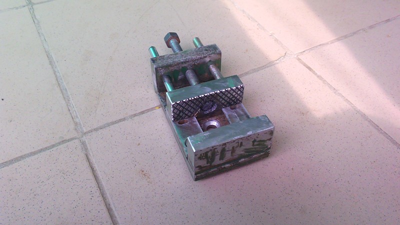

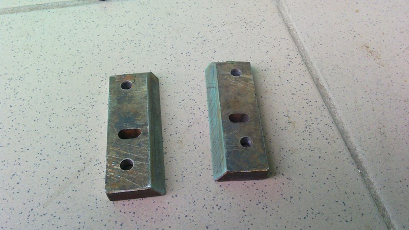

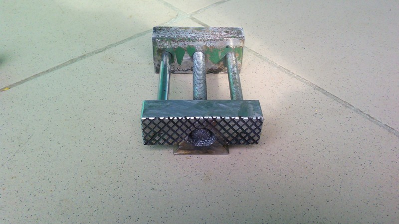

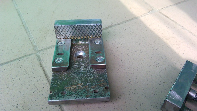

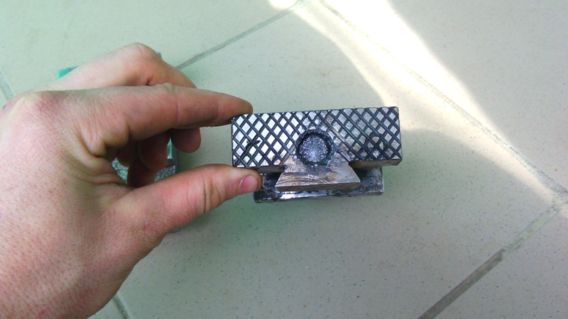

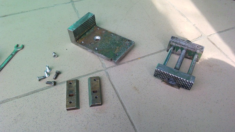

    Homemade milling vise
    Homemade lathe for metal-img_20160308_144518.jpg Homemade lathe for metal-img_20160308_144532.jpg Homemade lathe for metal-img_20160308_144549.jpg Homemade lathe for metal-img_20160308_144945.jpg Homemade lathe for metal-img_20160308_144955.jpg Homemade lathe for metal-img_20160308_145354.jpg Homemade lathe for metal-img_20160309_124213.jpg

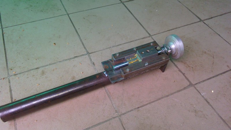

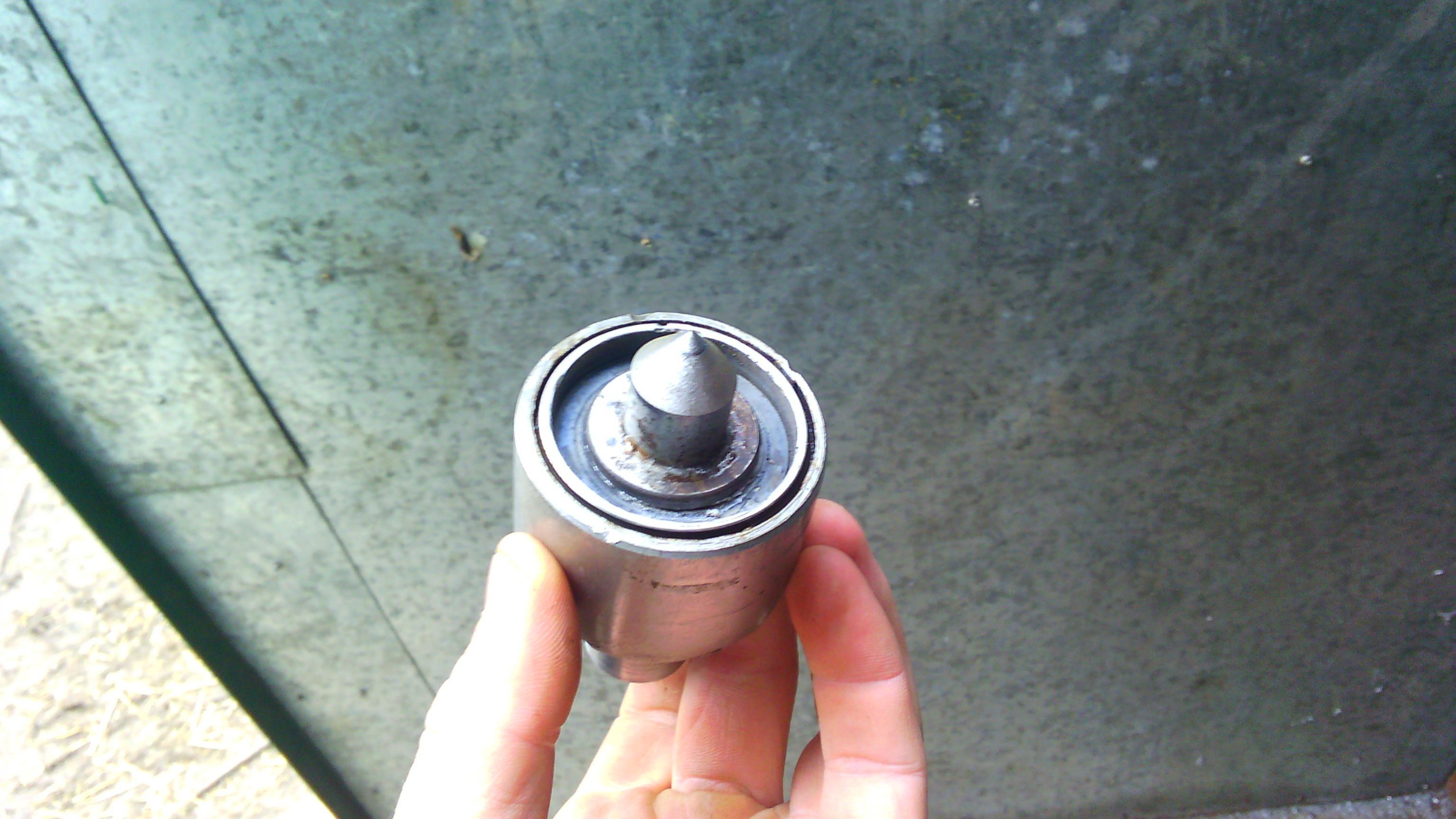

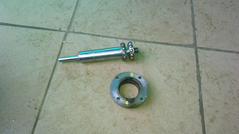

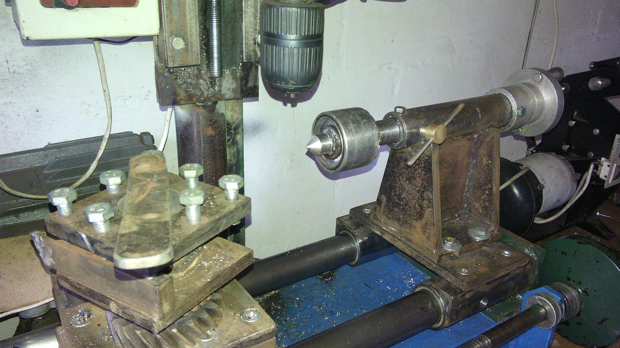

    Rotating tailstock centre
    Homemade lathe for metal-img_20160313_120944.jpgHomemade lathe for metal-img_20160313_121120.jpgHomemade lathe for metal-img_20160313_121311.jpg
    The maximum length of 30 cm details
