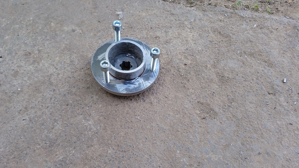

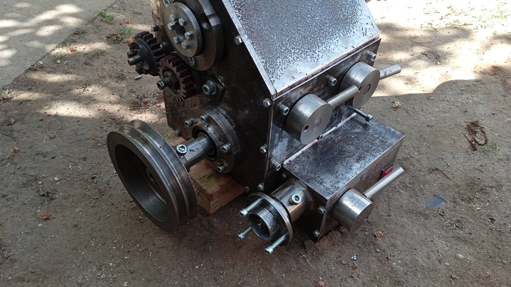

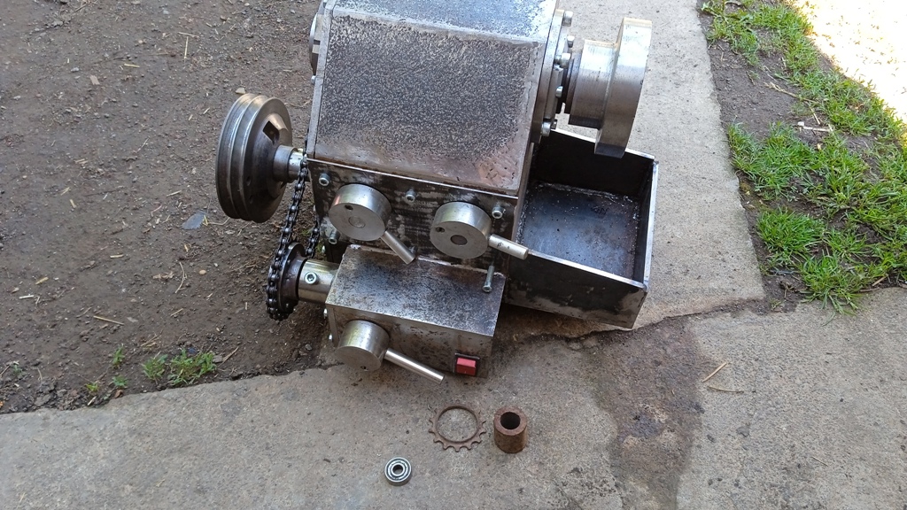

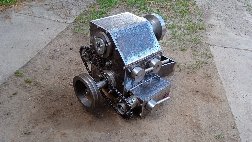

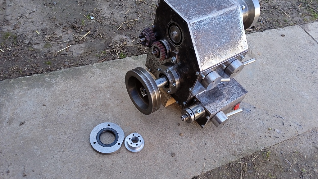

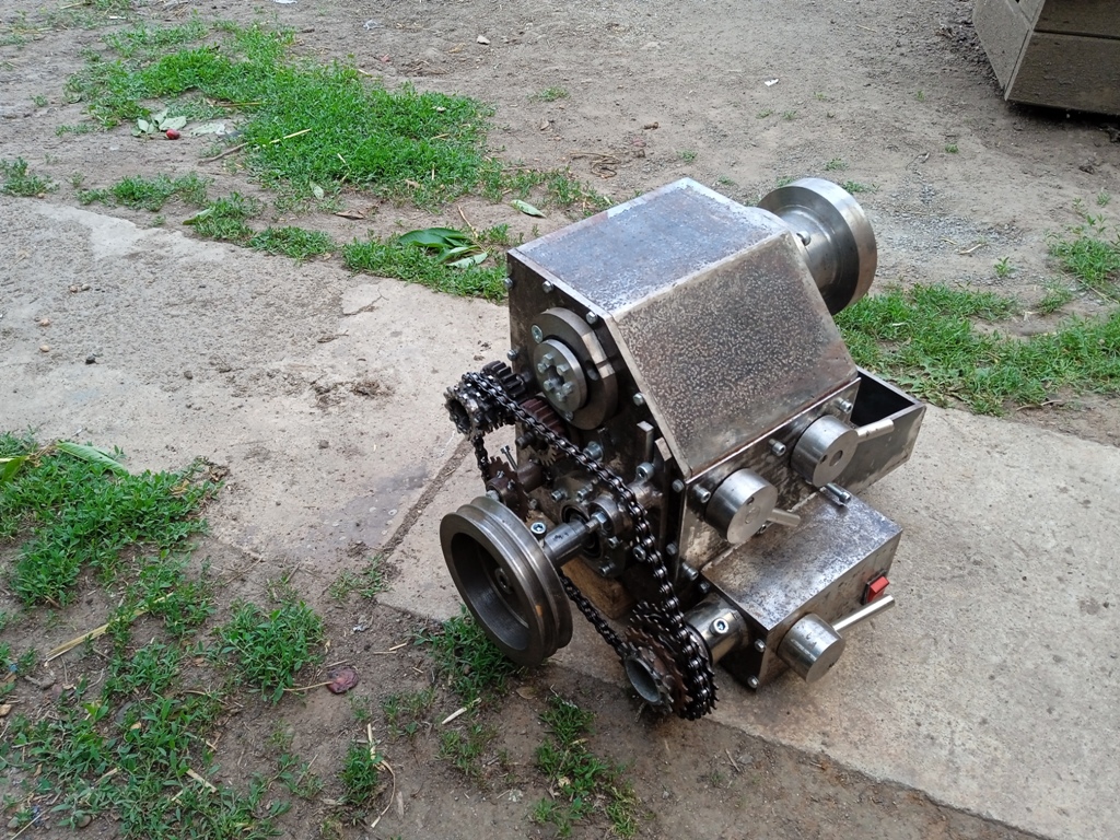

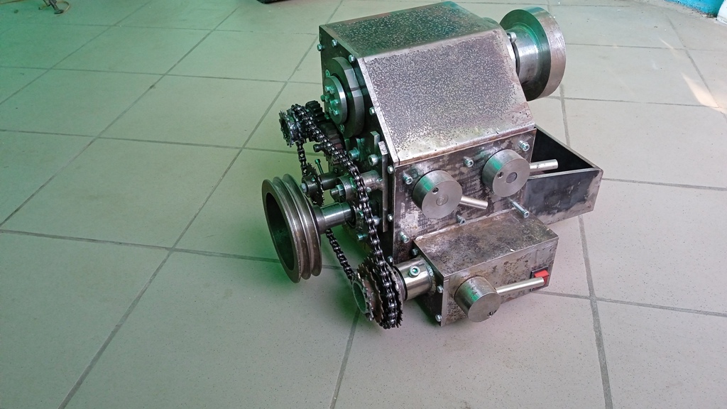

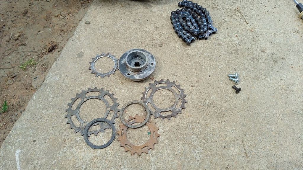

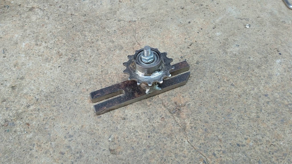

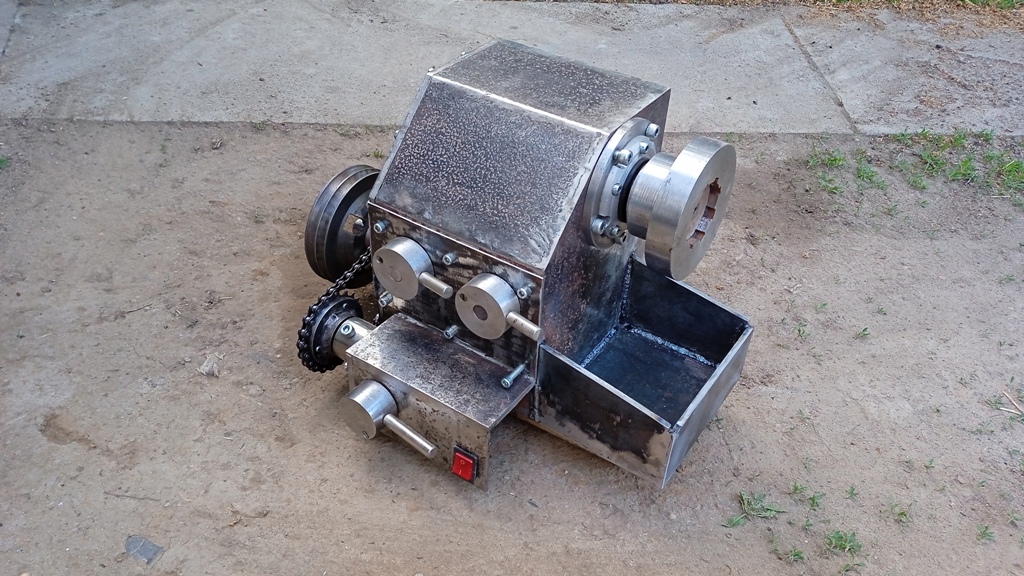

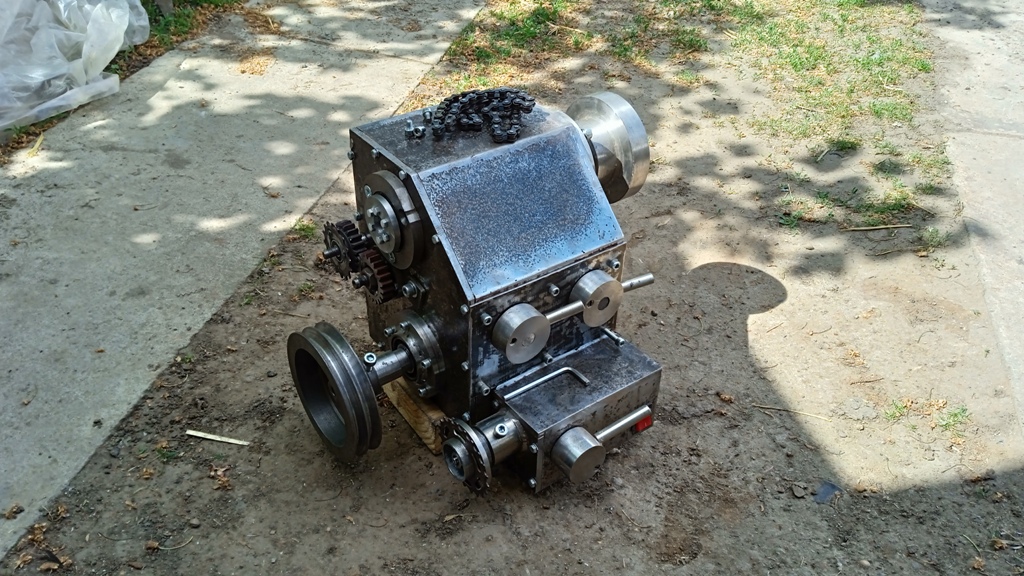

    Drive on the leadscrew feed. I used a chain and a star because it's easy to make. For each step of the thread, you can easily make a star with the right number of teeth.
    Homemade lathe for metal-img_20220511_160914_1.jpg Homemade lathe for metal-img_20220511_161410.jpg Homemade lathe for metal-img_20220516_151559.jpg Homemade lathe for metal-img_20220516_174156.jpg Homemade lathe for metal-img_20220516_174203_1.jpg Homemade lathe for metal-img_20220516_174208_1.jpg

    Vyacheslav,

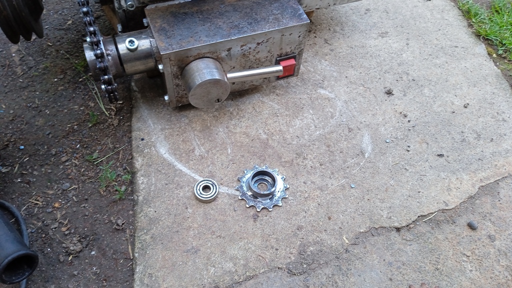

    I hope this helps, the english word for "star" when used with a chain is "sprocket".

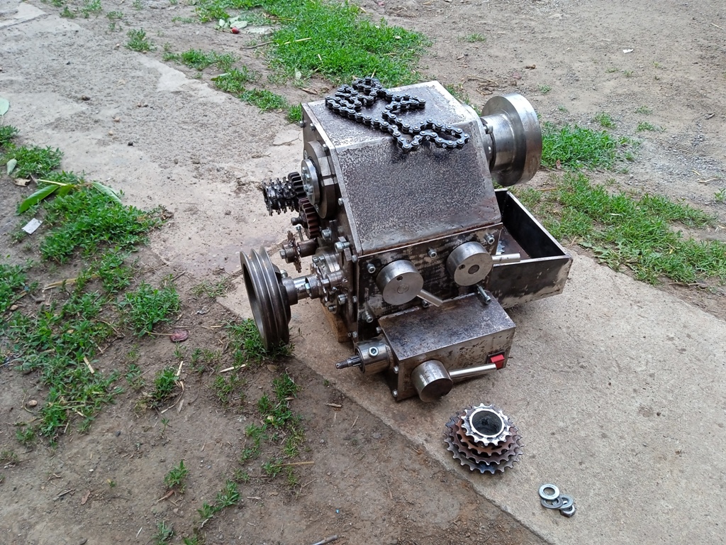

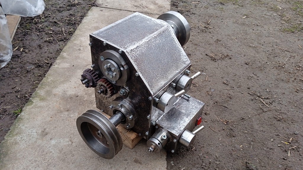

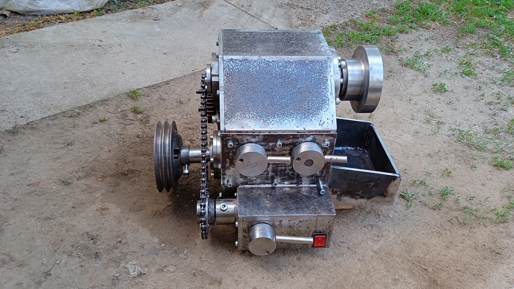

    Now self-made lathe has the opportunity to cut metric threads in steps of 1.0, 1.25, 1.5, 1.75, 2.0. In the future, this figure will be expanded by replacing the sprockets.
    Homemade lathe for metal-img_20220606_105917.jpg Homemade lathe for metal-img_20220606_195132.jpg Homemade lathe for metal-img_20220607_164624_1.jpg Homemade lathe for metal-img_20220617_152035.jpg Homemade lathe for metal-img_20220618_182742_1.jpg Homemade lathe for metal-img_20220618_183428_1.jpg Homemade lathe for metal-img_20220619_191727_1.jpg
