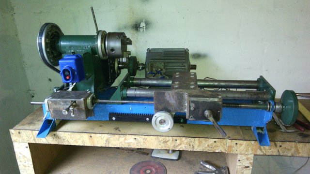

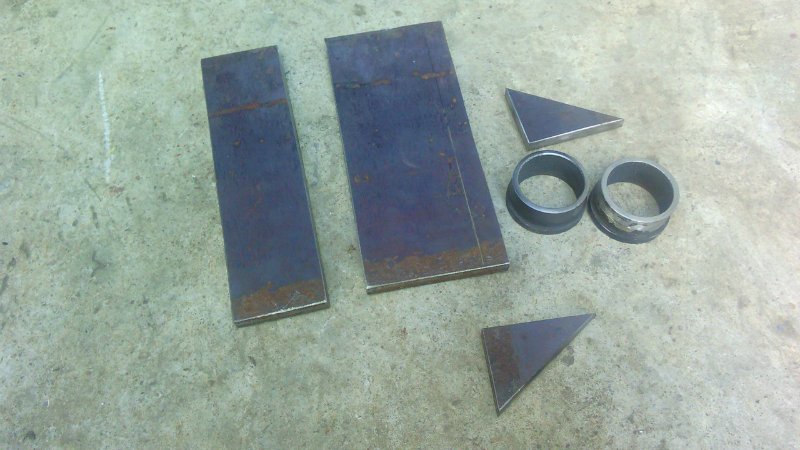

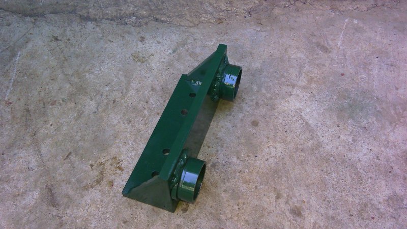

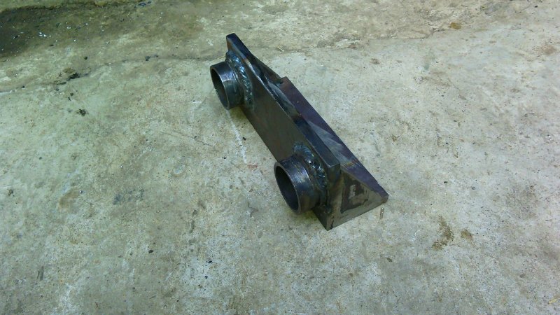

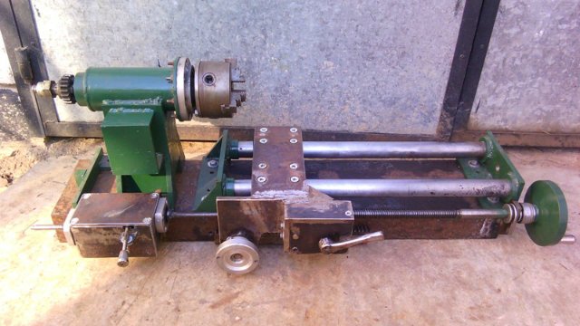

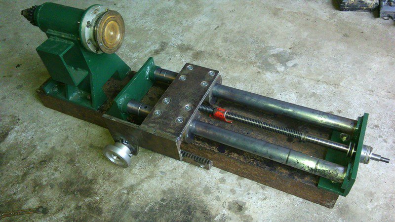

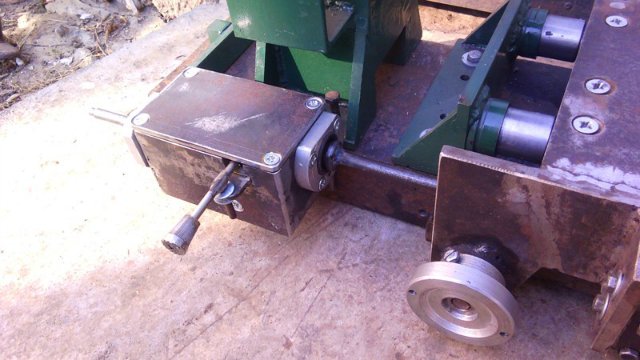

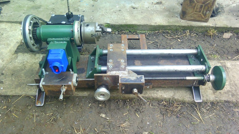

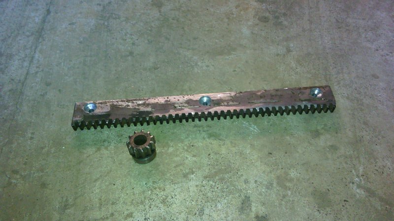

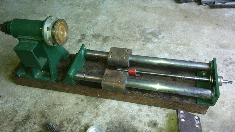

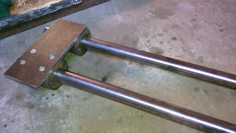

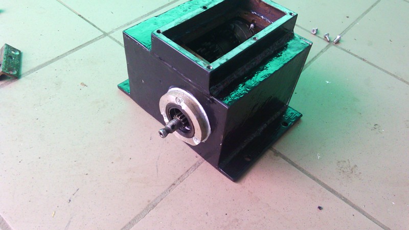

    Hello. I want to share my project. This lathe machine for metal, construction began six months ago. I'll start my story about the front pastern. For the construction of boxes used sheet metal 10 mm.
    Download plans for lathes.

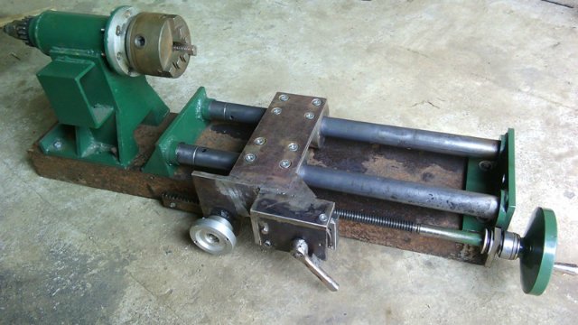

    The process of creating front pastern

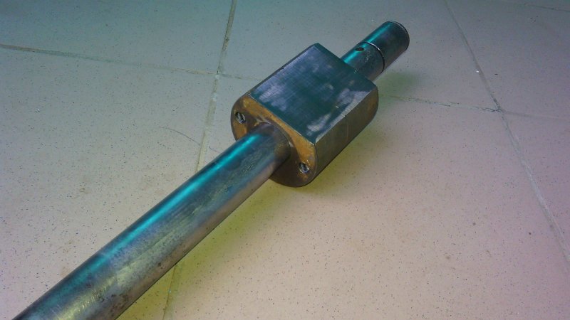

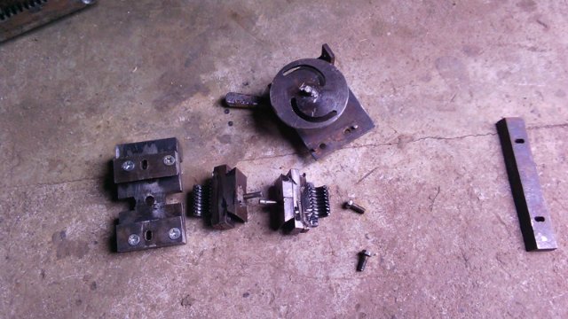

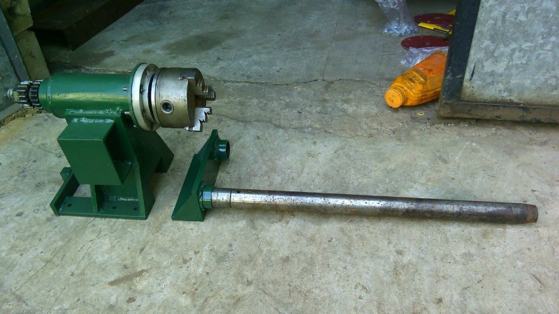

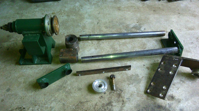

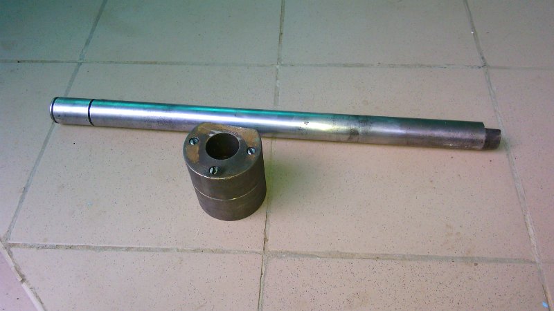

    Fasteners for steel rod and iron bushings. Rods diameter 36mm, length 54 cm, diameter bushings 75mm.

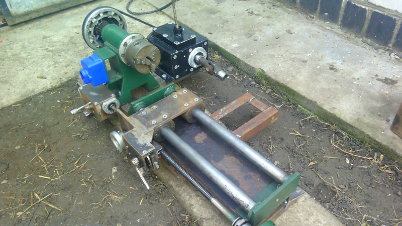

    Demonstration of work

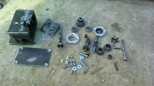

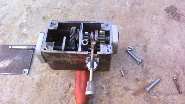

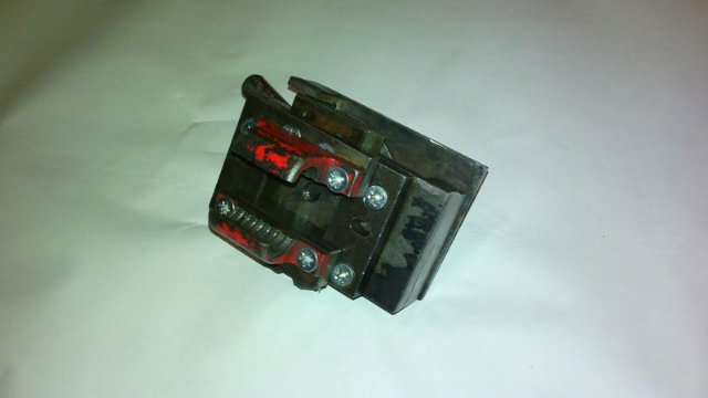

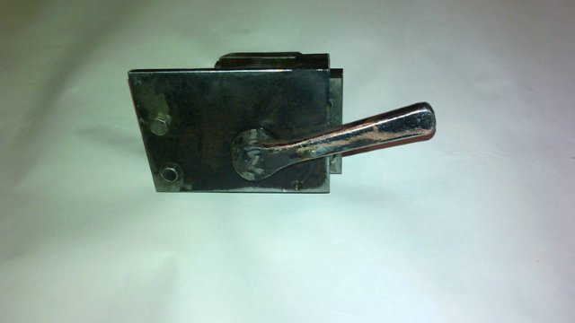

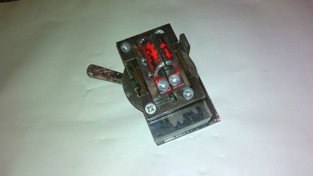

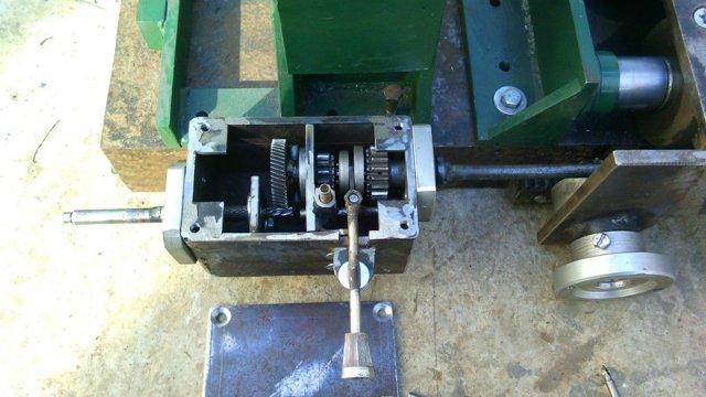

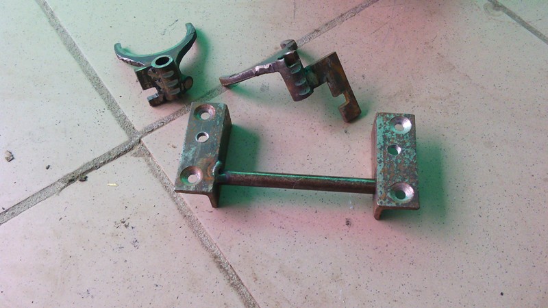

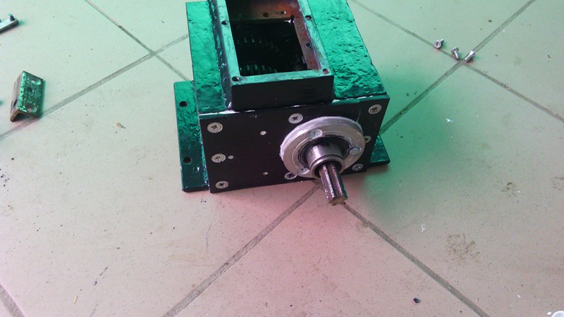

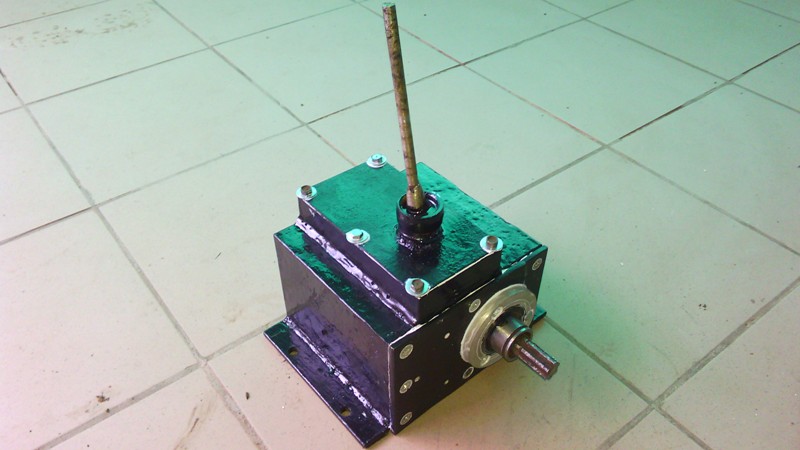

    Gearbox for lead screw. Gearbox has 2 speed, gears from mini motorcycle, and the old drill.

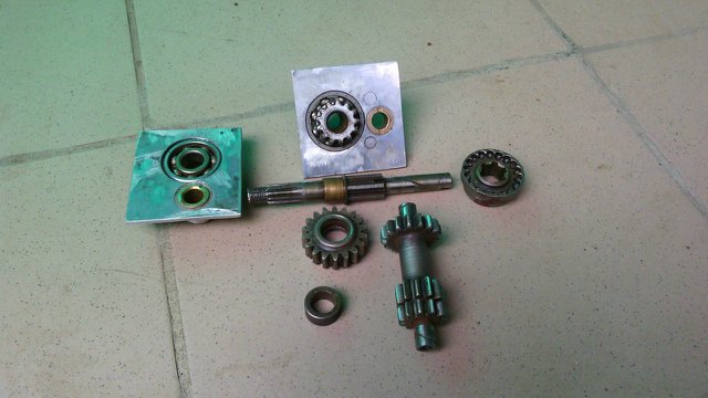

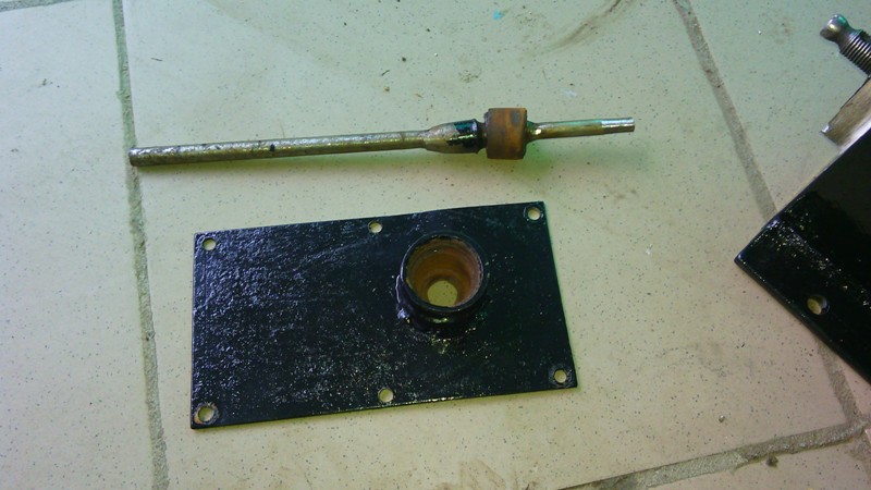

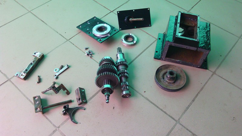

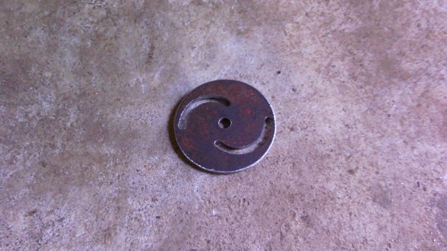

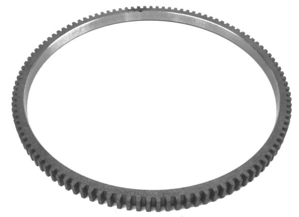

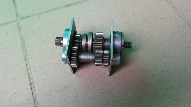

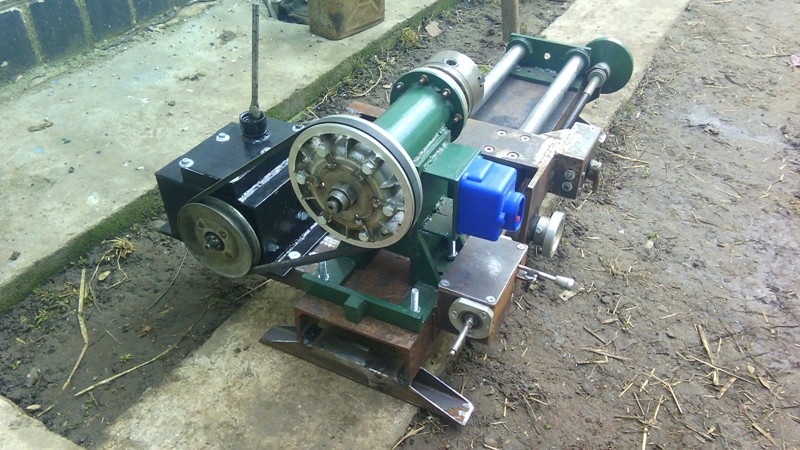

    Gearbox to the spindle. Gear used by motorcycle "Dnepr".
    Homemade lathe for metal-mototsikl-dnepr-11-mt11.jpg.pagespeed.ce.awzgi13mzv.jpg

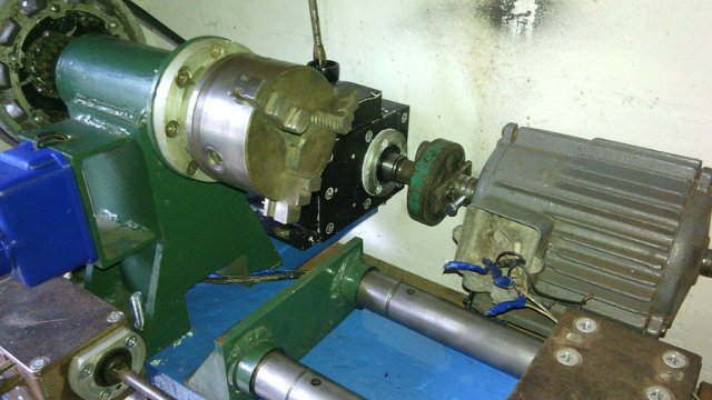

    Motor power of 1 kW.
