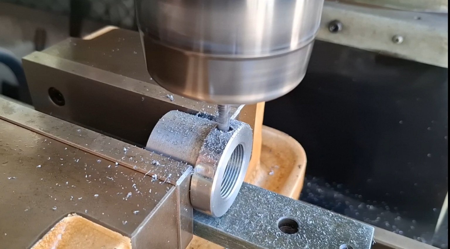

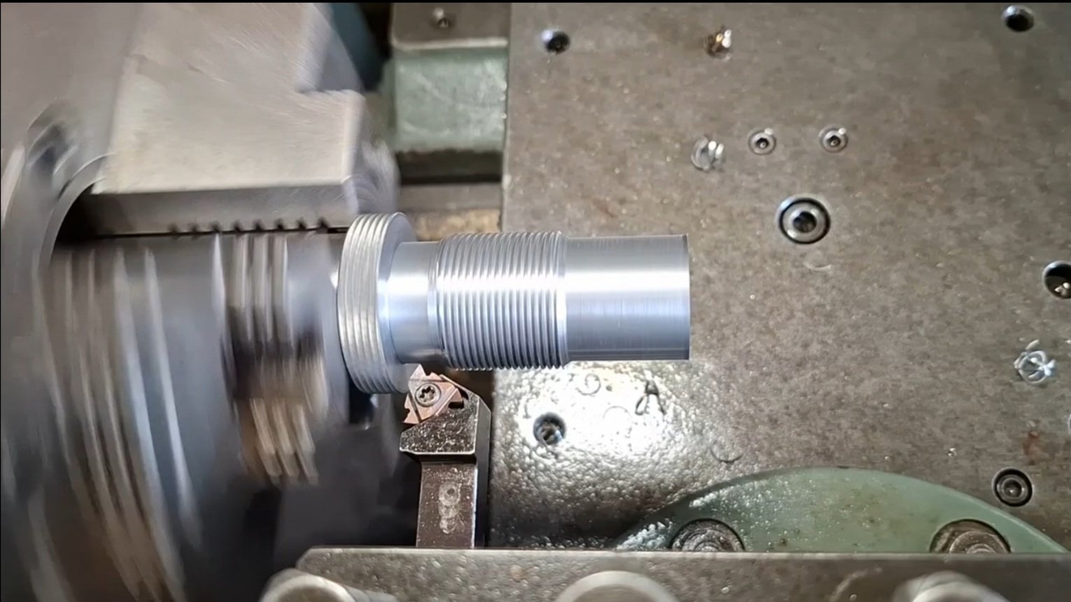

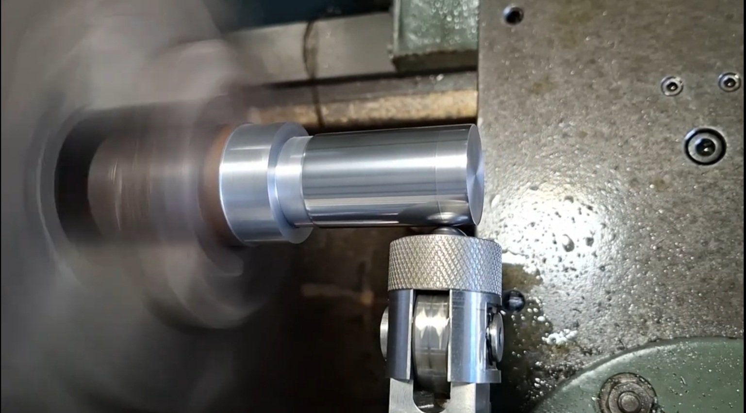

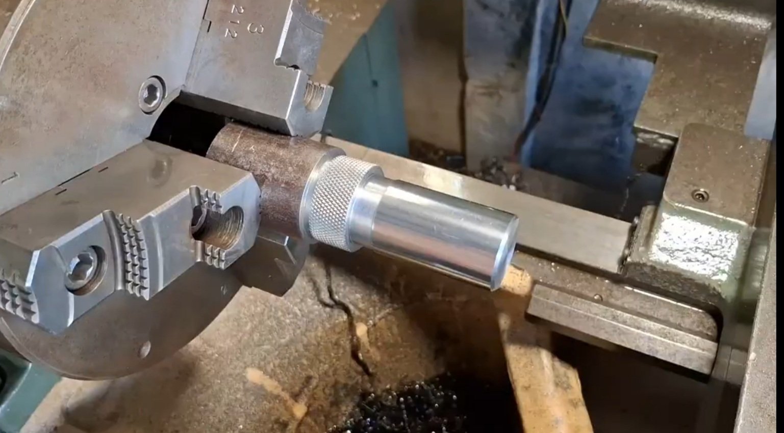

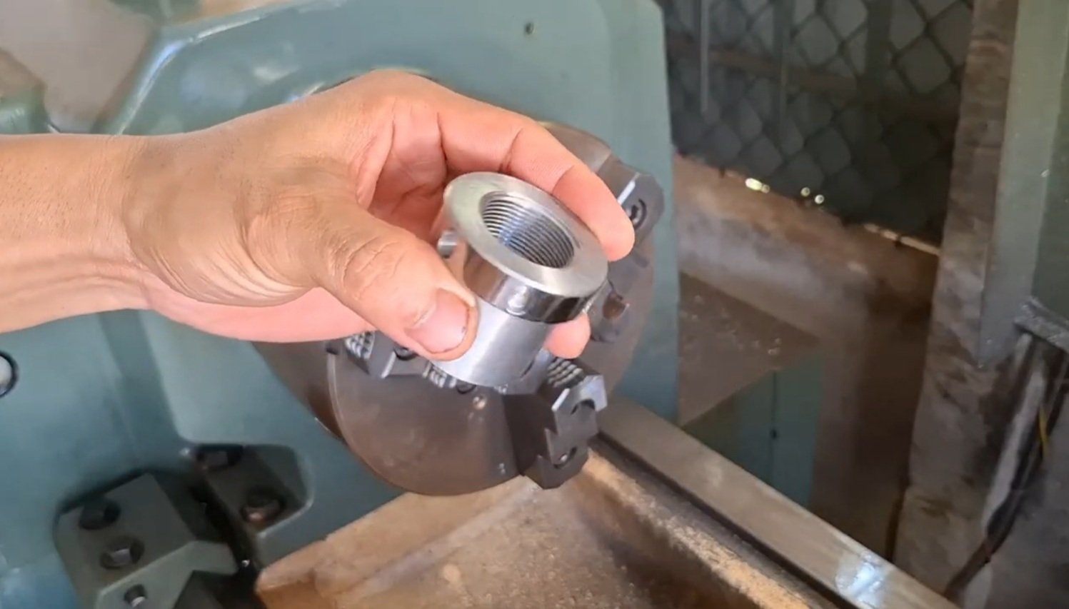

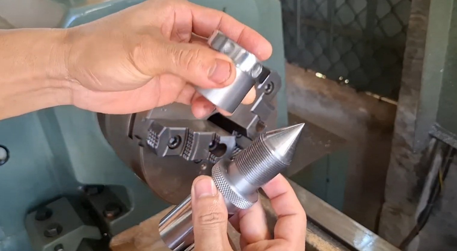

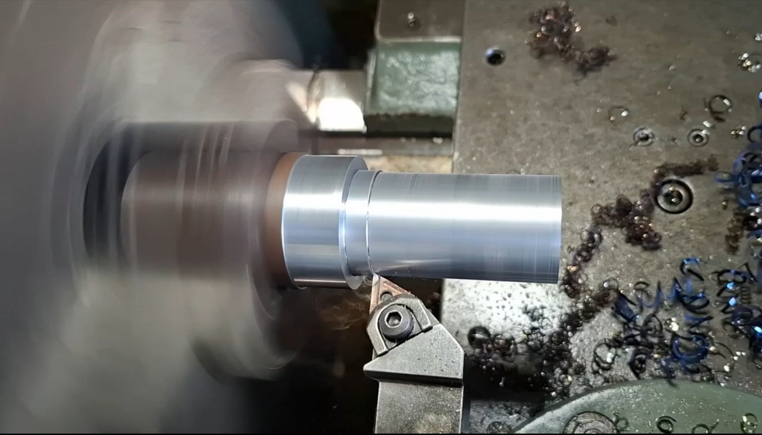

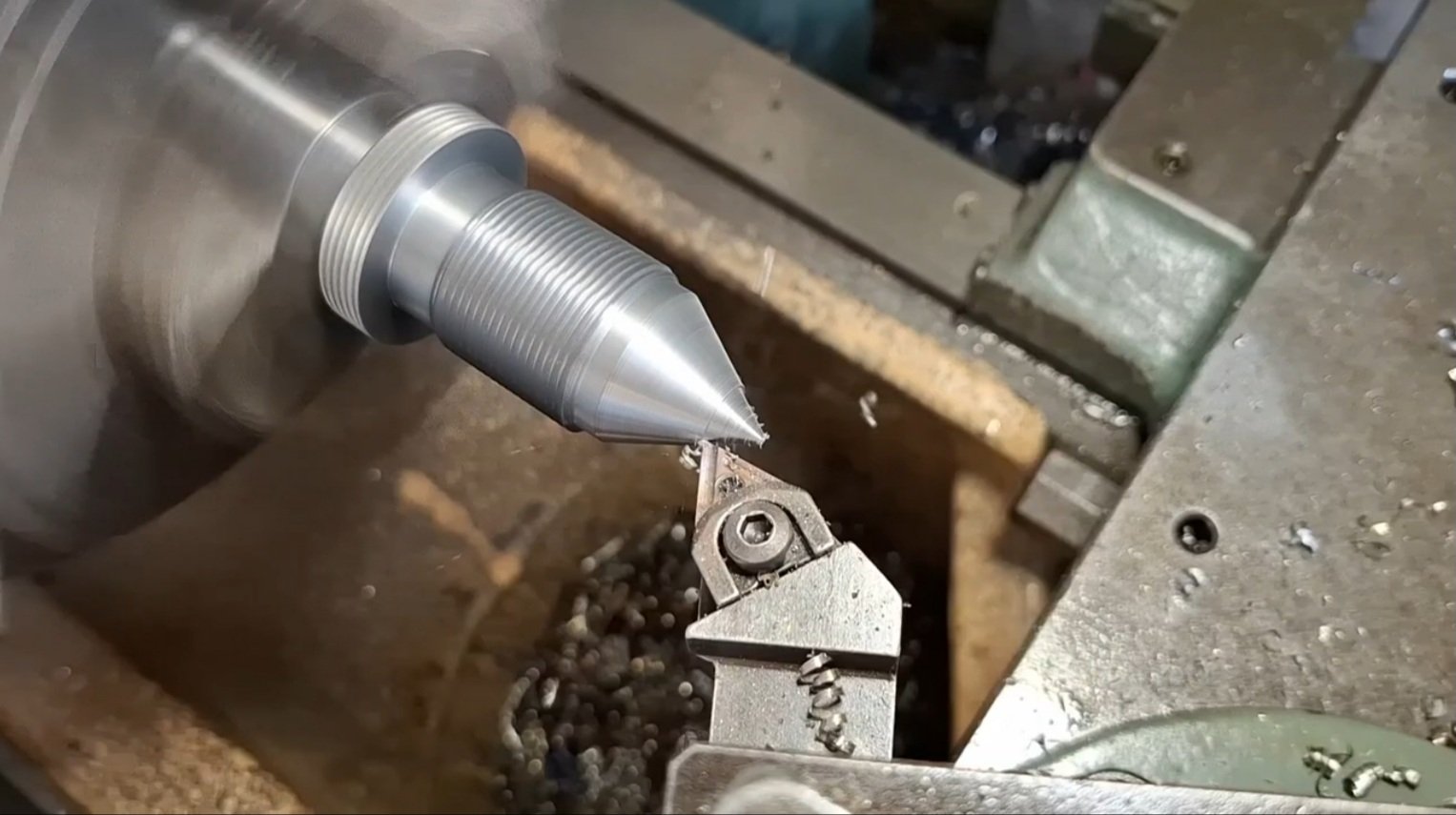

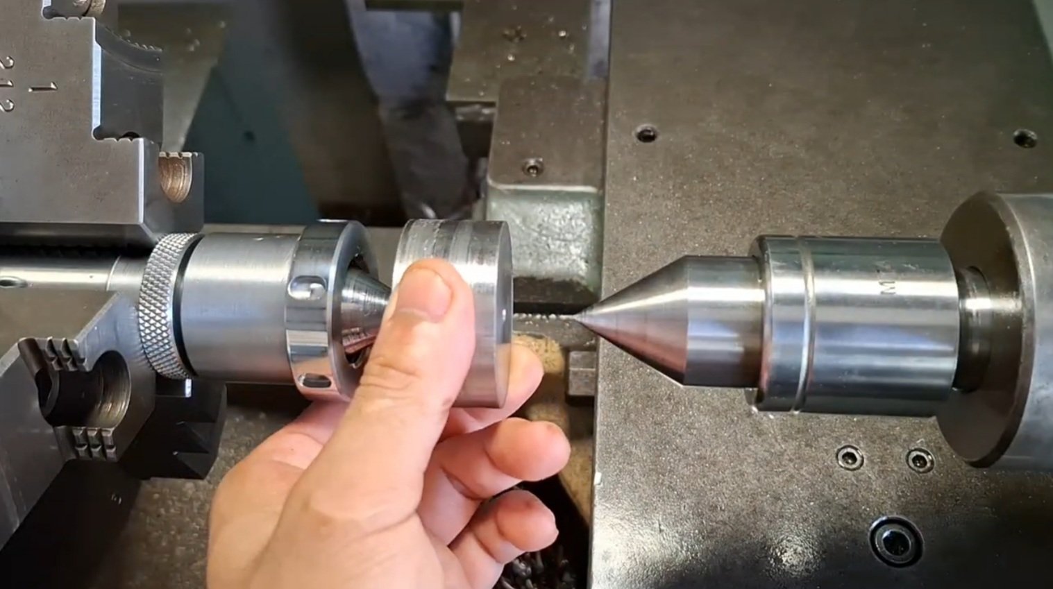

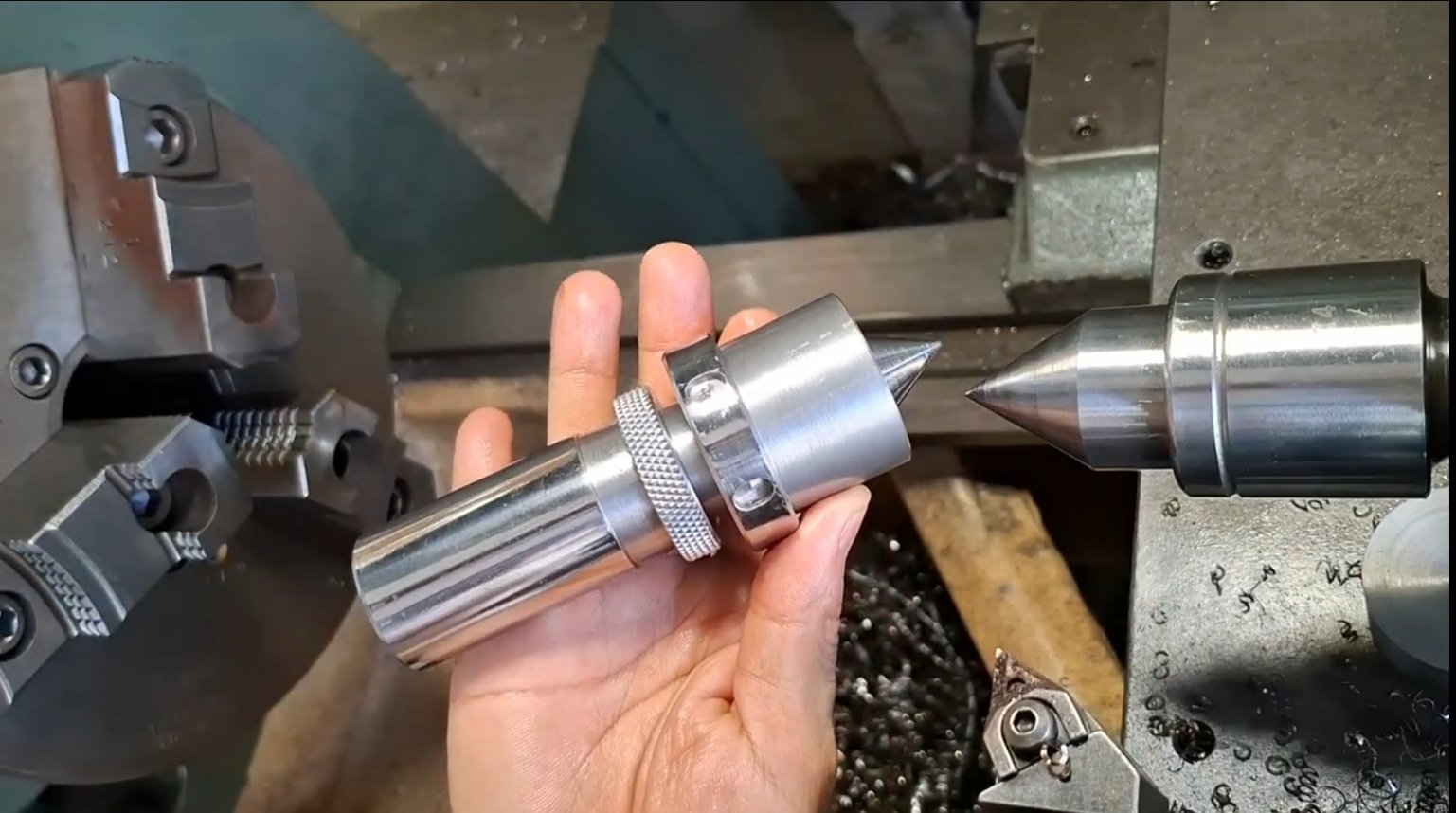

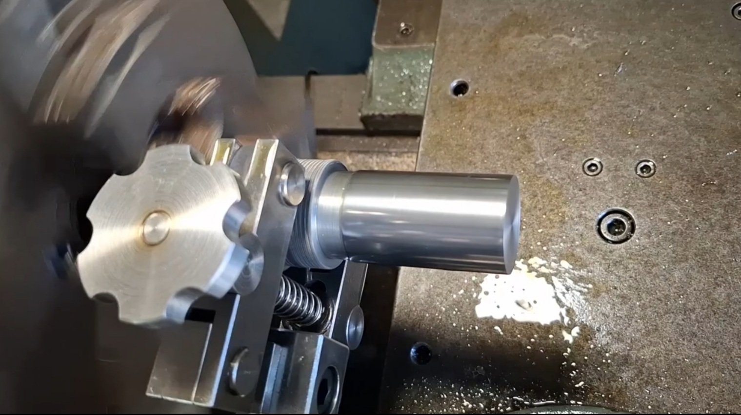

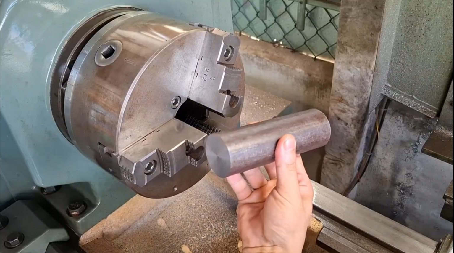

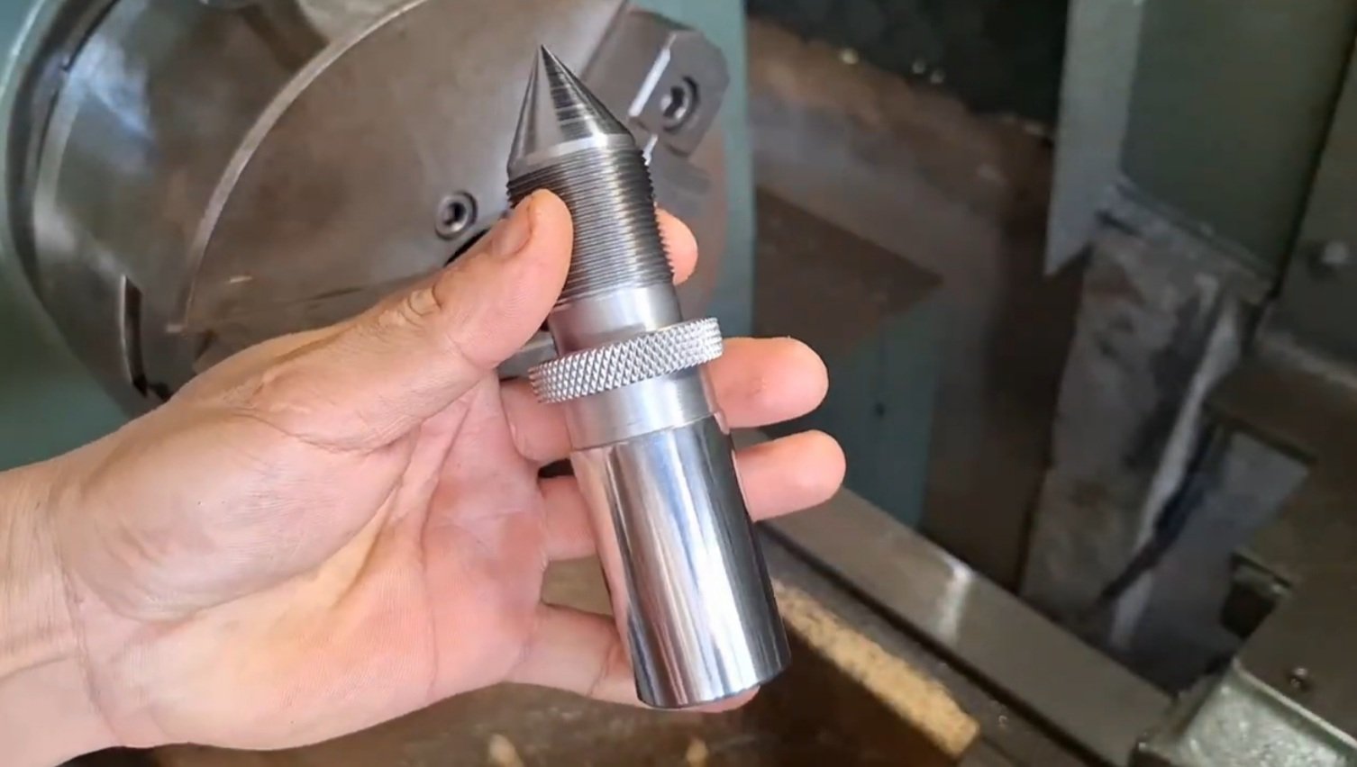

    Hi all,
    This tooling will allow you to turn shafting between centers from end to end and can also eliminate the use of an addition lathe dog to drive the work piece:
    For step and step tutorial including video: https://zalonvtn.blogspot.com/2024/05/blog-post.html

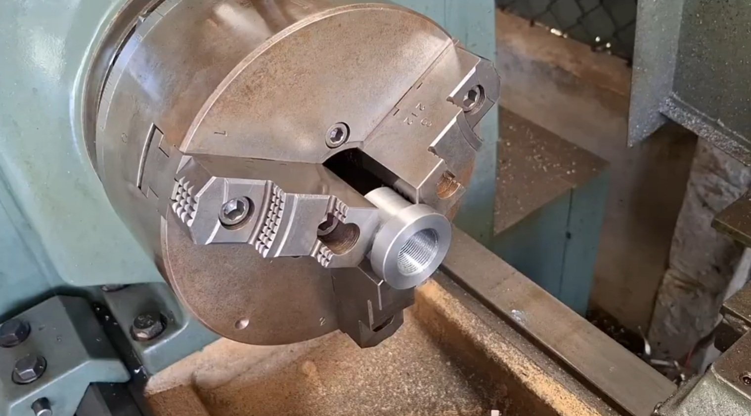

    Homemade lathe drive center-1.jpg Homemade lathe drive center-2.jpg Homemade lathe drive center-3.jpg
    Homemade lathe drive center-4.jpg Homemade lathe drive center-5.jpg Homemade lathe drive center-6.jpg
    Homemade lathe drive center-7.jpg Homemade lathe drive center-7.1.jpg Homemade lathe drive center-8.jpg
    Homemade lathe drive center-9.jpg Homemade lathe drive center-10.jpg Homemade lathe drive center-11.jpg
