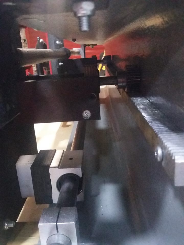

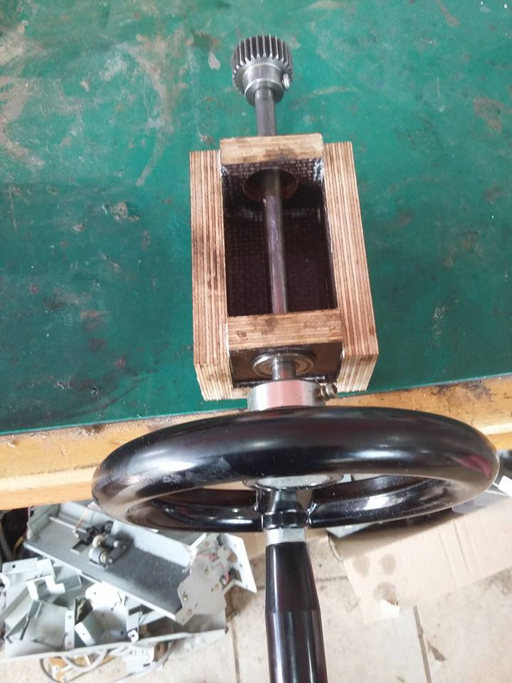

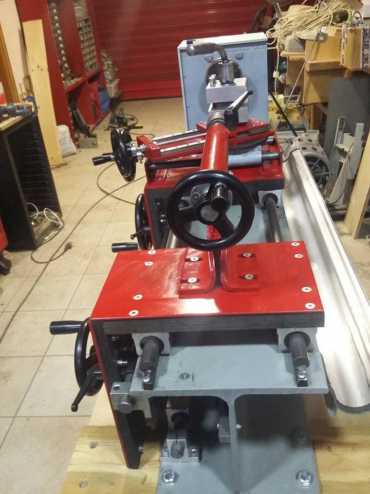

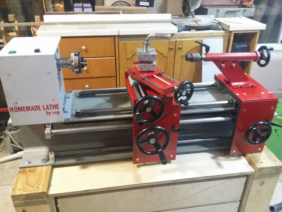

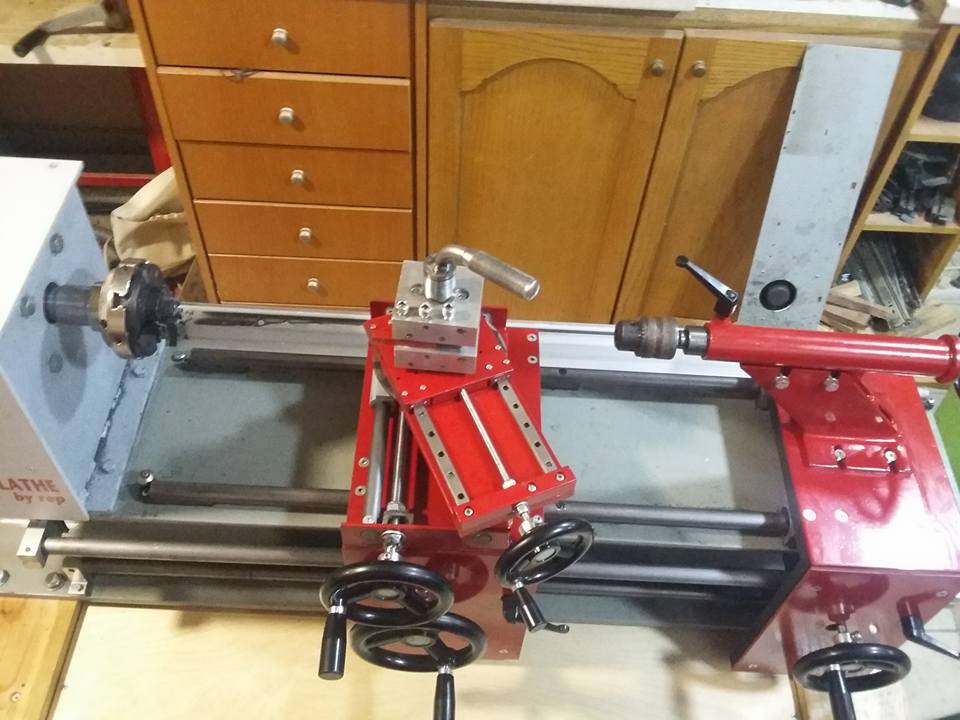

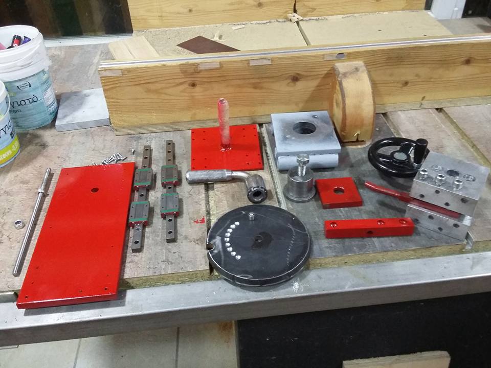

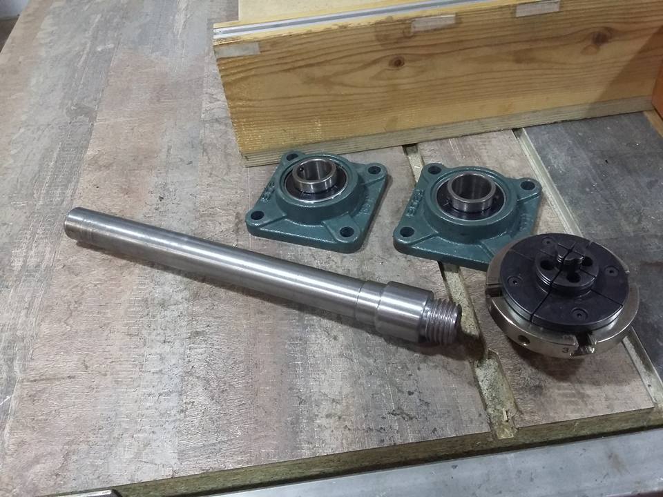

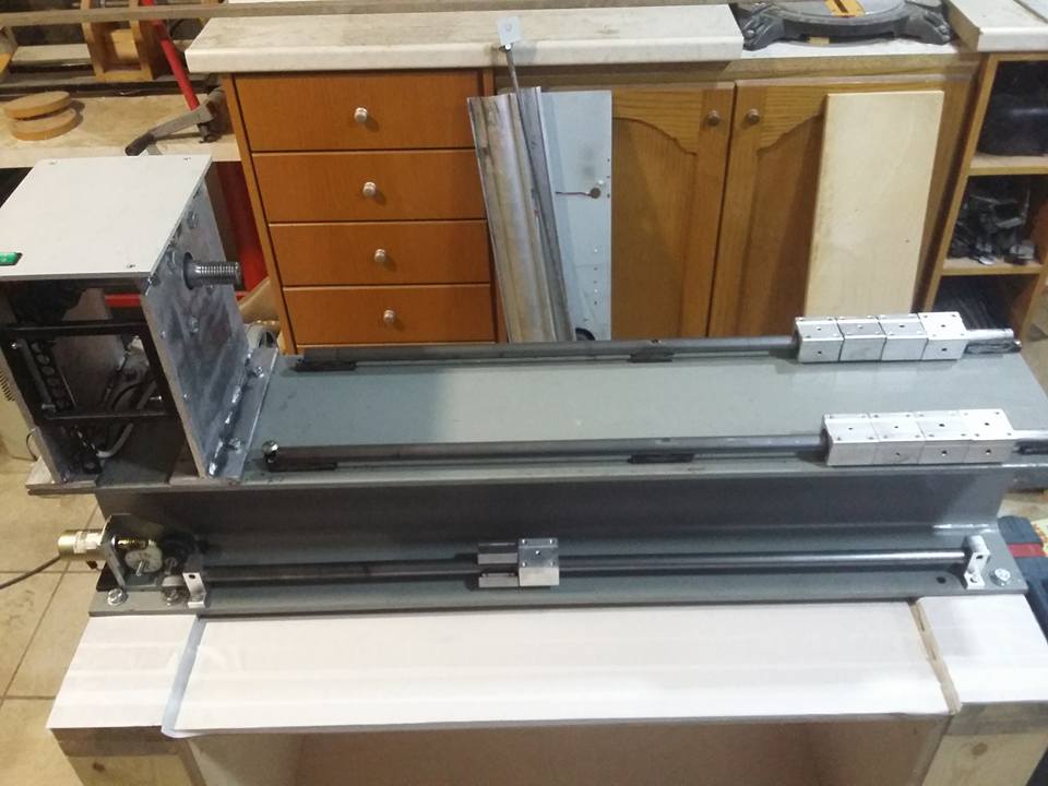

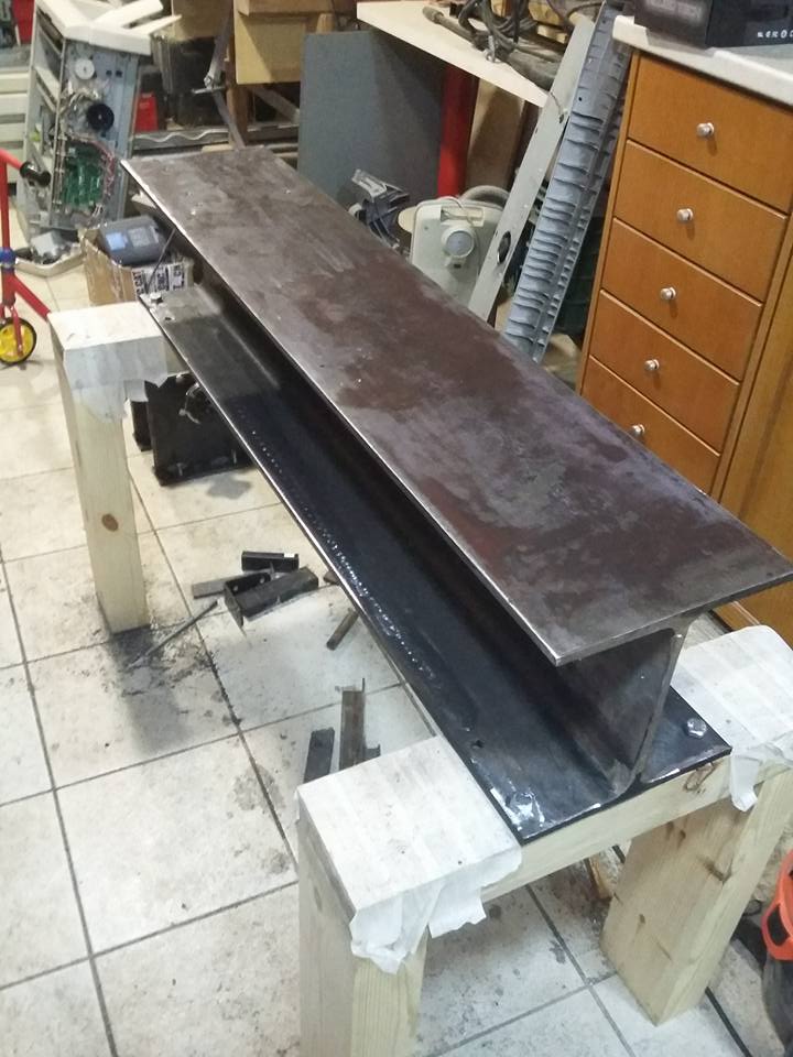

I always wanted to make a lathe. Three months ago without any design and a thick old wood and a metal (H) started. Many mechanisms and a lot of work almost every day. The first tests are satisfactory.

Are you mainly going to do wood work and a little metal? what moves the carriage? I see you have a handle on the saddle, is there a rack an pinion gear on the bottom of the feed rod?
