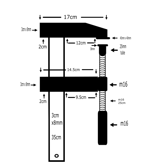

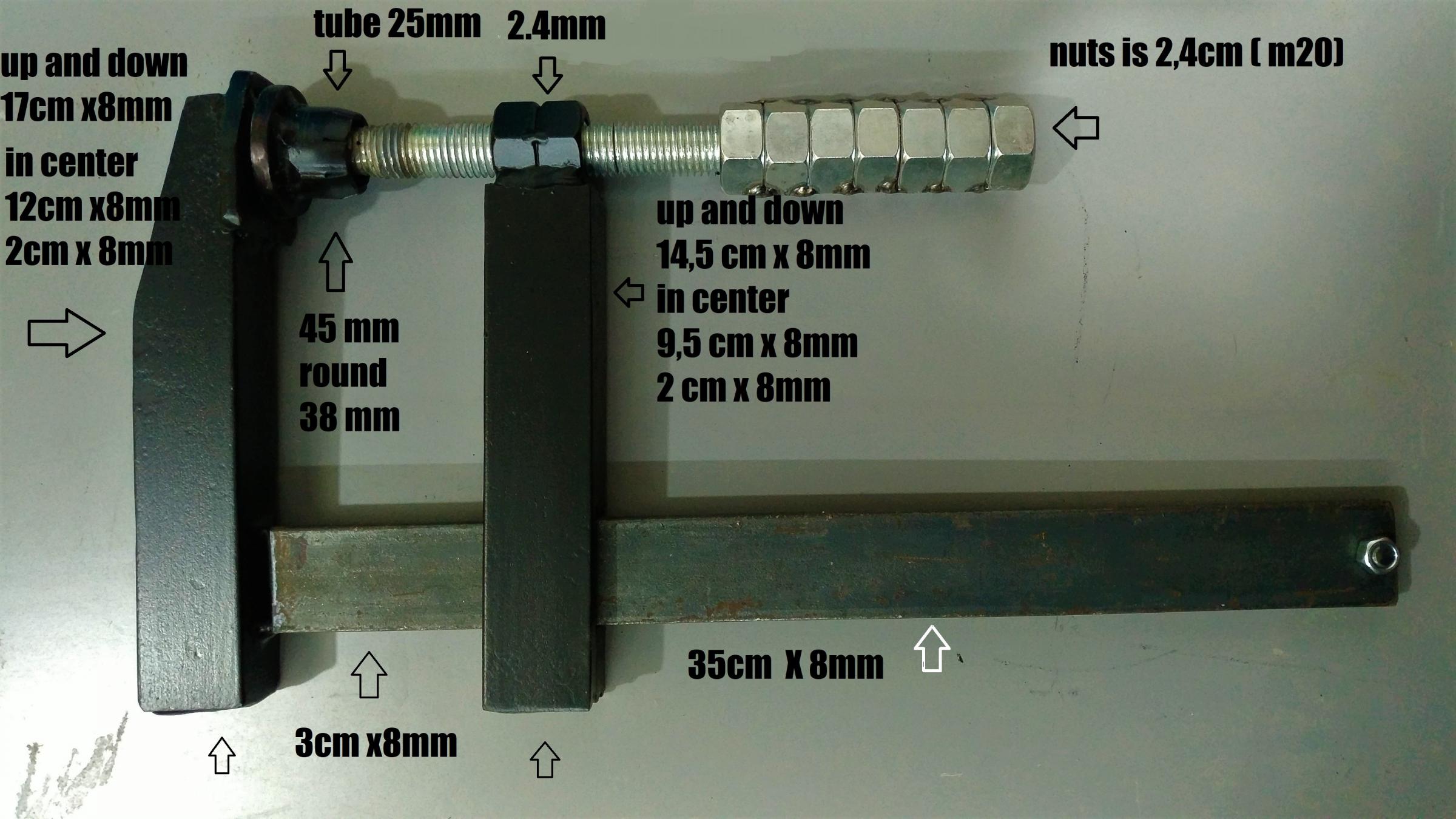

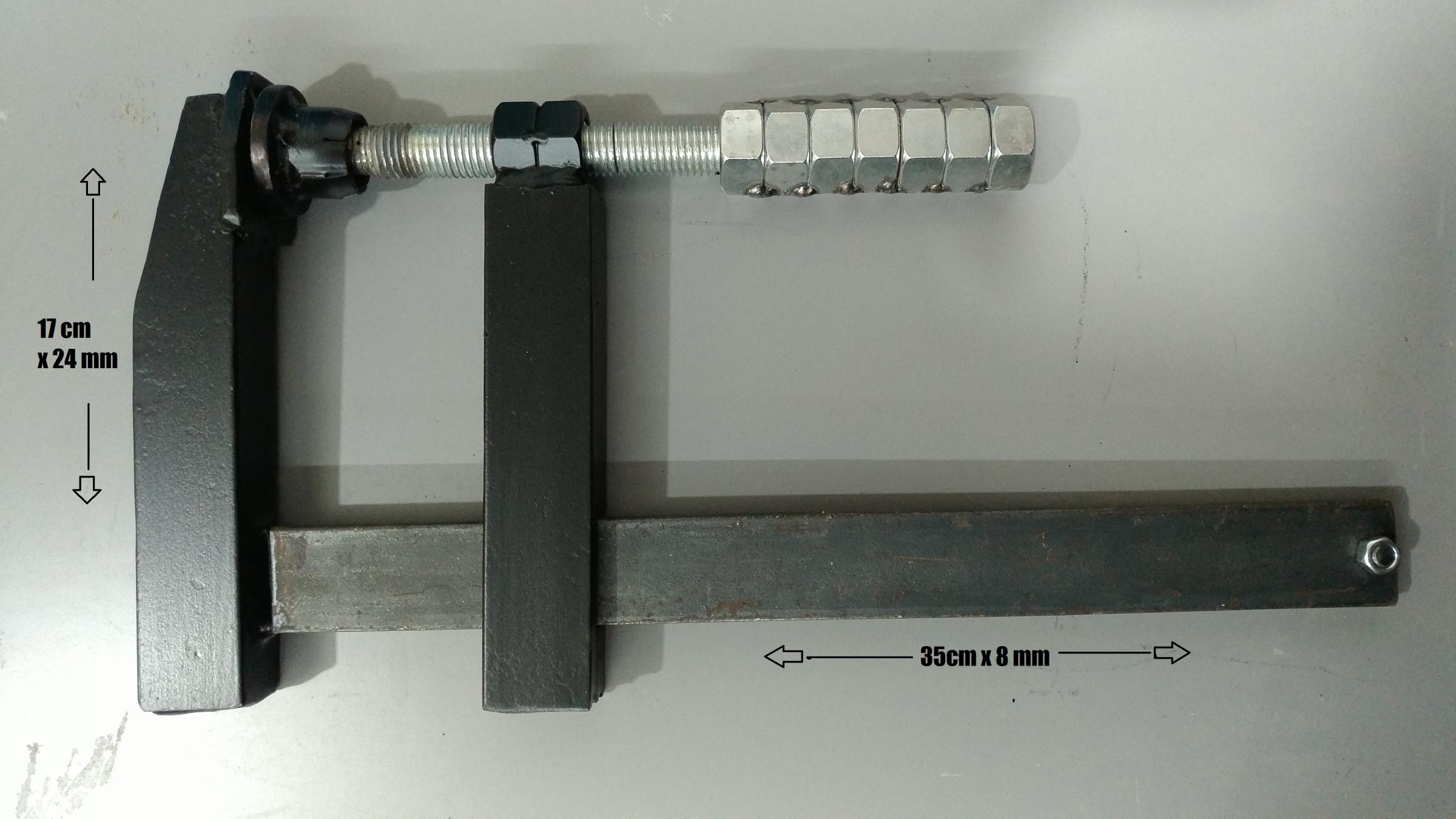

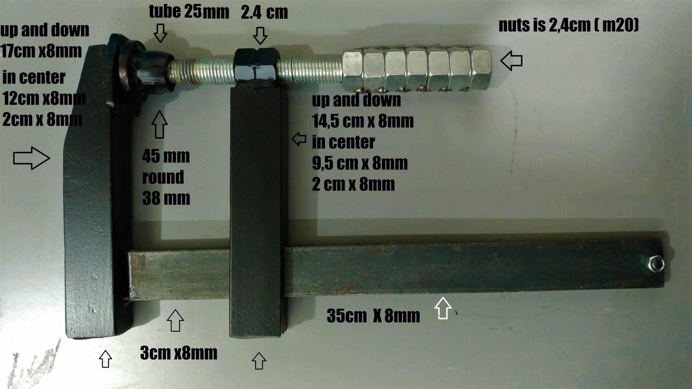

Hello Guys in this video you can see how to make a heavy duty F type clamp with nut handle.With nut handle you can lock with a wrench for more safety.
