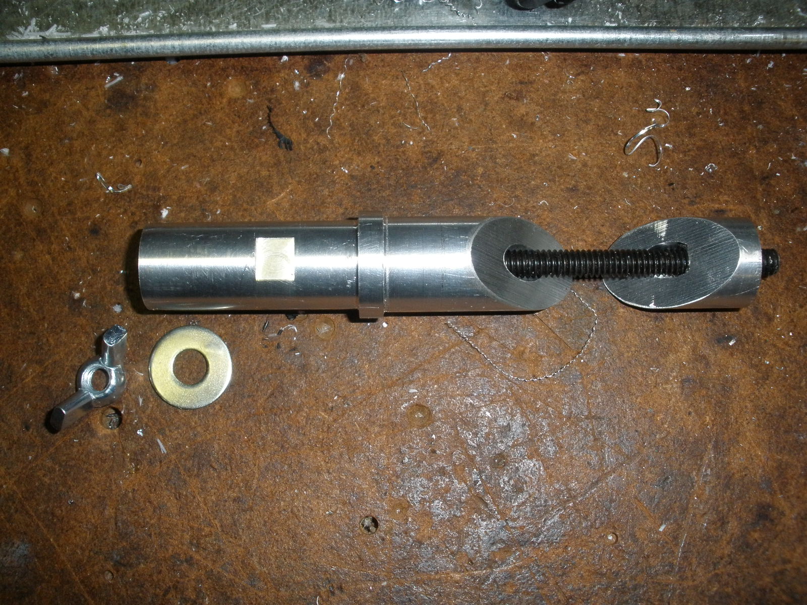

    My local hardware store has a modest selection of expanding anchors. If I am free to drill the required hole, these anchors work great. But there are times when the hole exists and I just need to be able to thread in a bolt. That is where it is nice to be able to make my own anchor. The design presented here is not as strong as the store-bought variety.
    If you are interested, please see
    https://rick.sparber.org/anchor.pdf
    Your comments are welcome. All of us are smarter than any one of us.

    This type of anchor works well to fix things to the outboard end of the bore of the lathe spindle. Examples of "things" might be a dividing disk or a hand crank for threading up to a shoulder.
    Done with square-section stock one can make fences that lock into the T-slots on a machine. For example...
    Miniature milling table accessories

    I suspect the genesis of this anchor was from seeing an attachment to a lathe. It might have been in the Bedside Reader series.
    A spreading anchor for a T slot sounds very useful. Do have to be careful not to force the top of the slot since it could chip out.
    An adjustable parallel is a close cousin.

    It has worked just fine in millions of bicycles over the years all over the world to hold the handlebars tight too.

    I made my lathe attachment based on bicycle handlebars.
    Here's the handwheel attachment for the lathe.

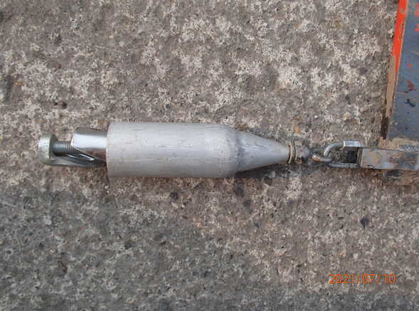

    Gadgeteer's Tools
    I repurposed a handlebar anchor to secure 3/4" poly pipe inside the bullet point puller for my ride-on yard irrigation trencher. It just happened to fit its second purpose, perfectly.
    Attached Thumbnails Attached Thumbnails A Homemade Expanding Anchor-bullet-puller-2.png
