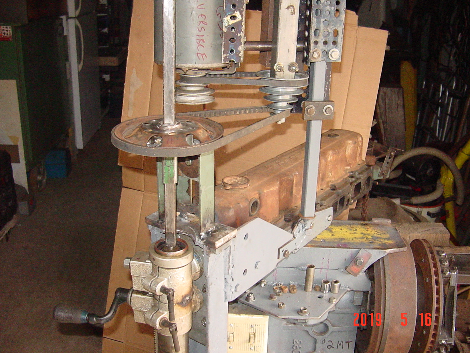

    This project is a continuation of my "HOMEMADE METAL WORKING LATHE" and based on the Pat Delany "MULTI MACHINE" concept.
    Also see my "HOMEMADE 4 JAW CHUCK" project.
    This design is similar to Smithy Lathe/Mill machines.

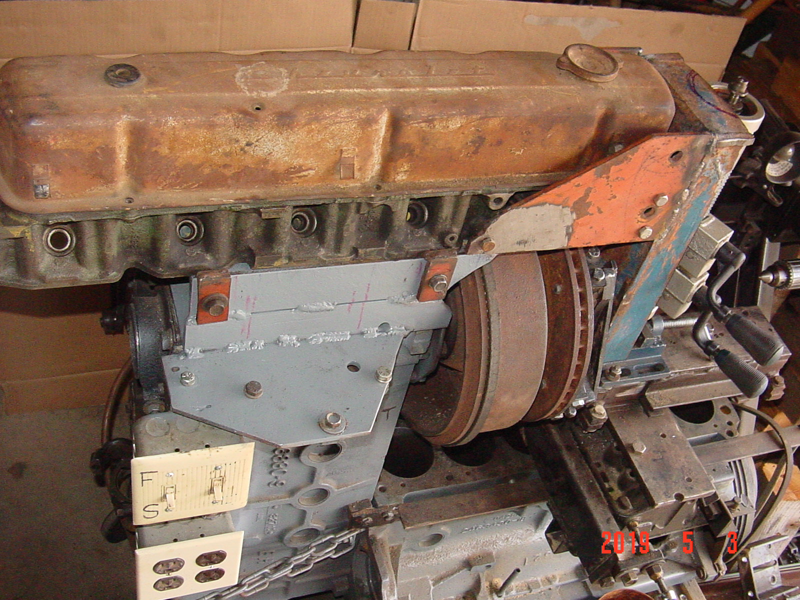

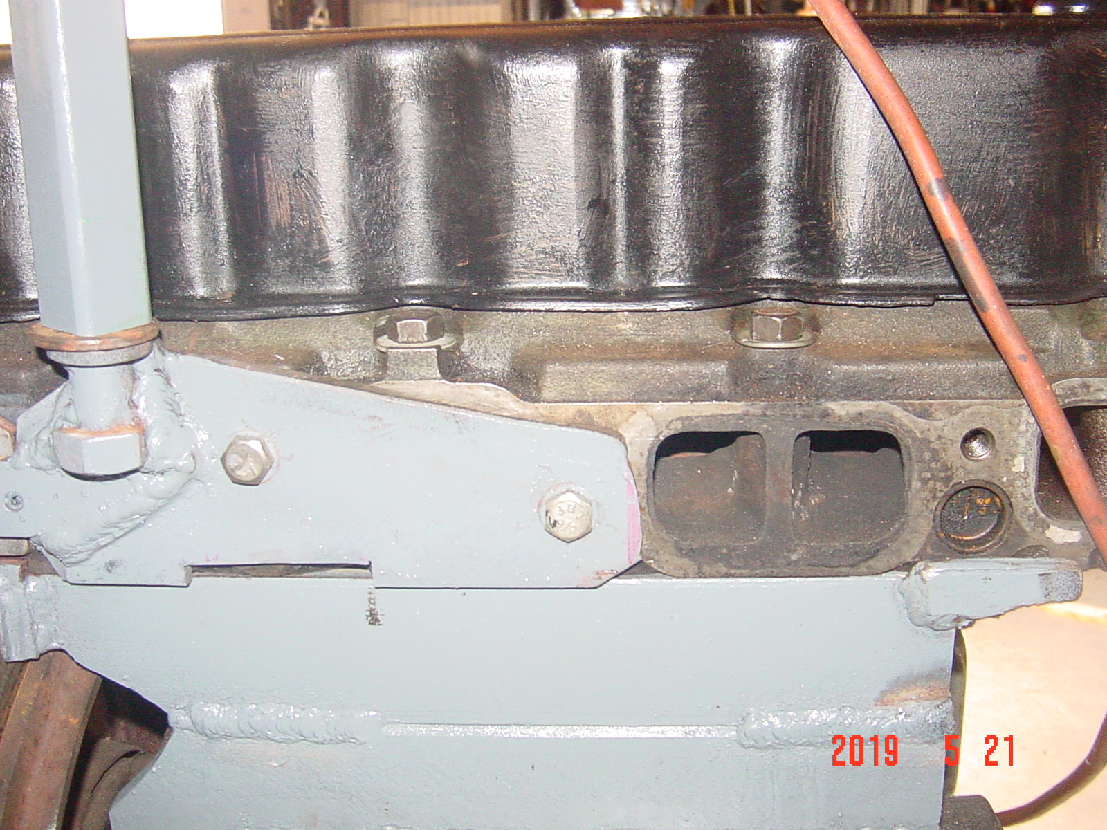

    The Chevy 6 cyl. head is mounted to the front end of a slant 6 Mopar engine block
    standing vertically.

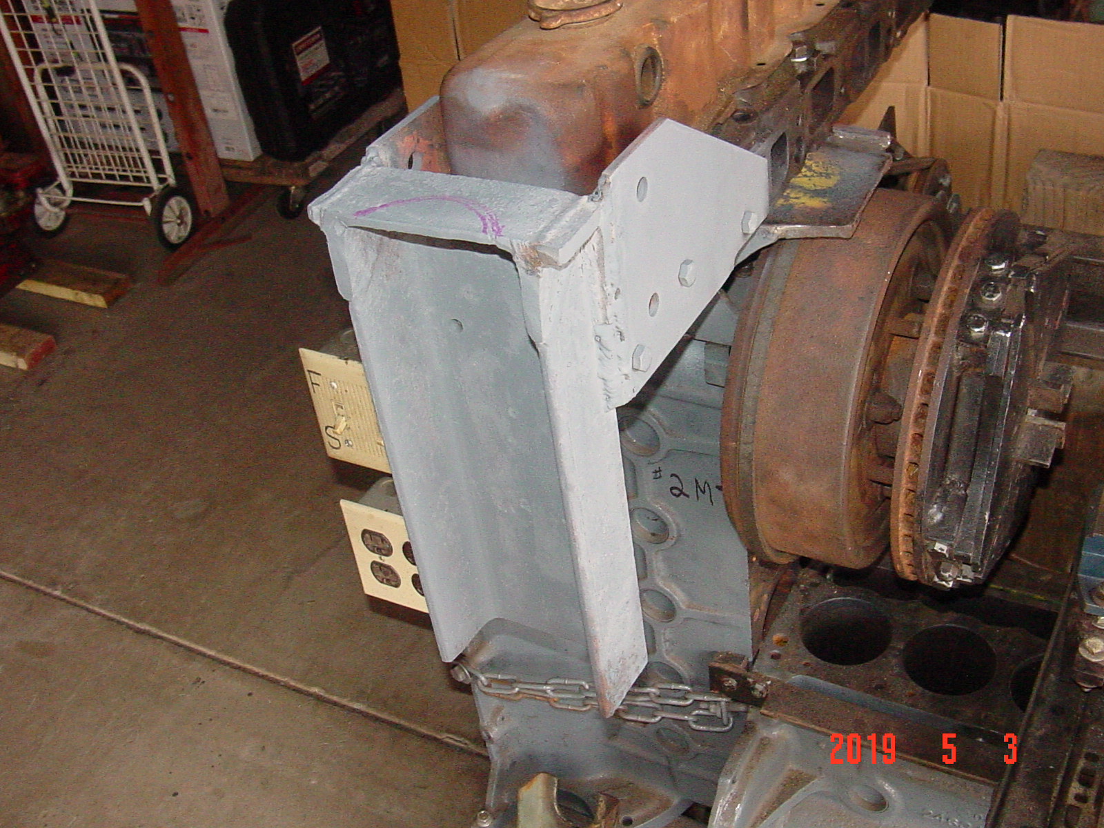

    Between the Mopar 6 cyl. block and the 6 cyl. Chevy head are two
    pieces of 6 " channel iron welded together. pics 8, 9, 14
    1/4" plate is welded to attach the lower channel iron to the front end of the
    vertical block using 13 factory made threaded holes. pics. 8, 9, 18
    The upper channel iron is drilled and tapped in 6 places to match
    existing factory head bolt hles. Stops are welded to channel iron by the
    exhaust ports. Clamps are bolted to the channel iron on the spark plug
    side of the head. pics. 8, 14

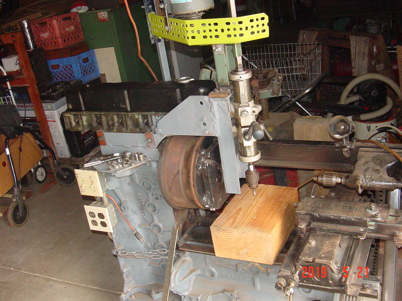

    The head can be located in two different positions and also swung out of
    the way when not in use. Always support the Milling "Head" when changing position
    or have at least 1 head bolt installed. pics 1, 8, 9, 18

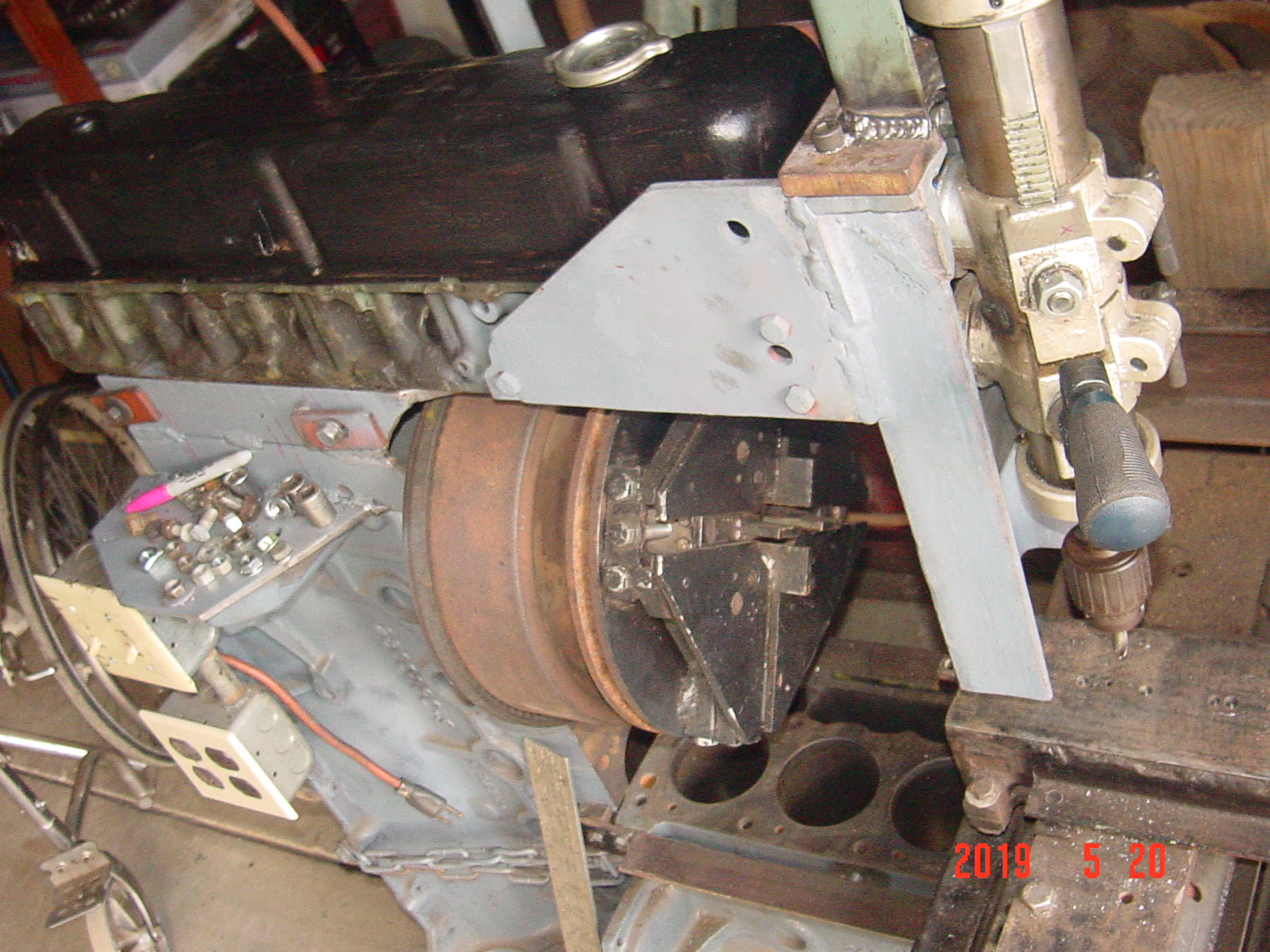

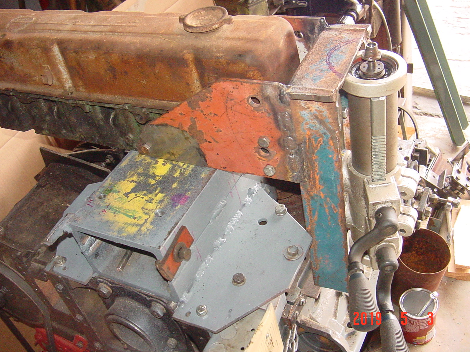

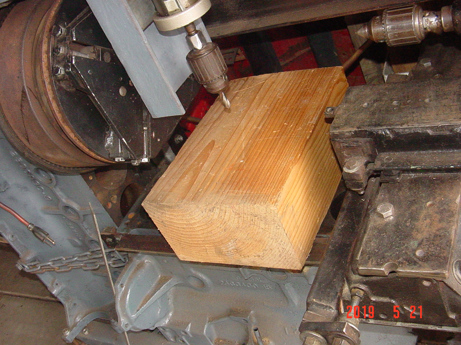

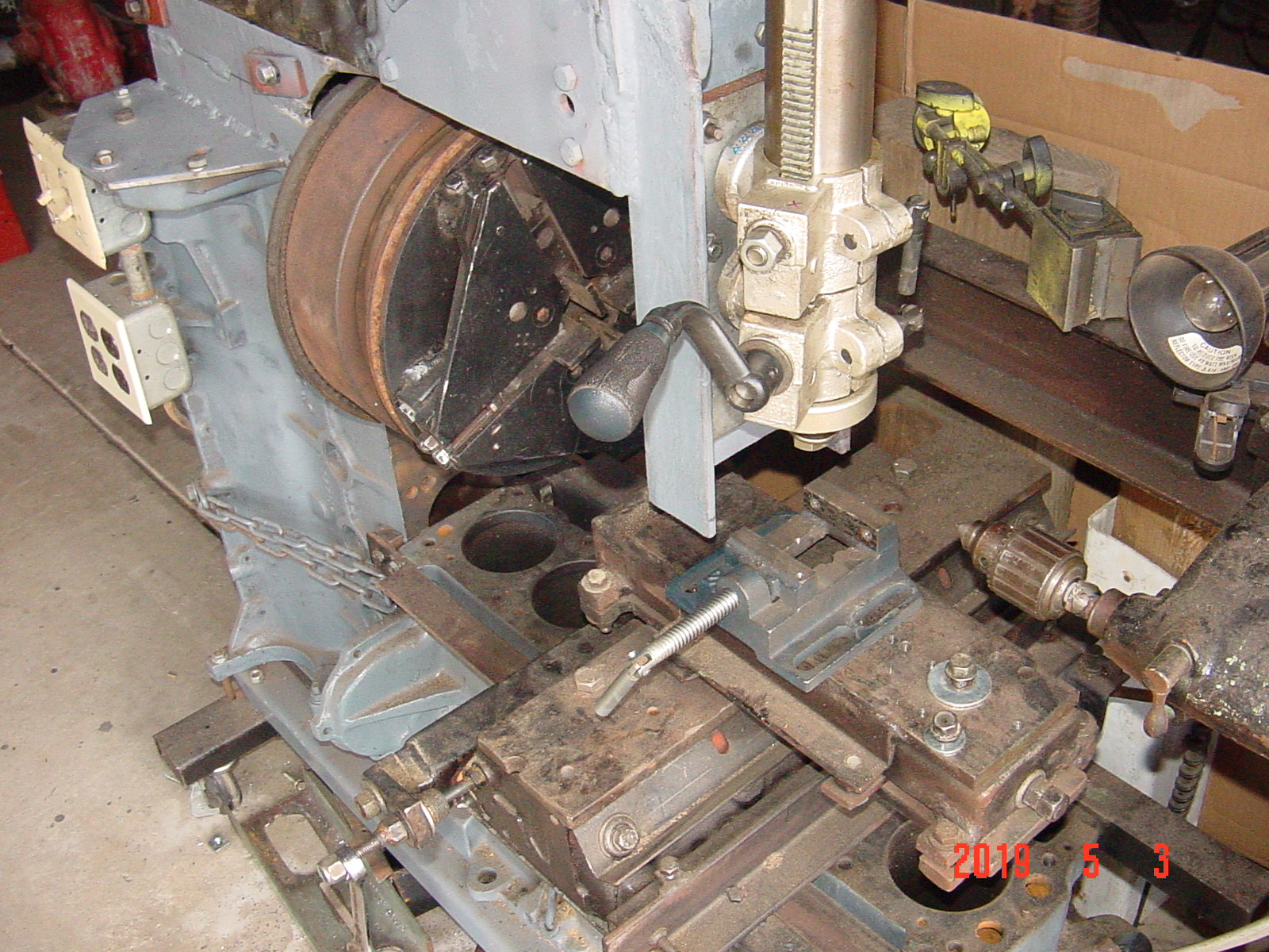

    5 1/2" channel iron is bolted to the front end of the head
    where the thermostat housing normally bolts to the head using 3 existing
    threaded holes. Gussets are drilled to match existing taped holes in the head and welded
    to the 5 1/2" channel. pics. 3, 11, 18

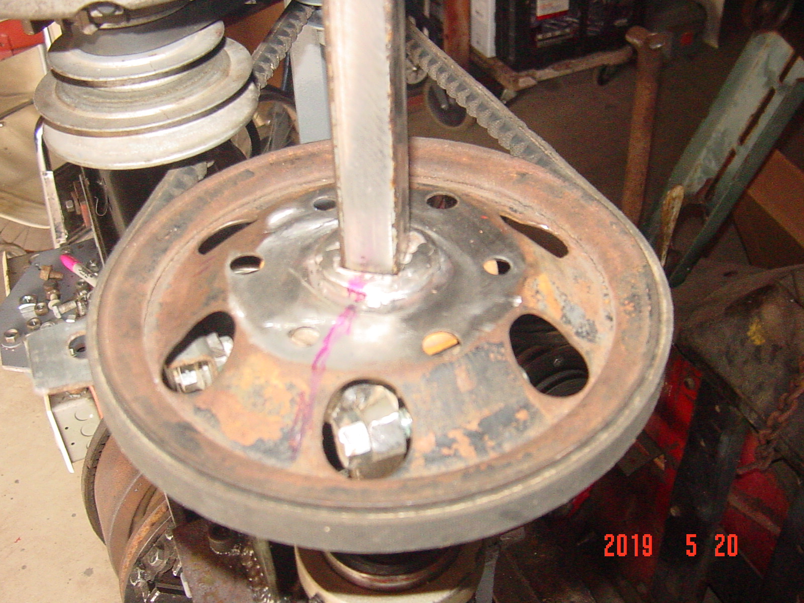

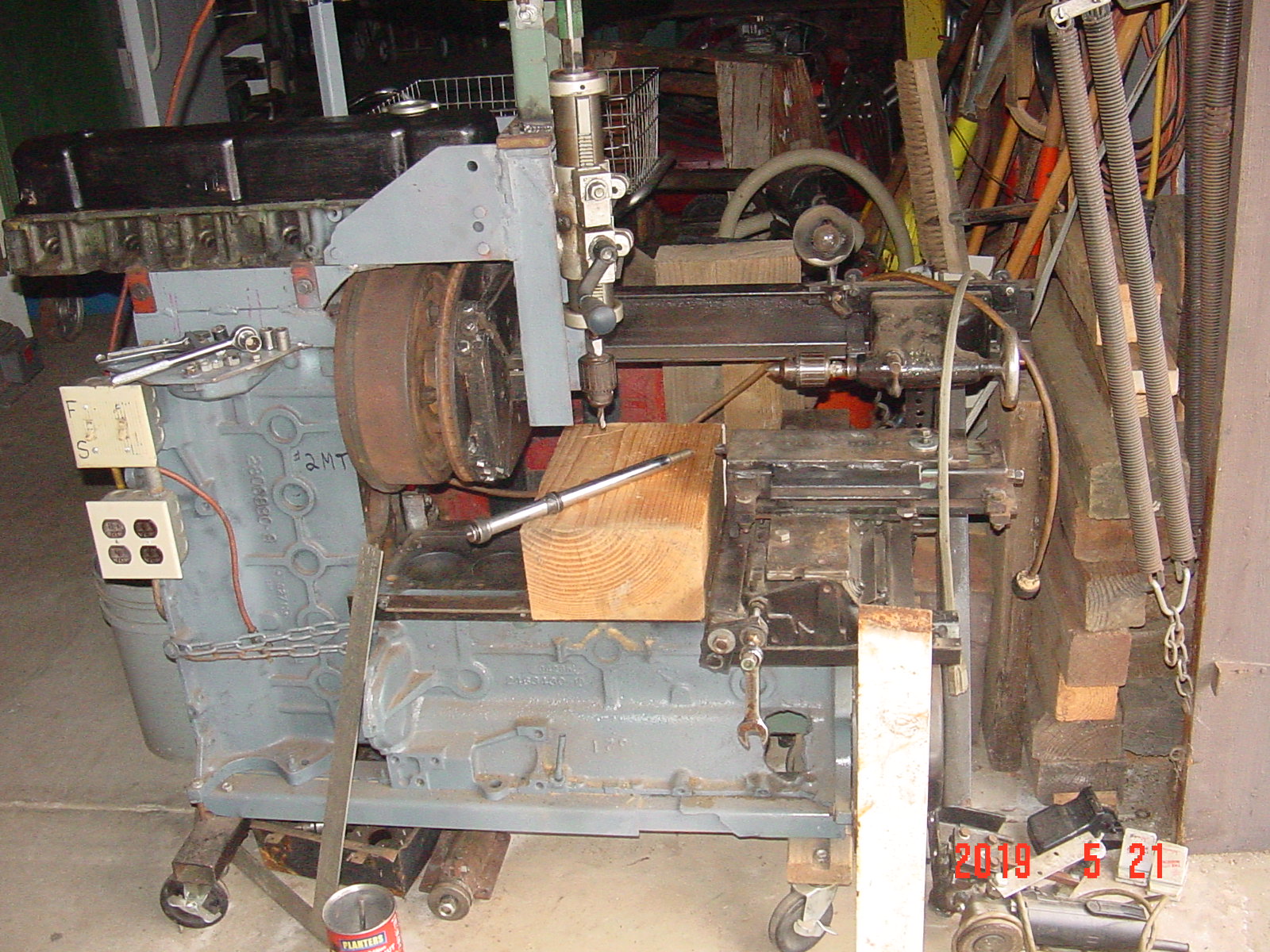

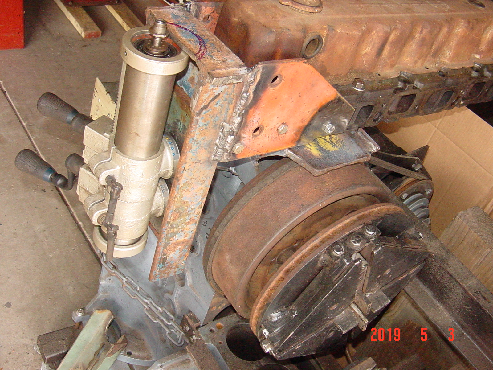

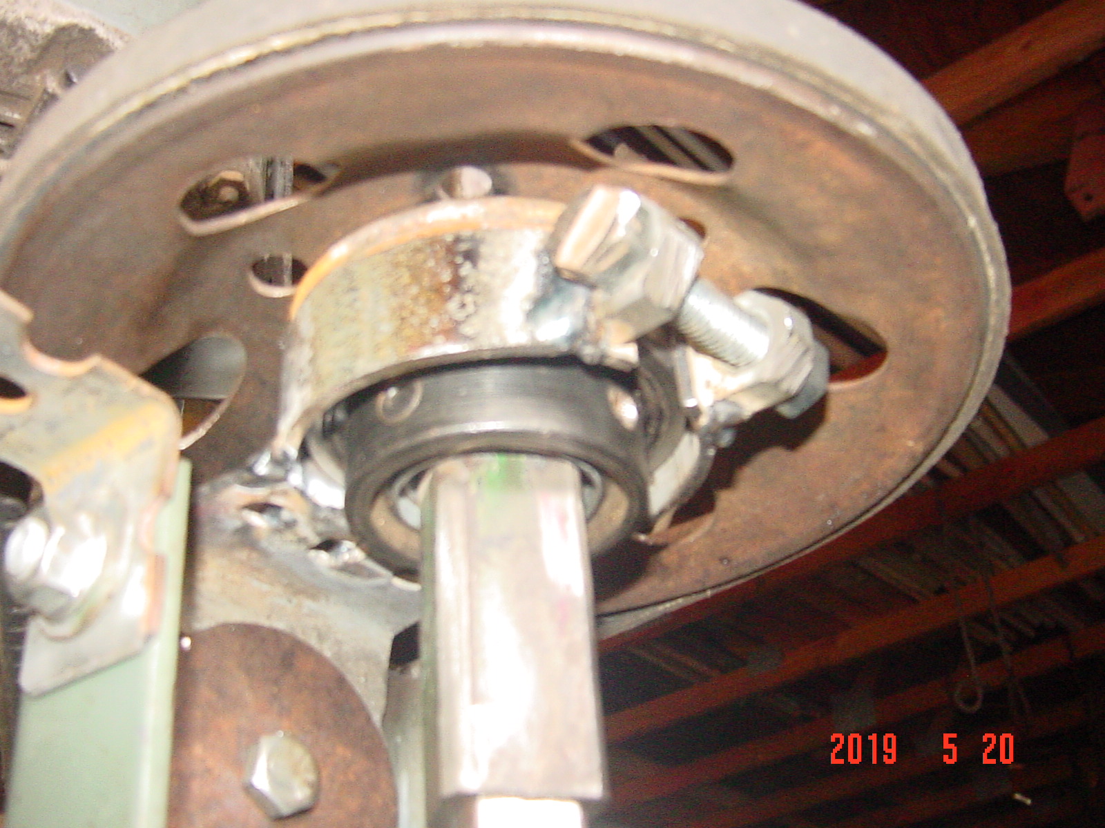

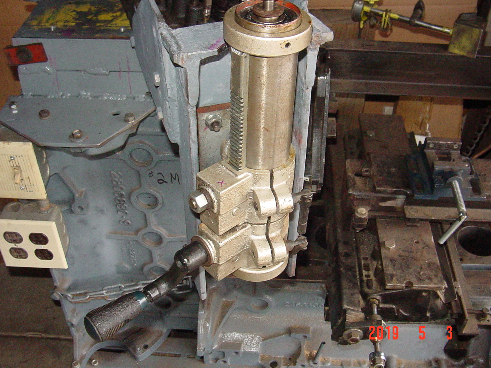

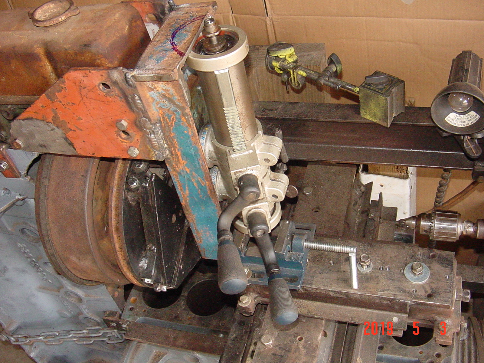

    I made the drill arbor using parts from two Chinese drill presses. The
    shaft is from a motorcycle front strut. Sealed ball bearings are used
    top and bottom of the shaft. The telescoping drive shaft is made from 3/4" square tubing
    over 1" x .100 wall square tubing. A Mopar crankshaft pulley drives the
    1" square tubing. pics. 2, 3, 5

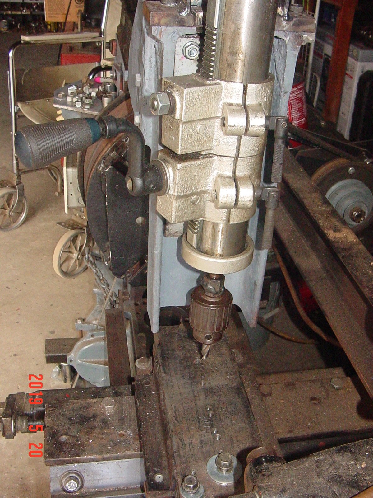

    A 6207 sealed ball bearing is used to locate the drive pulley. pics 6, 7

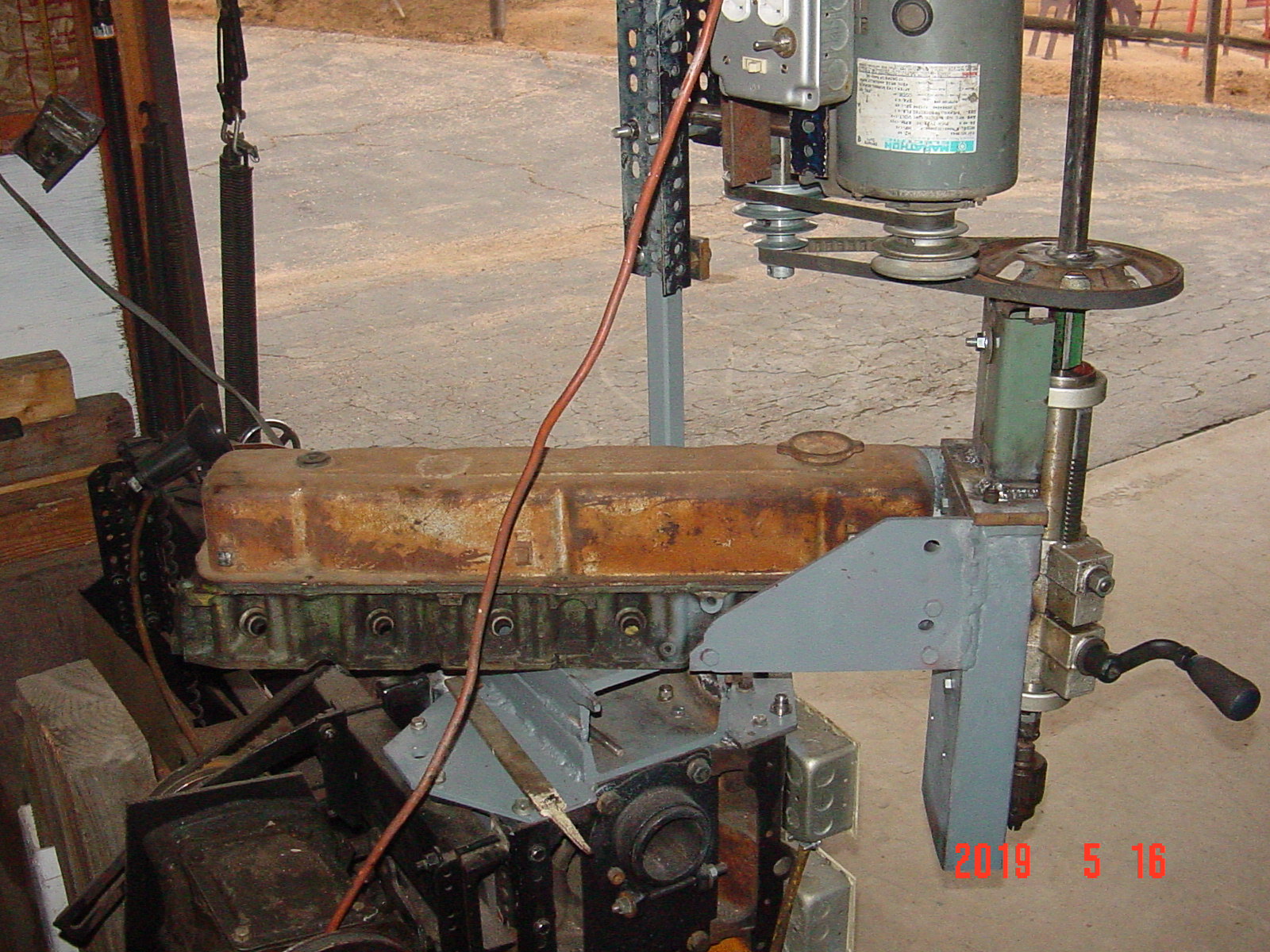

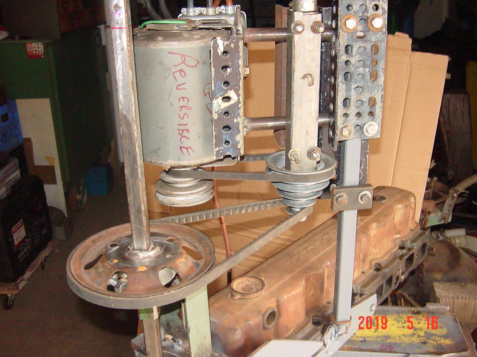

    A 1725 rpm motor drives the arbor using step pulleys on the jackshaft and
    motor. pics. 15, 16
    A cross slide made from a Chevy V8 head is on the horizontal engine
    block. This is used for both lathe and mill functions. pics. 8, 12, 13
    I am not going to put in a lot of specifics and measurements since most
    likely your project will become different because of different parts being used.
    Any project you build is at your own risk and liaibility. It's safety
    and operation is your responsibility. I relinquish all
    responsibility/liability in any project you build.
    Good luck and have fun!
