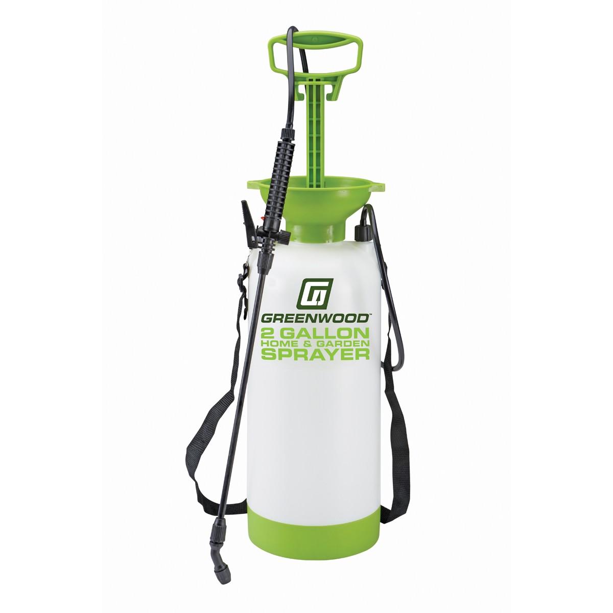

    https://www.harborfreight.com/2-gall...yer-95690.html
    $14.99
    Super quiet, get buff

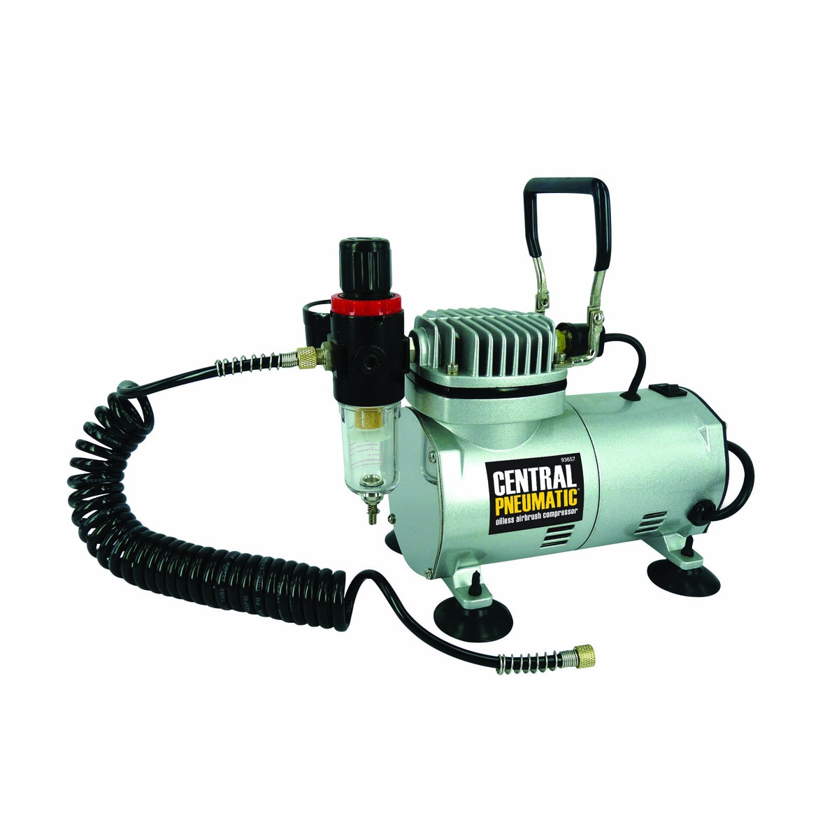

    https://www.harborfreight.com/1-6-hp...sor-93657.html
    $69.99
    Still pretty quiet, the usually quality at a great price.
