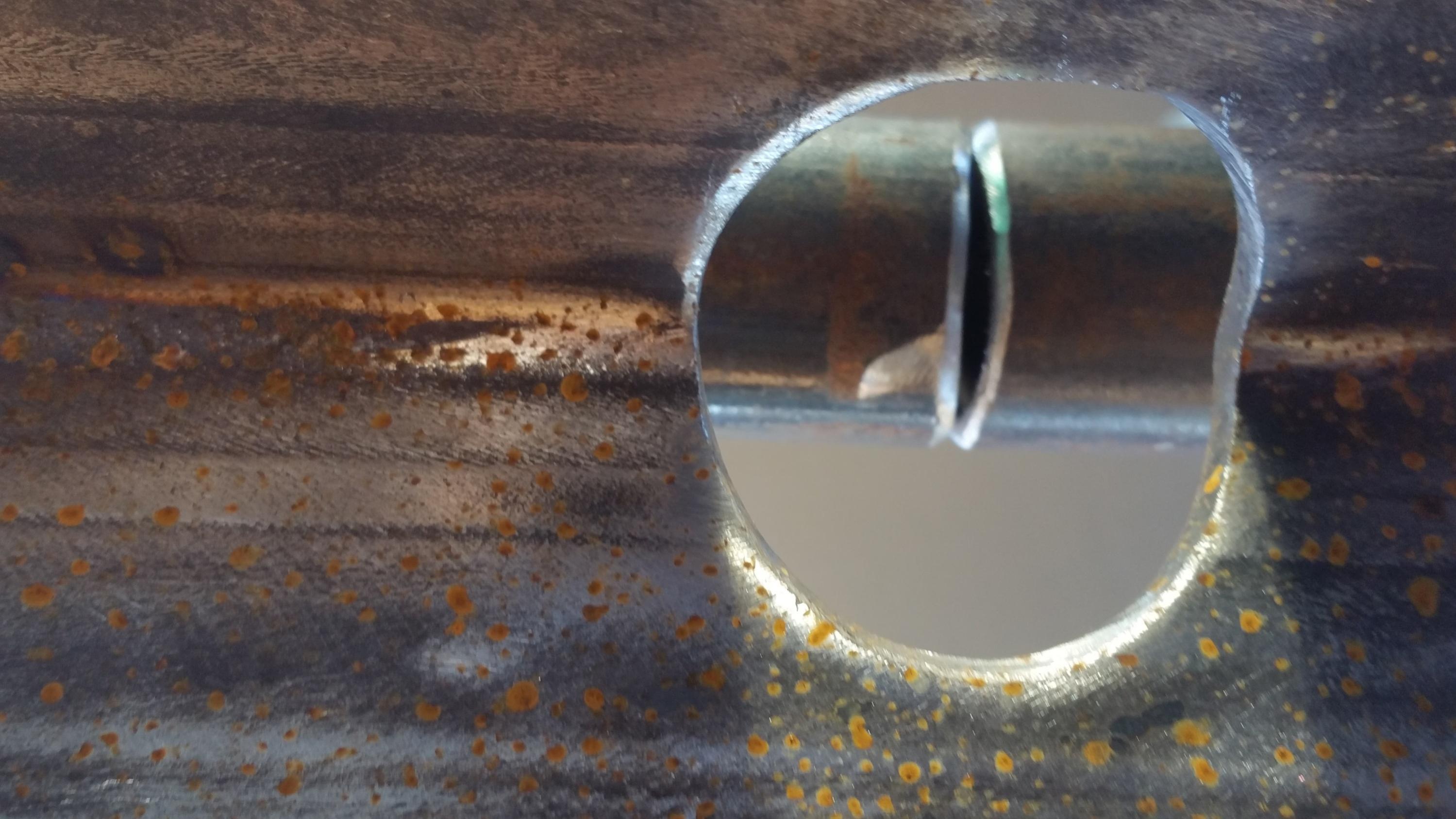

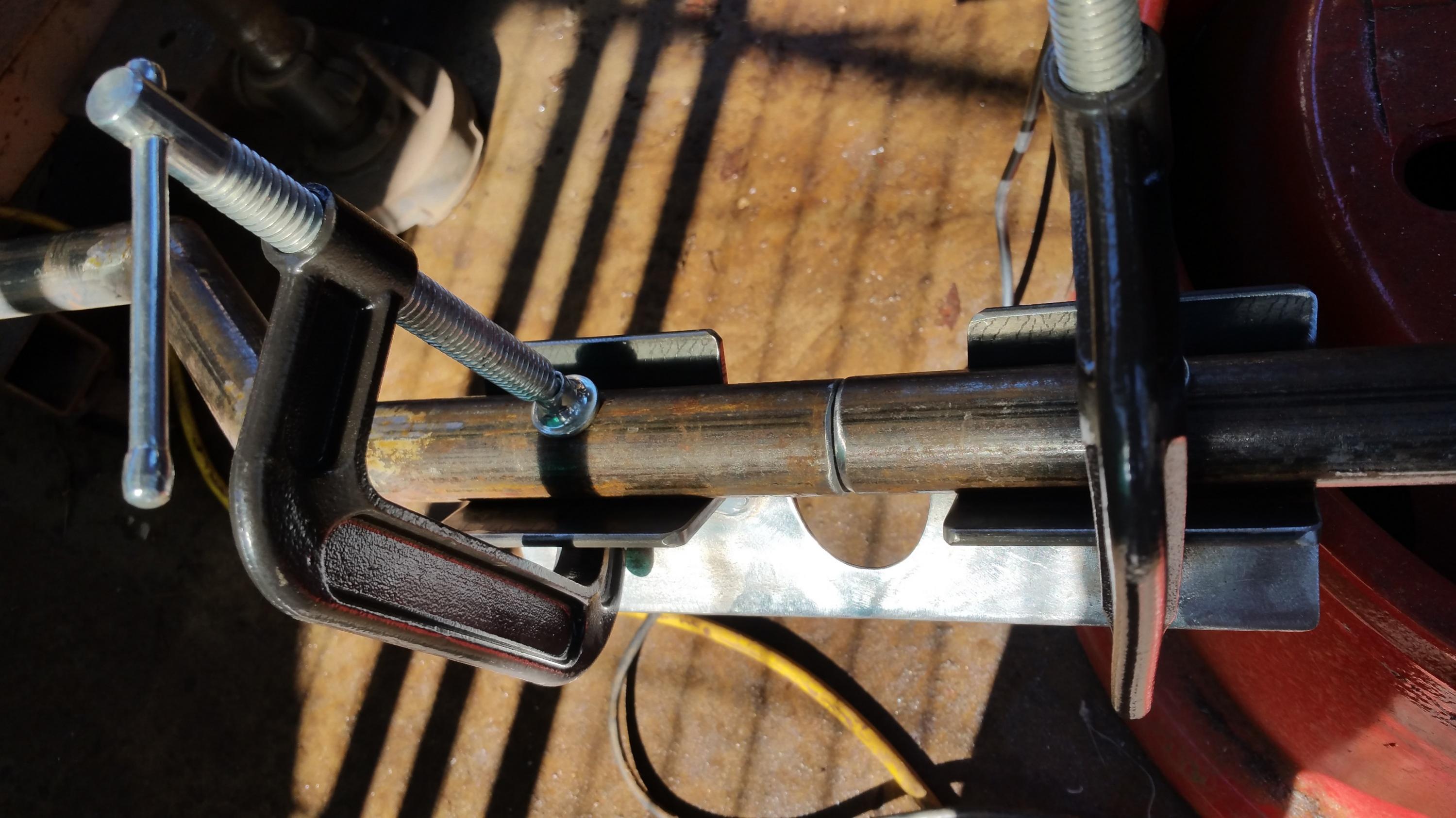

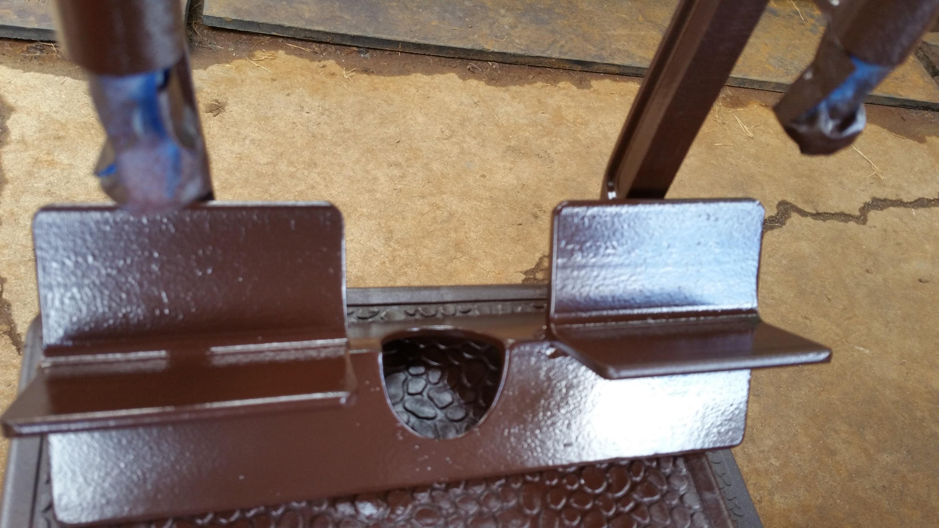

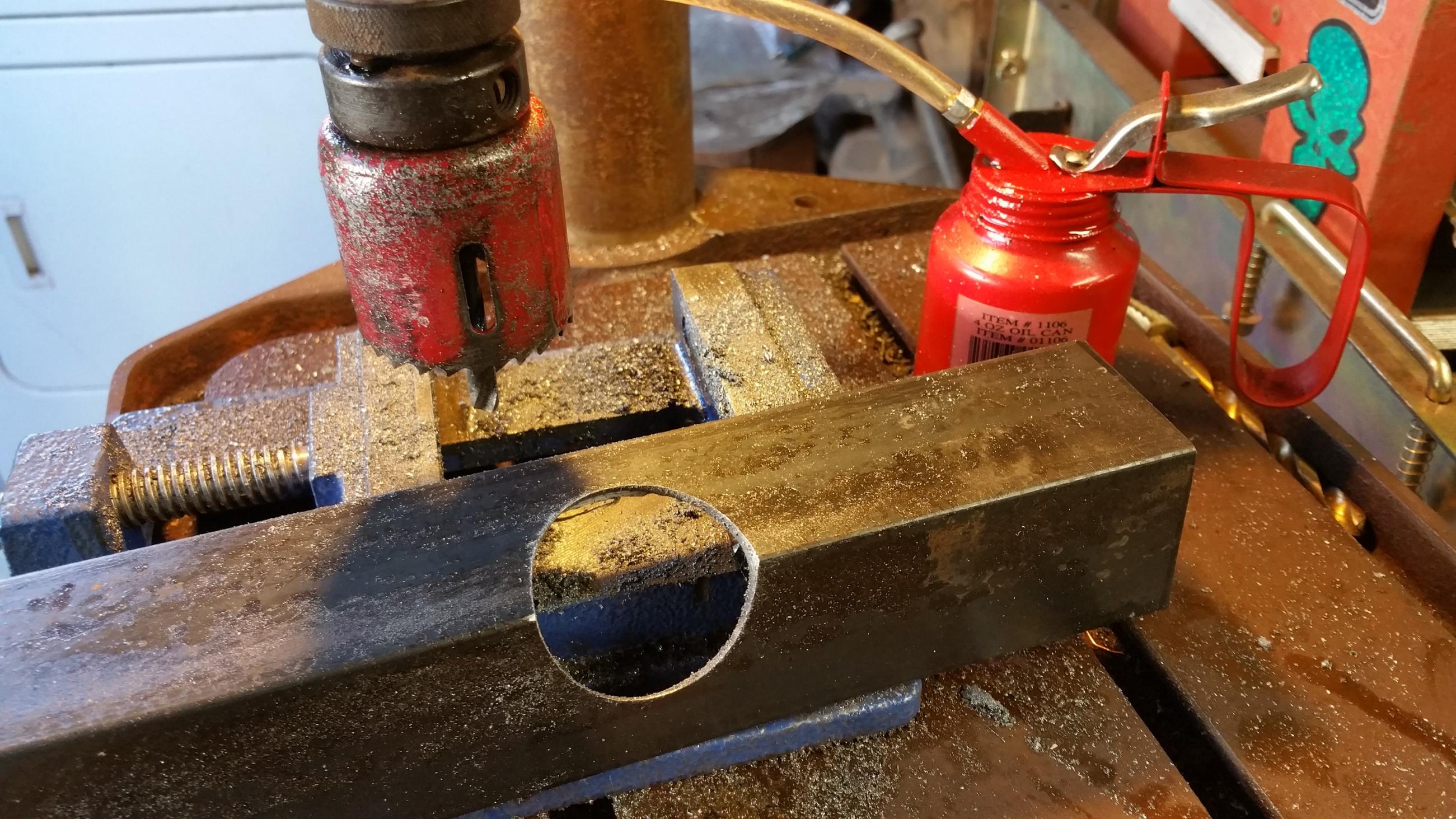

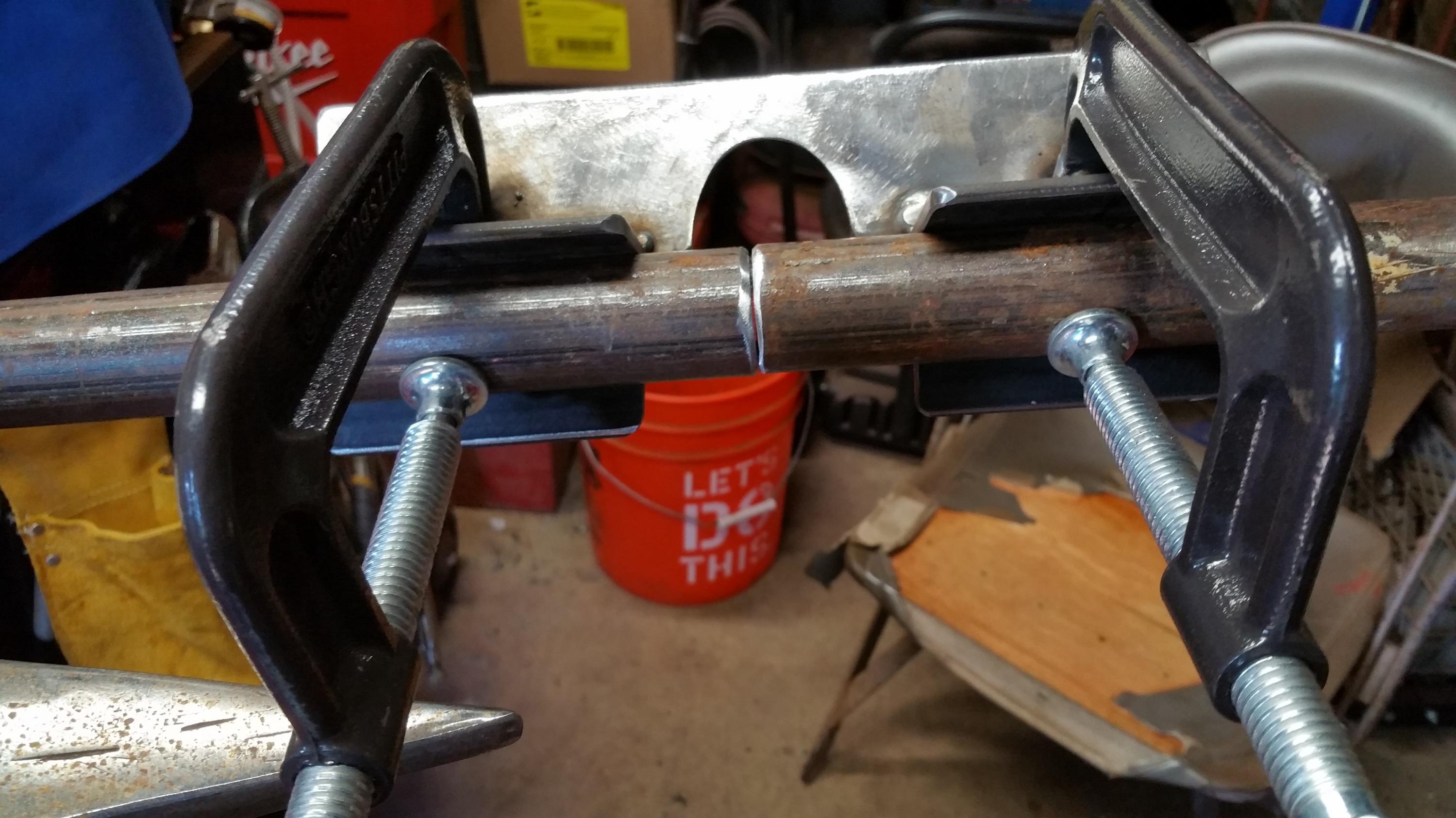

    homemade clamp for welding pipe end to end-20151125_142631.jpghomemade clamp for welding pipe end to end-20151127_094438.jpghomemade clamp for welding pipe end to end-20151127_094509.jpghomemade clamp for welding pipe end to end-20151127_095135.jpghomemade clamp for welding pipe end to end-20151127_141506_001.jpg Here are a few pictures of a pair of clamps I made, I found the idea on the internet and copied it...and added the hole in the center to allow welding access from the bottom.

    Gracias Eljorger, así se soluciona el inconveniente de soldar el tubo cuando se suelta de un lado y de este modo se deja fijo sin que se deforme.
