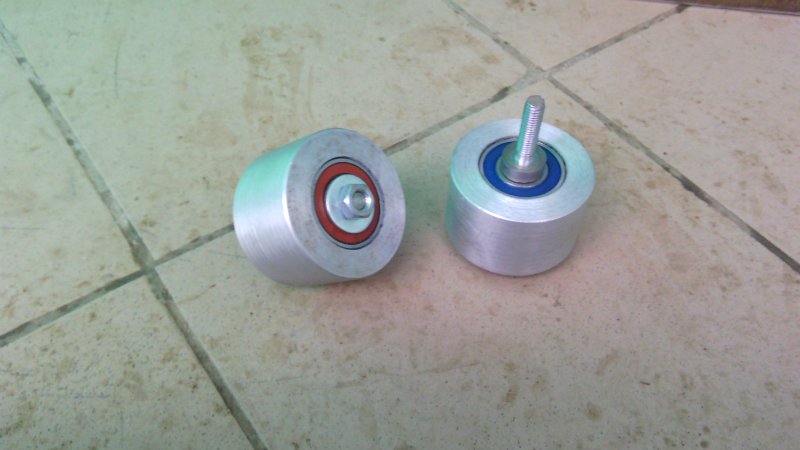

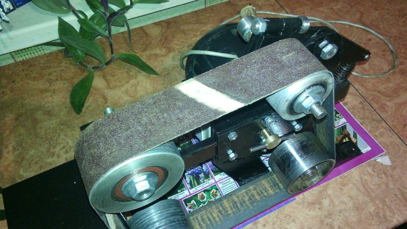

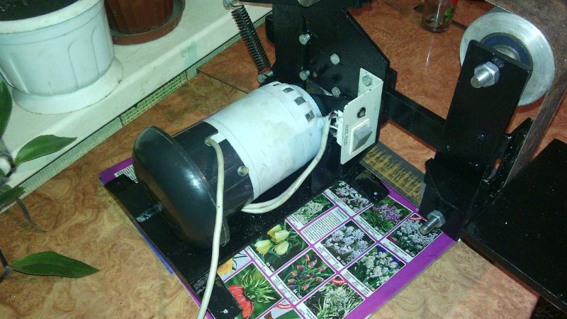

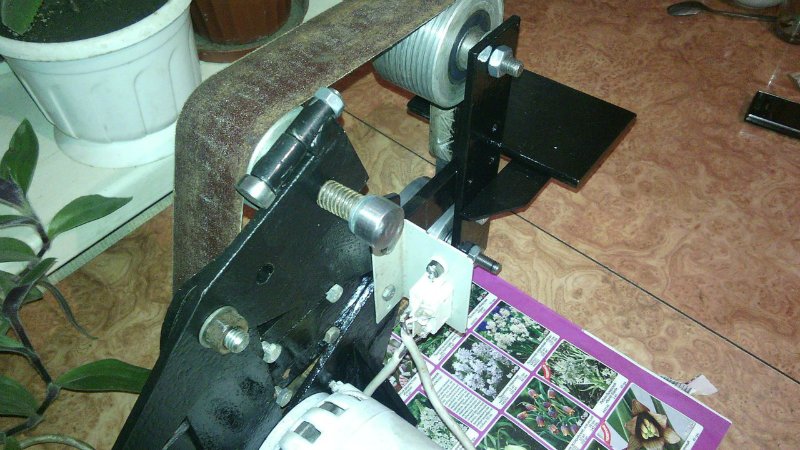

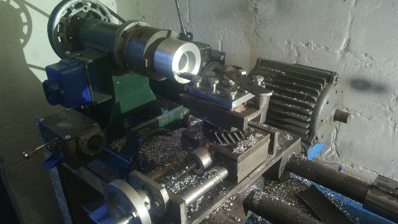

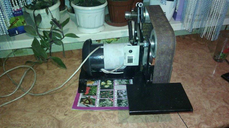

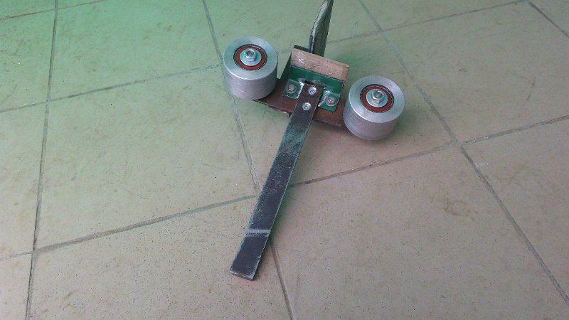

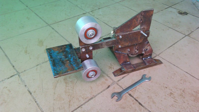

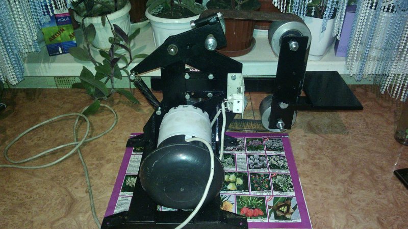

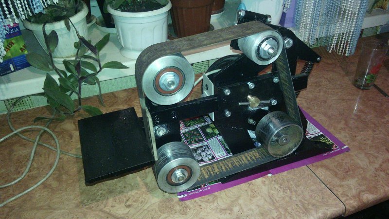

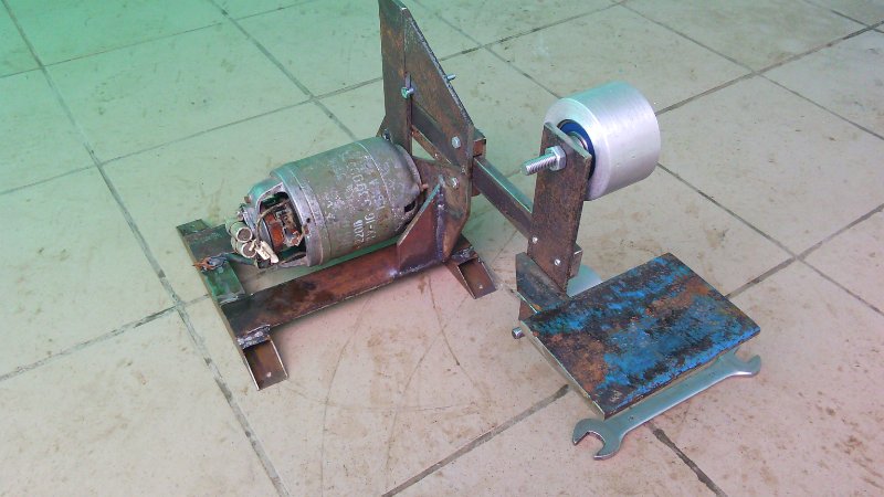

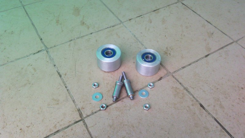

    Hi! I am making a belt sanding machine. Use everything that he found in his garage, metal plates, aluminum scrap to be molten.

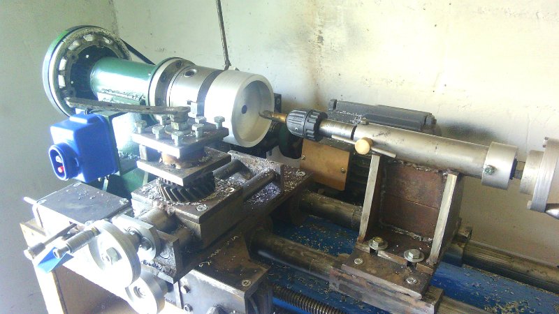

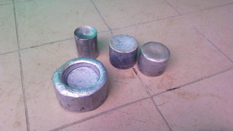

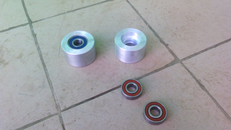

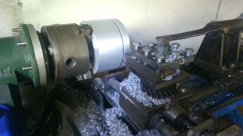

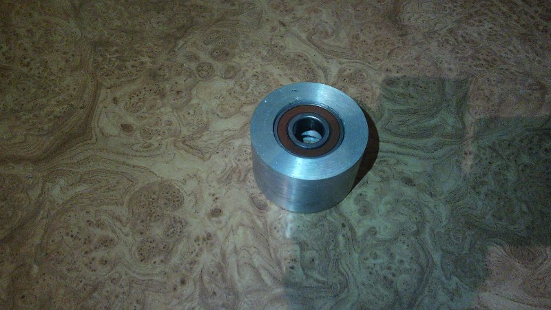

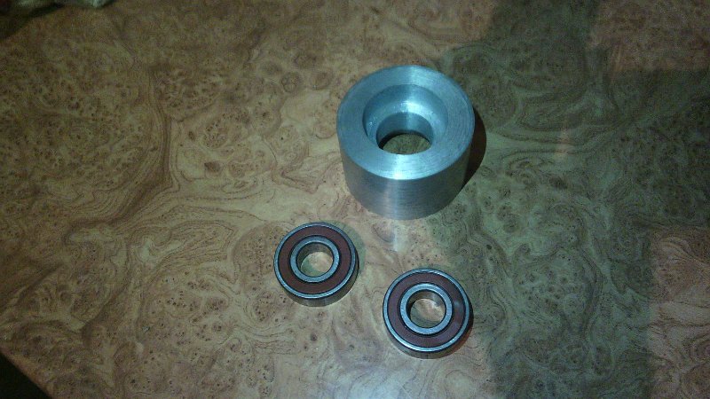

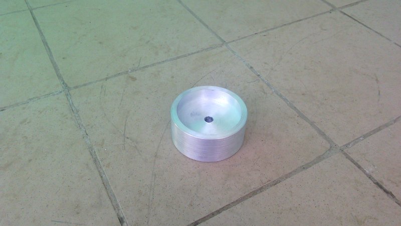

    Aluminum scrap Melting, received here are blanks for rollers and pulley on the engine.

    Wow, that is an impressive homemade tool build using your own aluminum castings and then machining the cast parts on your homemade lathe to make another homemade tool. Thank you for the posting and video, Paul

    Great build! Very good machining! What size belt does it take?

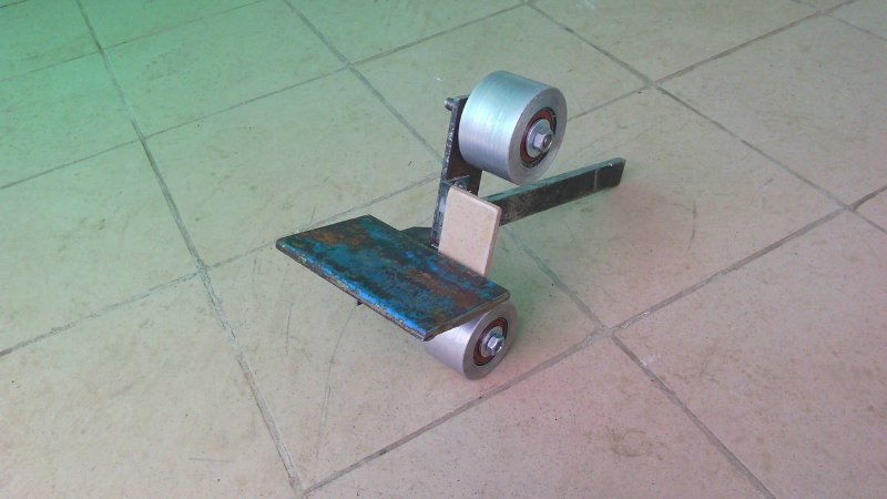

    Quote Originally Posted by DrByte View Post

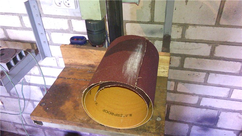

    The minimum length of belt 800mm, maximum 1400mm. Belt myself produce, cut into strips and glue.Homemade belt sander-daa37d66aa6f.jpg
